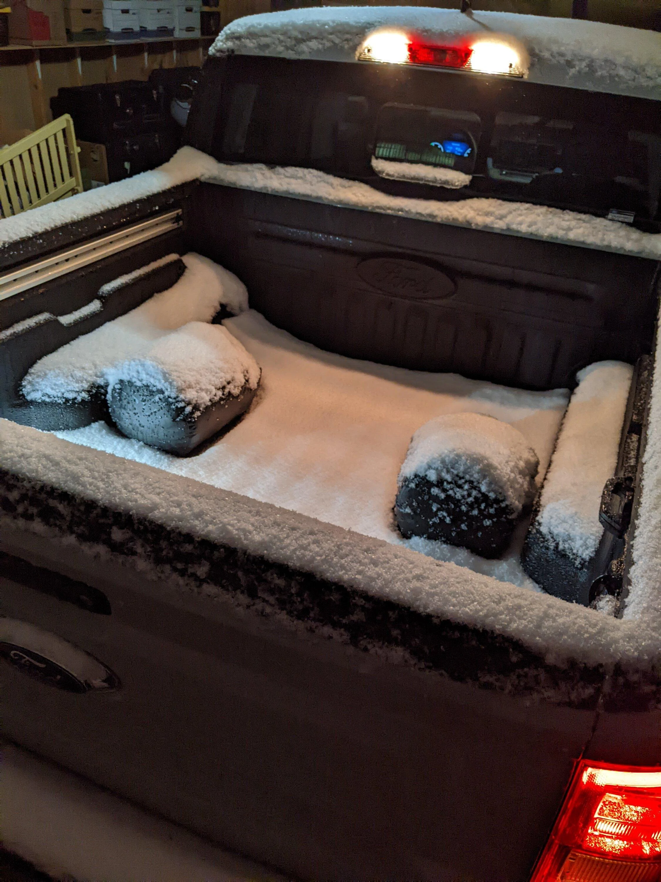

I added two roll top dry bags filled with sand, each 50lbs, right around the rear axles after a couple weeks with the snow and ice here in ND. I've been driving with them for at least a month and I don't know about less traction on the front like what was mentioned in this thread, but I definitely noticed it helped the back end be less squirrelly on corners. Just my two cents. I might mess around with scooting them up a bit based on what I read here but, so far so good.
