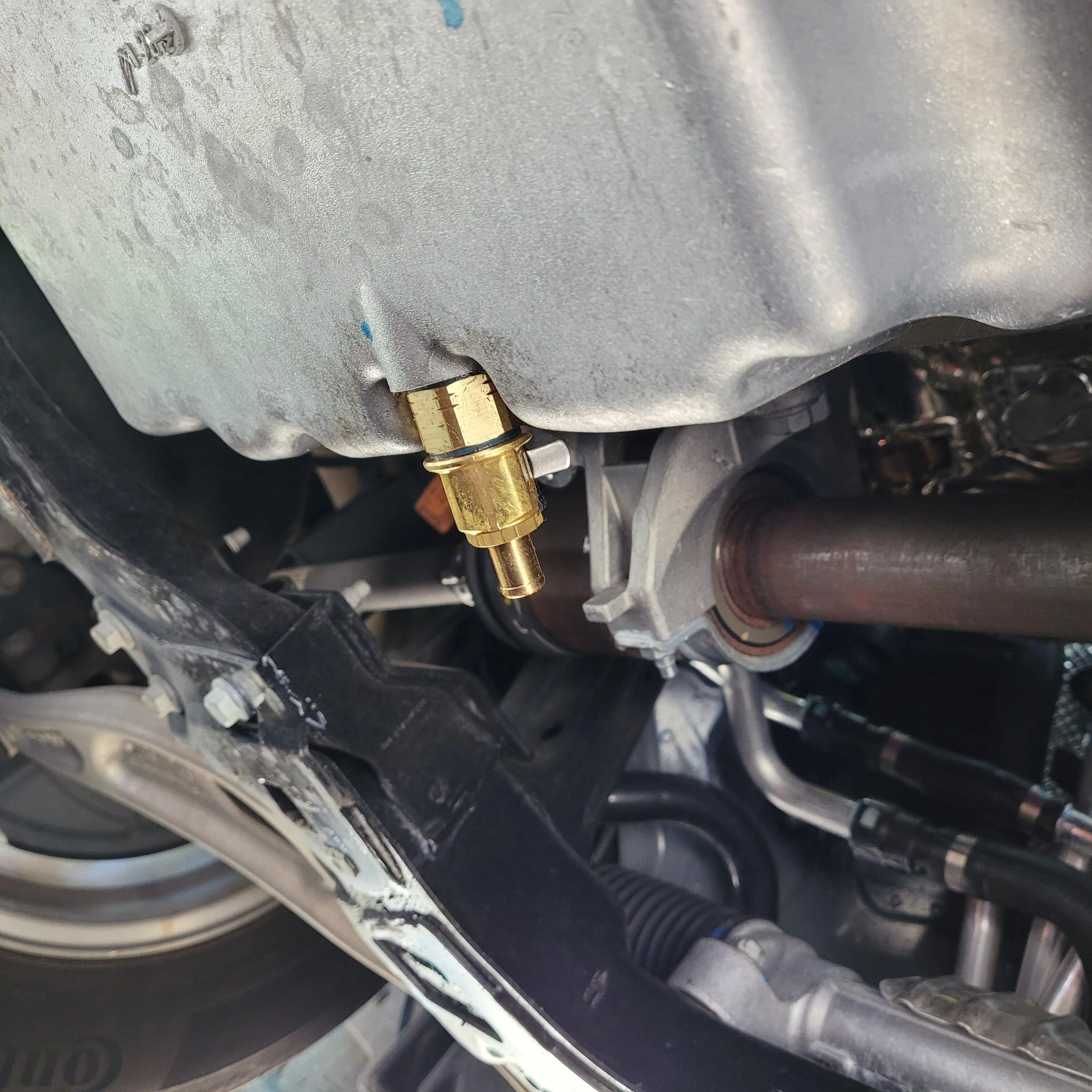

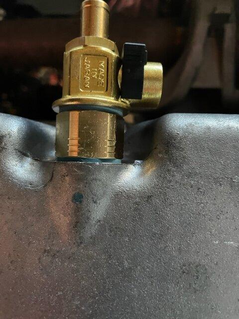

I just completed my second oil change on my Maverick Hybrid and added the Fumoto Oil Drain Valve F137N and the adapter ADP-137 (won't go on without it).

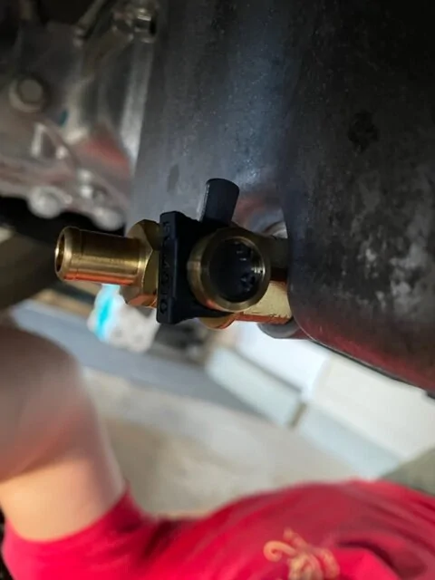

I did too. Another angle to show clearance if anyone is wondering.
Ford Maverick Fumoto drain plug 20220625_114910
And another pic
Ford Maverick Fumoto drain plug 20220625_114829

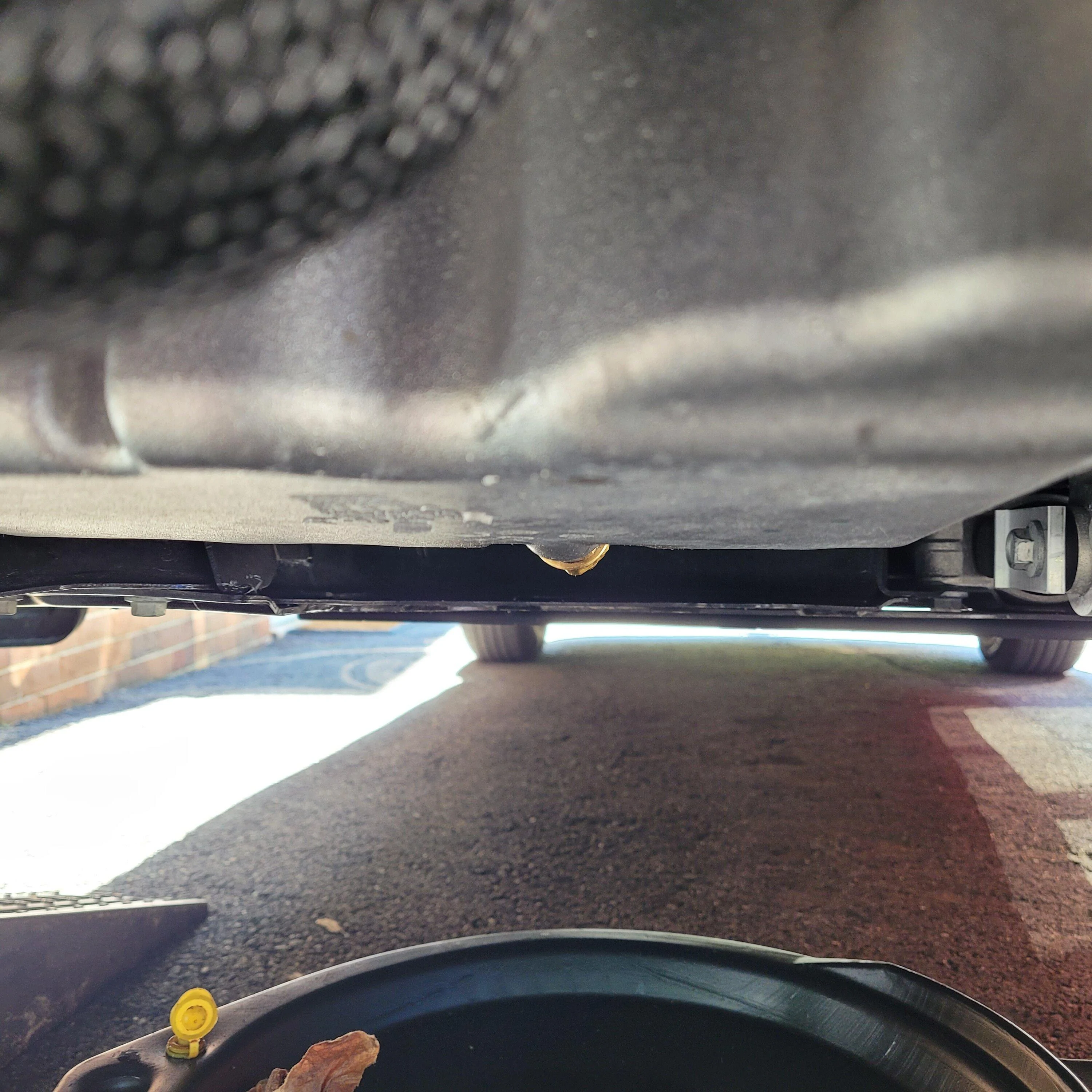

Just did my first oil change since I installed it two months ago. My first FUMOTO drain plug and man, it's the way to go. Makes it so easy and less messy. No splashing with the hose. Still messy dropping the filter though.
Ford Maverick Fumoto drain plug 20220825_095443
Anyway, I was trying to remember what size socket I need for the drain plug. Then I realized, holy crap!!! I don't need that anymore! This is literally the only tool I need now.
Ford Maverick Fumoto drain plug 20220825_104226

Thanks for your information and photos concerning the Fumoto drain valve part numbers including the extension needed. Just ordered from the manufacturer website which recommended the same product numbers. Our Maverick looks just like yours, thanks again!
