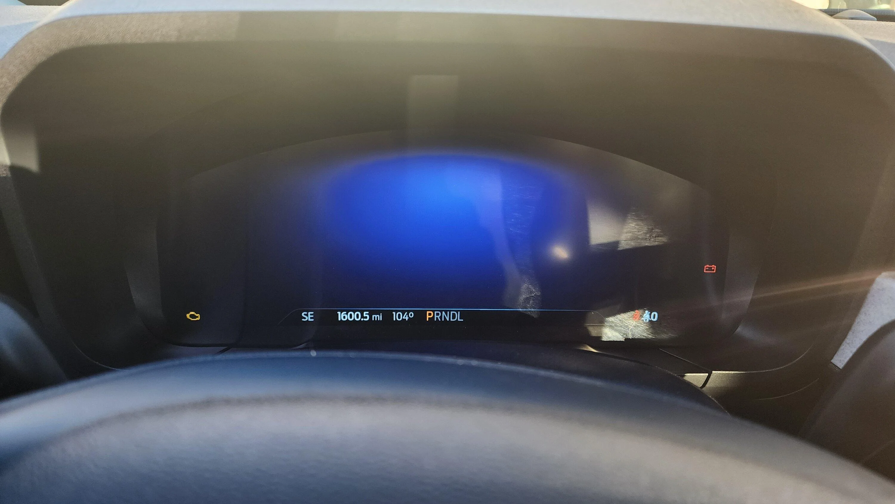

I spent a couple of hours yesterday trying to get things to work, I tried that and for some reason it just doesn't work.
Another problem I have is that non of the gauges appear on screen until I actually start the truck, it only works if I disable the splash screen, but that's something I like and don't want to disable.
Ford Maverick Full digital gauge cluster from Ford Escape swap into Maverick 20230830_181844
I'll keep messing with forscan to see if something works.
