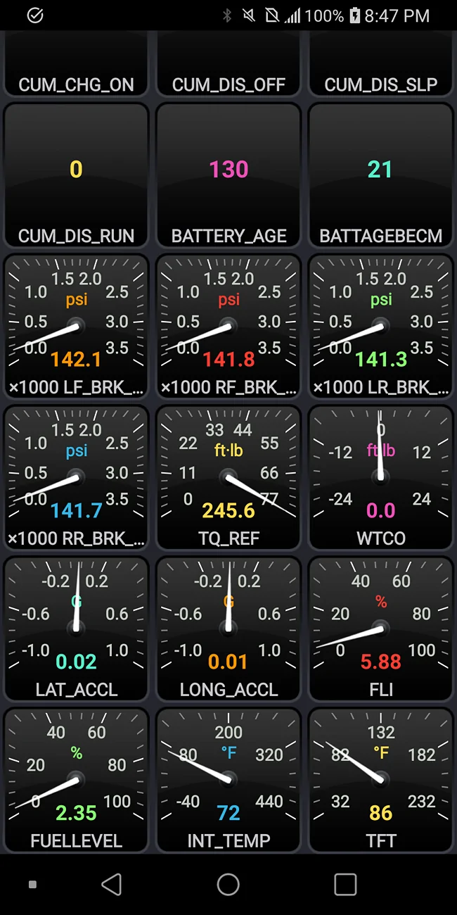

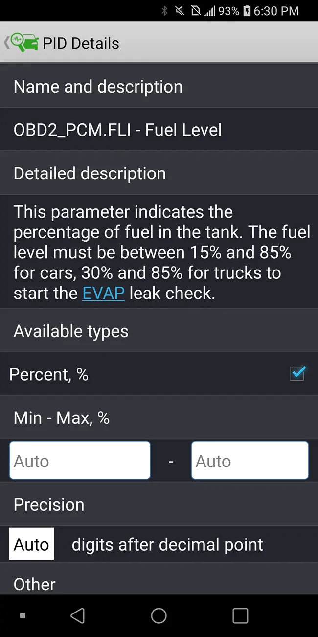

The scanner PID for fuel tank quantity states the testing is ONLY done within the range of 30-85%. Unless the Maverick is considered a car. (who said that!)
There will be no aborts or misreads - as it's not even going to attempt it.
Someone mentioned tank temp before, now, not 72 outside, but returning fuel added to tank - this isn't that high for 2-5% fuel remaining. All the PID's at the end.

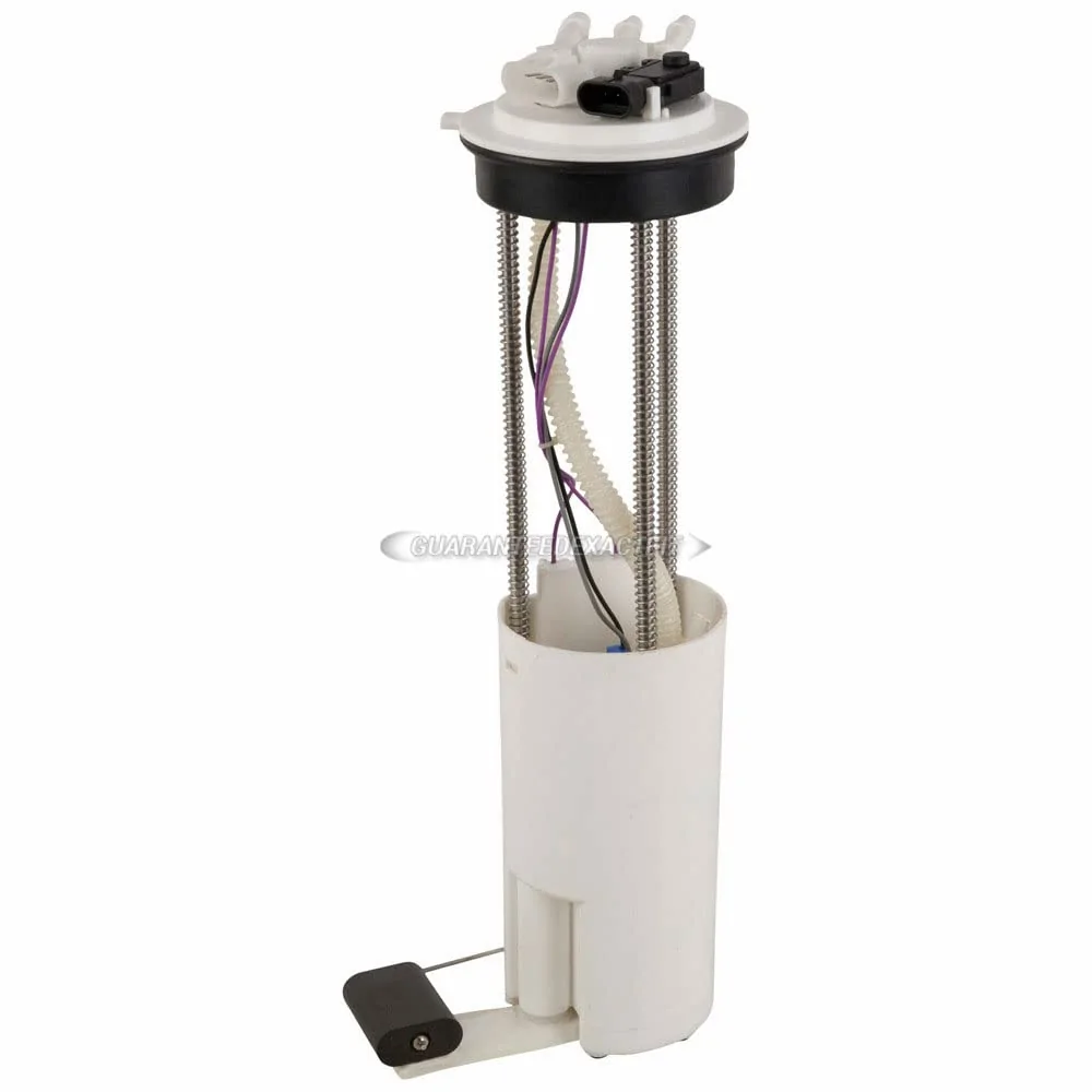

You mean this well?
(upside down in pic)
Negative, the fuel pump assembly includes a small well (about the size of a soda can, typically) that encompasses the fuel pump motor in the fuel pump assembly, and gets removed from the tank with the assembly. Picture is of the S-series pump I am familiar with.

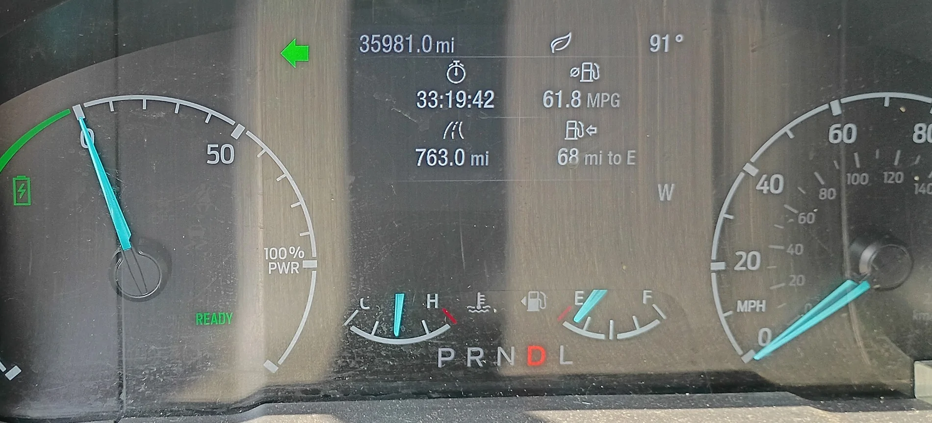

I fill up near empty so I get a clean full tank of gas. Out with the old and in with the new.
You must wait for a "tail wind" to push you around to get that kind of mileage. That's awesome (y)
Unlike his younger days when he had to walk to school uphill both ways - in snow and barefoot mind you
He's earned the right to only drive downhill now.
Great on the MPG!
