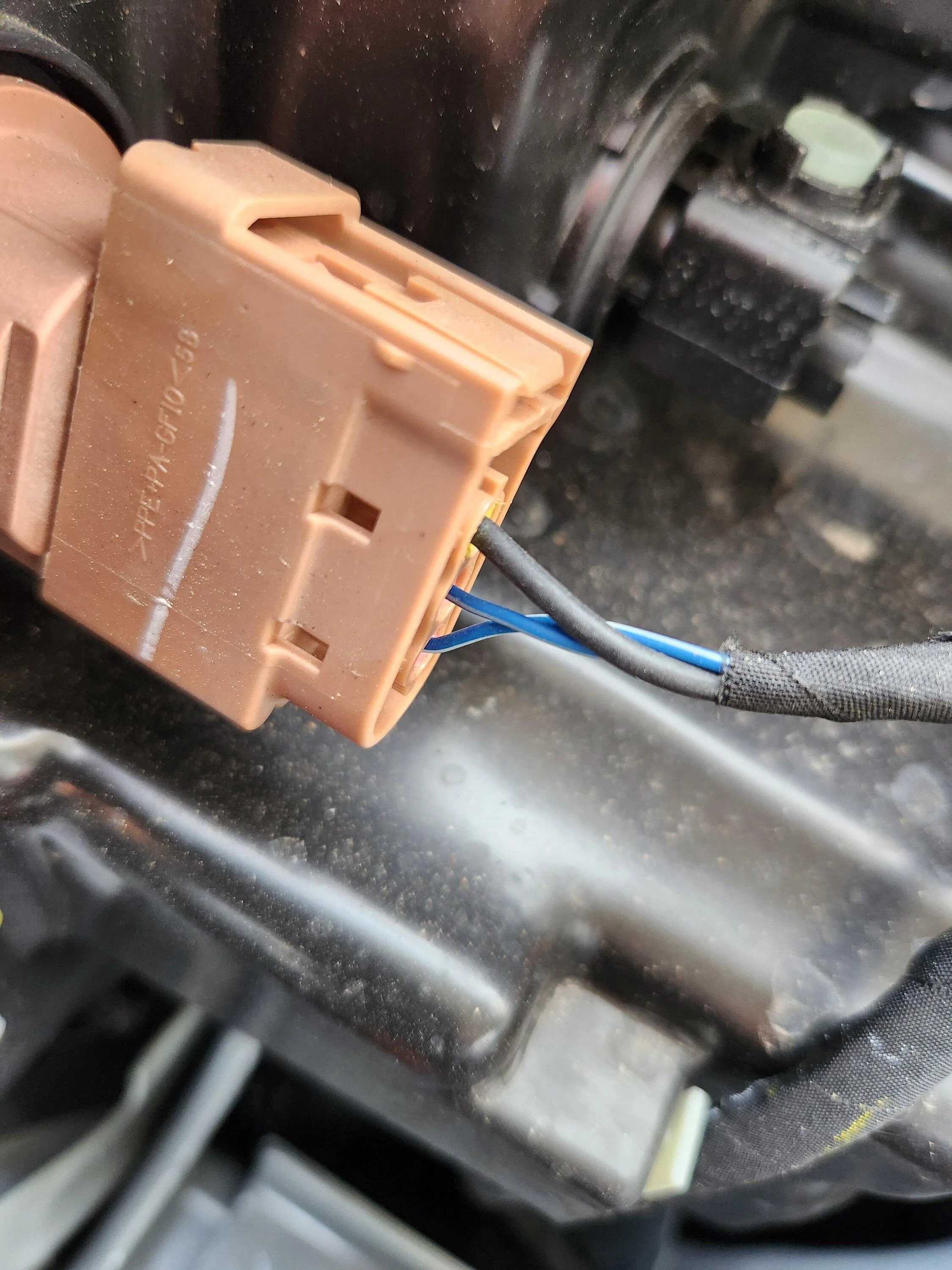

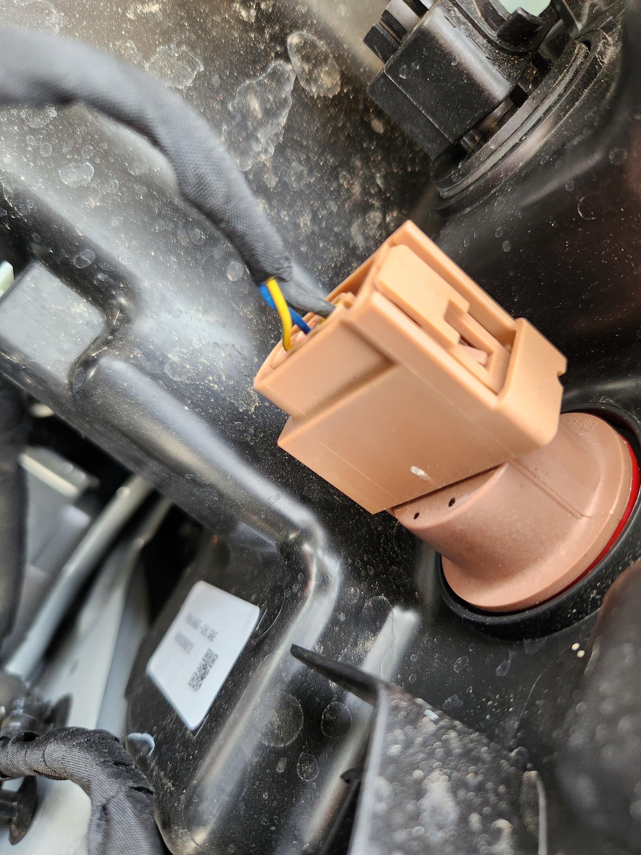

Anyone know the pinout for the front turn signals? Going to tap into these wires for my new light strips.
I'll bet the black wires are ground...
1st pic is Driver's side.
2nd pic is passenger side.
Ford Maverick Front turn signal pinout at lamp connectors 20230101_162807
Ford Maverick Front turn signal pinout at lamp connectors 20230101_162758

Thank you so much!

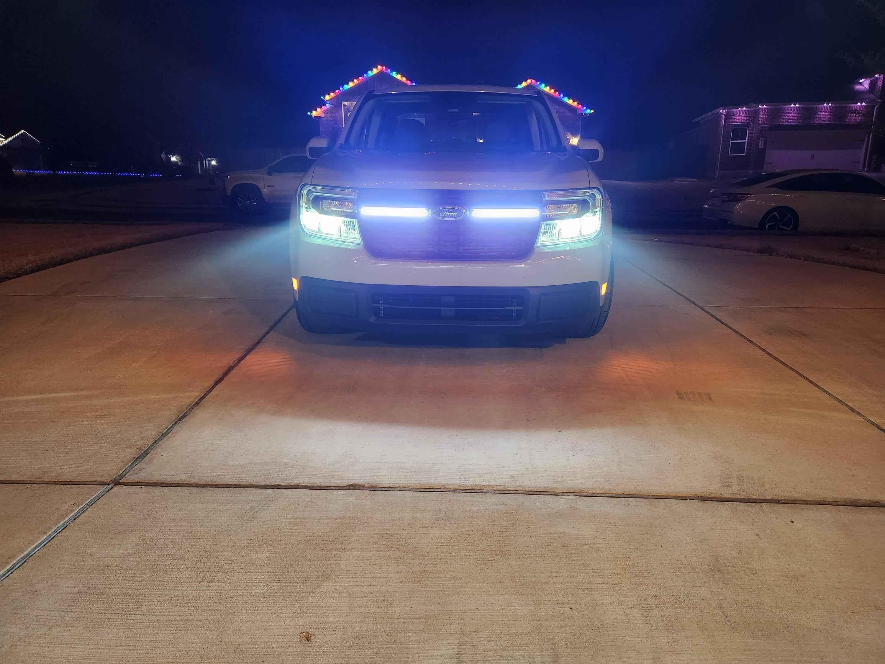

Got the strip lights installed. Don't work unless I unplug the OEM turn signals. Too much load I think. Hopefully they will work with my Lasfit switchback turn signals.
Ford Maverick Front turn signal pinout at lamp connectors 20230102_210859
fossil
ernie
Aug 23, 2020
3,432
5,792
ohio
if you would be so kind, what is the power draw, amps or watts?

Not sure of the specs. These are eBay specials.

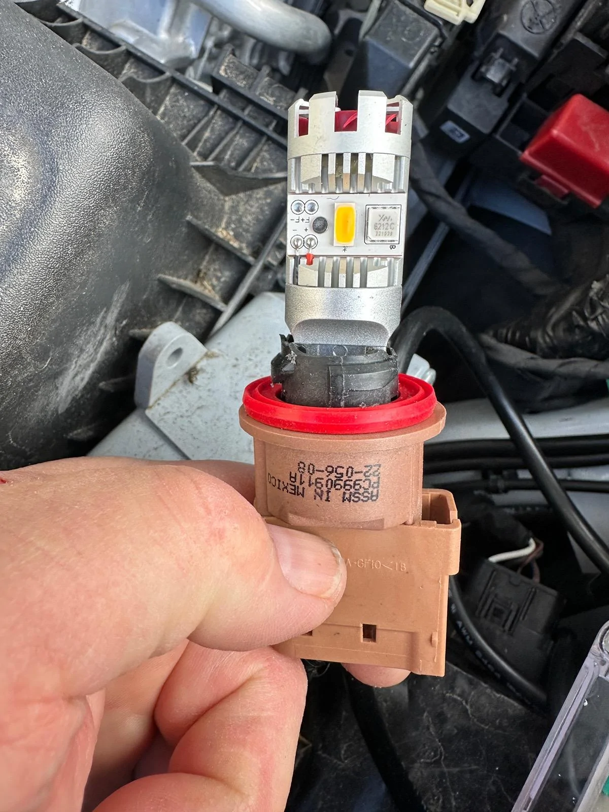

after 8/10 all the lasfit bulbs burned out
SKIP lasfit!
Tech Tye
Ken
Oct 10, 2023
208
174
Kentucky
2023 Maverick

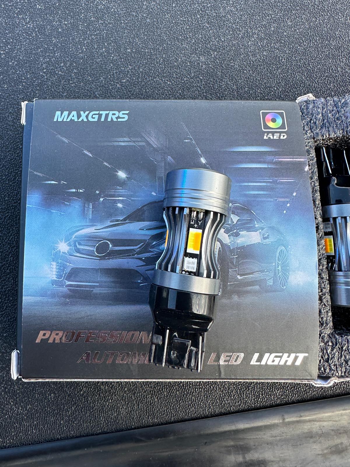

Same here, LAS QUITS. Went with MAXGTRS. My current setup is the amber only as it mates very well with the reflector lens, gives the most uniform output. I couldn’t get the switchback to function on the white side. I tested the bulb on the bench and it works, however the amber give a distorted pattern. I put the straight amber back in . It’s a 7440 base. I did modify my lamp socket so I can put any 7440/7443 style bulb in.
