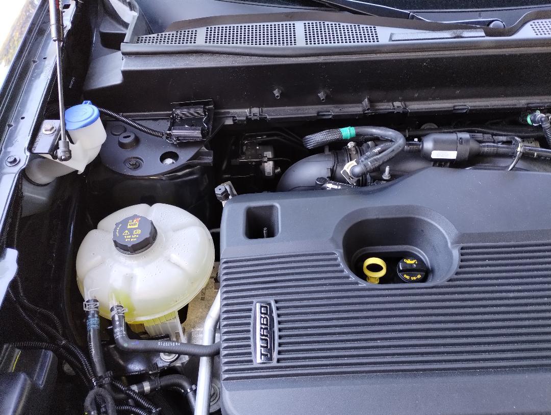

Finally got around to fixing my hyperflash. First off...you cannot put the resistors inline...they need to be run from the + side of the turning signal to any ground which was my original mistake. Plus I needed to put two 4 ohm 50 watt resistors in series to get enough resistance drop to trick my truck. Everything now works okay and the inside flash speed is normal.
I have my Mabett side markers, white front TEMU turn signals, hood led stip and amber backlight fog lights all on when the car is turned on and idling. Front turn signal led Switchbacks are very bright and do not appear to be affected in their brightness by the added resistor circuit wired up. The resistors only come into play when the turn signals are flashing amber (resistors wired into that turn signal wire circuit).
One side note is that the resistors do get hot and I tested them leaving them on for 15 minutes...no issue with heat on the plastic mount I used but I did add another piece of metal to support them and placed a rubber washer between it and the plastic mount. Plastic stays cool to the touch no matter how hot the resistors got. Mounted on strut towers top on both sides.
