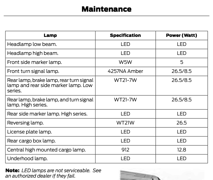

Is anyone able to tell me the size of the front turn signal bulb? Thanks!!
Thank you!4257NA
StandardWhat socket is it? Ck or standard?
