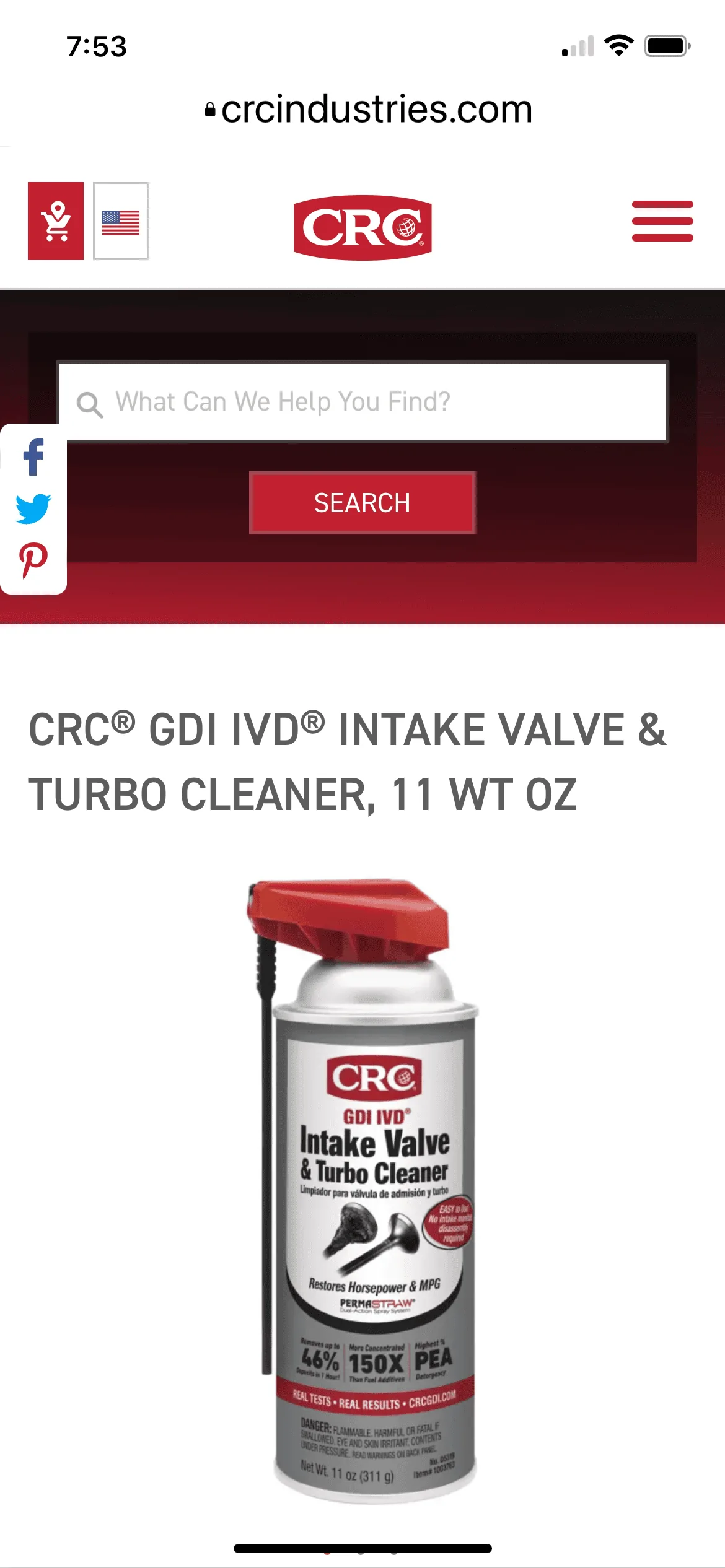

There is, CRC intake valve cleaner

So it seems that having some detergent gas in the intake might keep valves cleaner.
I read somewhere that some current engines use a combination of throttle body and direct injection. Maybe Ford needs to sell a magic fluid To spray intakes at every oil change.
I believe Ford has dual injection on their 2.7 and larger engines so far. This technology has apparently solved the carbon build up problem. I know Toyota, Hyundai/KIA, and higher end vehicles also are now using some version of this solution to the carbon problem. Too bad the EB 2.0 still does not have it, the Santa Cruise does. If you have direct injection only, you would still need access to your intake valves directly to Garner any real help from a valve solvent cleaner. A fuel additive for this is of little value.
