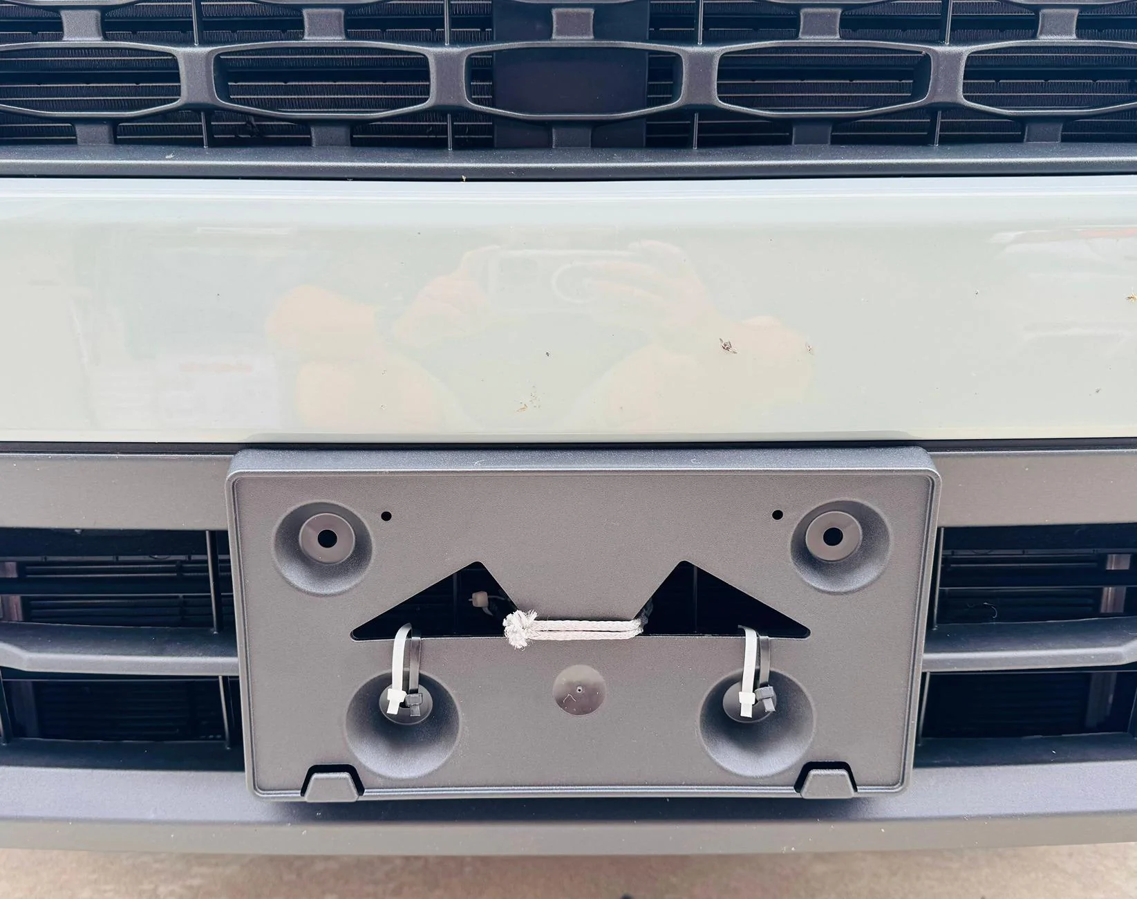

My install without drilling into the front bumper.
Not for nothing and it will likely never hurt, but that does cover part of your cooling system.

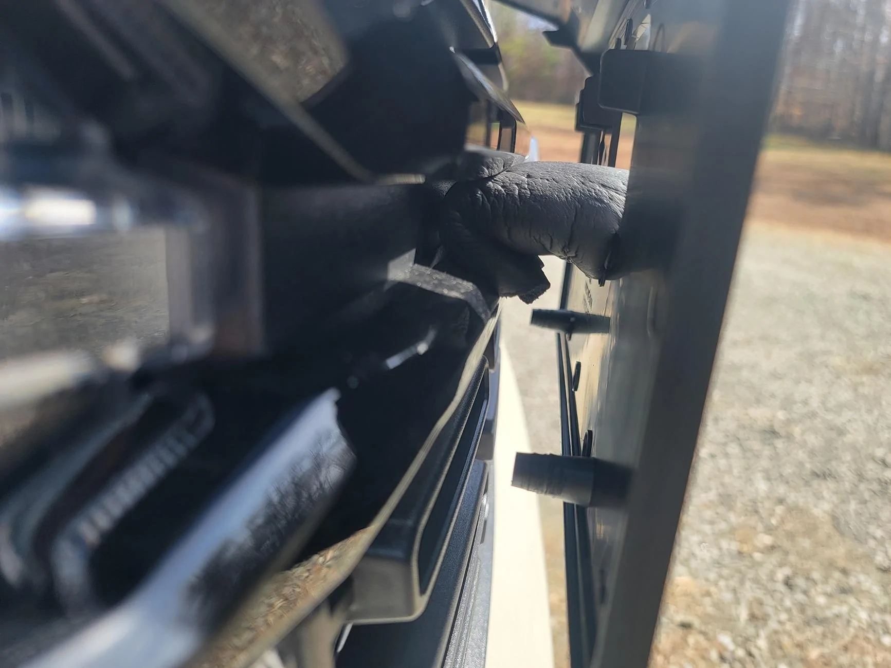

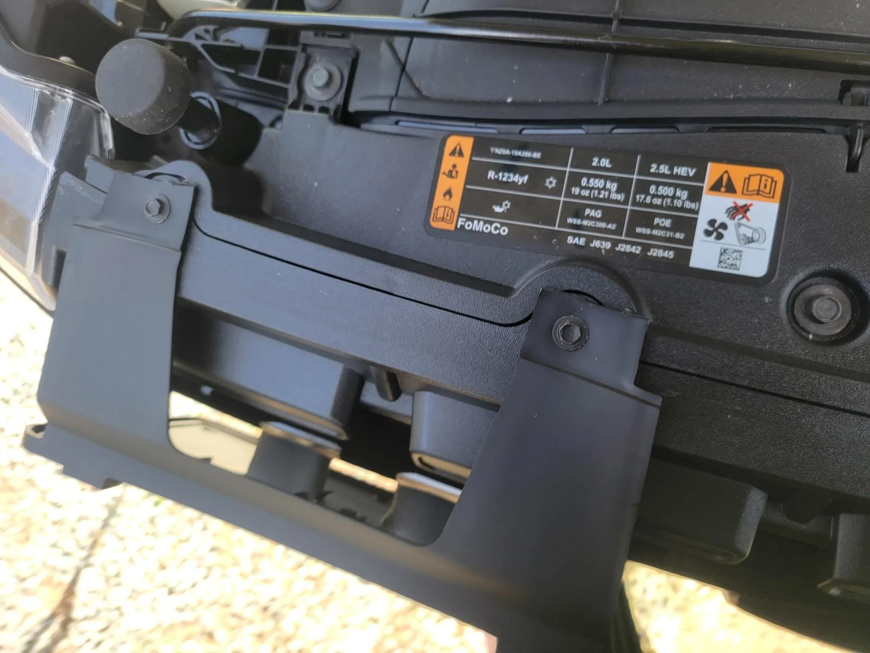

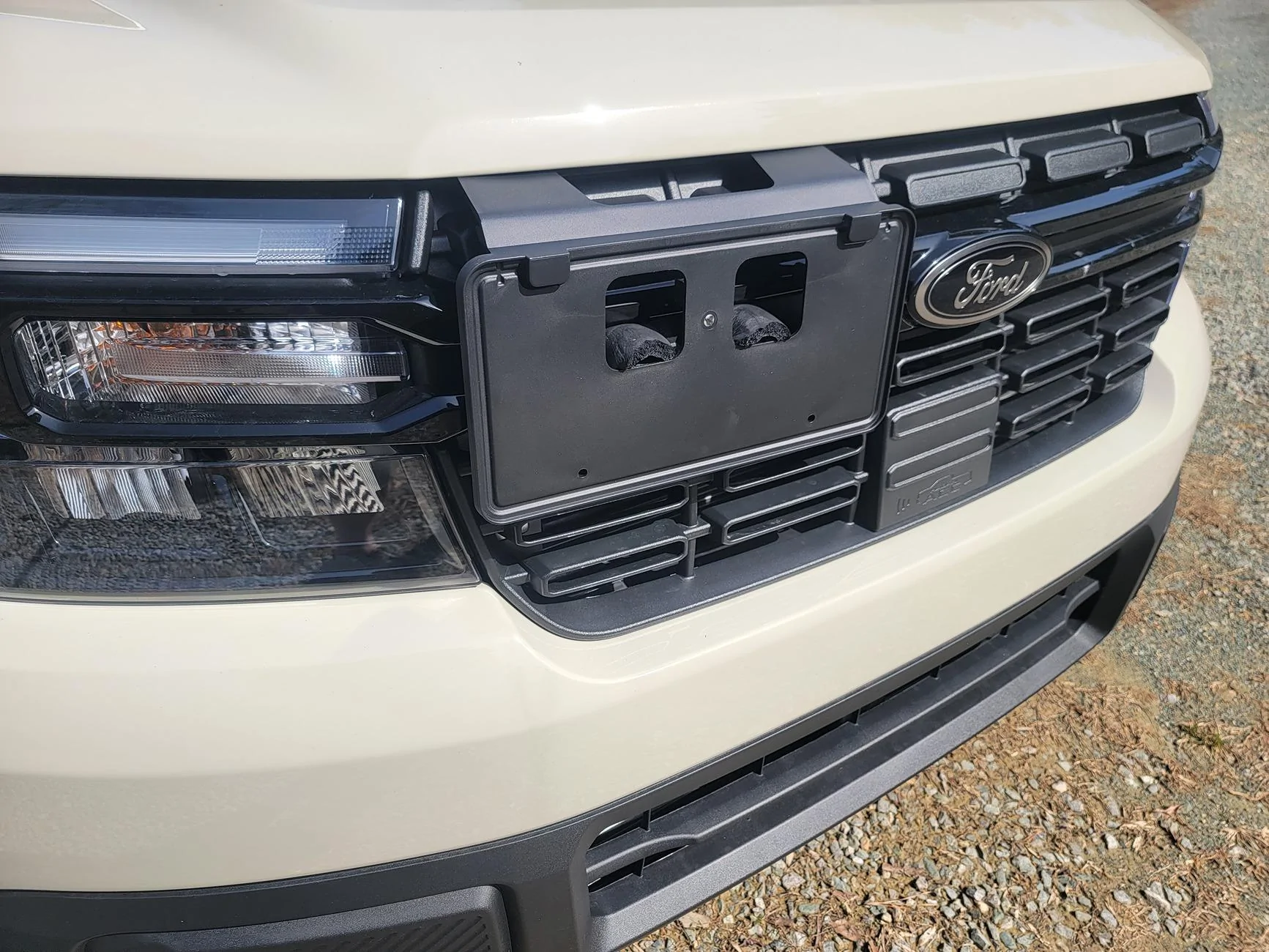

I got a cheap Amazon F150 and mounted it to the shroud. Easy as: trim one hole on mount, unscrew, place, re-screw.
