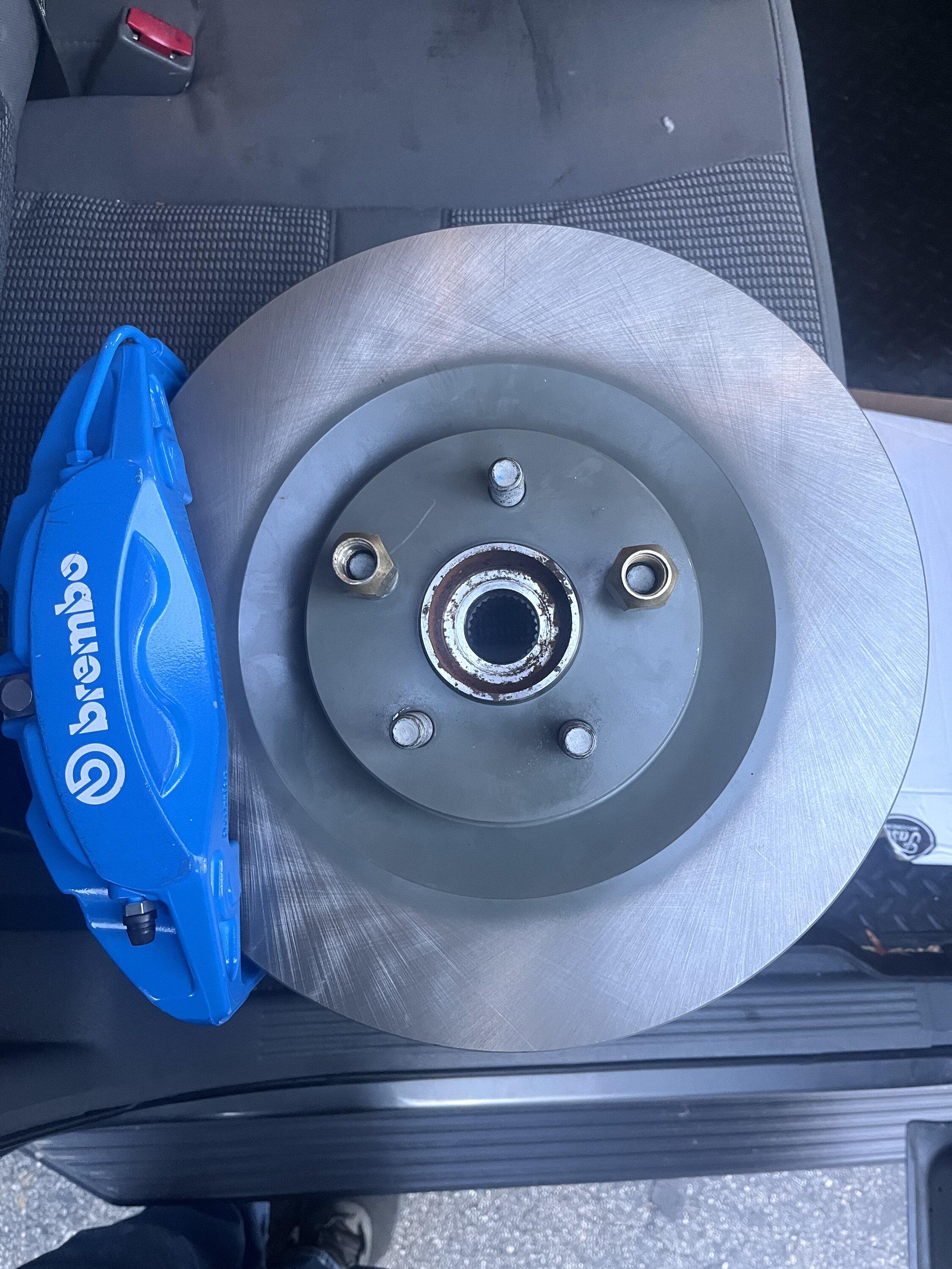

Herr are some mock up pictures. The rotor fit perfectly, I was afraid the studs would be thicker and need to drill out holes but it’s a perfect fit. The calipers are held in with only one bolt in the picture so actual fitment position will be perfect once brackets are done.

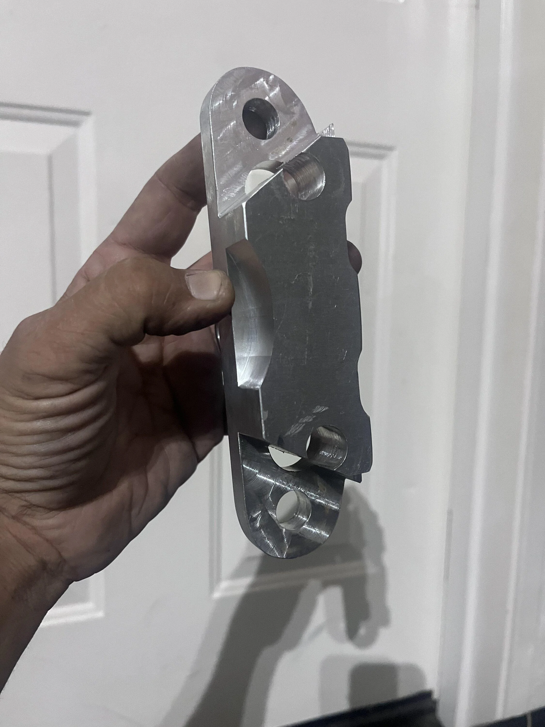

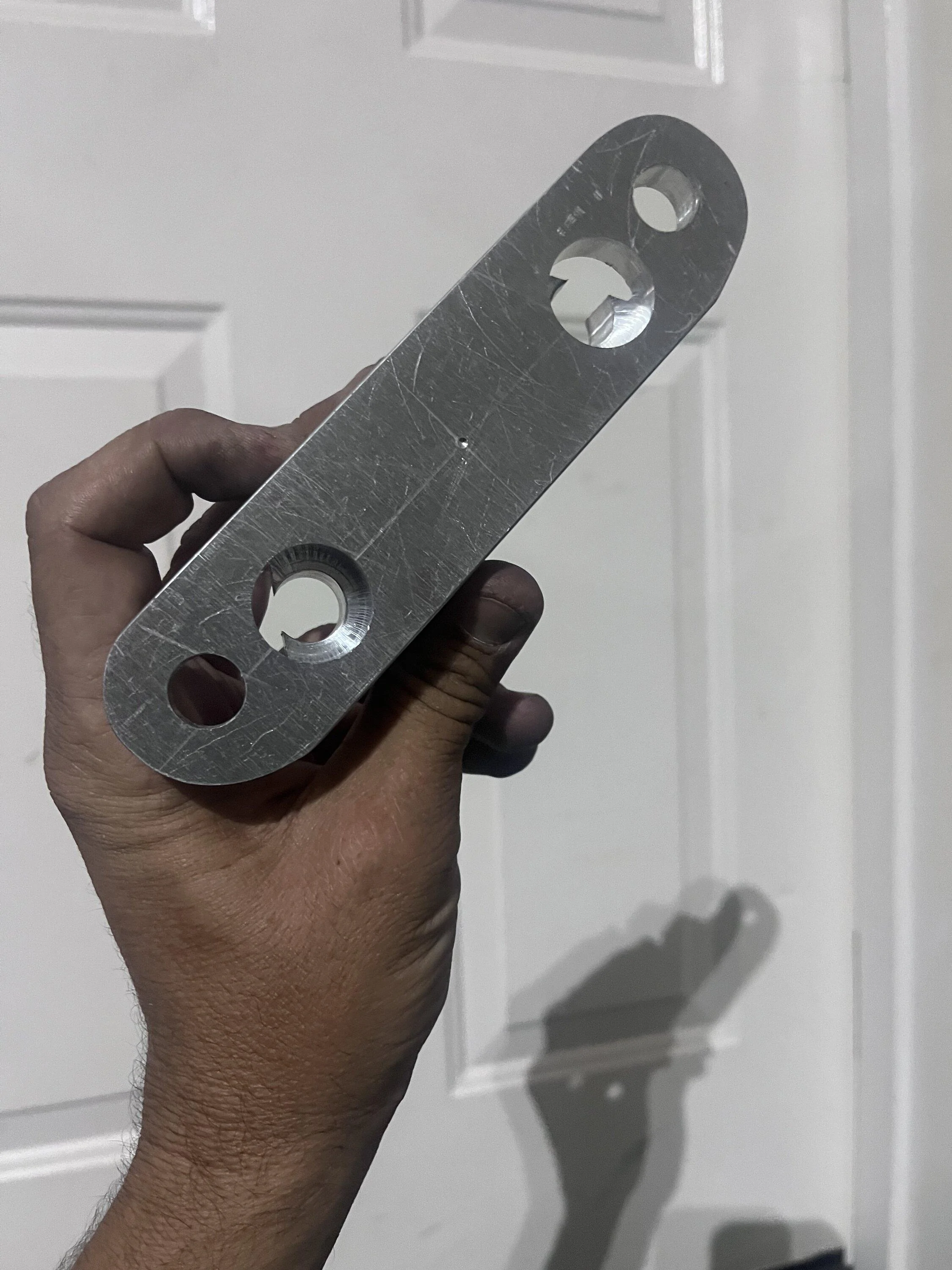

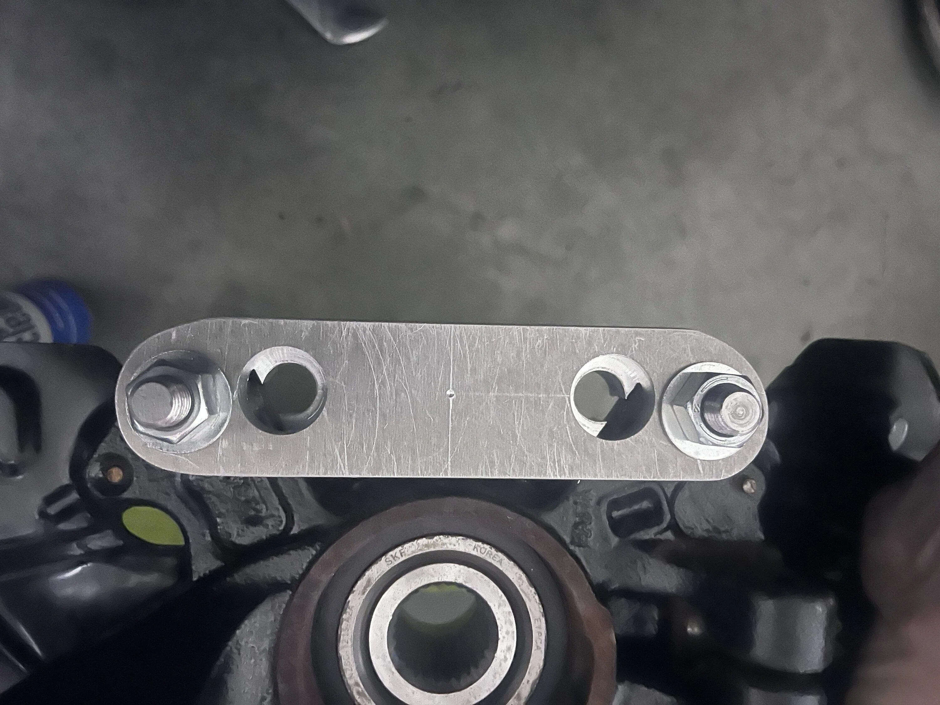

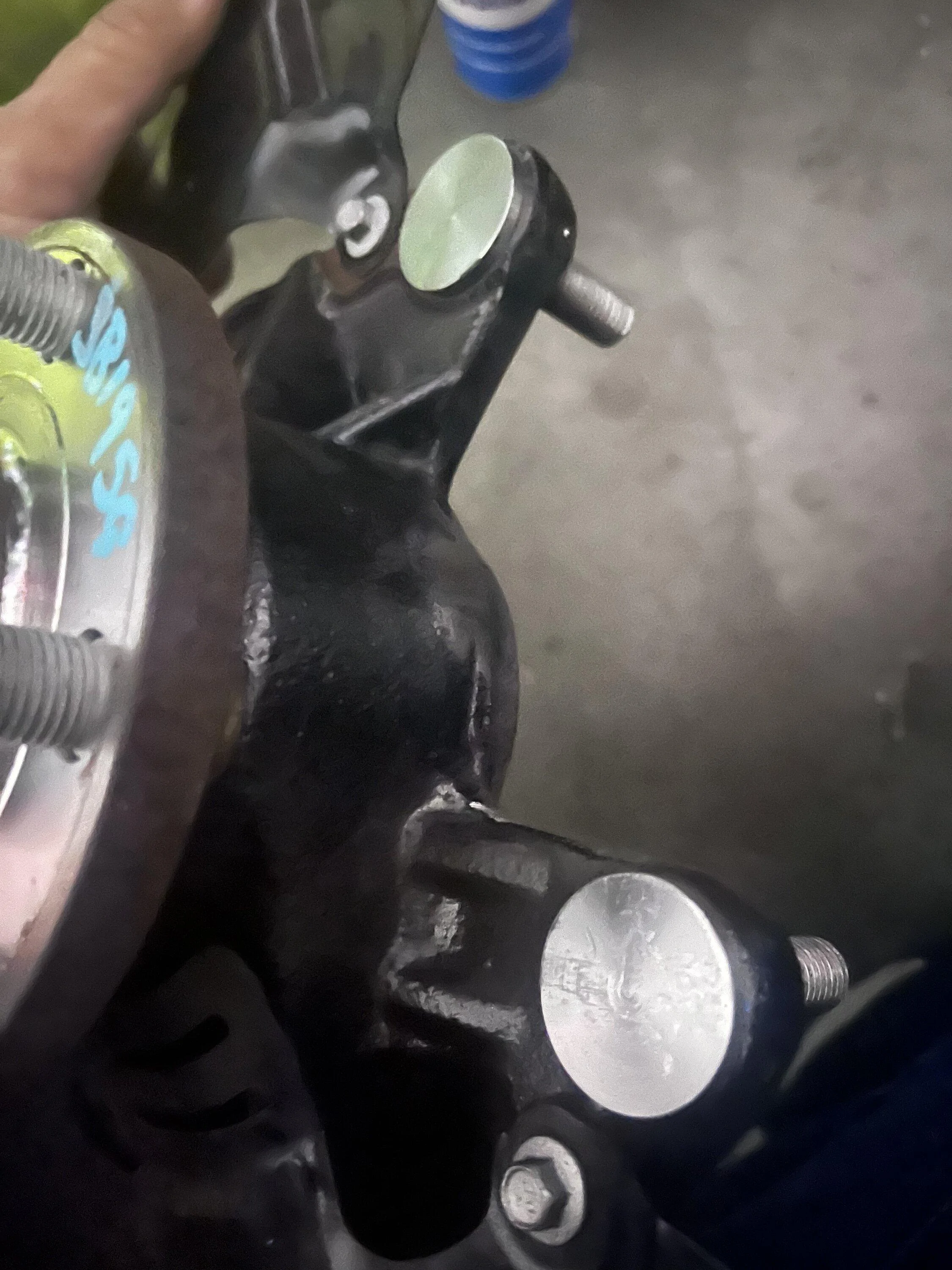

Just got the first prototype so we’re one step closer. I need to install to make sure everything clears before he makes the other side. Then I will test them out while I get quotes to manufacture them. My builder is a retired Mechanical Engineer who worked at Rocketdyne for 40 years so I know some thought went into this. So here are the pictures of the rough prototype.

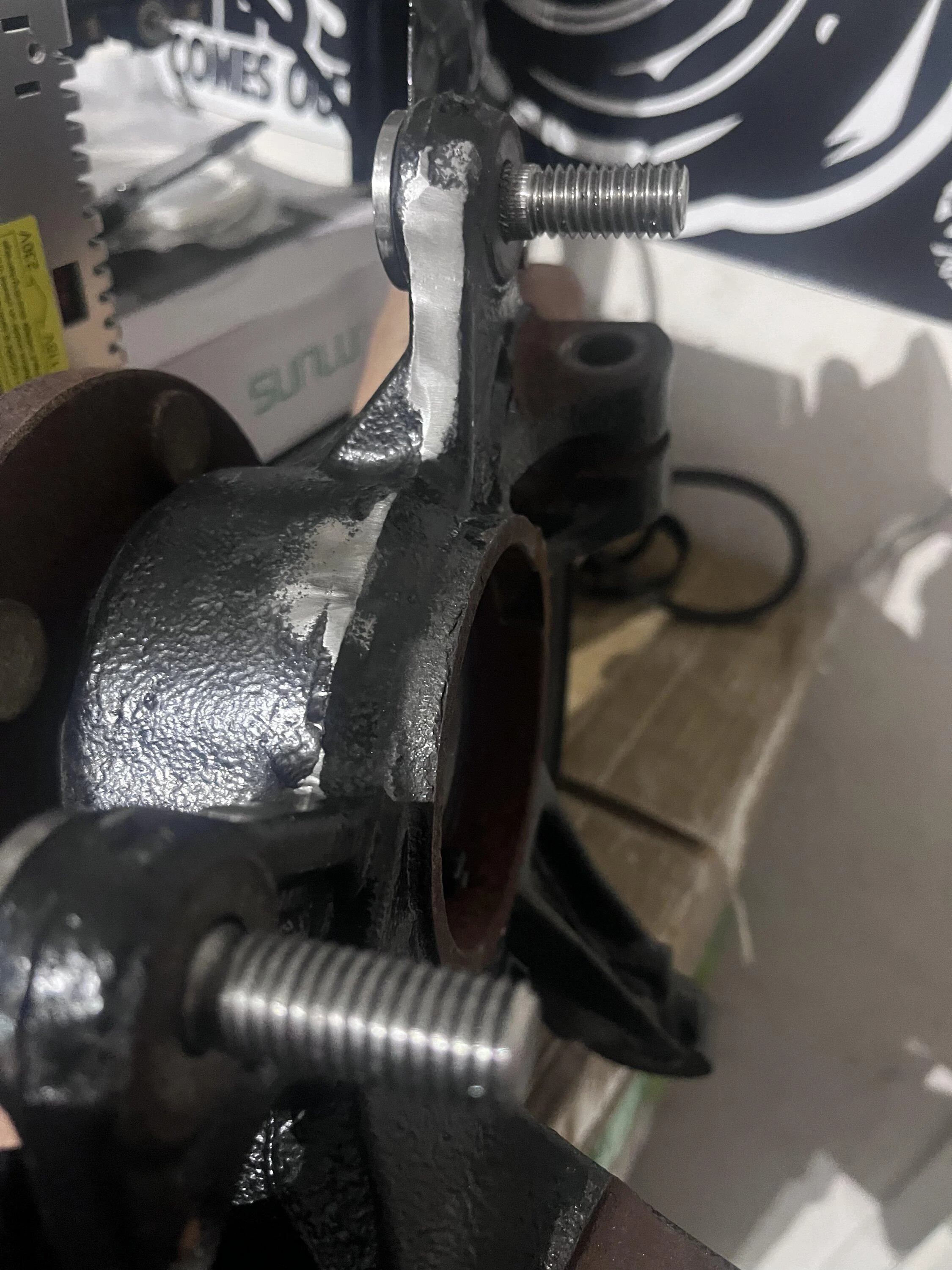

unfortunately these 2 bolts need to be pressed into the spindle so they are secure. It’s a small inconvenience I’ll take any day for safety. He wouldn’t do it any other way and I’ll take his word.
Ford Maverick Front Brembo Brakes Kit coming soon D1993749-A9A1-4FE3-A133-DC9B623B299B
Once pressed in they aren’t going anywhere
Ford Maverick Front Brembo Brakes Kit coming soon 6C8F4141-C6F9-4ED6-8739-61C0CC1D2B9B
This is what he called a very rough prototype lol. He has over 12 hours into this project.

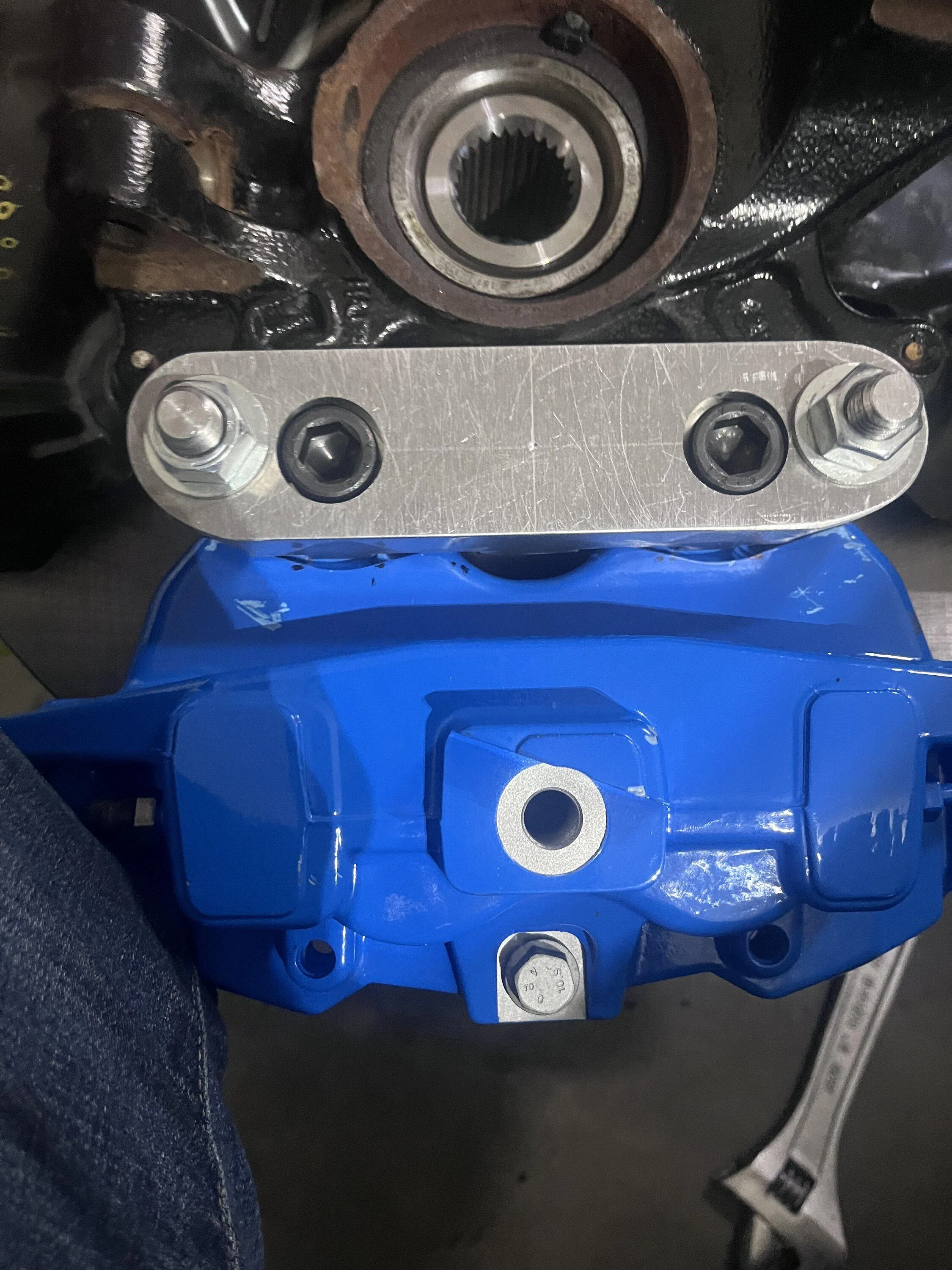

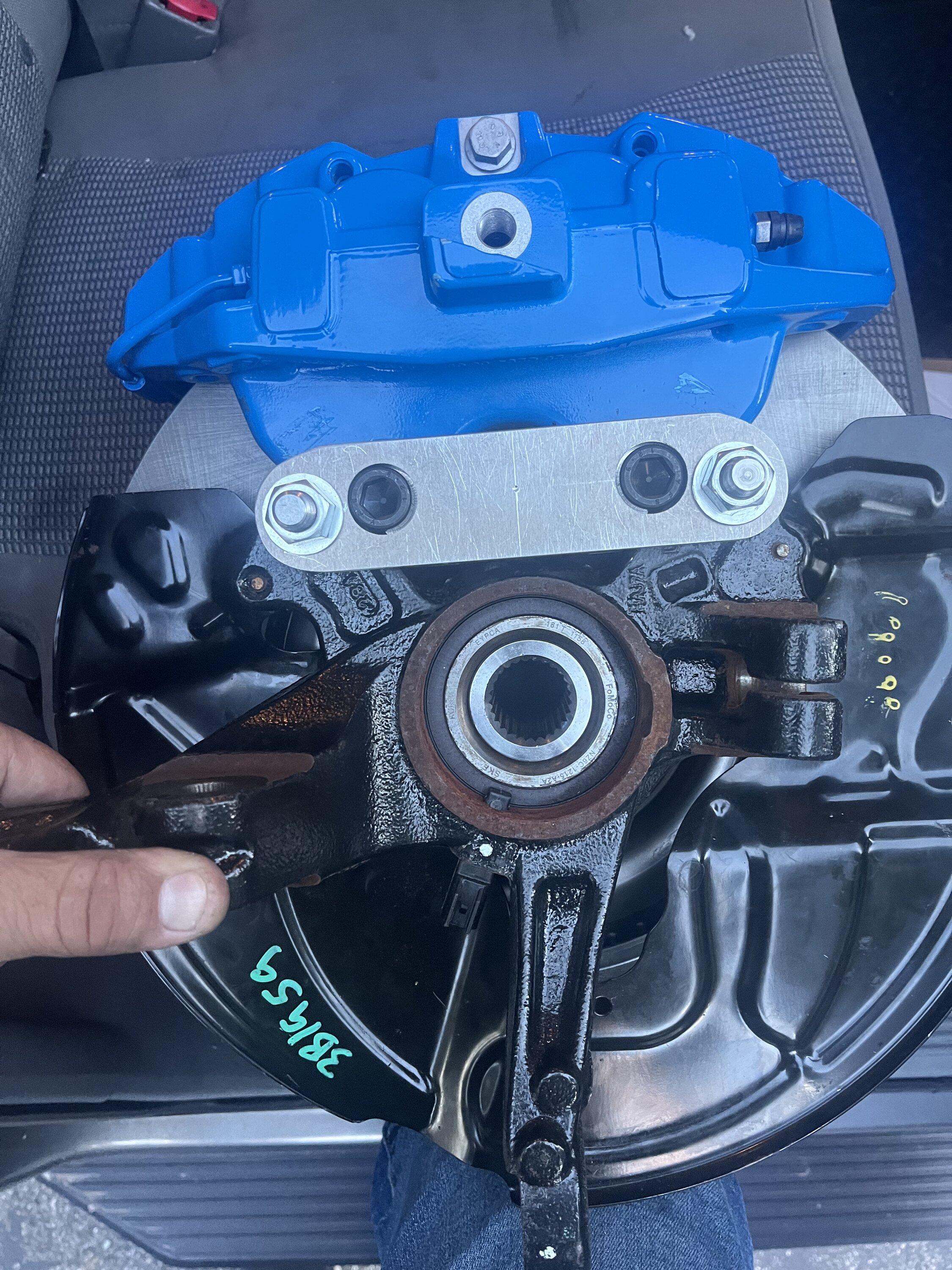

bracket mounted on spindle with 19mm nuts.
Ford Maverick Front Brembo Brakes Kit coming soon FED22984-EE93-405C-9FCD-D48AA0D8BD70
Then you slide in caliper and attach with 2 hex bolts.
This is far from done as i have to test fit, then drive for a while to make sure all works. I’ll get quotes for the finished product during that time. I will only be selling the bracket and brake lines.

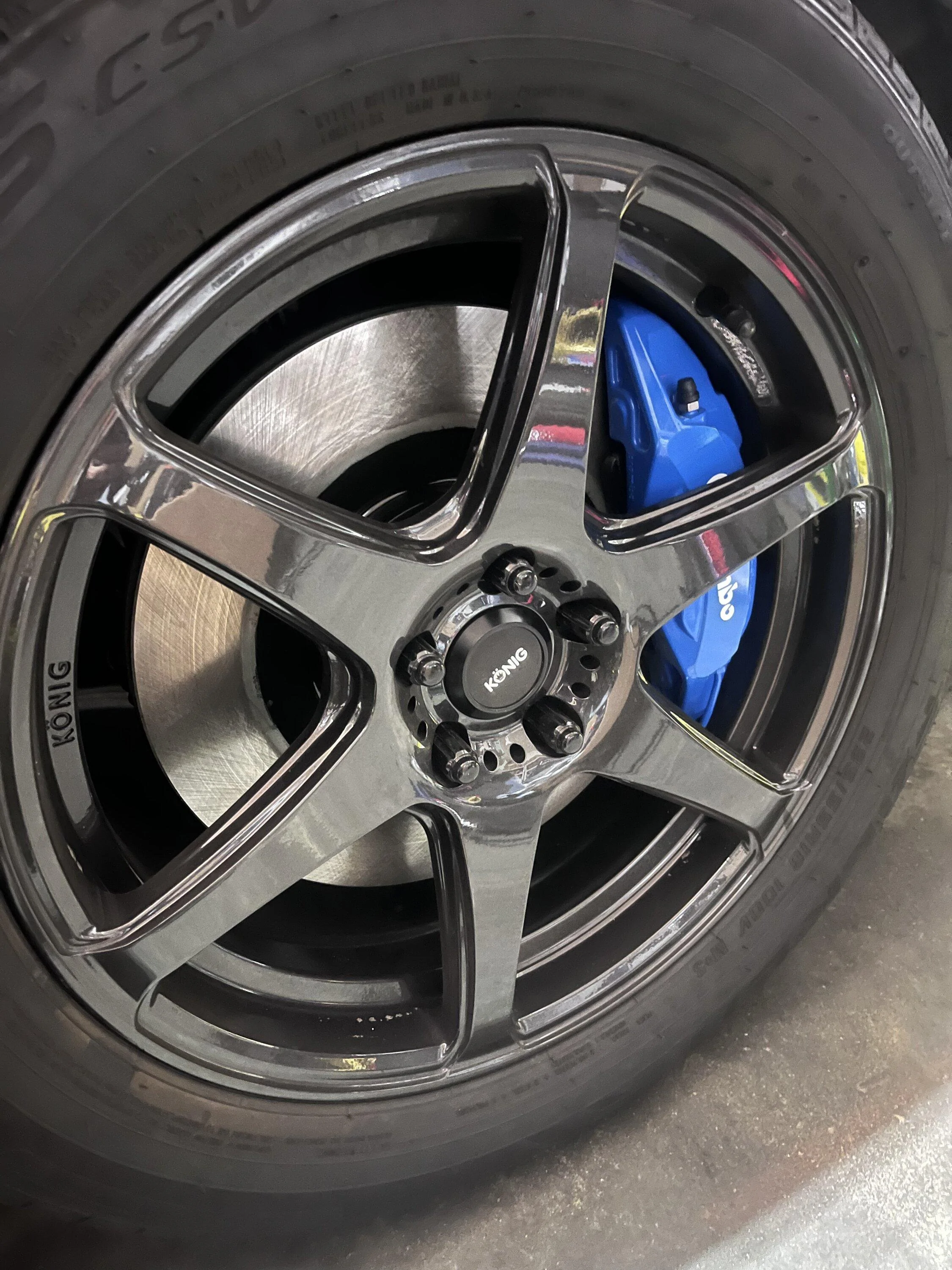

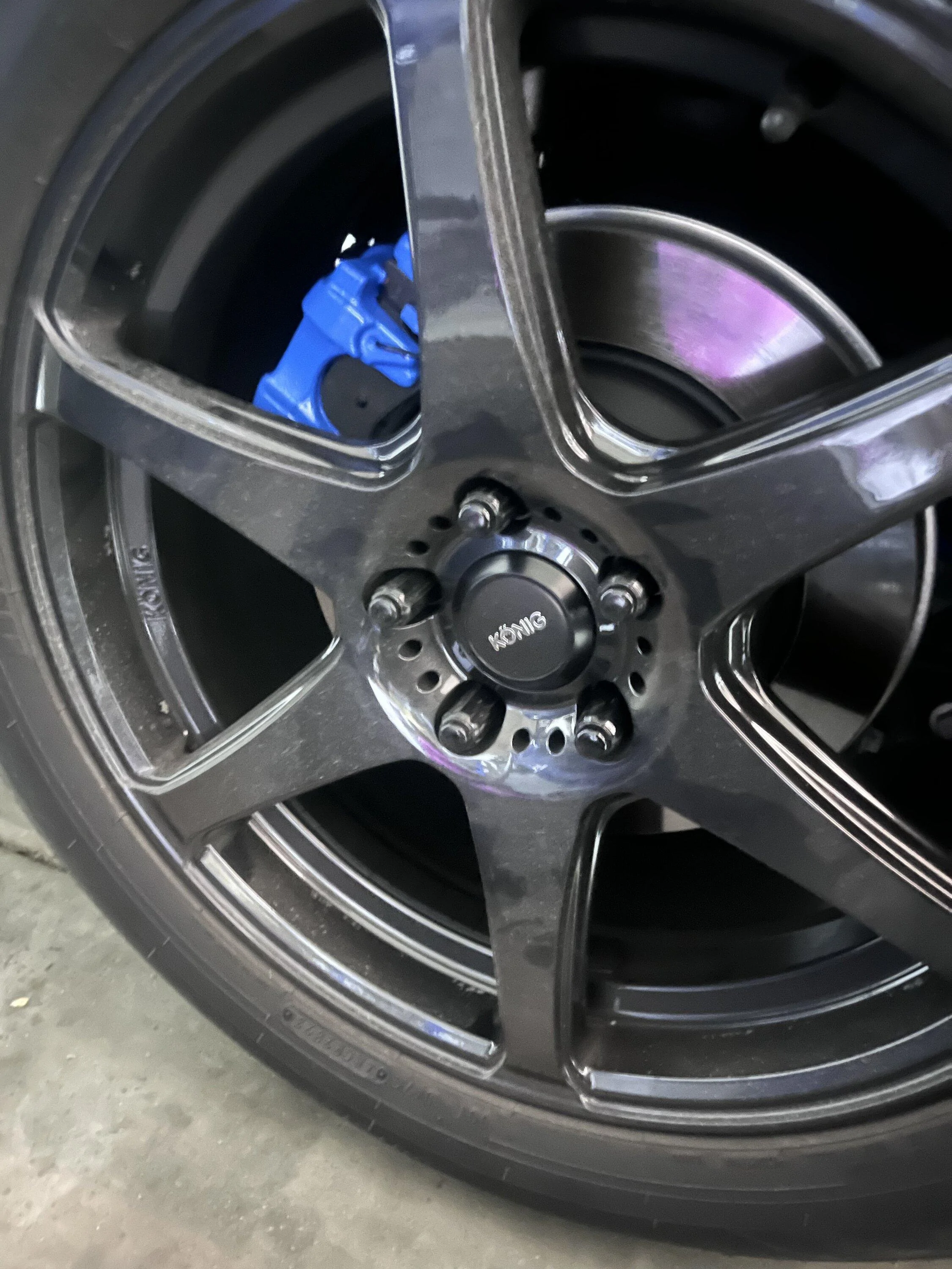

Just a follow up, I’ve been running these for a few weeks now and they are great. Pedal feel is the same as stock but stopping is greatly improved. Brake bias is a non issue as well. The final brackets will be done and available soon. You will have to machine them calipers and the spindle needs minor notching. Otherwise the install is 45 minutes tops. Since the rears remain stock I painted them to match the fronts.
