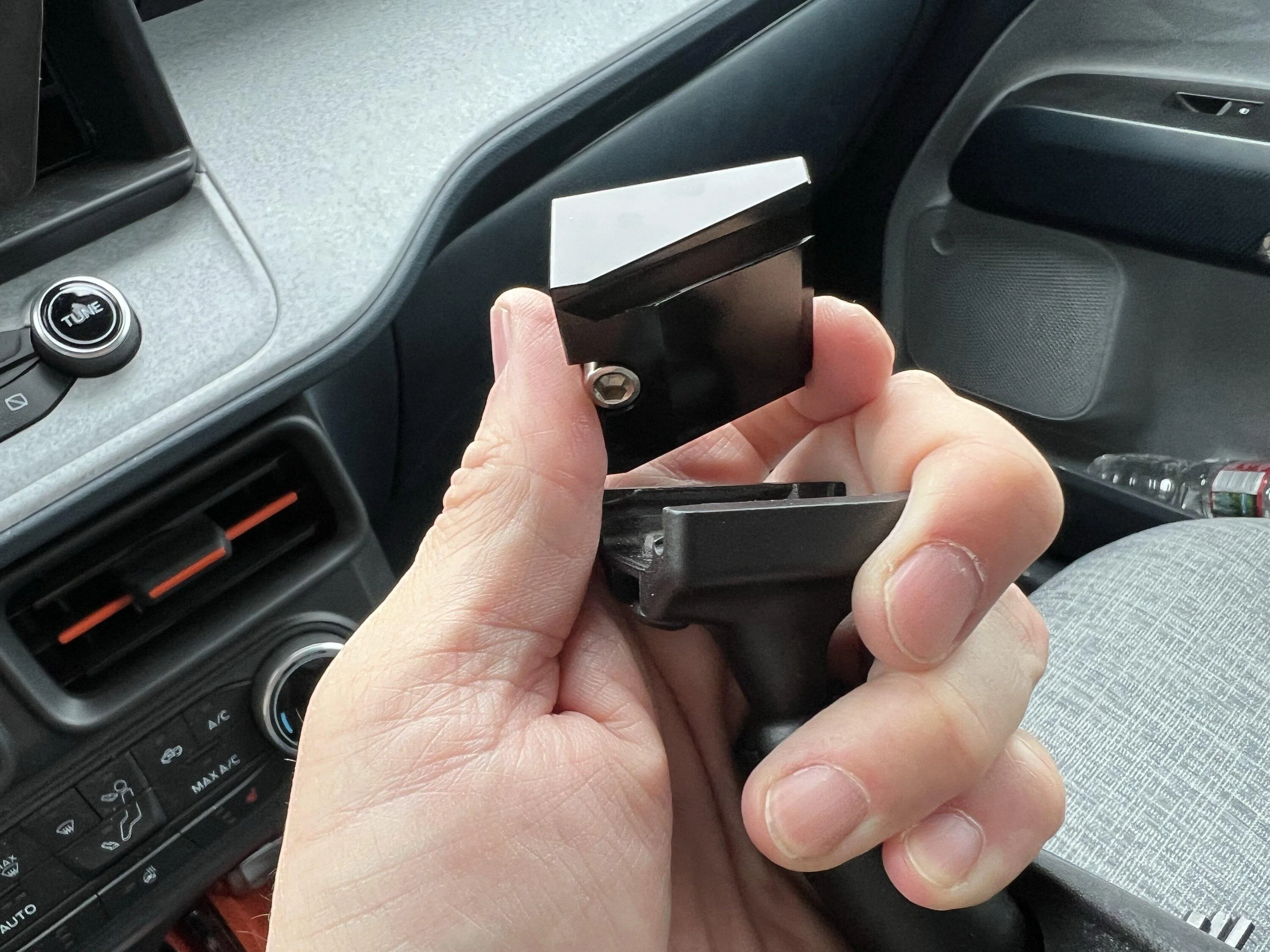

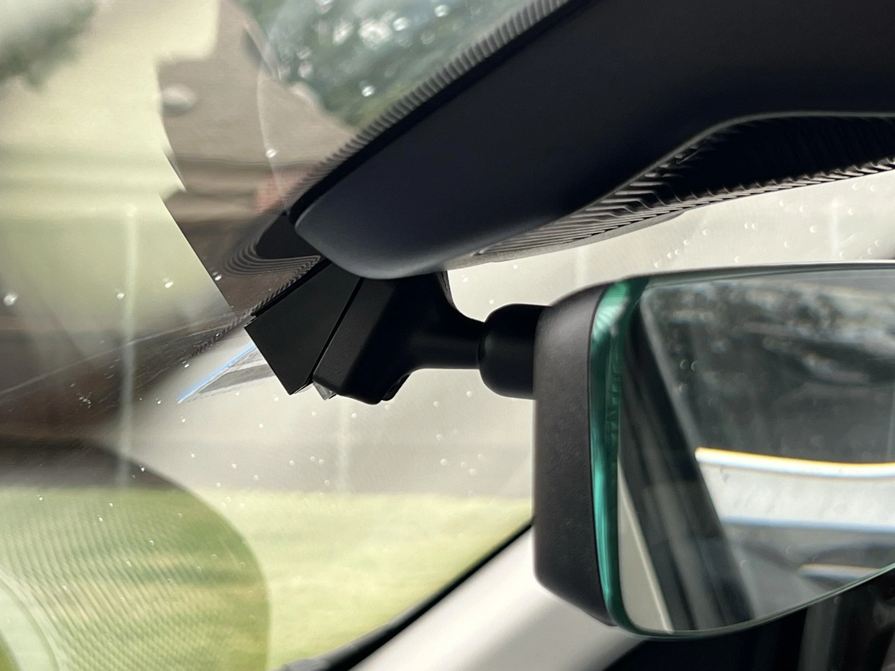

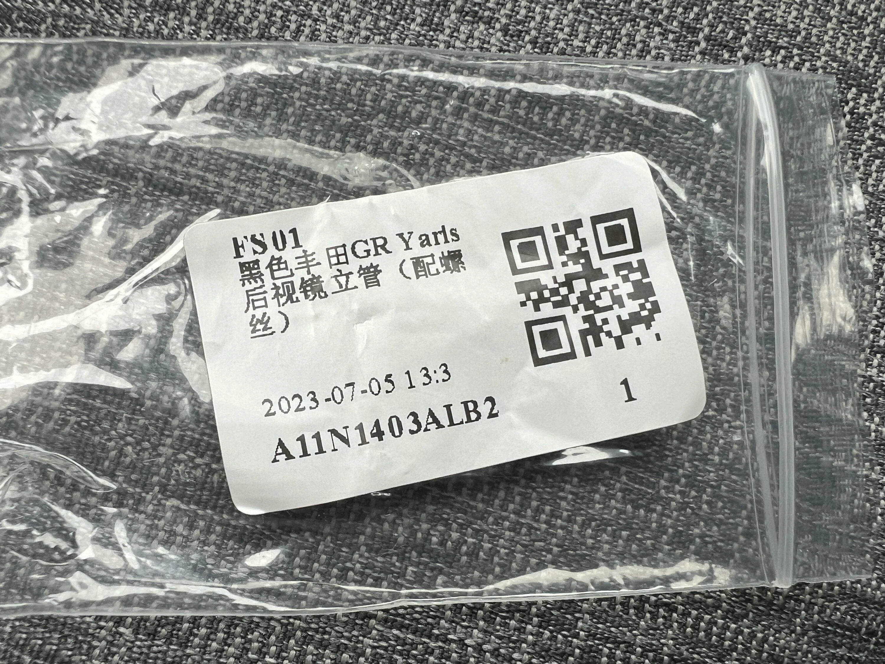

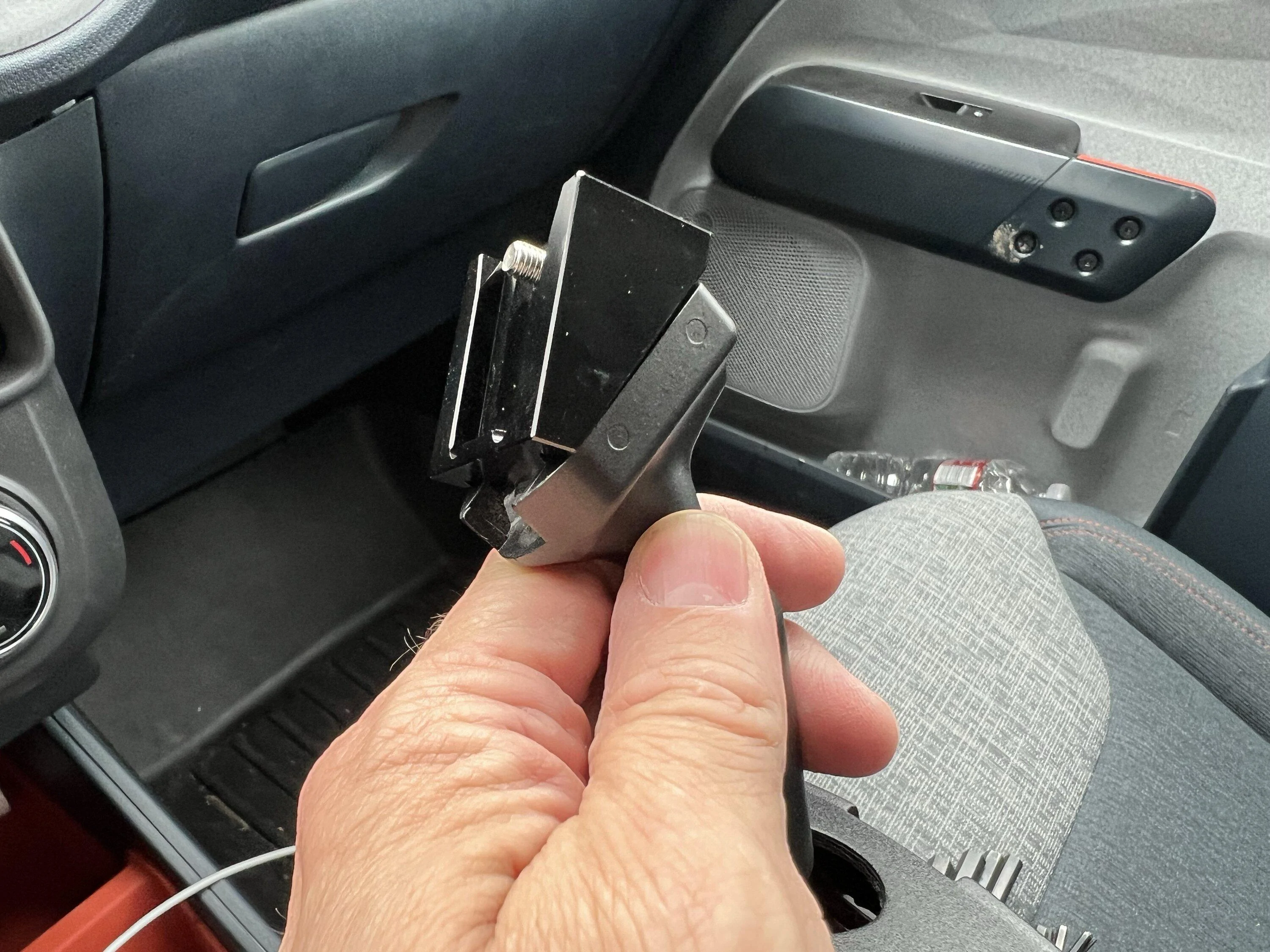

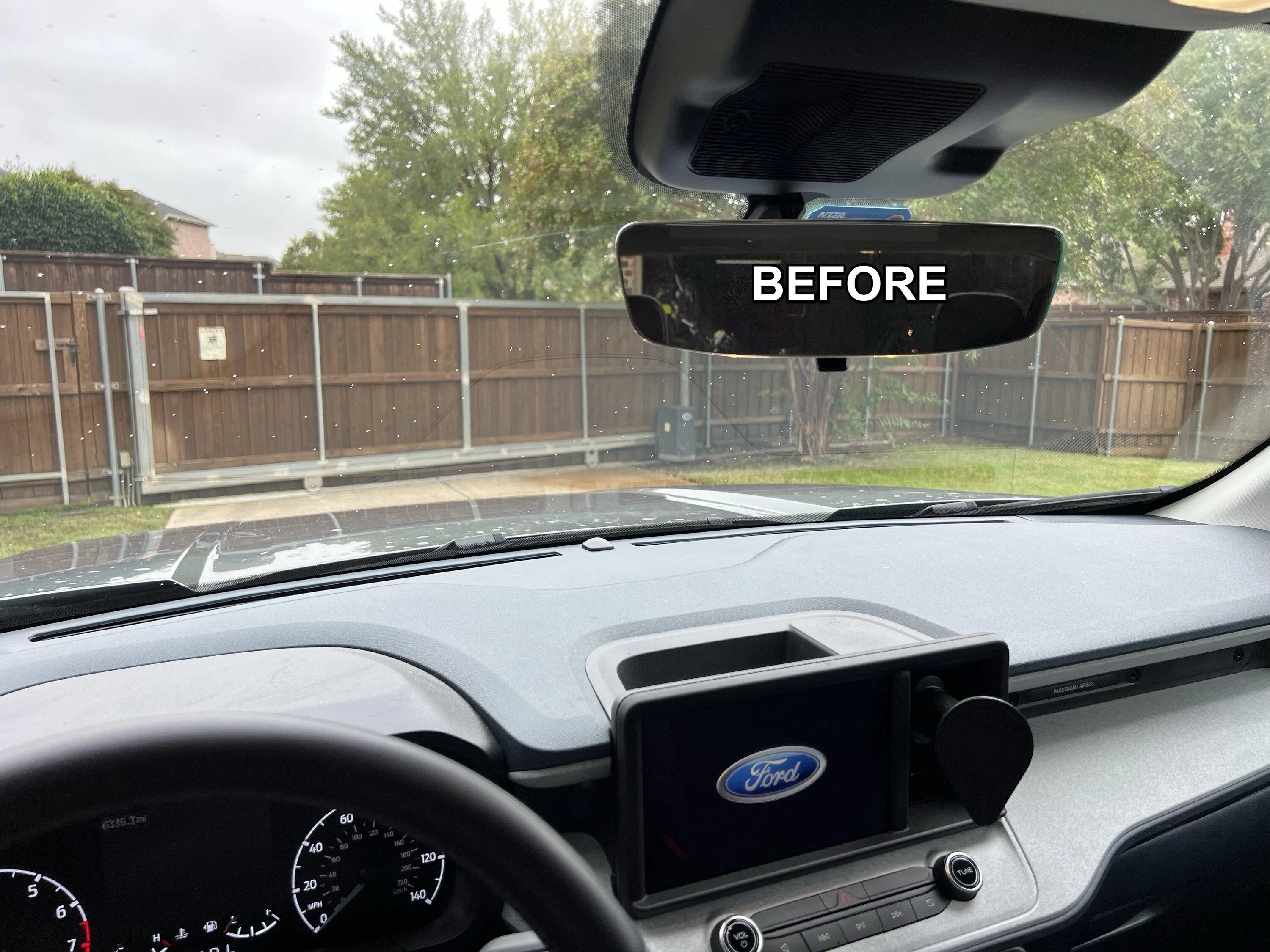

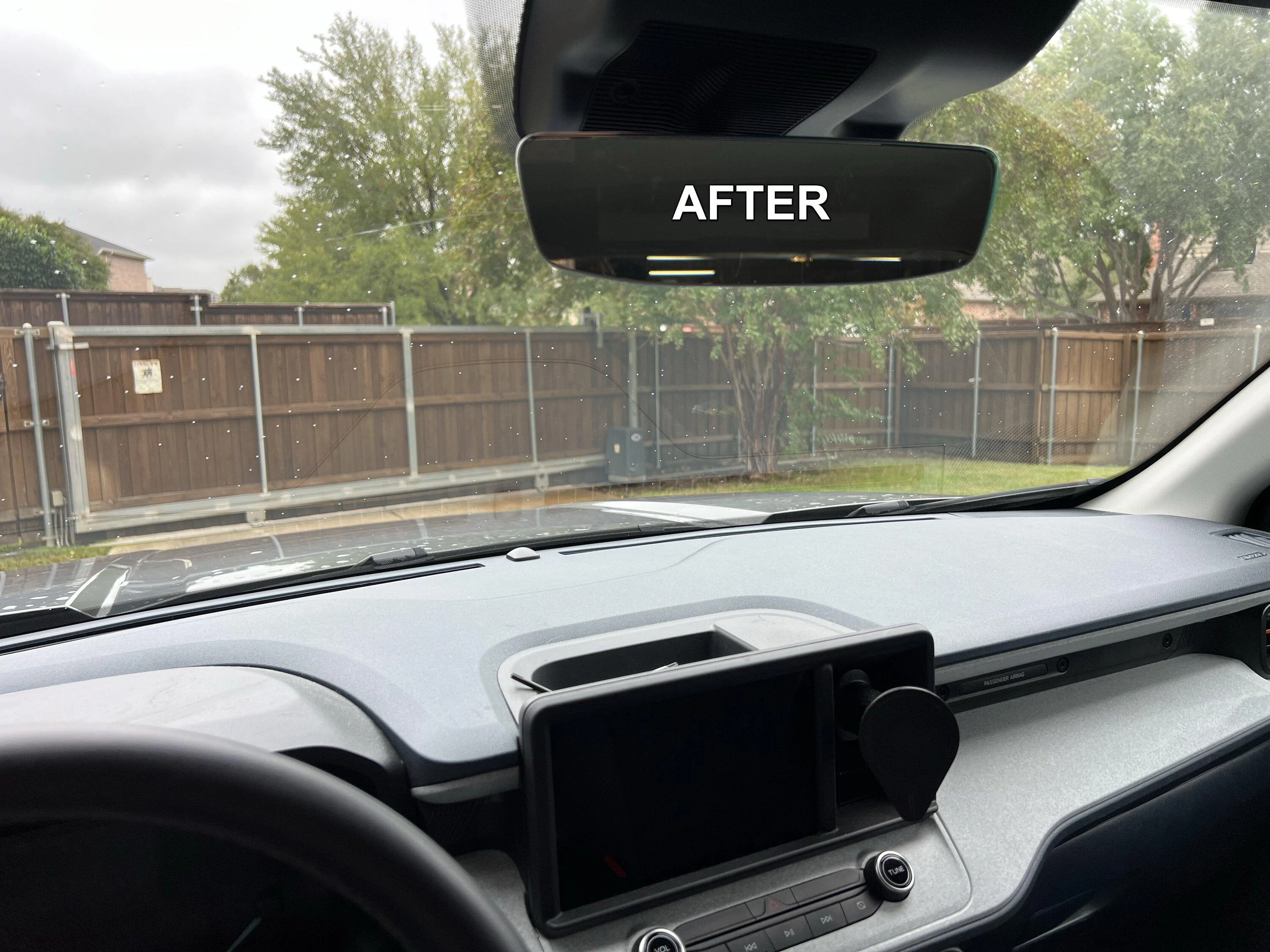

I installed a Toyota Frameless Homelink Mirror (PT374-00210) and it's great except that I can't raise the mirror as high as I'd like. On one of the many Mav FaceBook groups, someone mentioned they used a "toyota yaris mirror riser" and a quick google search showed me several options. I ended up buying one off of eBay for around $50 and installed it yesterday.
Glory be, it's exactly what I wanted! :D
I'm now able to raise the Toyota Homelink Mirror to max height and I have a better view across my windshield.
Pics attached in case this helps anyone else.
Thanks!
