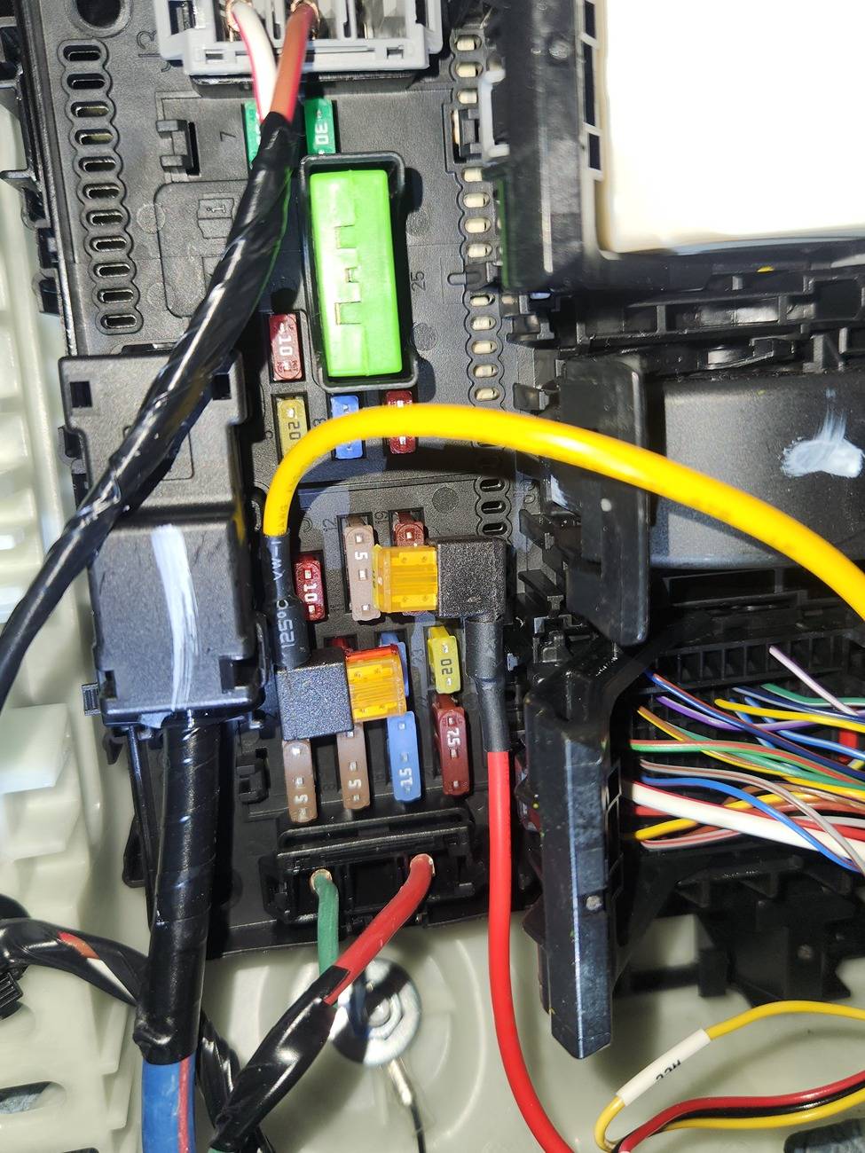

FWIW... if I remember right, fuse 3 (bottom post) is acc and fuse 24 (top post) is +12.
Ford Maverick 2025 ford maverick lariat rear view mirror 1000007725

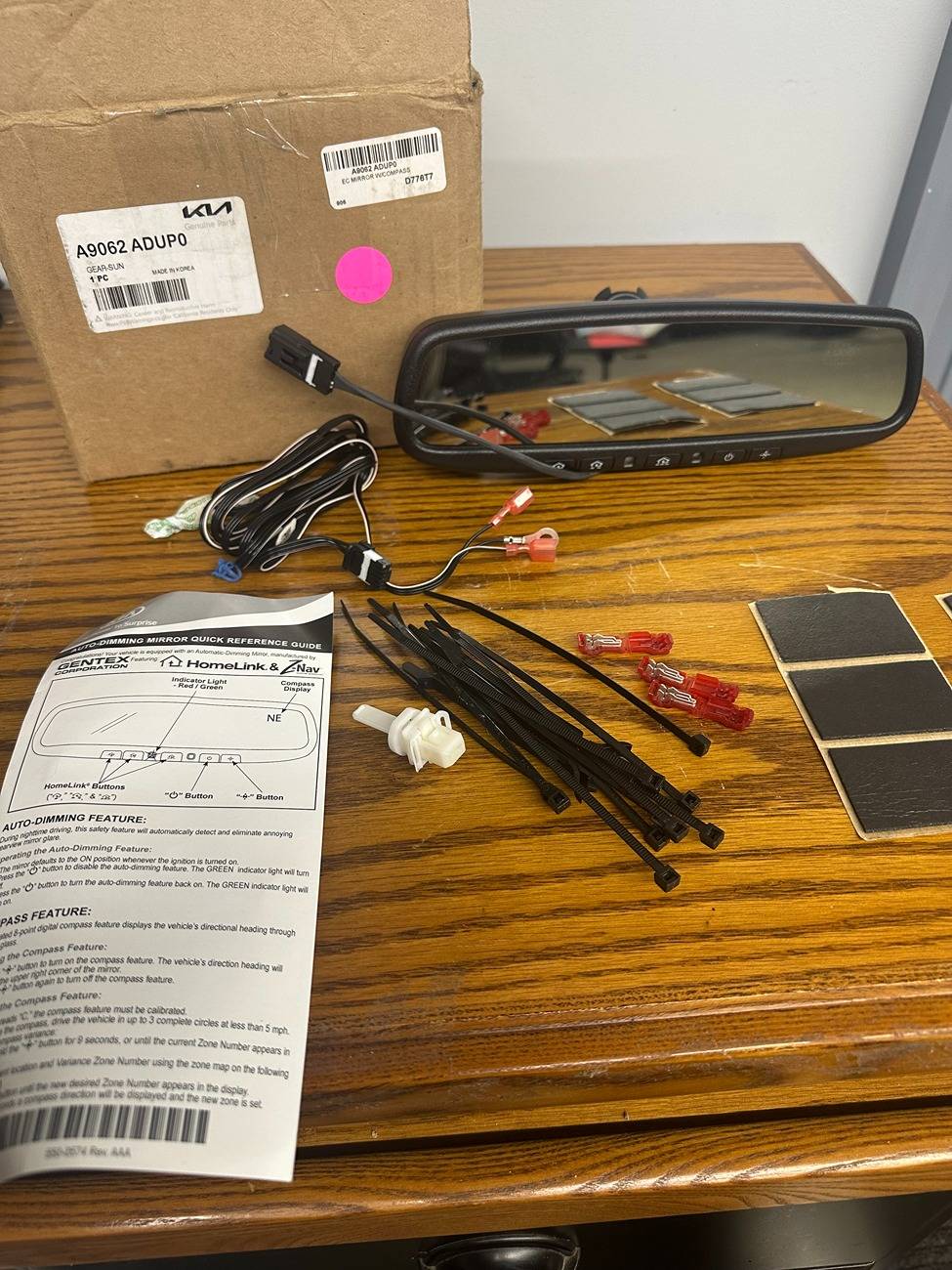

Hello, I still have not received my truck. My dealer says any day now. I paid a total of $59.24 for my mirror and everything you see in picture. I believe it's all I need. I got it from QuirkParts.com on Oct 24, 2024, it's the KIA mirror with HomeLink. Part # A9062 2DUPO. Now I don't have my truck yet, but I believe I have everything, and it should work? Thanks Darrell
Ford Maverick 2025 ford maverick lariat rear view mirror A9062 2DUPO
