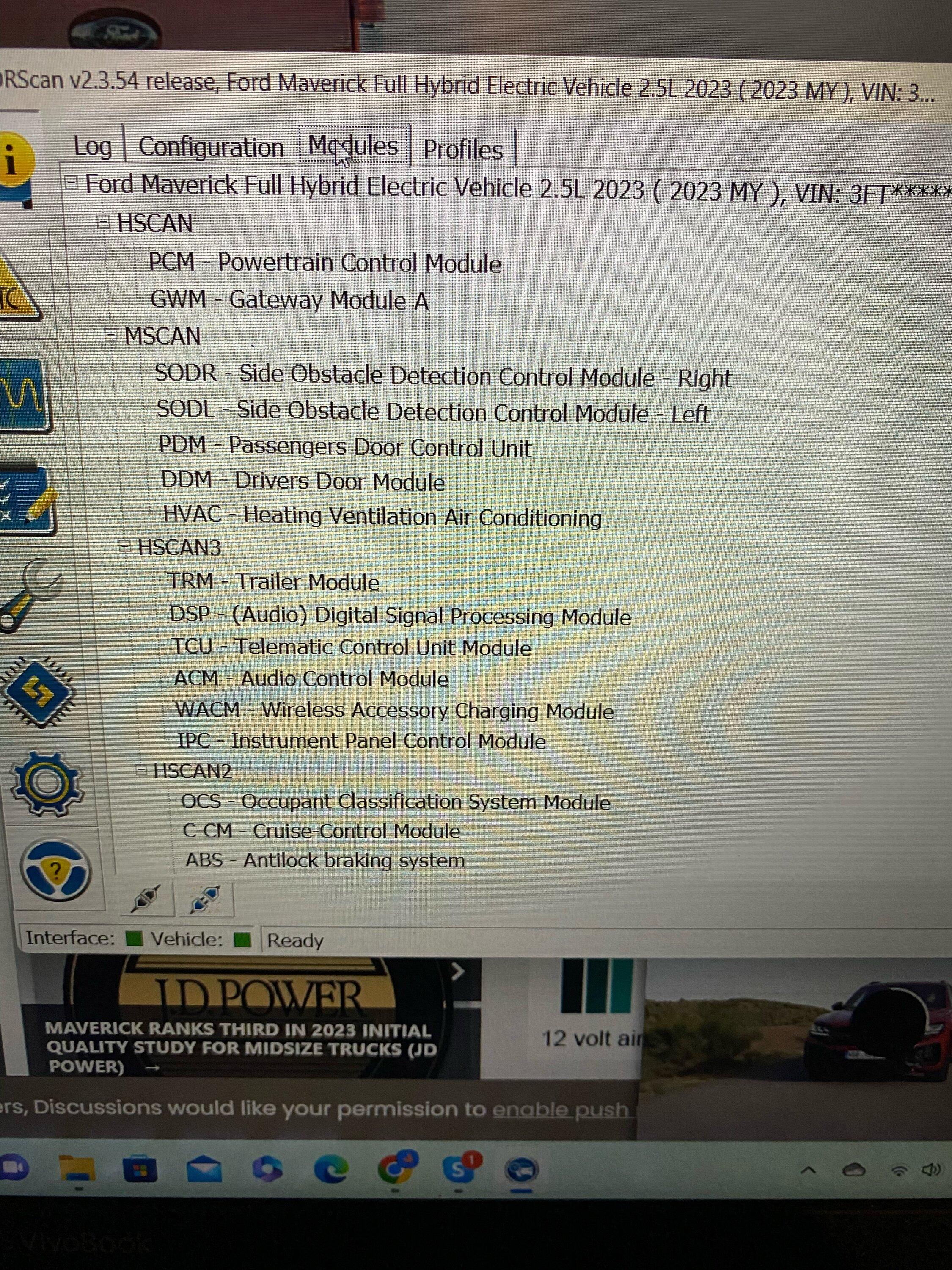

I bought a Forscan ELM cable on Amazon. After a couple of hiccups, I was able to get it connected to my Mav using a laptop. The tweaks I want to make (global open/disable double honk) are apparently in the bodycm module, but that module is missing from the list of modules. Any ideas about what's going on here?

Which modules are showing up? The Maverick has multiple CAN buses. More expensive OBD adapters can automatically switch between the different buses.

Here are a couple pics of the modules that are listed. I bought the cheaper option for the ELM cable, and I ordered the recommended one today. It will arrive tomorrow. Hoping that fixes the problem.

You skipped a step or missed somethig. You are in the wrong menu.
Click the chip icon that is labeled "Configuration and programming" to access the correct menu.

The adapters usually have their own drivers and firmware to download. FORScan can automatically update the firmware for some adapters like the vLinker.
Also when you go to rescan after getting your new cable or whatever delete the old truck profile it may have saved. Otherwise it may tend to only look for the known modules.

If FORScan can't find the module, there is no way it is going to program it.

It's the same list in the Chip tab. I only used that tab because it's like the list that Automate sent over.
