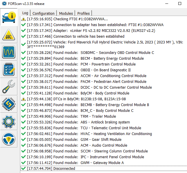

I attempted to enable TSR, or Traffic Sign Recognition. It doesn't work, but going back in just now, Forscan does not list the IPMA module anymore. I even tried generating a new vehicle configuration, bu no luck. Any ideas from all you Forscan geniuses on how to recover it?

Has forscan previously shown an ipma for this maverick? If yes then check fuses. In no, are you sure it has one? Also you have tried removing all saved vehicles?

Yes, Forscan originally showed an IPMA for this Maverick. The IPMA is protected by Fuse #3 in the BCM fuse box. This fuse also controls the automatic high beam control, which still works as it should, so it wouldn't be the fuse. I didn't actually remove the saved vehicle, but I renamed the original one with a .SAV extension and created a new one. Is there anything else to try? Thanks.

Well, I updated Forscan and still no IPMA module. Any other thoughts? Thanks.

I'm happy to report that My42waffles was on the right track. After deleting the existing saved vehicle and scanning the "new" vehicle TWICE, the IPMA module showed up in the list of modules. Thanks for your help.
