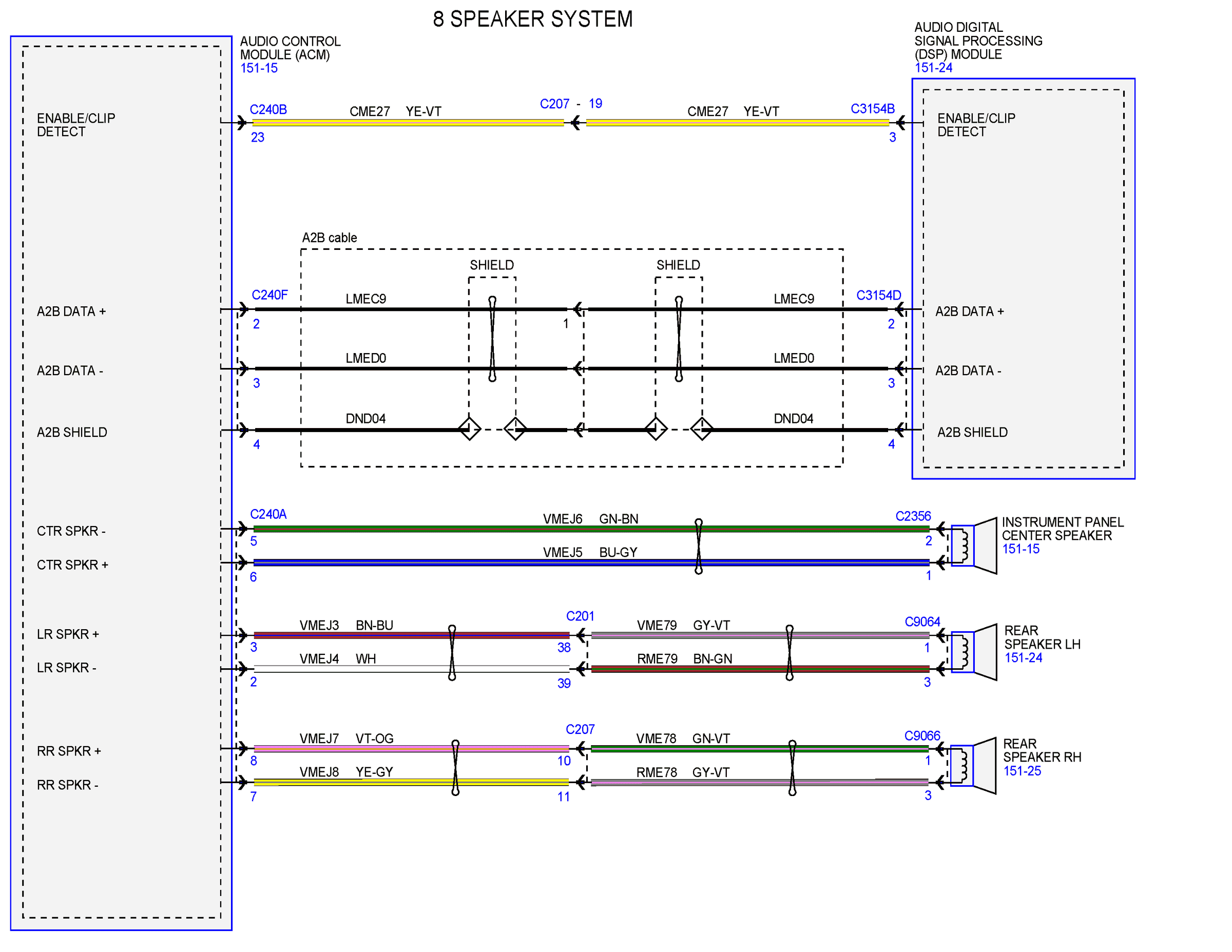

since I don't see it mentioned here those with the b&o won't get any benefit from the speaker setting changes to the acm as the acm isn't what is powering the speakers. the B&O dsp is the amp for all speakers and sub and is connected to the acm threw usb to receive audio data to produce sound and leaves the speaker positions unpopulated in the acm plug.
Only the door, tweeters, and subwoofer are powered by the B&O amp. The center and rears are direct to the ACM.
My42waffles
Kegan
Aug 5, 2023
79
70
21 f150 powerboost lariat 20 fusion titanium hybri
they set the maverick up differently than the f150 and bronco sport? that's odd as I have seen center and tweeters on the acm but not the rears before.
