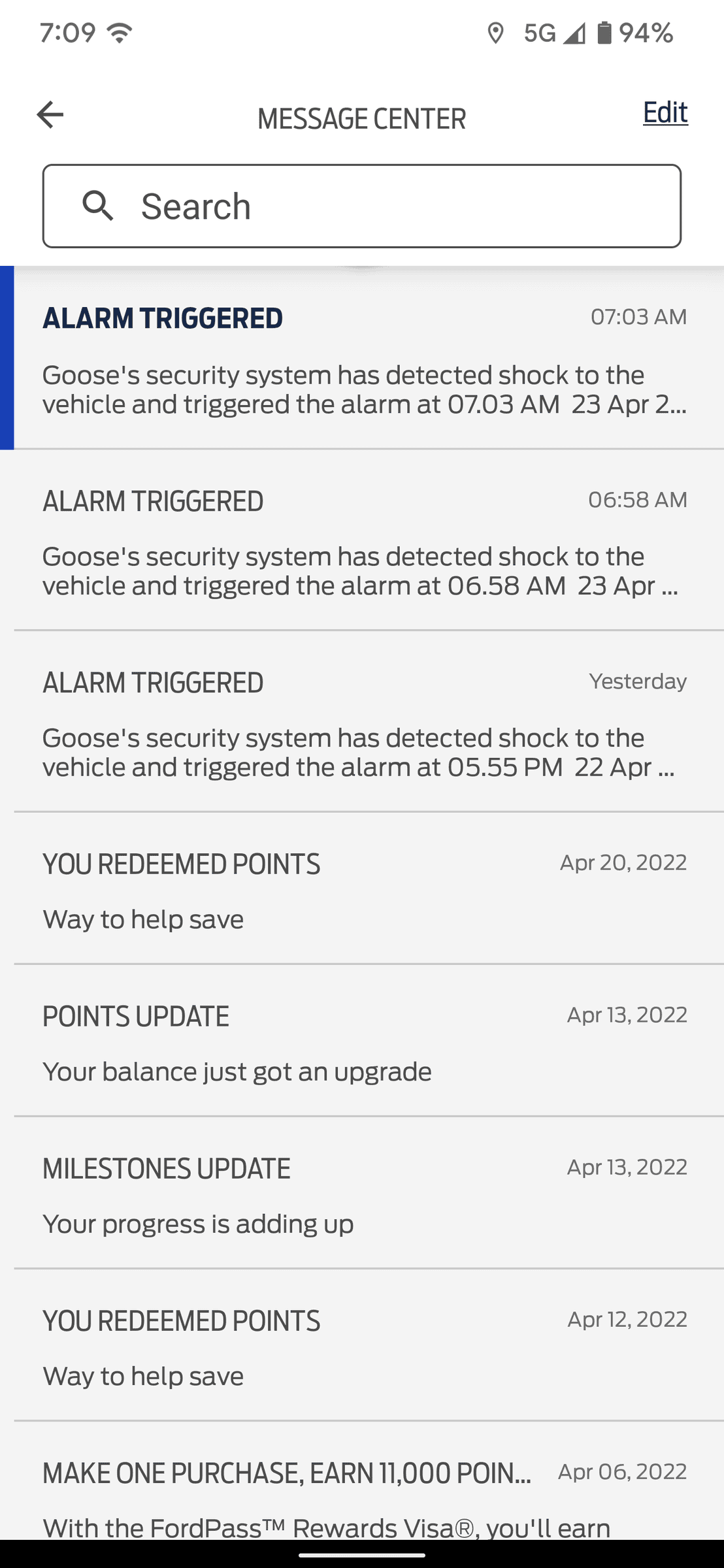

Is this still not working?
After I got my Maverick 3/30 I tested the Door alarm and was sent a notification.
Tested again the other day and No Notification in the Ford Pass app.
I added the Perimeter Plus alarm today and was expecting alerts when it is set off, but still Nothing in the Ford Pass app.
Tried uninstall/reinstall and nothing.

Nope, the option is still gone.
That's disappointing. I just installed the Perimeter Plus shock sensor. I set it off probably 15 times testing it throughout the afternoon.
I got ONE notice on the Ford Pass app that the Alarm had been triggered at 5:55 pm.
Hope that is fixed soon.

I just uninstalled the Ford Pass App V 4.13.0 and installed the previous version V 4.12.1.
I set the Alarm off twice, and both times it has notified me almost instantly through the Ford Pass APP. Maybe they messed something up in the latest version of the app?
FordPass™ for Android - APK Download (apkpure.com)
Edit: I set the Alarm off again about 30 minutes later, and No Notification?
Ford Maverick FordPass SecuriAlert Disappeared Screenshot_20220423-070913

I just had a chat through the FordPass app about the Securialert feature. According to the chat host, this feature isn't available for Maverick....yet. He said the engineers at Ford are working on this feature and will be coming soon. The Mach-e and F-150 with a SYNC version does have it......again according to the chat host.
Good to know. I know there's no option in the app, but I do get Alarm alerts, sometimes.
I just adjusted my Perimeter Plus alarm again, setting off the alarm probably 5 times.
I got an Alert from the App one time out of the 5 or so I set it off.
Hopefully they can fix it where it is consistent.
