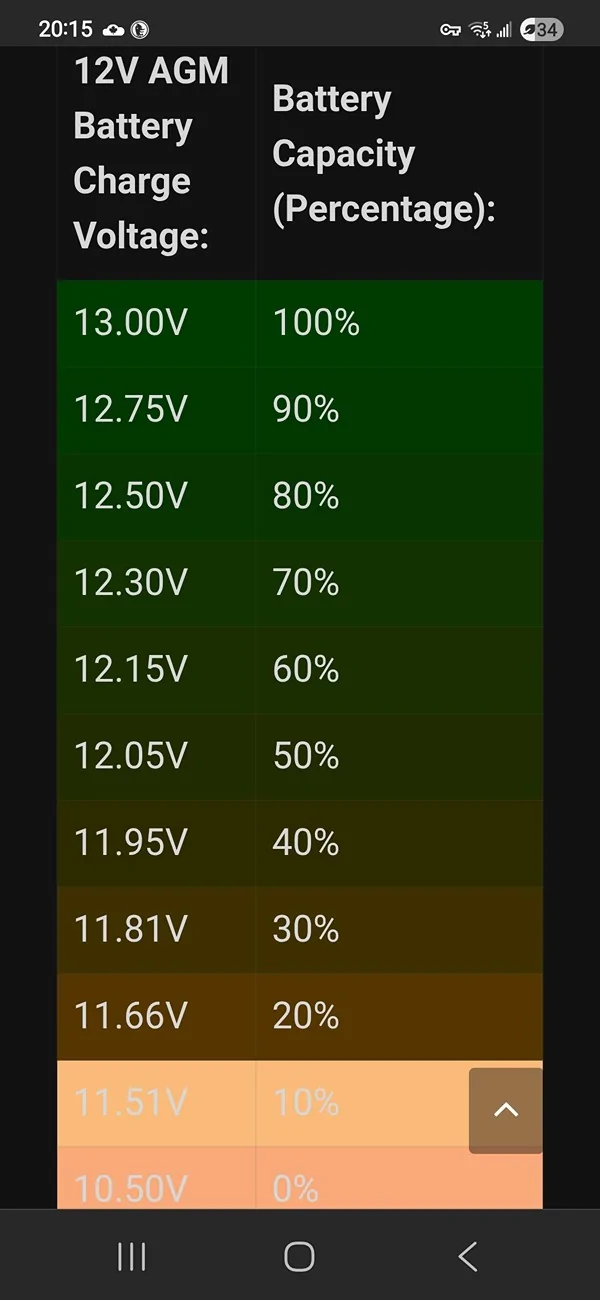

Here is a handy AGM BATTERY CHART, in case you have an AGM battery.
Ford Maverick % Ford Pass App doesn’t work Screenshot_20260514_201517_DuckDuckGo

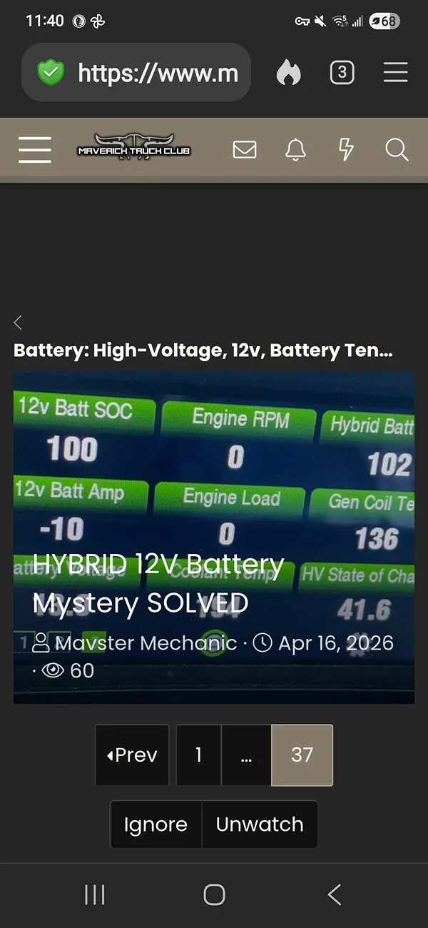

This is the thread I mentioned earlier.
Ford Maverick % Ford Pass App doesn’t work Screenshot_20260529_114057_DuckDuckGo
