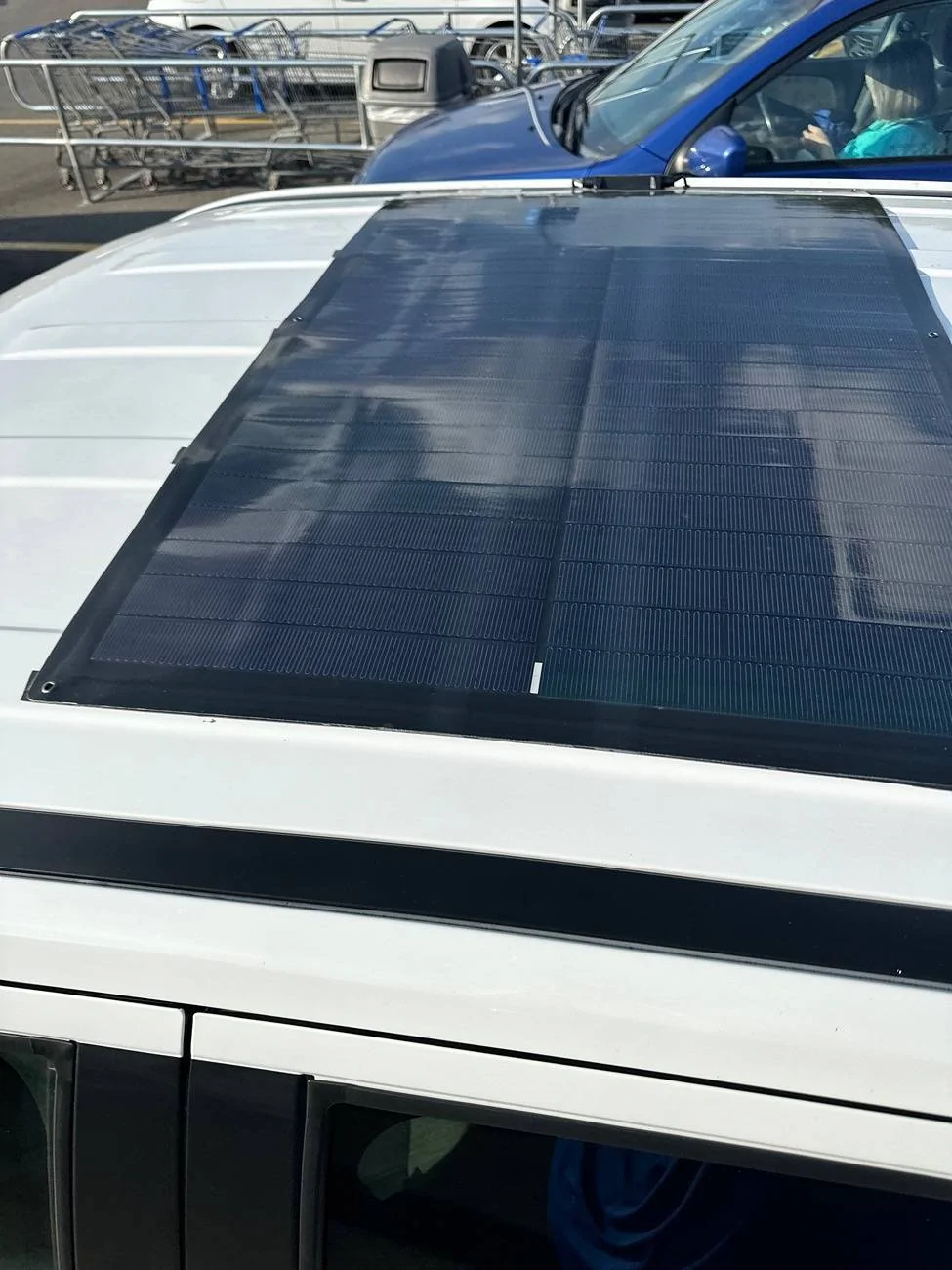

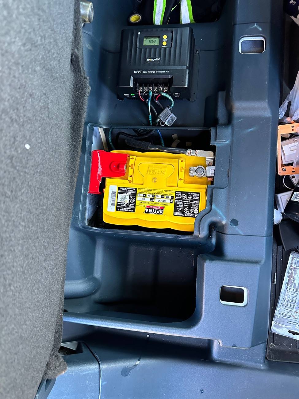

100 watt CIG panel with a optima yellow top H5. Bye bye deep sleep

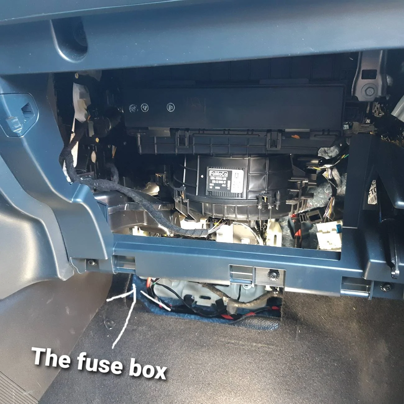

Just so I know for future reference, where is fuse 11/12 located at?
Appreciate the tips!
Not a problem.
If you look up on the left side of the passenger footwell you'll see a plastic panel underneath that panel is the fuse box. There are plastic snaps that hold the panel on so be careful pulling it off.

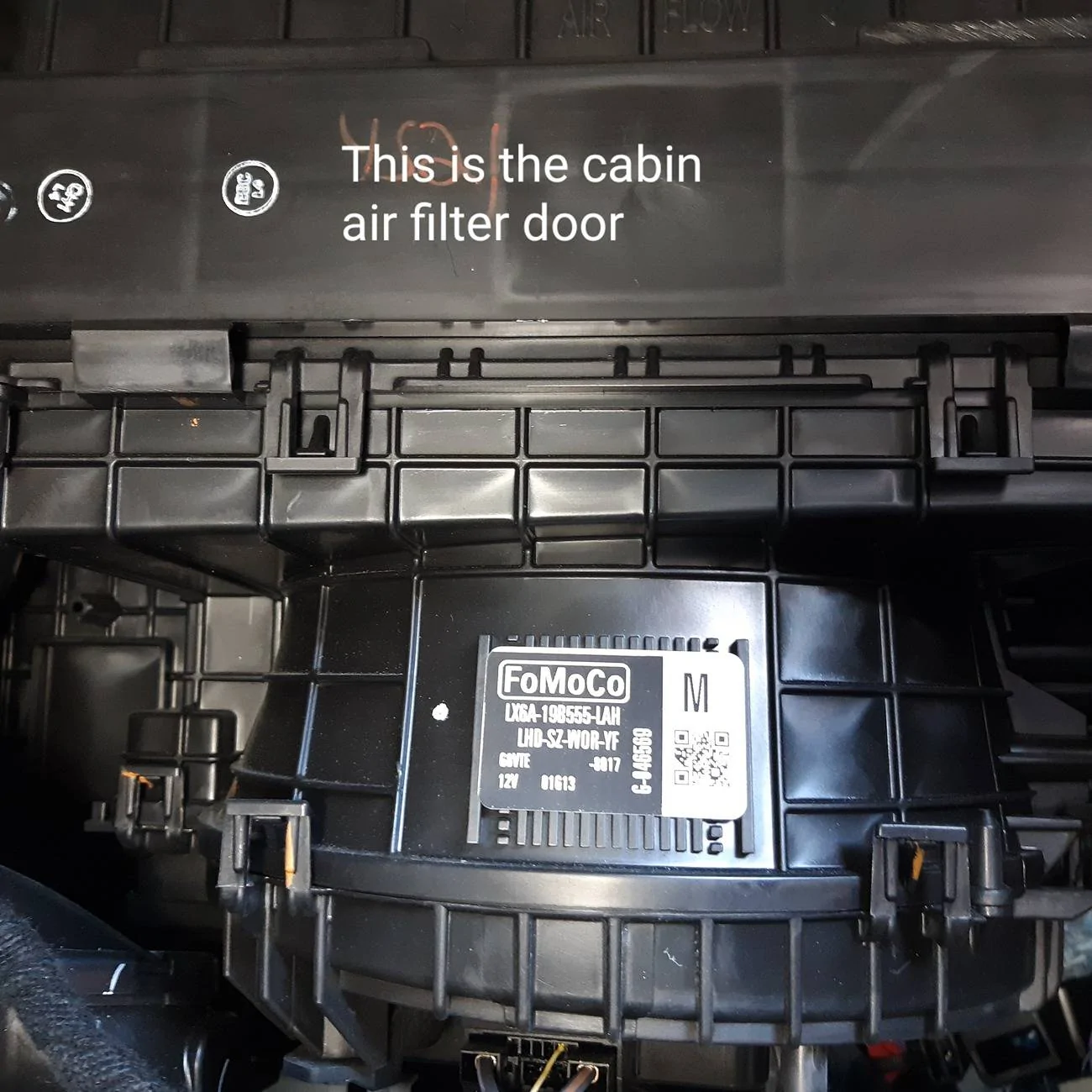

So that you have some relationship this is the cabin air filter door.

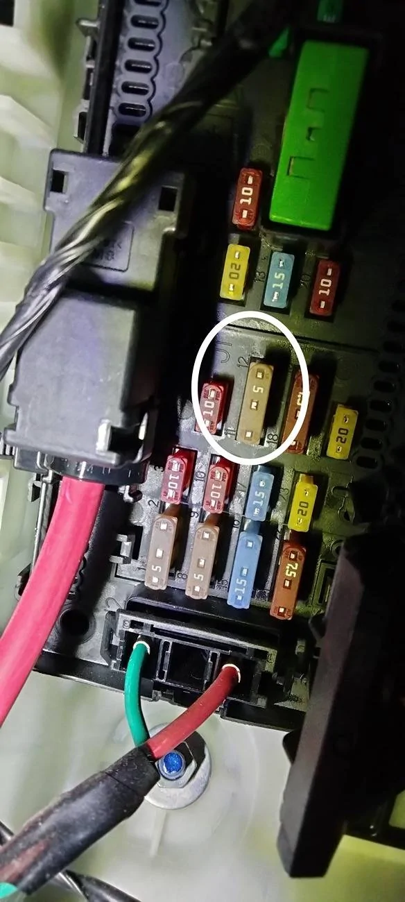

Here is what the fuse panel looks like and the location of fuse 11/12.
I hope this helps.
Good Luck
