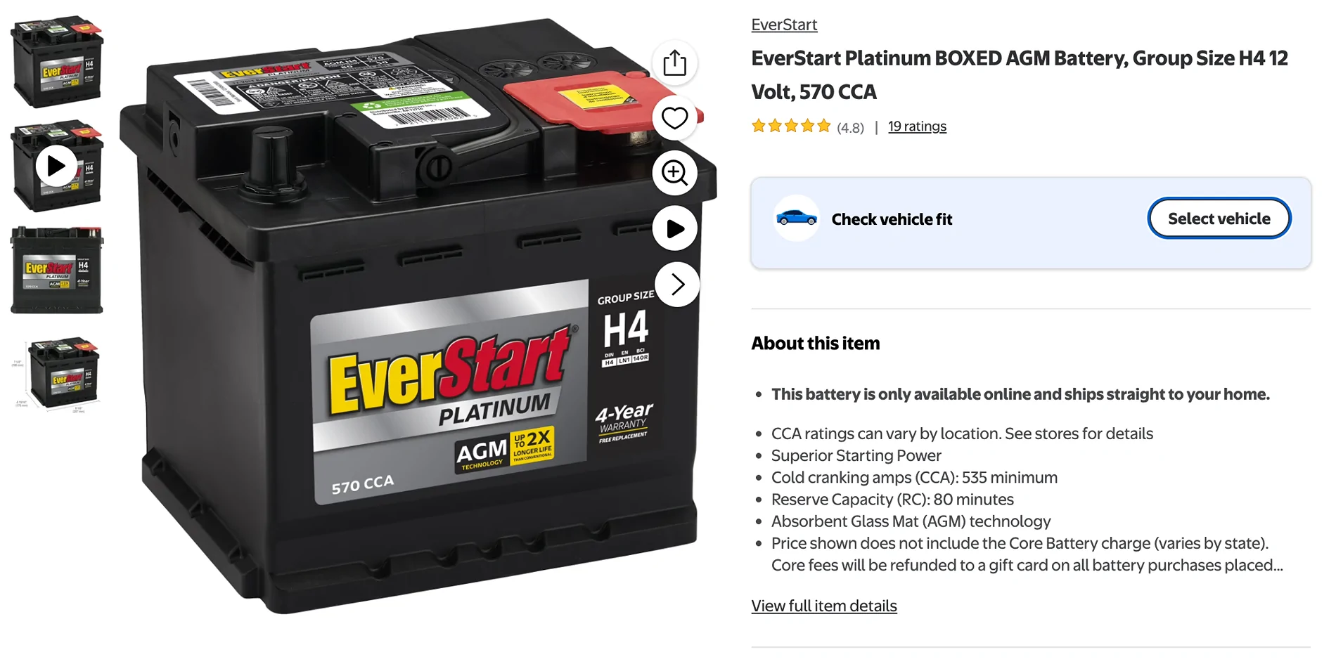

I had the harness cable overlay recall done on my 2022 years ago. Also did you fully charge the agm before you installed it, reset the bsm, and then run the "new battery learn" procedure?
