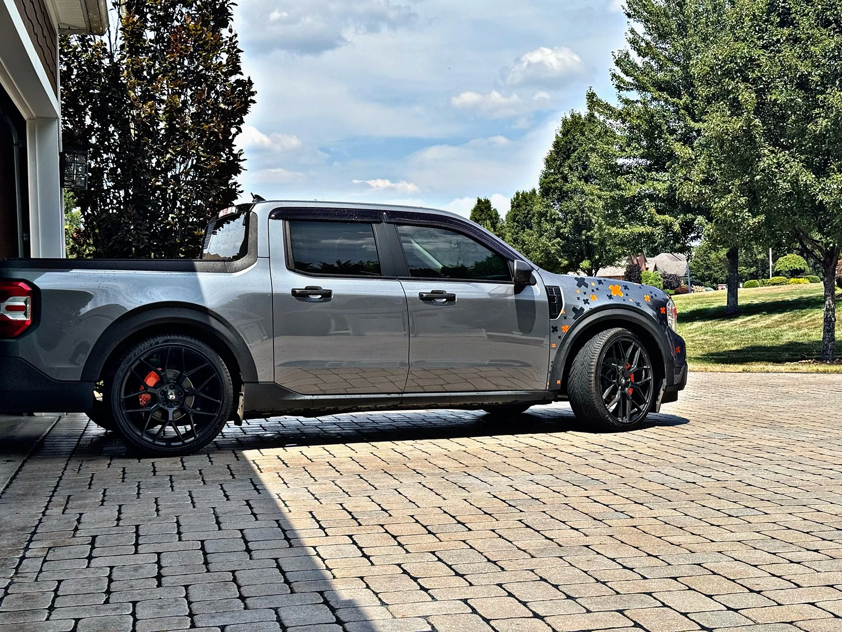

Your truck looks great. Your lowered on eibach?? I'm lowered on silvers coilovers.

Yes they actually had my truck in Monday for the battery recall and I asked them to check my cv joints bc I’m getting a weird vibration.. they confirmed then they called me today with the recall for it how ironic..

I’m actually lowered in H&R sport 3in front 3in back and thank you
