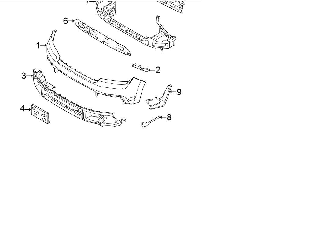

The pins on the bumper I am talking about are show as #2 below in the picture
Ford Maverick ****FOGLIGHTS**** Installed [Diode Dynamics] bumper
Part numbers
NZ6Z17C947A
NZ6Z17C947B and about $13 each. That part is rivoted into the top of the bumper and it has plastic centering pins and the three holes that the fender bolts into. The center of this part is where the plastic mount is that has two tabs on it and that is what holds up the bumper from dropping down even with the botls removed and the front and bottom of the bumper free. Those two tabs really need to be pushed in on the mount to allow the bumper to drop the rest of the way rather than just yanking on the bumper until the tabs break off. Tabs are not required for reinstall but support the bumper during removal.
Part numbers
NZ6Z17C947A
