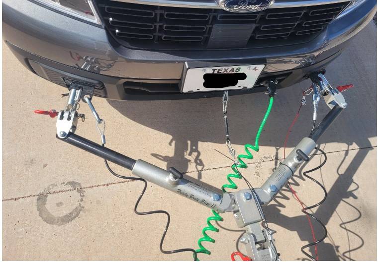

Seriously reconsider putting on a Demco instead. Even though Blue Ox has revised their initial, TERRIBLE Maverick baseplate, many of us saw their failure to stand behind the failures people experienced. See picture for an example. The DEMCO is a lot beefier than the Blue Ox revised version.
I wouldn't tow a child's wagon with that little, stumpy aluminum tow bar. I wouldn't trust that bar with ANY baseplate on ANY vehicle. It even came with little, tiny cables.
The forces on these bars can be tremendous. The forces acting on those joints had to be unbelievably high.
This isn't a Blue Ox problem.
It absolutely was a Blue Ox problem.
They did not design their initial 2-piece system's welds sturdy enough to accommodate the outward pressures generated by even a "little stumpy aluminum tow bar."
You can see the evidence of the initial poor engineering by the fact that they have now modified their Maverick design to include an internal crossbar...although it is just a bolt-on item to their now 3-piece baseplate instead of the much sturdier solid Demco baseplate.
Oh! Let's play that game. A Demco failure point is the single tab used on their towbars. Hard turns bend and pop the welds on their base plates. There have been a bunch.
Choosing a towbar and baseplate is a lot like choosing a religion. You become heavily invested in your brand. You find failures in other brands. It bolsters your choice [while you ignore your brand's failures].
I have been towing with Blue Ox for too long to get into a peeing match over one-off failures every brand exhibits. I have been pleased with Blue Ox support and responsiveness.
