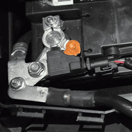

OK. No problem. We all start from there. Here is a less than perfect, non-technical explanation, and I'm sure the genius folk will correct me if needed.
1. Ford has a Battery Maintainance System (BMS) in one of its computers that tracks what is happening with the voltage and current in your 12 volt (not Hybrid) battery that you found under the seat. It is very similar to the shunt I have in my RV (Victron SmartShunt) to keep track of my house batteries. These things "sample" the current as it goes by (that sampling is what a shunt does, so it doesn't take a lot of power/current to accomplish the measuring). Literally, the BMS keeps track of the electrons leaving the battery (using 12 volt things) and the electrons coming back into the battery (from charging). It is literally an electric fuel gauge.
2. My Smartshunt is on the negative terminal, and I believe Ford is as well, as it is in my Ford Transit pictured below.
3. So if you connect directly to the battery terminal (like we all used to do until things got fancy), then you do not let the BMS "see" that you are taking power without "telling" it. So it doesn't know your battery status any longer. This is why you don't hook up your battery charger there either, directly to the battery post.
This is a picture from my 2020 Ford Transit. That black thing is the BMS shunt/sensor. The lowest, left nut is for the negative cable, the nut right above it goes to the negative of the second battery (Ford uses 2 batteries for the later Transit 3.5L motors). You can see that the BMS is located between these two nuts and the actual battery terminal above it. You can see the red and white wires taking the info from the BMS sensor to the computer.
You see the nut on the top of everything? To connect something there would be to bypass the BMS. That is the WRONG place. Connecting to EITHER of the lower nuts on that plate is just fine. They are "after " the BMS sampling occurs, so whatever you do (taking power, replacing power) is seen and recorded.
