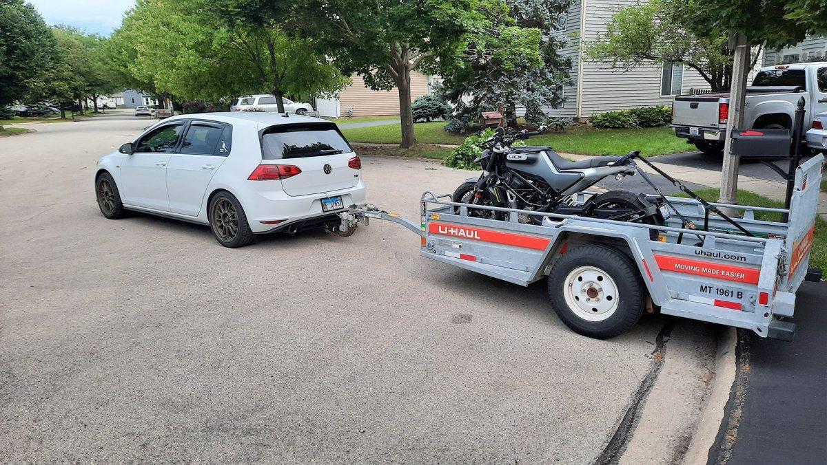

Anyway, it'll be nice to not have to get a rental trailer like I've been doing with my GTI... :)
The local U-Haul location I use had a pretty new one of those stolen from their lot last year, I think I found it.

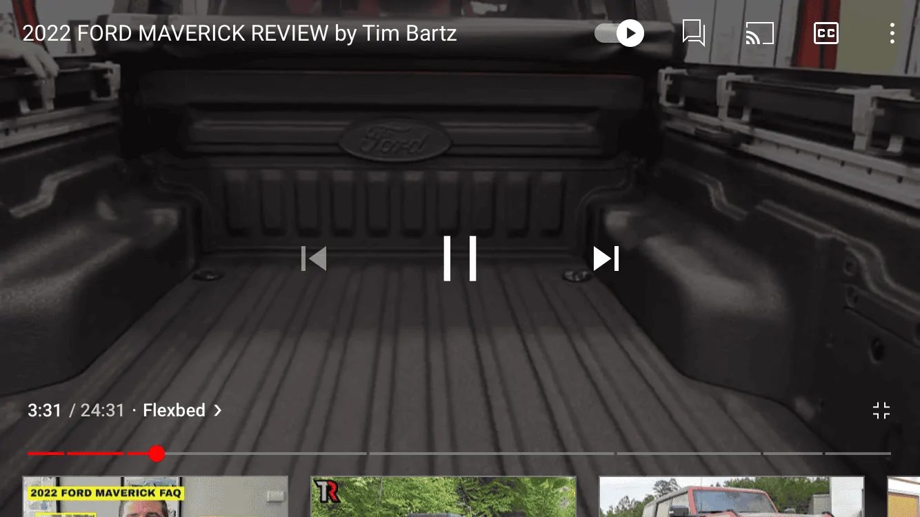

Newest video recently posted measures total length of bed with tailgate down is ~79”. Anything with a wheel base under 60” should fit straight in, tailgate down, rear tire contact patch on tailgate. Just like a 5’ bed. Now I wonder if I can fit two.

There’s usually a gap between the edge of the bed and the bottom of the tailgate. The bed isn’t like a folded piece of paper, the hinge will form a gap. The 79” seems believable, but I’d still measure myself to be sure. I’m going to mock up the bed with tape on the ground and park 2 dirt bikes in there and see how it looks.

Photos please! My front edge of the front tire to contact patch center at the rear is 75" if the bike is straight along the centerline of the truck. Tim's measurement of 79" is very promising. Not knowing the gap I computed 74.7" but it is hard to believe the gap is 4". I think that black plastic cap on the top of the tailgate may be adding a couple of nonstructural inches.

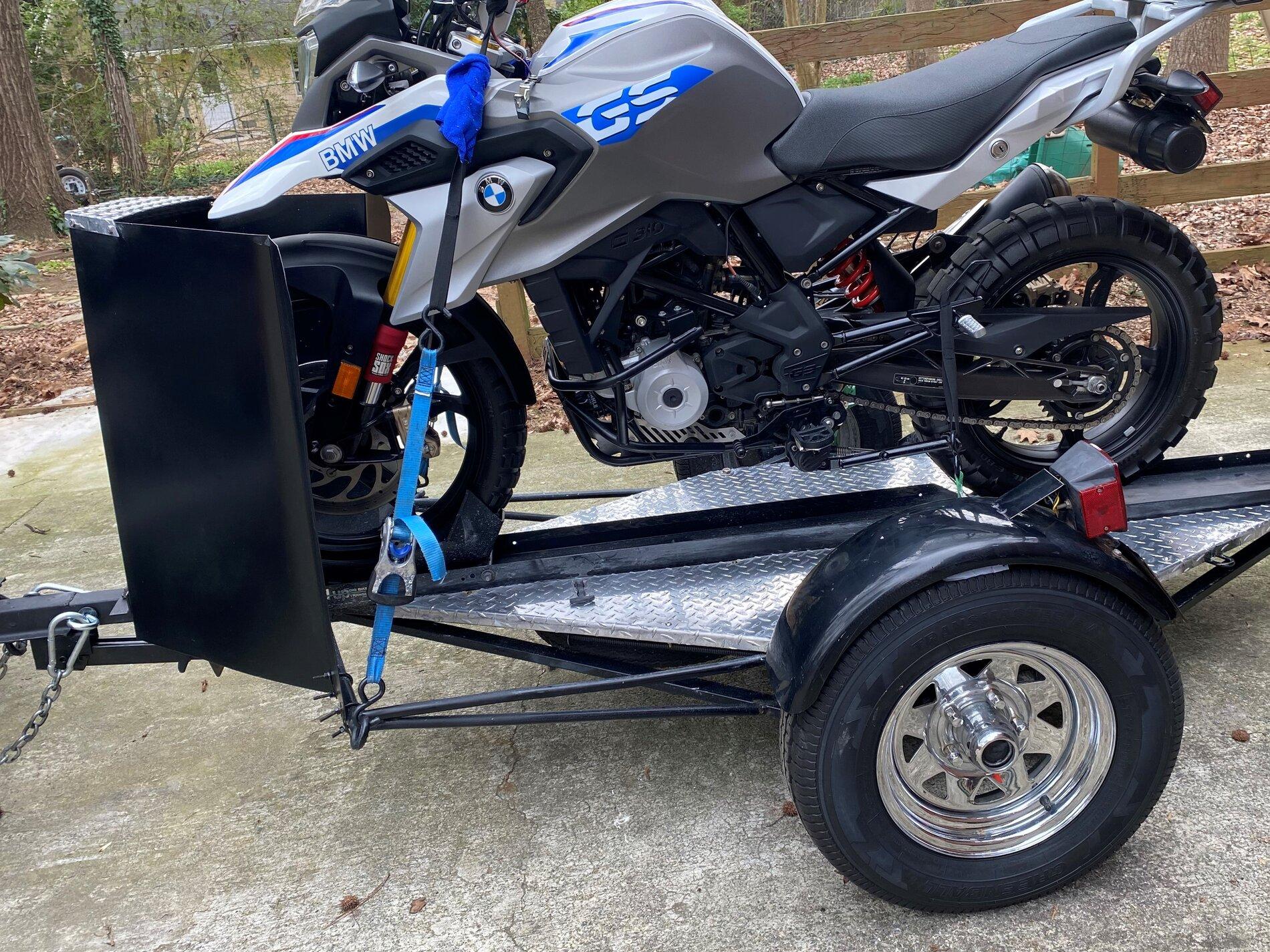

I checked my old Ford Ranger today and the down tail gate adds roughly 3 inches to the length of the bed...the tail gate hinges outward....so Maverick tail gate is probably similar. I "haul" the below BMW-GS from Atlanta to Idaho and Montana just about every summer for off-road trails. Have 2 well made Harbor Freight trailers ($320) that I've used in the past but NOTHING TOUCHES the convince of a little Kendon Trailer (used $650)(full sized car tires, no ramp needed)(1, 2 or 3 bikes no problem)...ride it on and strap down the bike in 5 minutes....trailer weights 335 lbs but can easily haul a 1000 lb bike. Honda Element 4 banger has no problem pulling it, looking for a Maverick Hybrid to save gas and higher trailer weight pulling.
The problem I ran in to with the HF trailer or my Ranger was getting to a destination and find a low place to unload, then struggling with loading and unloading 350-400 lbs bike with ramps....with the Kendon you just ride it on and off the trailer. I will easily sell the Kendon for 3/4ths of what i paid for it when I retire from riding...do have 2 HF trailers for sale.
I'd never load a bike cockeyed (front wheel sideways) in a bed for the potential of having to hit the brakes hard, and bike's front wheel needs to be in a chock for stability, strapped up high. (my dirt bike WR250R, no problem). I'm pretty sure with the tail gate length will be at least 74, 75 inches....but my concern will be putting too much weight on the tail gate, and waiting to hit a big bump and breaking a tail gate cable and loosing my GS. Rigging an extension might help but when you are off the bike your dealing with 300-400 DEAD weight....most any bike will have the rear tire on the tail-gate.
