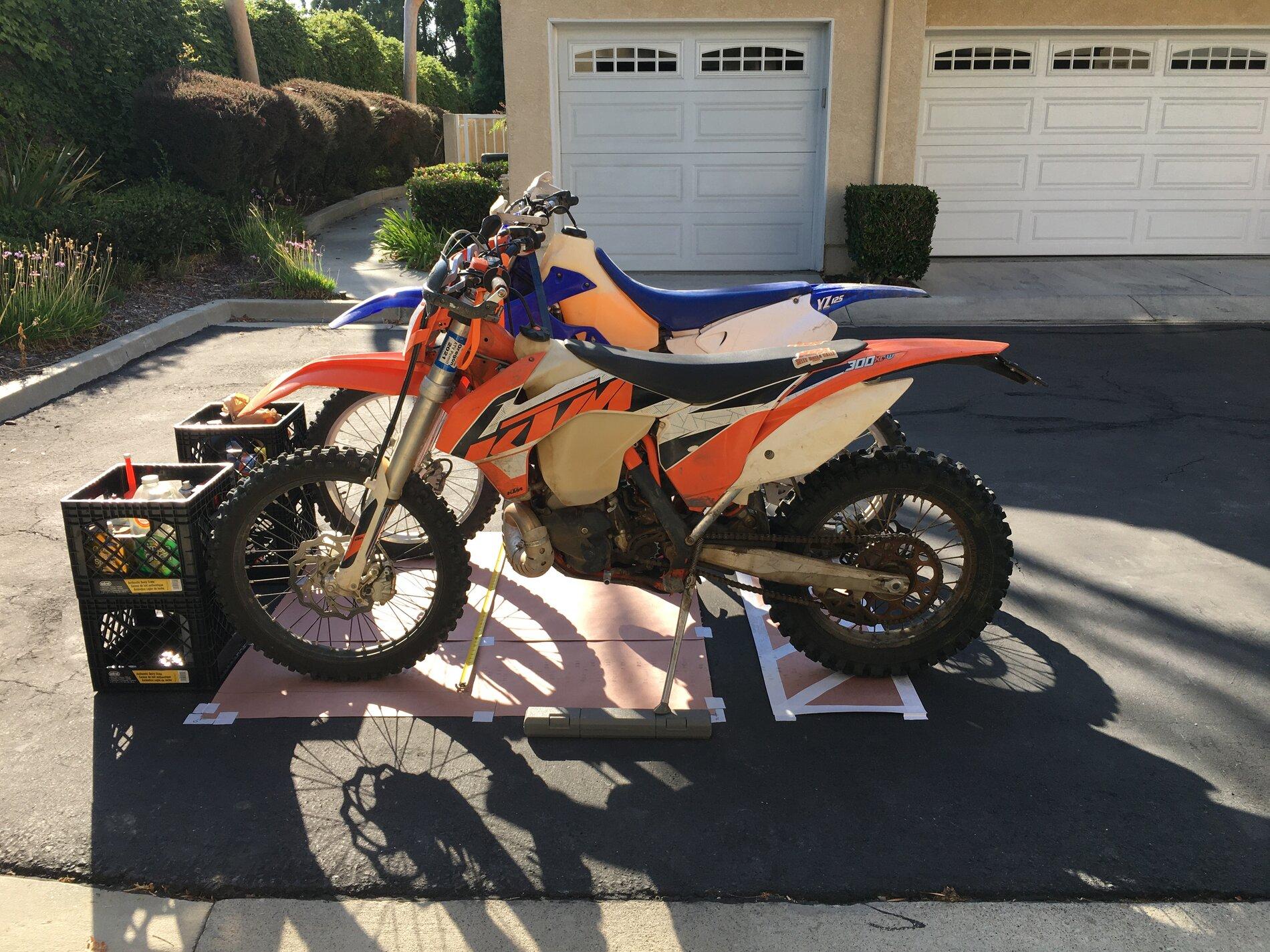

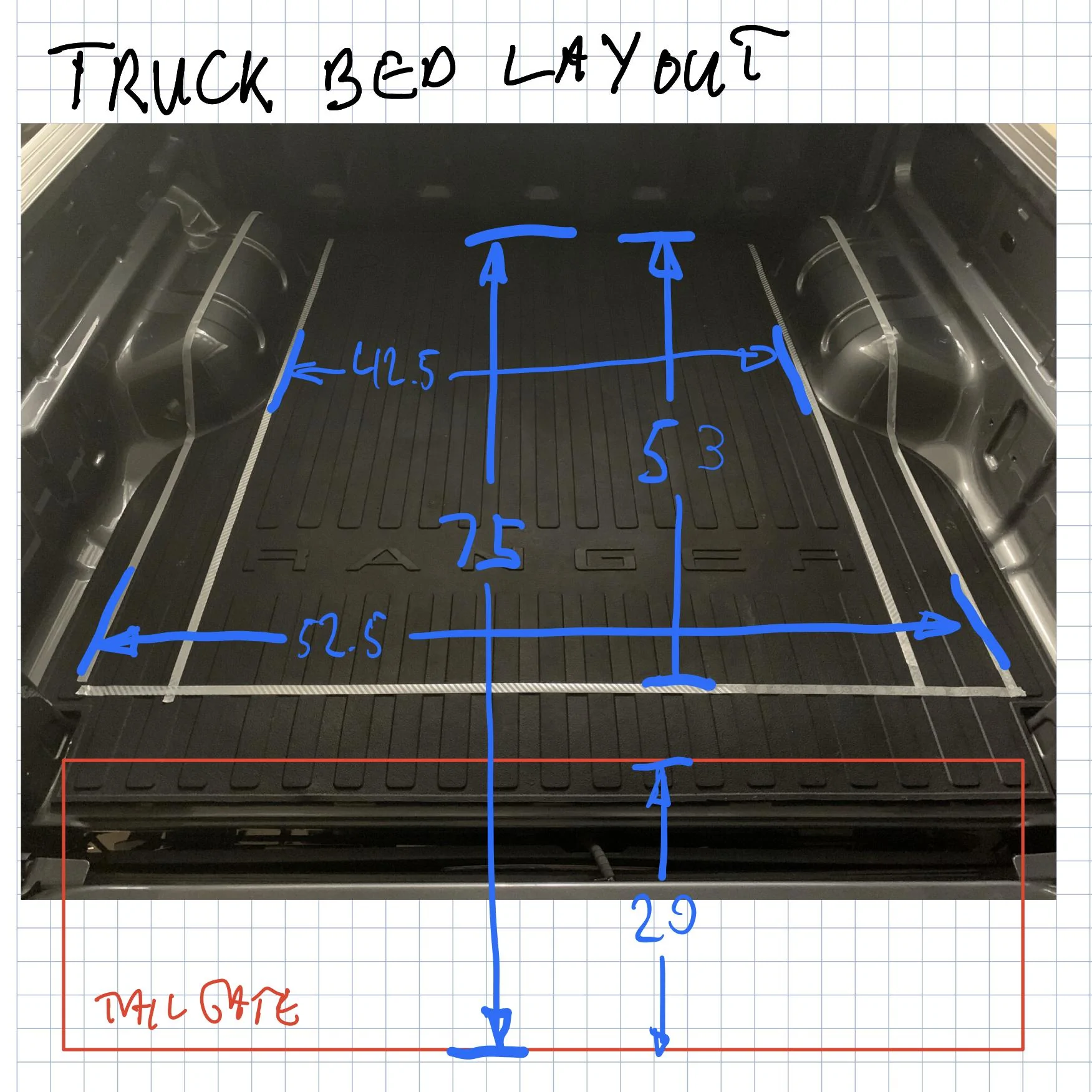

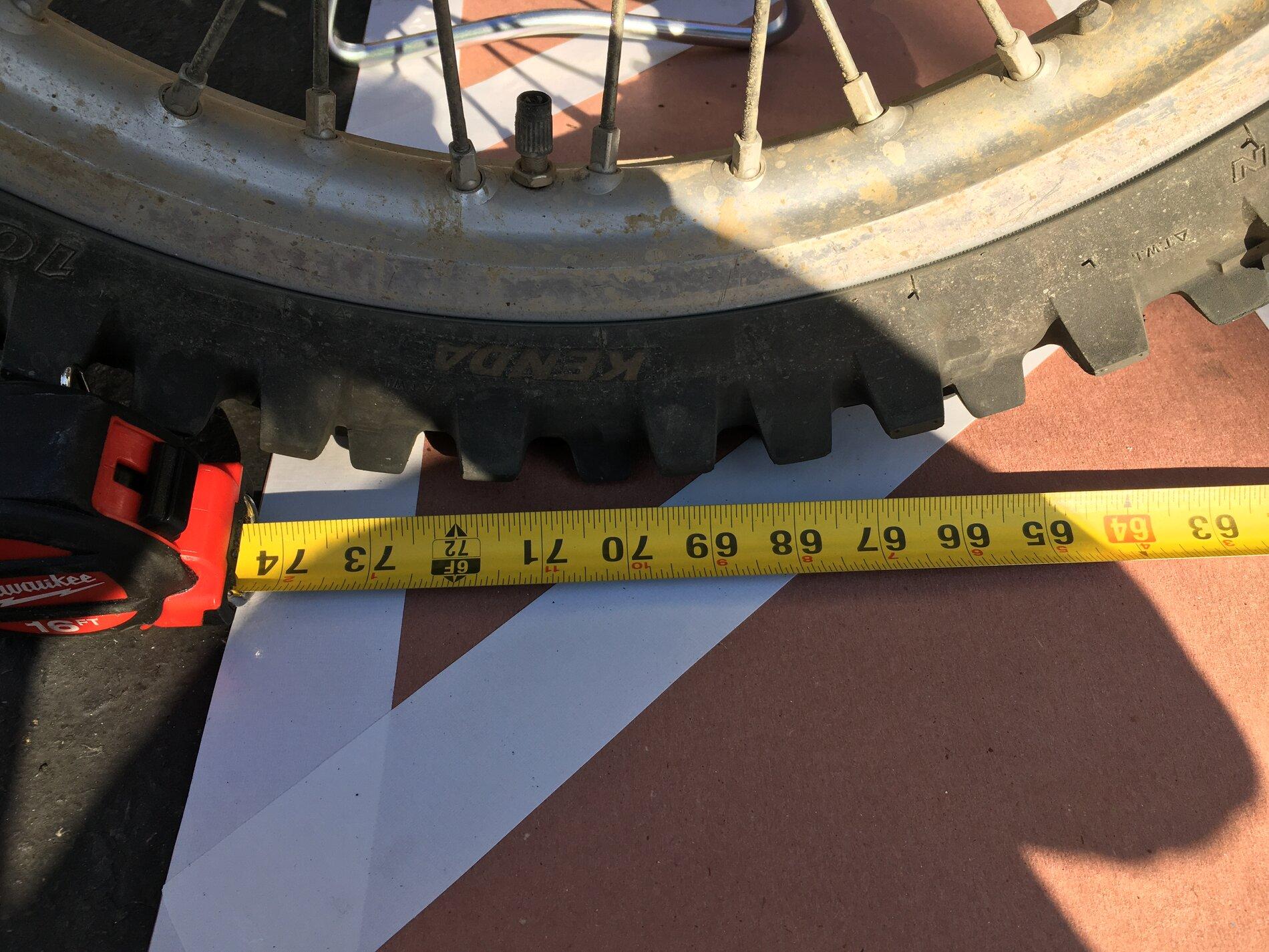

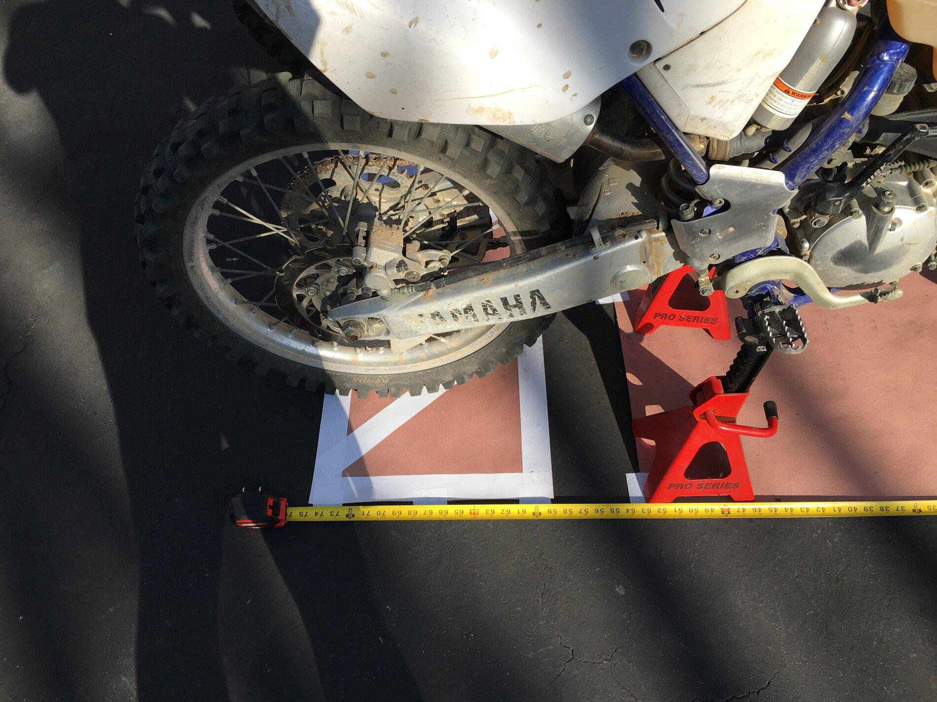

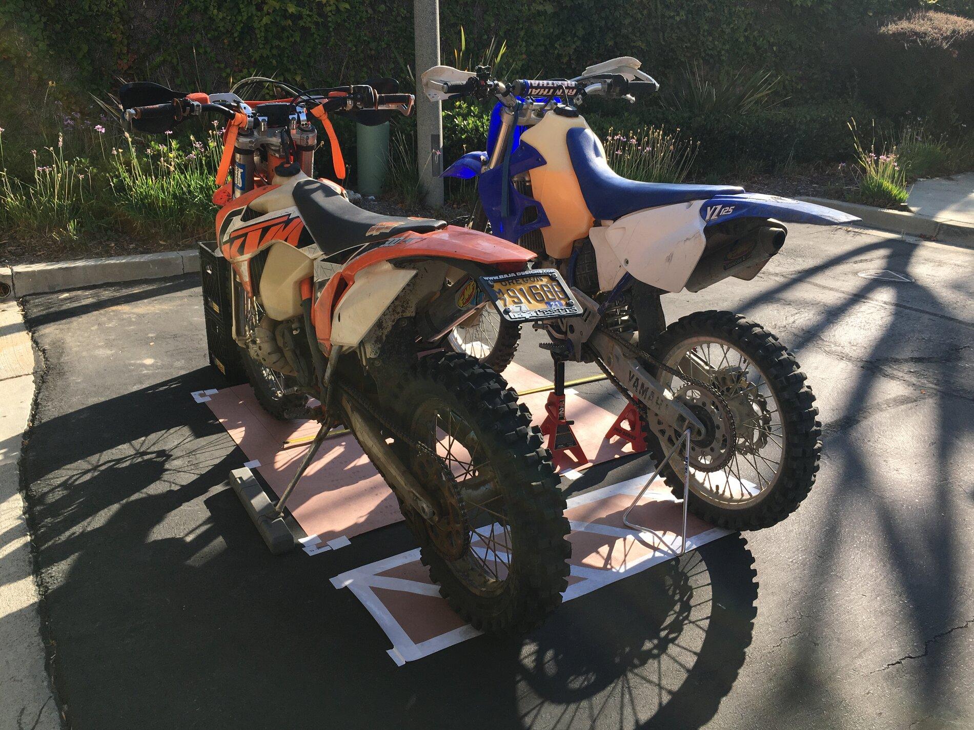

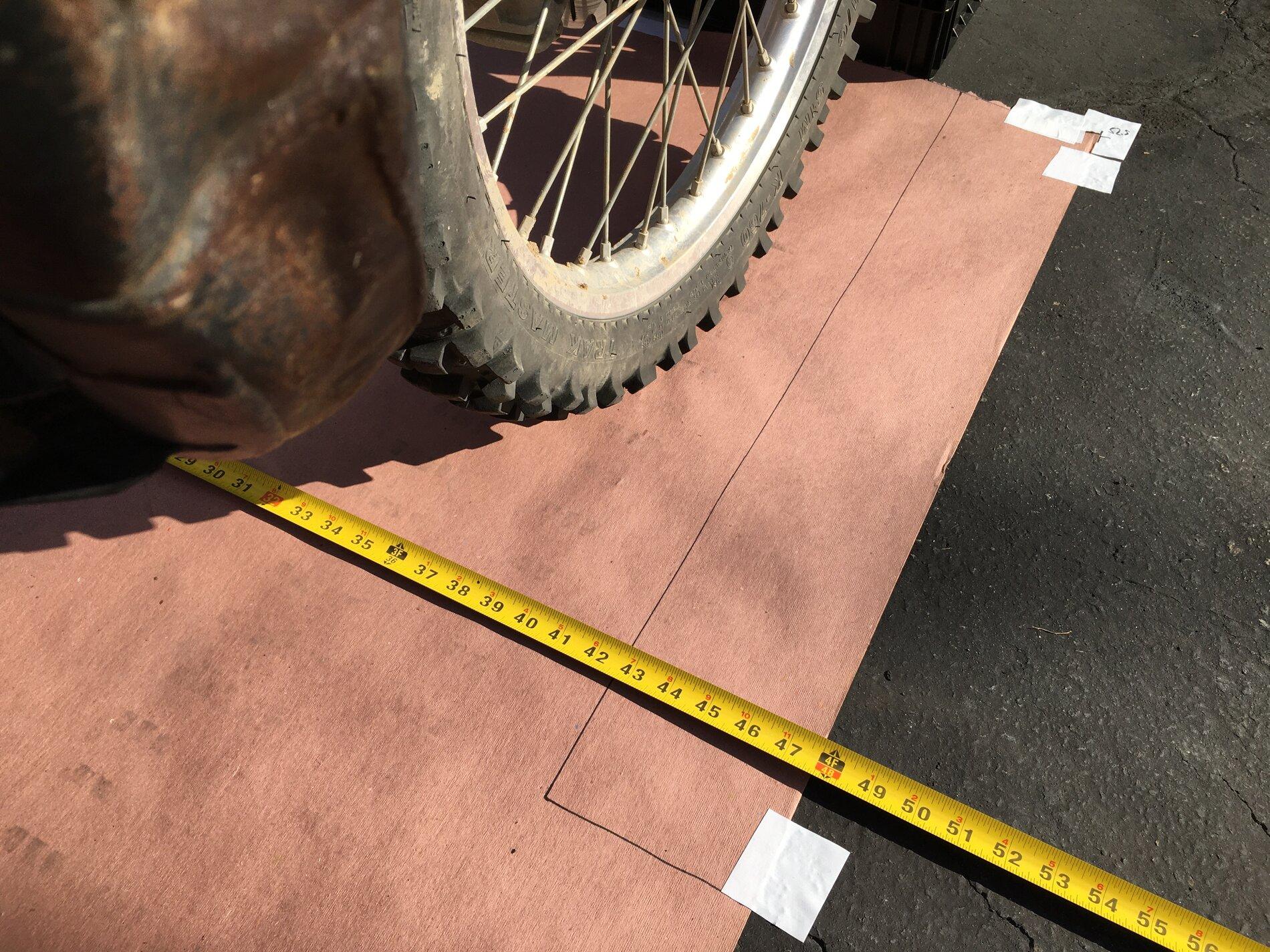

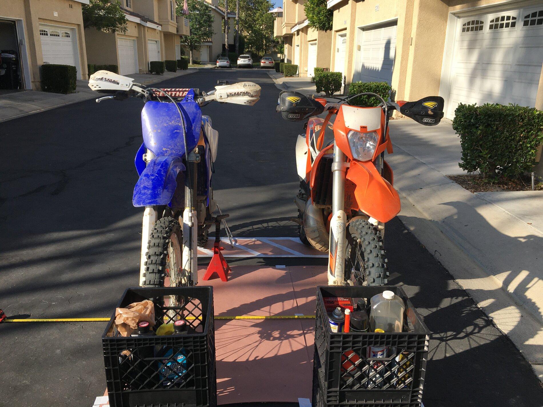

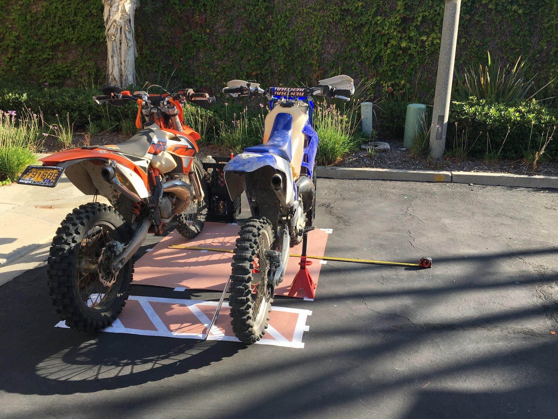

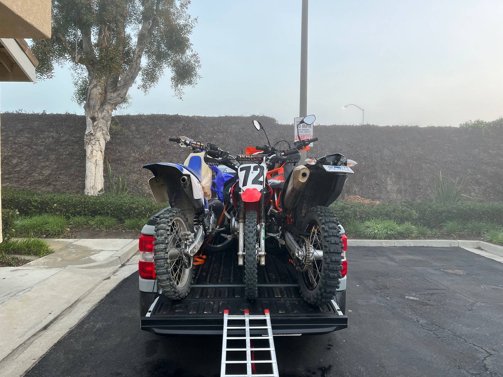

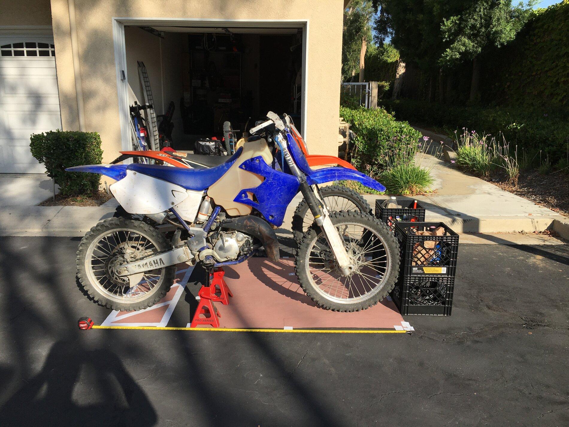

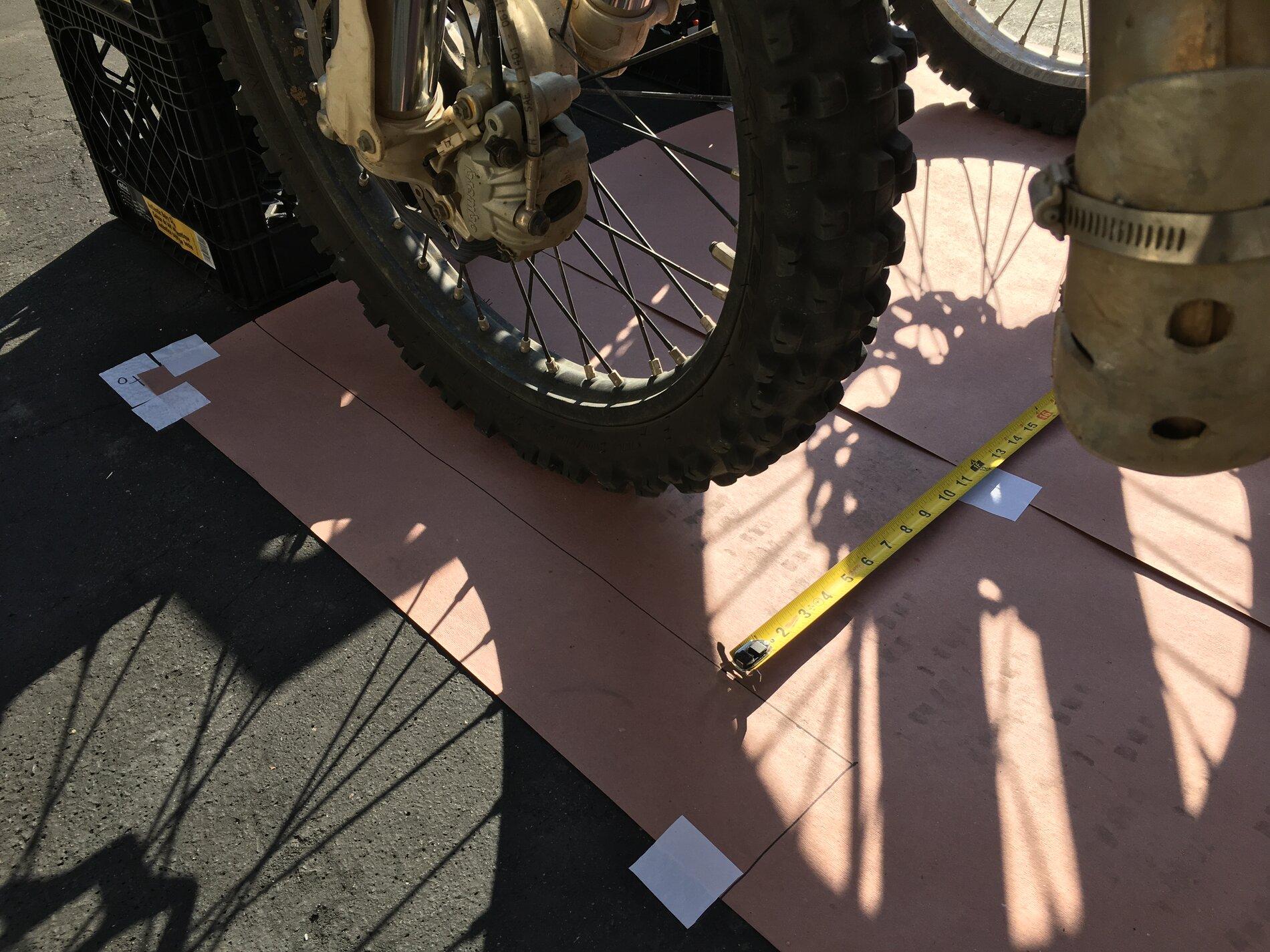

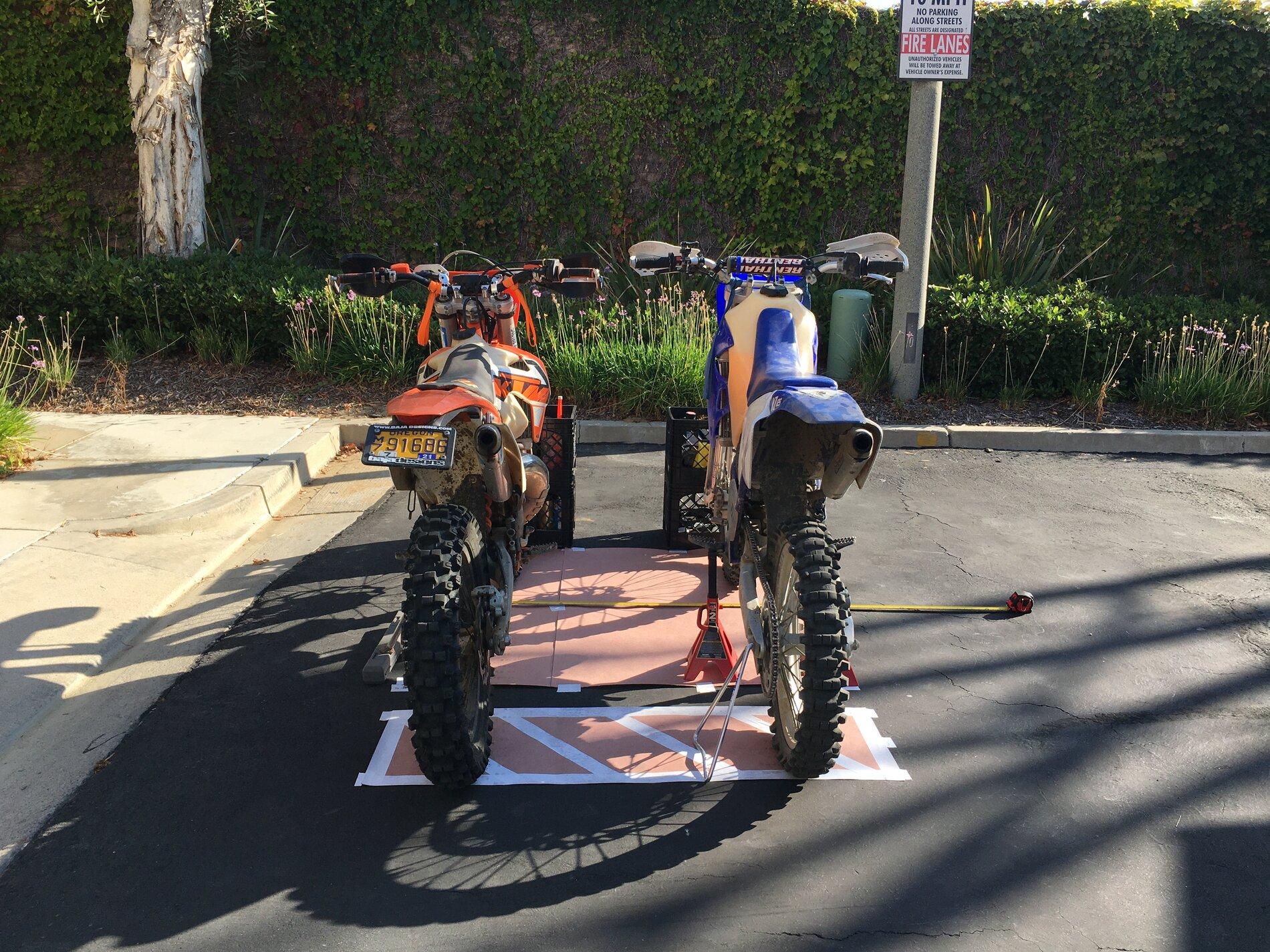

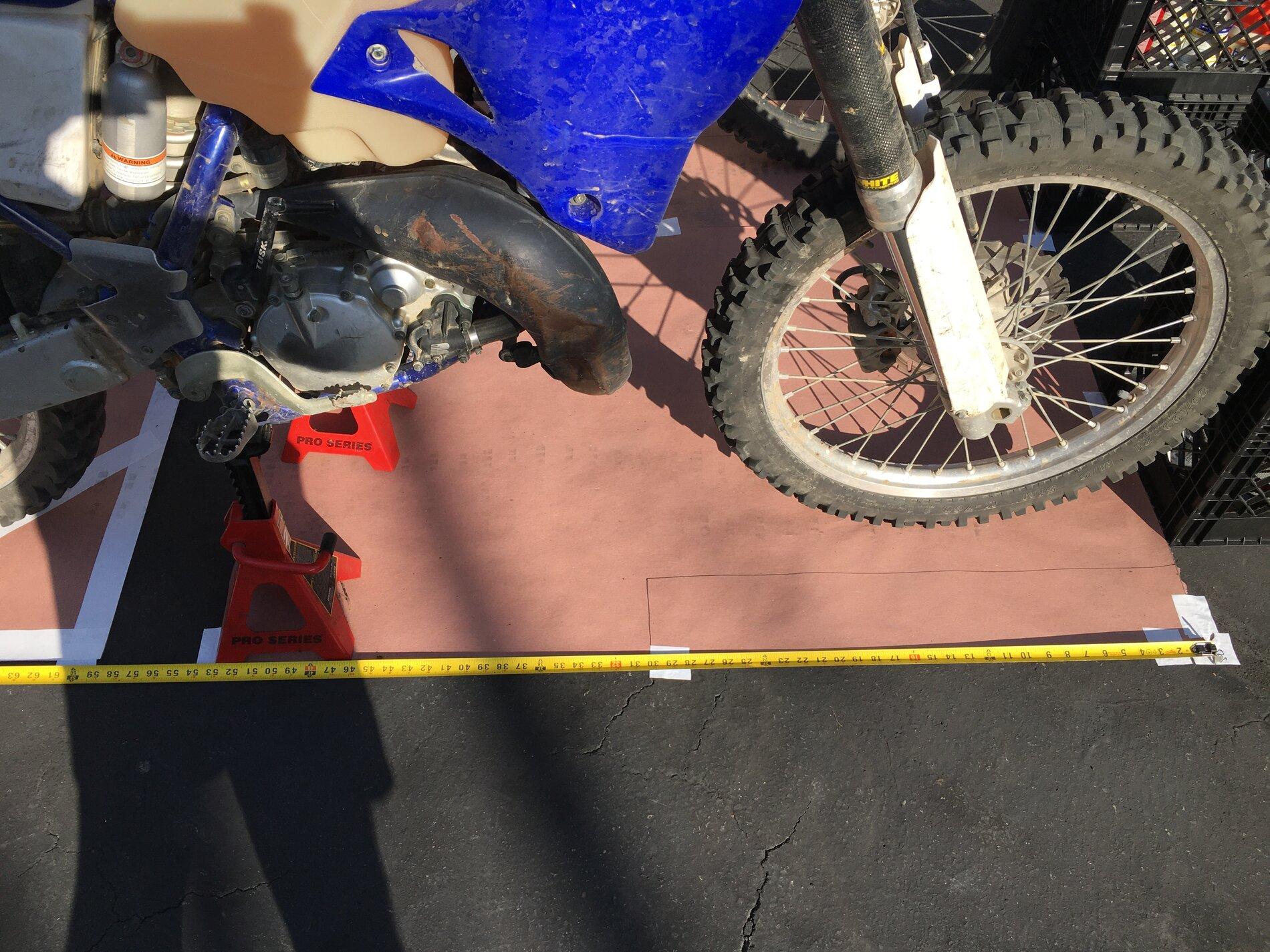

Here’s my take on it.
yes 2 bikes will fit, I would put in some u channel at rails to help distribute the weight of the bike to the bed. Bikes may be light, but when strapped down, I‘m sure it’ll get close to the tailgate load limit.
I know the length of the Sargon with tailgate down in not 100% confirmed, but even worst case of 73” can work. I used 75“ in my mock-up.

ok folks, look at this picture closely. See where the D-Rings are? You need those to attach your tie downs to secure the bike. If you try to put 2 bikes in, the rings will be blocked by your front wheels. I'm still of the opinion 2 bikes are not going in there side by side without modifications and even then it will be a tight fit PIA.

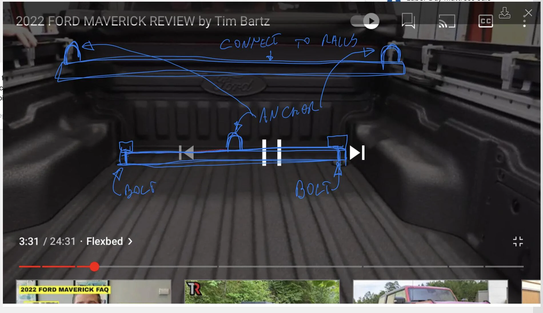

I’ll have to weld something up that bolts where the d rings go that will give more anchor options. Then add a cross bar that connects to the 2 upper rails to get 2 more anchors. I’ll lose some inches on bed length, but I plan on using u channels anyway to get extra length and reduce load on tailgate.

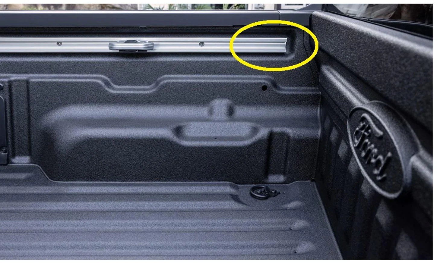

Isn't there an opportunity to add tie-down points using the bolt-in rail feature?
HRG
What an awesome write up lol I’m still hoping I can get my dirtbikes in the bed!

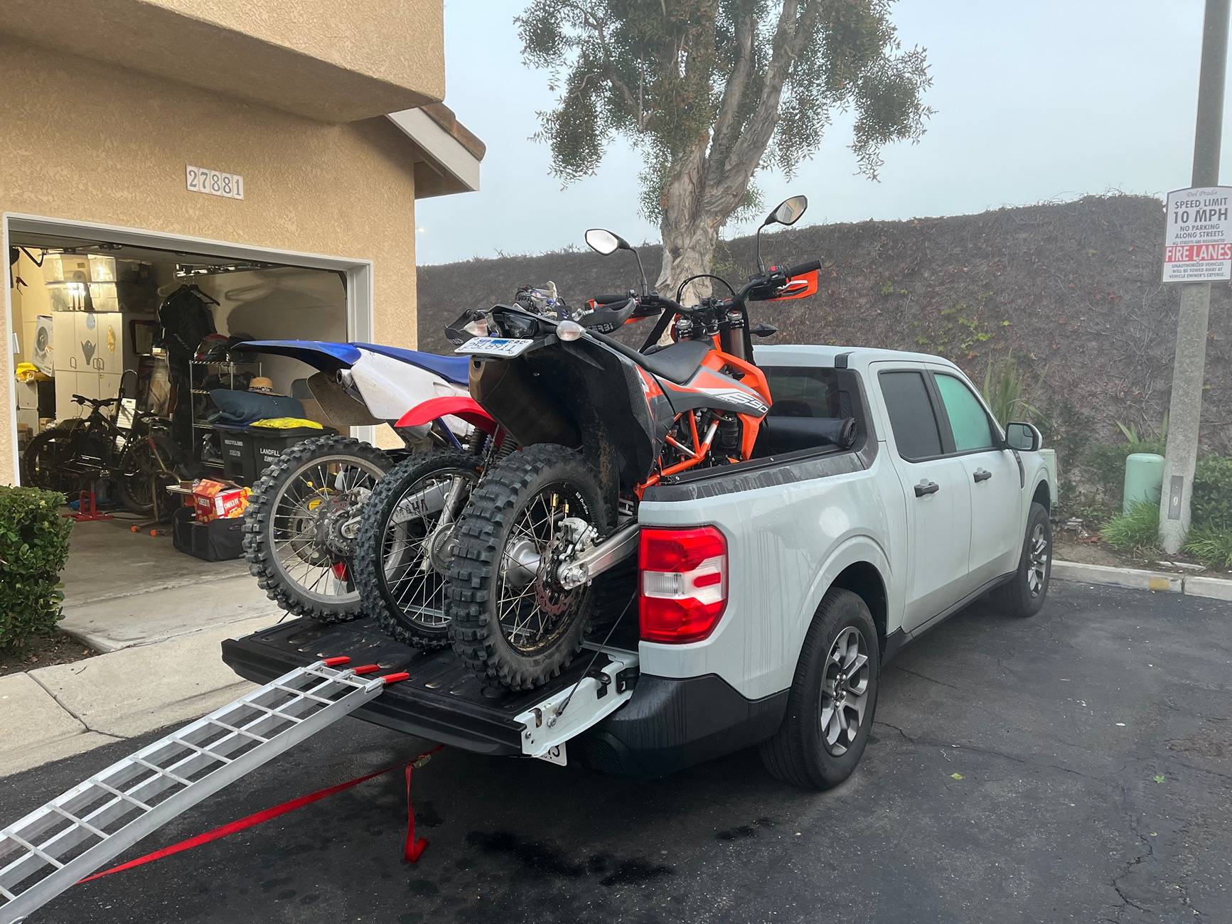

Awesome to see it confirmed and works!
Both those dirt bikes weight about 275 each so no way it is over the 500lb lift gate limit.

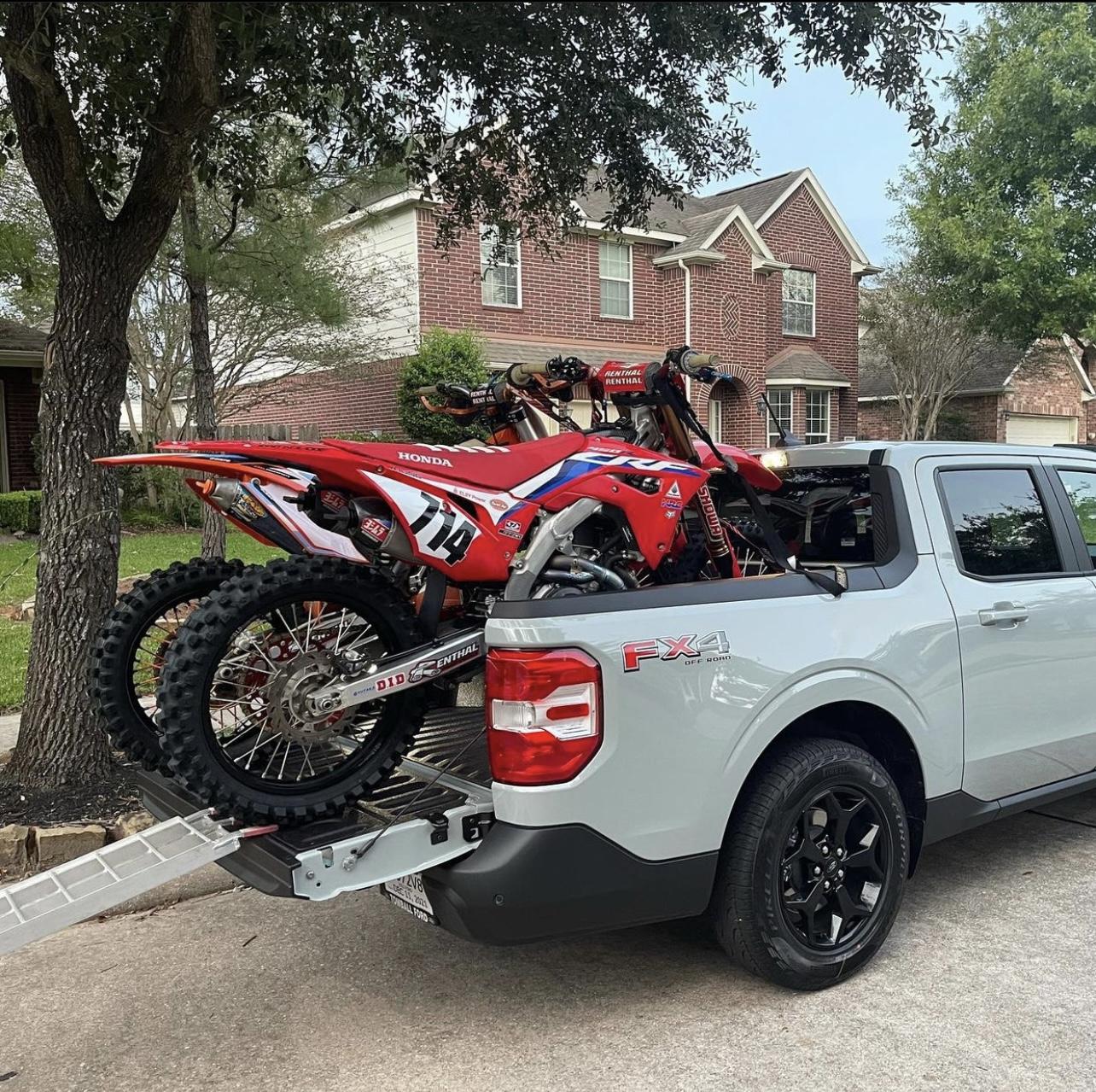

I'm only planning 1 bike in the bed with the tailgate down, but it's a Husqvarna Svartpilen 401. Wheel base is short at 53.4". Half the diameter of the front wheel/tire is 12.5". This gives me a distance from the leading edge of the front tire to the rear contact center point of 65.9". This leaves enough room to also have some type of front wheel chock setup in the bed as well for enhanced stability when transporting. I'm not sure how to secure a regular wheel chock in the bed yet. But maybe fabricating a DIY wooden support using the front flex bed slots would work so as not having to drill anything into the floor of the bed.
Anyway, it'll be nice to not have to get a rental trailer like I've been doing with my GTI... :)
Does it fit like I think it will in the bed? Will it fit with bedliner?

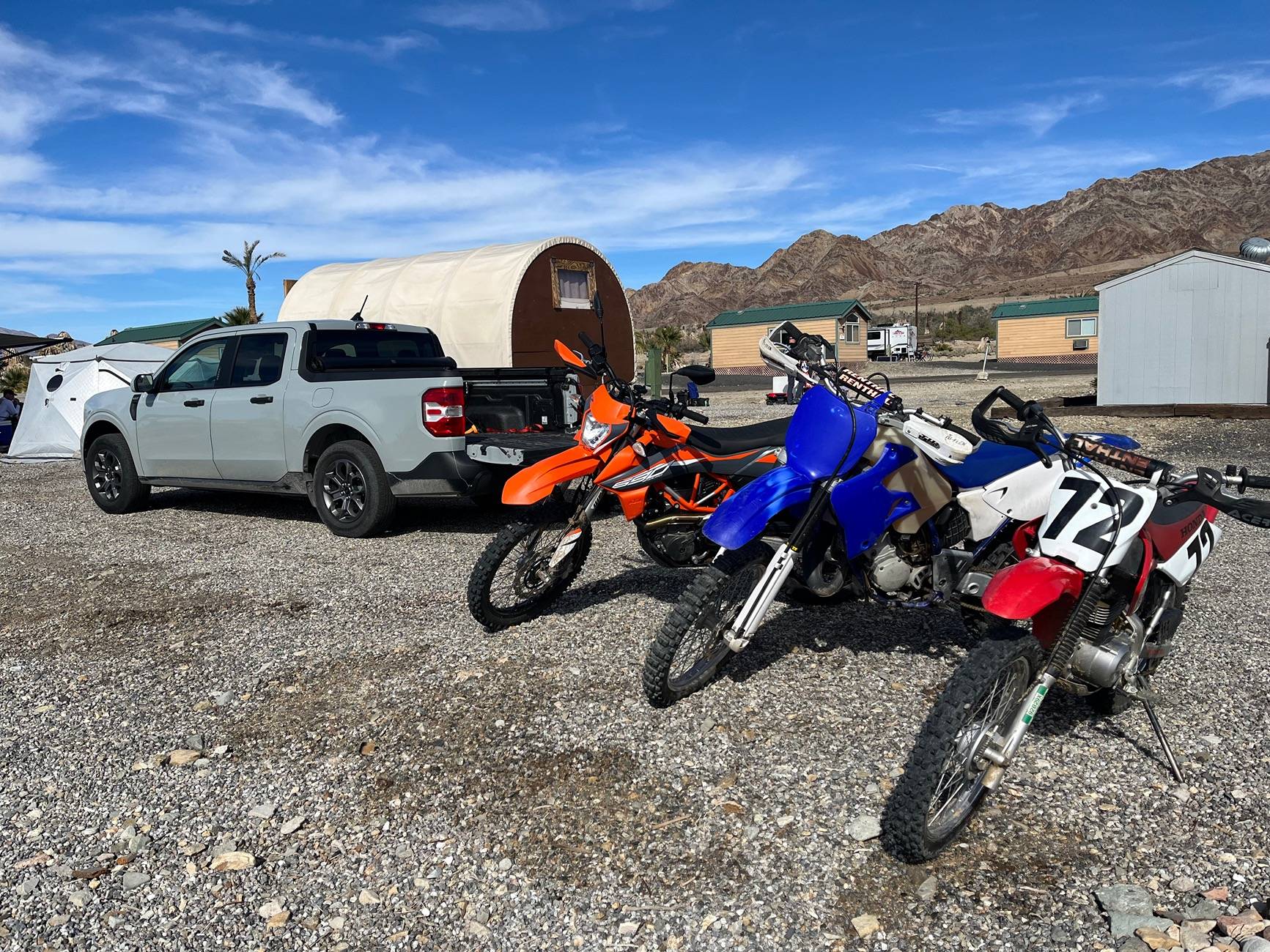

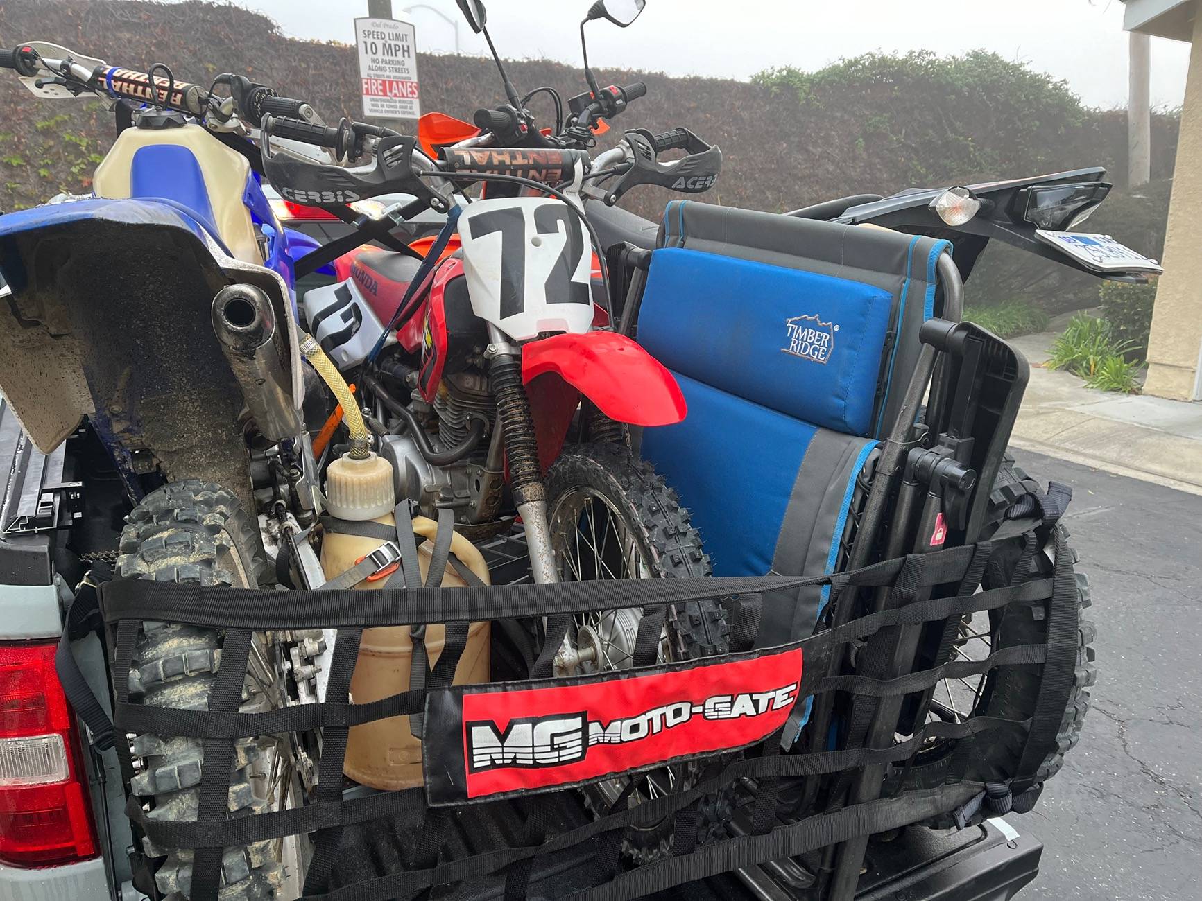

Save yourself the hassle and don’t bother with any extra add ons like wheel chocks. 3 bikes (more like 2.7 dirt bikes fit.) I have a yz125, 690 enduro, and an xr100 in the middle. Works fine using straps only. Need that extra piece of mind, get a tailgate net.
