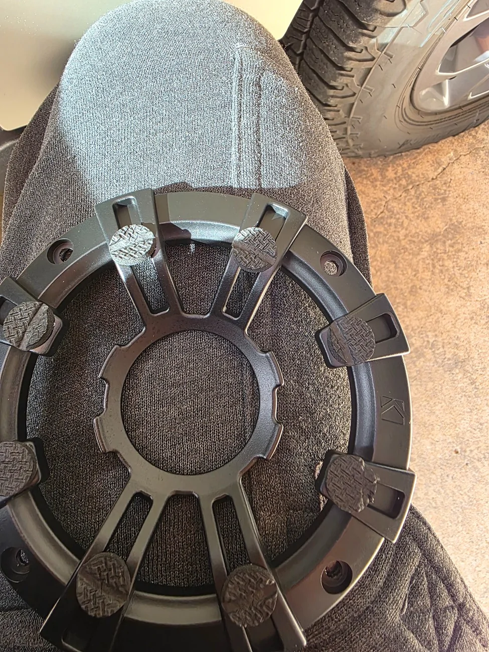

After removing the real speaker panels for the fifth time, I have finally solved my rear speaker rattle issue. There was no rattle with the stock speakers of course, but after installing a four channel amplifier (with powered sub-woofer), I was forced to turn down the rear balance to not overpower the stock rear speakers. After upgrading to a better rear speaker, I was left with a VERY annoying rattle at certain frequencies.
The first step was insulating the speaker grills with foam pads and it helped, but did not solve the issue.
Step two was hot gluing the speaker panels separate panels together, again it helped but did not solve the issue.
Step three and final attempt worked. The self stick rubber sound deadening sheets did the trick once and for all.
I can't say if the sound deadening sheets would have done the trick by themselves, as I didn't do it in that order.
If I had to do it over again( with hindsight) I still probably would do all three.
I can finally enjoy my music like I had planed all along.

Ford Maverick Finally stopped the rear speaker rattle issue Sound deadening panel
Ford Maverick Finally stopped the rear speaker rattle issue Hot glue panel
Ford Maverick Finally stopped the rear speaker rattle issue foam pads on grills
It sure would be nice (and reasonable) for Ford to offer the BO system on lesser trims, but instead they force you to buy leather seats and low profile tires to get the good sound systems, both of witch would be deal killers for me.

I added those same speakers in the rear. I slathered sound mat over everything back there when I had the panels off and it had a much bigger impact than swapping the speakers IMHO.
