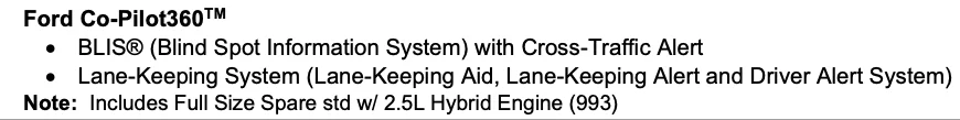

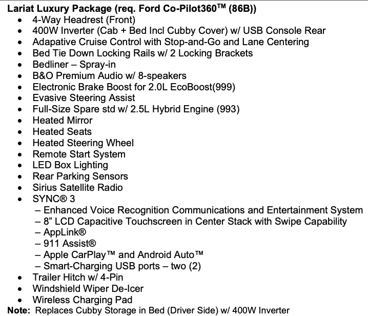

A stock XLT even with the Luxury package won't have the rear parking sensors, that was only available on the Lariat Luxury trim. You may be thinking of the rear cross-traffic alert, which will beep at you if there is an object moving sideways behind your vehicle. The cross-traffic alert won't help you back up close to static objects, like a garage wall.
jsus
Dec 20, 2021
2,883
3,883
2022 Ford Escape Hybrid AWD
Exactly. Not sure what's going on here. You don't have the rear parking sensors without either a Fleet ID # (and fleet order) or Lariat Luxury Package. Co-Pilot360™ does include the cross-traffic alert, which are in the corners of the rear bumper. Those would let you know if something is coming from the side when in reverse, but not if you were getting close to something directly behind you.
