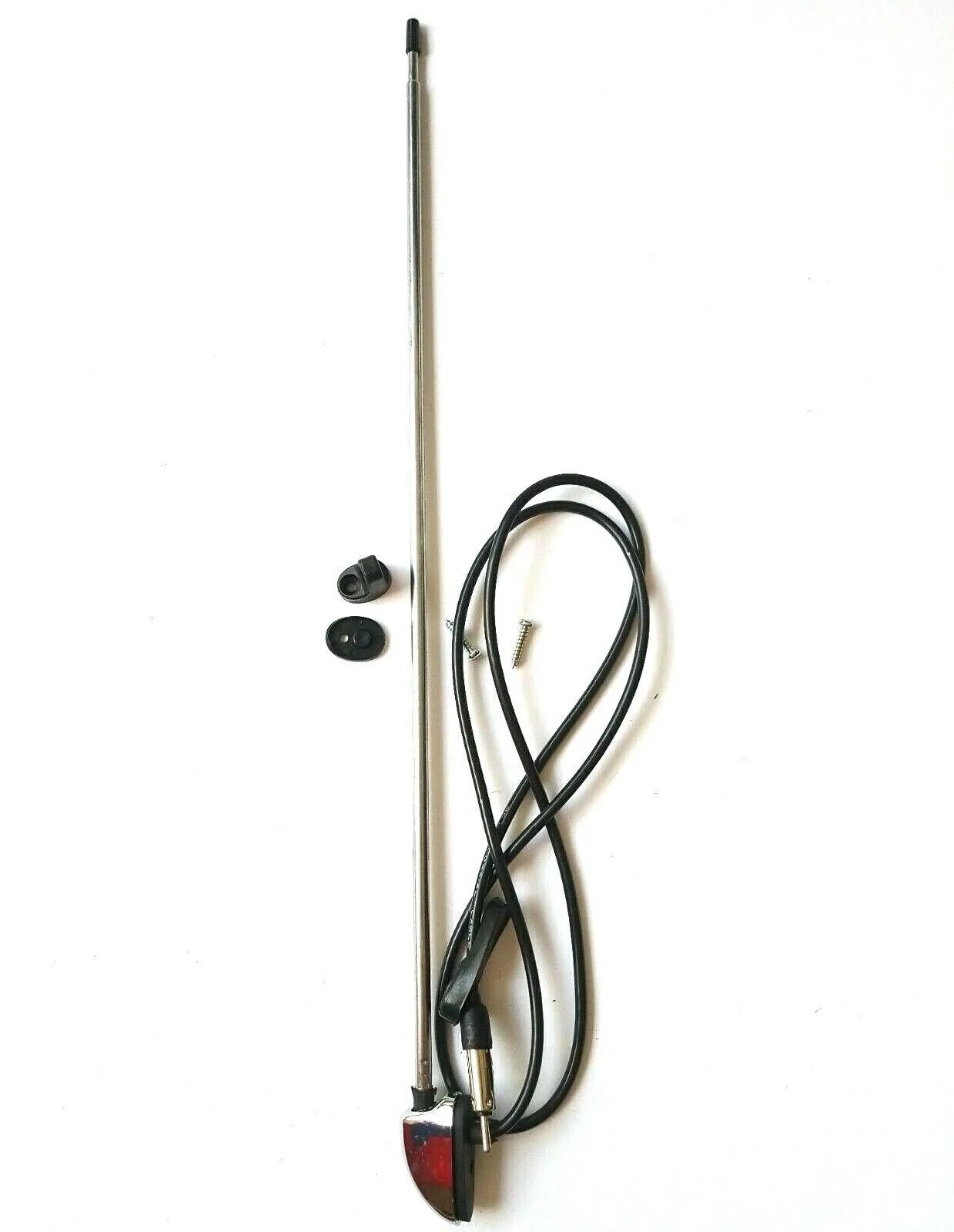

Size matters. The wavelength of a station in the middle of the FM band is about 3 meters in length. A quarter-wavelength antenna is roughly 2.5 feet long. One reason why old-school car FM antennas worked quite well.

Physics are at work and there's a limit to how much fn magic electronics can do to fix an antenna that simply isn't big enough to resonate well with the wavelengths trying to be received.
As the popularity of listening to tapes, CDs, and later, streaming stations increased, terrestrial broadcast radio listening declined. Sadly, auto makers began to look at making the radio antenna look better, at the expense of performance. Same with TV, people consider rabbit ears antennas ugly. But they nearly always work the best for indoor TV (and FM) reception, vs "pretty" antennas.

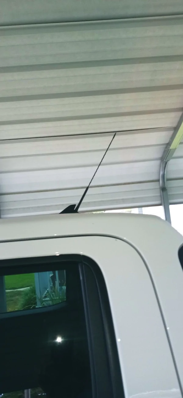

I did improve mine with a longer direct screw on antenna from Amazon. Can't find the link (or know how to post it if I did), but at the time over 18 months ago there were many options. It's about twice the length of the Ford OEM one and a solid twisted rod type with tip and fatter base. Reception much improved; particularly HD reception is more frequent and reliable is where I notice it the most. More channels received also, I think. Came with multiple thread adaptors to fit several applications, did say it would fit the Maverick.
