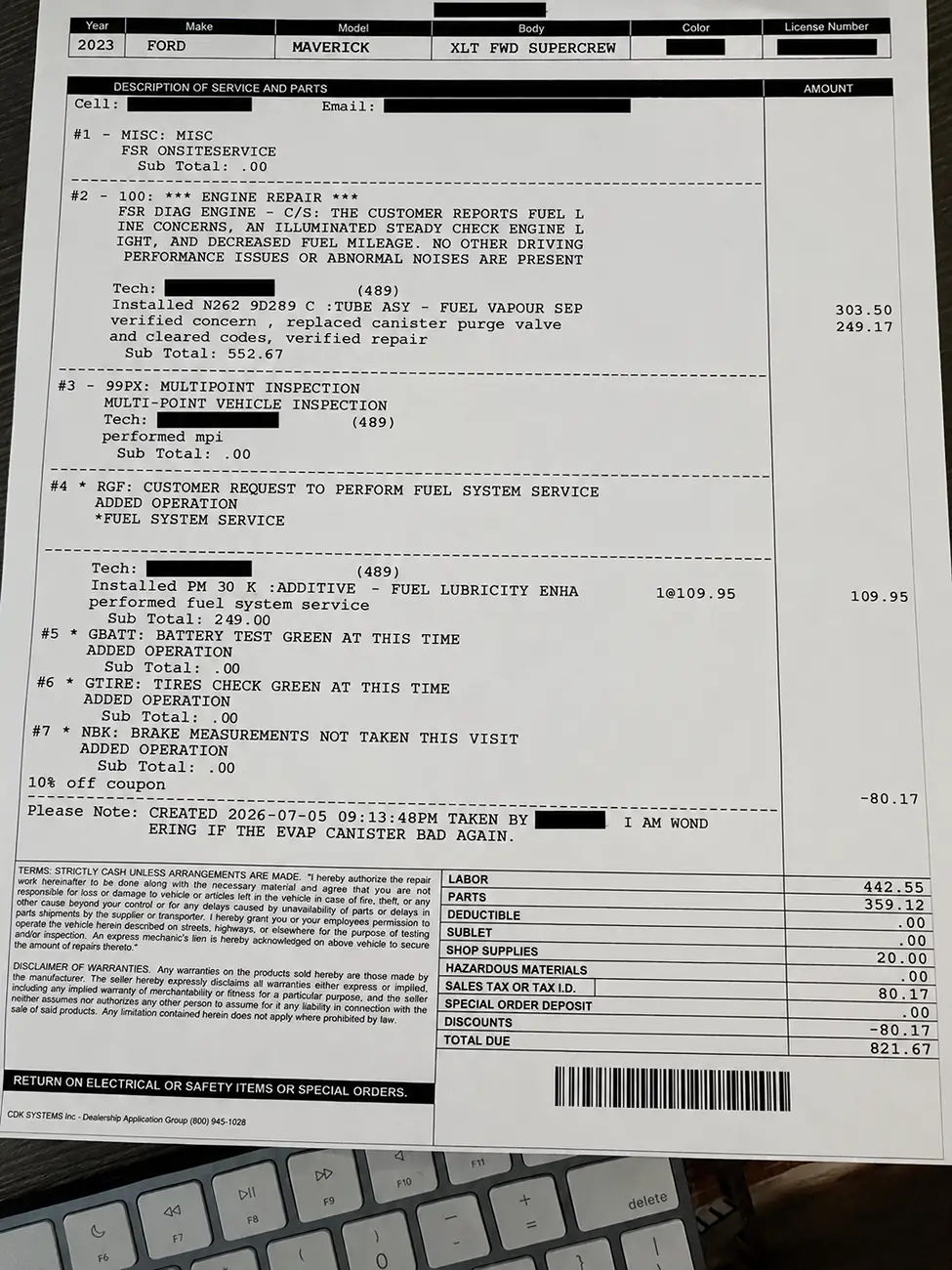

I'm curious if anyone else has experienced this.
My 2023 Ford Maverick Hybrid (67,156 mi) recently developed a Check Engine Light, along with a noticeable drop in fuel economy.
The dealership diagnosed the issue as a failed EVAP canister purge valve and replaced it.
While it was there, I also had a fuel system service performed.

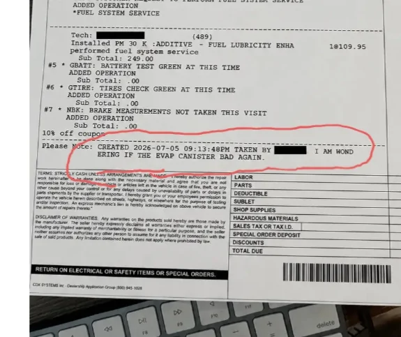

Why does it say
"wondering if evap canister is bad again"?
That was my comment when I scheduled the service visit. I thought the canister went bad. Had it replaced at 38,000 mi and again around 64,000 mi without overfilling it
