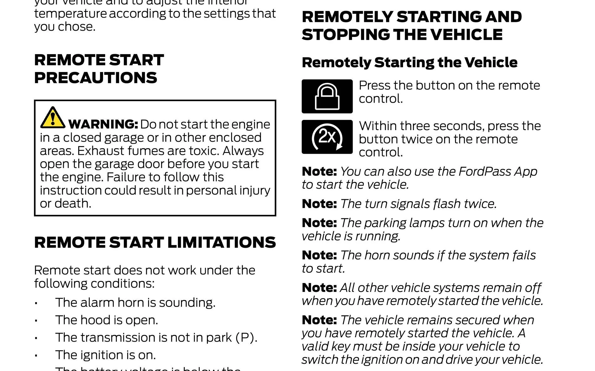

So you're 23 lariat didn't come with a key fob that you can use to remote start your truck like by 24 XLT does? Where you lock once hit the button below that twice and get a confirmation on the key fob small green flash for it worked red flash for it failed?
I can't believe I had never sen this! I just tried it and it worked! It's a lot faster and easier than the app!
Yep, directly from the owner's manual. My 24XLT came with one along with a Ford Velcro booklet. I also have one downloaded to my Samsung Galaxy tablet.😉👍

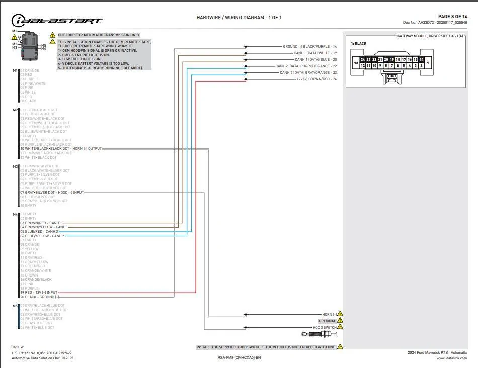

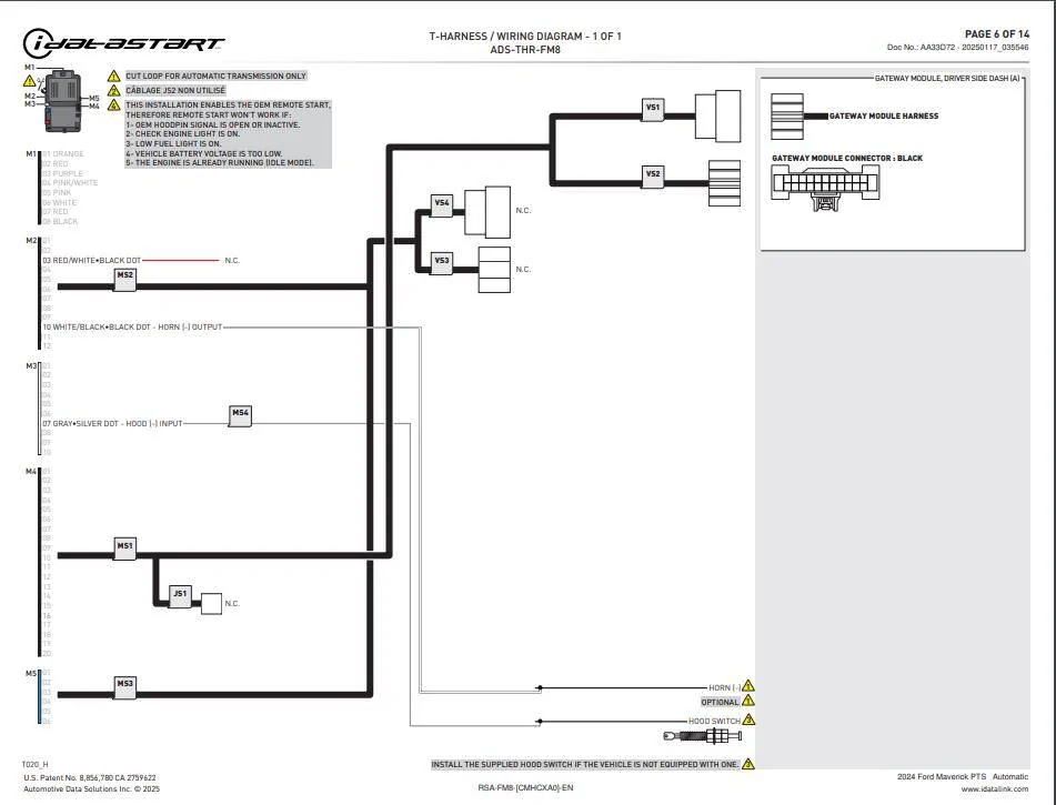

remote start for aftermarket is activated at the gateway module (behind OBD2 port)
I've been installing remote starts for about 20 years. For anyone wondering here are the diagrams from Compustar/iDatalink:
One is the T harness version with no wire connections and the other is one that is hardwired.
Startex has a T harness, which makes installation simple. The hardest part is getting to the OBD2 port.
that’s what the first page is of the compustar. The Startex would be the same.
