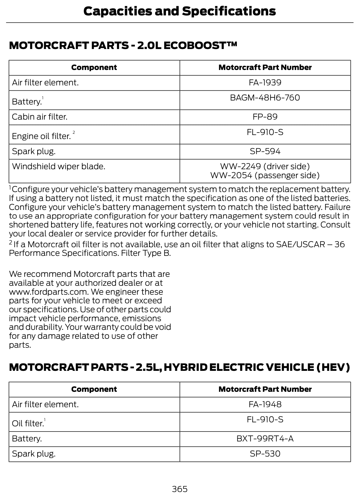

If you’re going to have to make room to make it fit anyway, why not just go with one much larger 48H6 AGM battery like many Escape Hybrid owners have done, which by all accounts seems to clear up almost all issues pertaining to low 12V SoC?
2021 Escape manual even lists that battery for replacements although 2022 regressed to the tiny 99RT4.
This seems like a good idea. I'm curious why the manual specifies an AGM for the EB but not the hybrid though. I noticed that AutoZone says AGMs require specialized chargers - maybe that's why? I'd be a little concerned about installing one if the hybrid doesn't have the necessary equipment on board to keep it healthy.
Simply just a matter of changing the battery type in the programming. You can do it with FORScan.
Interesting. Lots of 2022 Ecoboost units were not AGM. Mine wasn't and neither was the replacement.
jsus
Dec 20, 2021
2,882
3,879
2022 Ford Escape Hybrid AWD
Also, the hybrids have generally gotten an even smaller battery than the undersized 99RT4 the manual calls out for replacements. Why the inconsistency, I have no idea.
