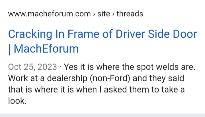

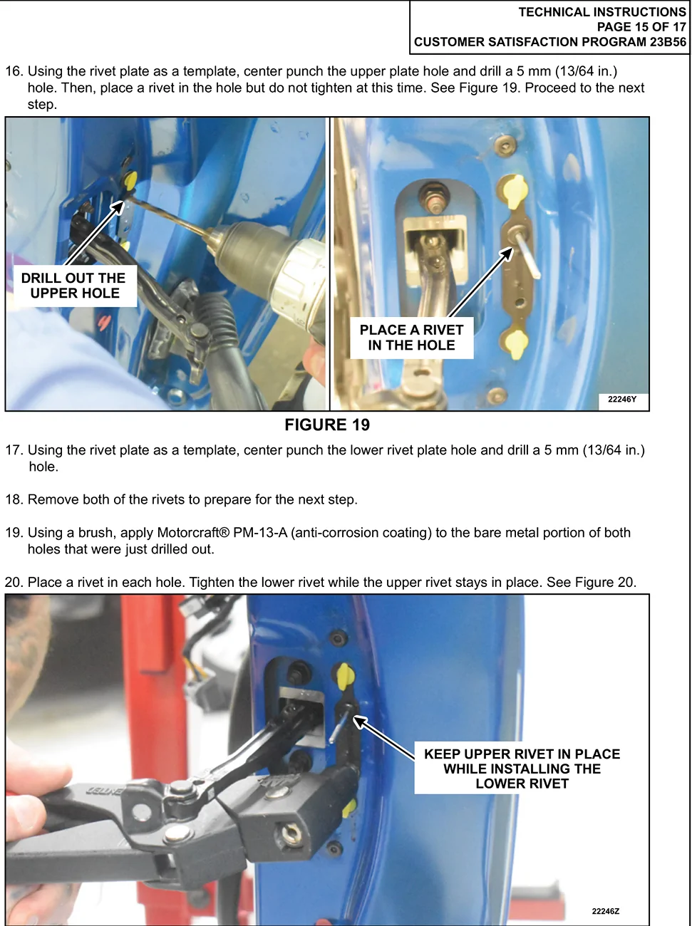

Similar to Escape door check arm. https://static.nhtsa.gov/odi/tsbs/2025/MC-11012204-0001.pdf
10/2/2025
22 Lariat - Broken driver side Door Check https://www.mavericktruckclub.com/forum/threads/22-lariat-broken-driver-side-door-check.73854/
8/11/2025
(2023) Door Hinge Weld Repair - Anyone have this done? https://www.mavericktruckclub.com/f...air-anyone-have-this-done.71525/#post-1182644
7/15/2025
(2022) New noise - clicking sound when open the door https://www.mavericktruckclub.com/f...-sound-when-open-the-door.70193/#post-1162921
11/29/2024
(2022) Maverick Warranty coverage AGONY! https://www.mavericktruckclub.com/forum/threads/maverick-warranty-coverage-agony.57793/post-976489
He tells me it only needed a door reinforcement kit installed and respray. So I look at the door stop and there are now pop rivets in my door.
11/7/2023
(2022) - The door broke https://www.mavericktruckclub.com/forum/threads/the-door-broke😮‍💨.39172/#post-701716

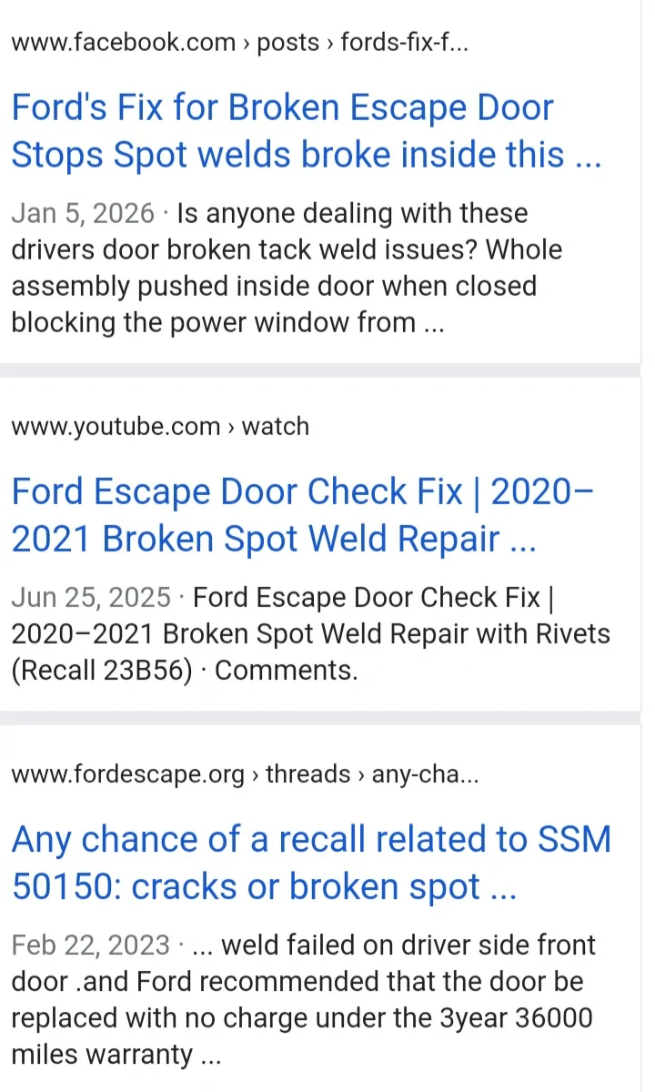

It's a known problem on Ford Escapes which is basically the same platform for a lot of parts on our Mavericks. It is also happened on the mach e

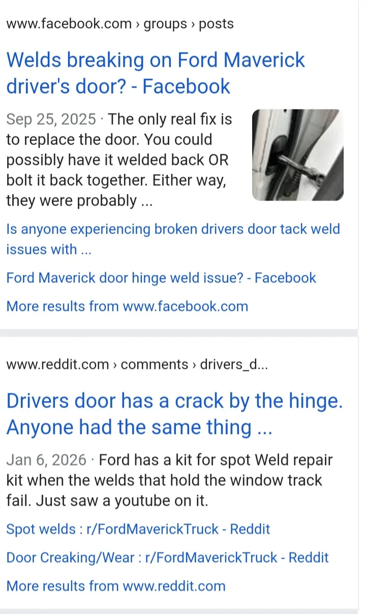

I had a "snapping" sound on my driver's door when opened fully. I just stopped doing it, and now carefully open part way to the detents. I know that's not the right answer, so don't lecture me. Wind caught it yesterday and blew it full open - heard that snap.
One member here got that repaired. The Ford dealer tech warned him that would not be repaired free out of warranty, and that it's a dang expensive repair. But I don't intend to own my Maverick much longer.
So OP, it's a real problem. Probably the right answer is to complain and get it fixed before warranty expires. Probably the wrong answer is what I did - nothing.
