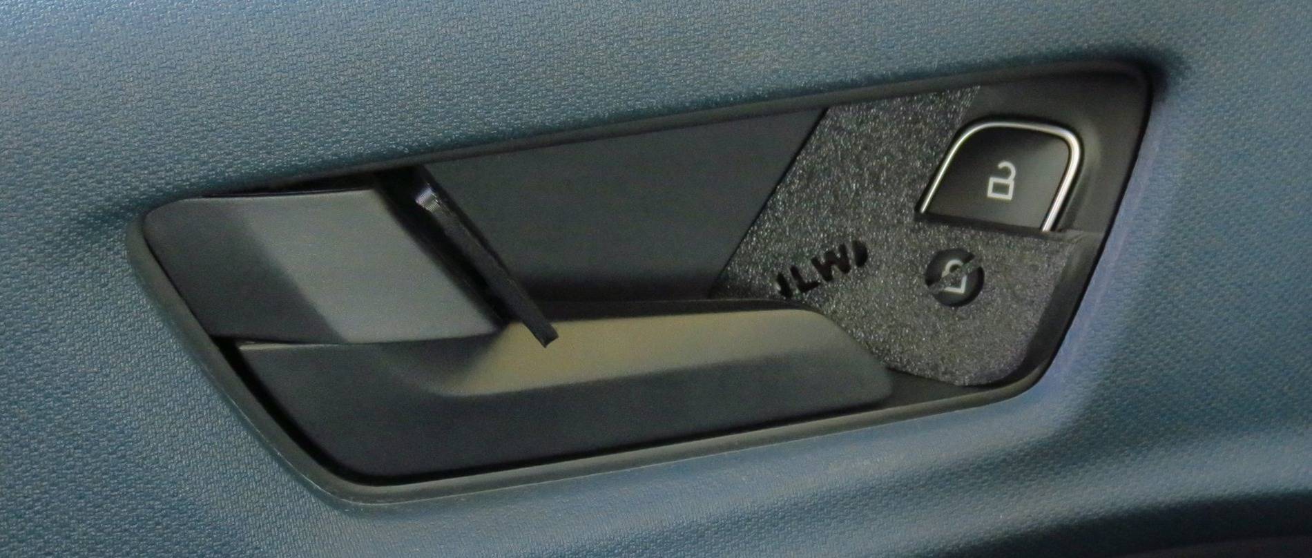

Folks , if i am accidently hitting the lock button upon exiting why are all the doors not locking ??
Because there is a manual lever just above the door handle. It is black, just like the handle pull. It's kind of hard to see. It is not the power button so if you push that lever in with the side of your palm when opening the door it only locks the driver door.
I pull the open lever with my pinkie and push the door open with my elbow 🤫

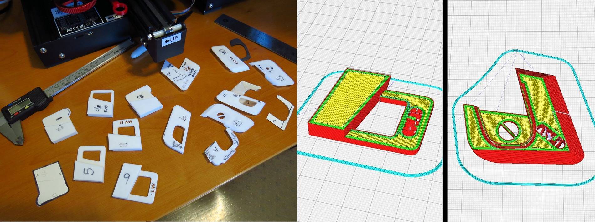

The accidental locking had plagued me too. I got super irritated and fixed it. Made a simple 2-piece 3D printed solution that works well in preventing accidental pressing of the lock lever and button. Took a bunch of iterations though, like anything worthwhile does.
Ford Maverick Driver Door Locking 220962-b3423ede4c8cec9b0ab5f6d172942cd7
Final version:
Ford Maverick Driver Door Locking 220963-da465f022406165c4d3a29ae343a76e9
Read more about it here. They're available If anyone else wants a set.
