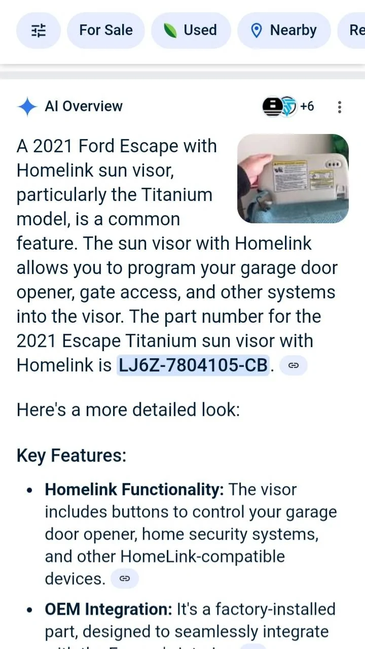

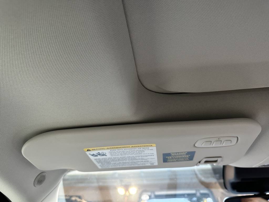

I've been running a Homelink visor from a '21 Escape for a couple of years now. It's actually a better fit than the Bronco Sport, the mounting bracket is slightly different on the BS. I've been happy with it. I did install a auto dimming mirror, had a Ford auto dimming mirror left over from an old car and install it, ran a line and tapped off the connection for the visor. The biggest reason I wanted the visor was my Bronco has the Homelink visor along with several other older Fords I had and I just naturally reach for the visor.
A 2025 Bronco works too although it's a tight fit.

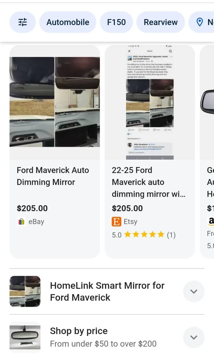

Or there are self dimming mirrors that have Homelink buttons on them that you order through Amazon.

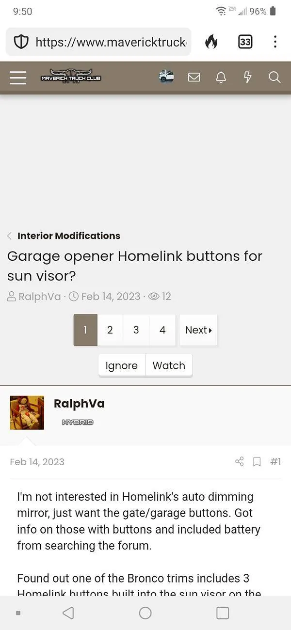

There is a thread discussing this. Sounds like a 2020+ Escape visor with the buttons may work. Check out the attached thread.

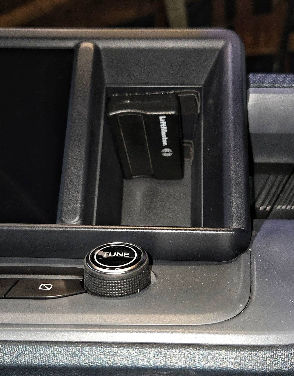

You know the old saying about wishing on 1 hand and doing something else in the other? Well i recommend you keep wishing but no one makes suck a thing yet. Several threads on the forum of what others have done to correct this. Me? I put the remote in the cubby next to the infotainment screen.
Same here. I velcro'd it to the top of the cubby. Not really visible from outside the vehicle, either - if one lives where that might be an issue.
Ford Maverick Driver side Visor with door opener buttons 20250606_135008
If your opener is too big to fit, get a smaller one. This one's not expensive and has good range.
