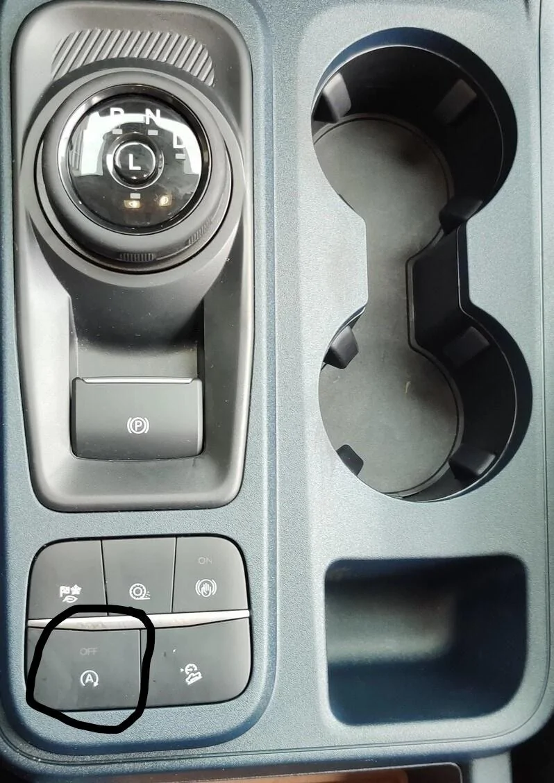

I have been noticing lately that my 23 Lariat Lux has not always been auto stop/start when I come to red lights, etc.... and that was starting to worry me. I have not turned off the button or bought one of those eliminators that most are talking about. I actually dont mind the feature. But after reading this post, I did some searching. I cant find more detailed information but this is from/on the website version of the owners manual that I found under the "auto stop/start - troubleshooting - FAQ's "...

So seeing I live in the midwest and it has been chilly out lately and I have some heated features on in the morning, it appears that the truck has parameters it needs to have before it will allow the stop/start to work. Hope this may help
