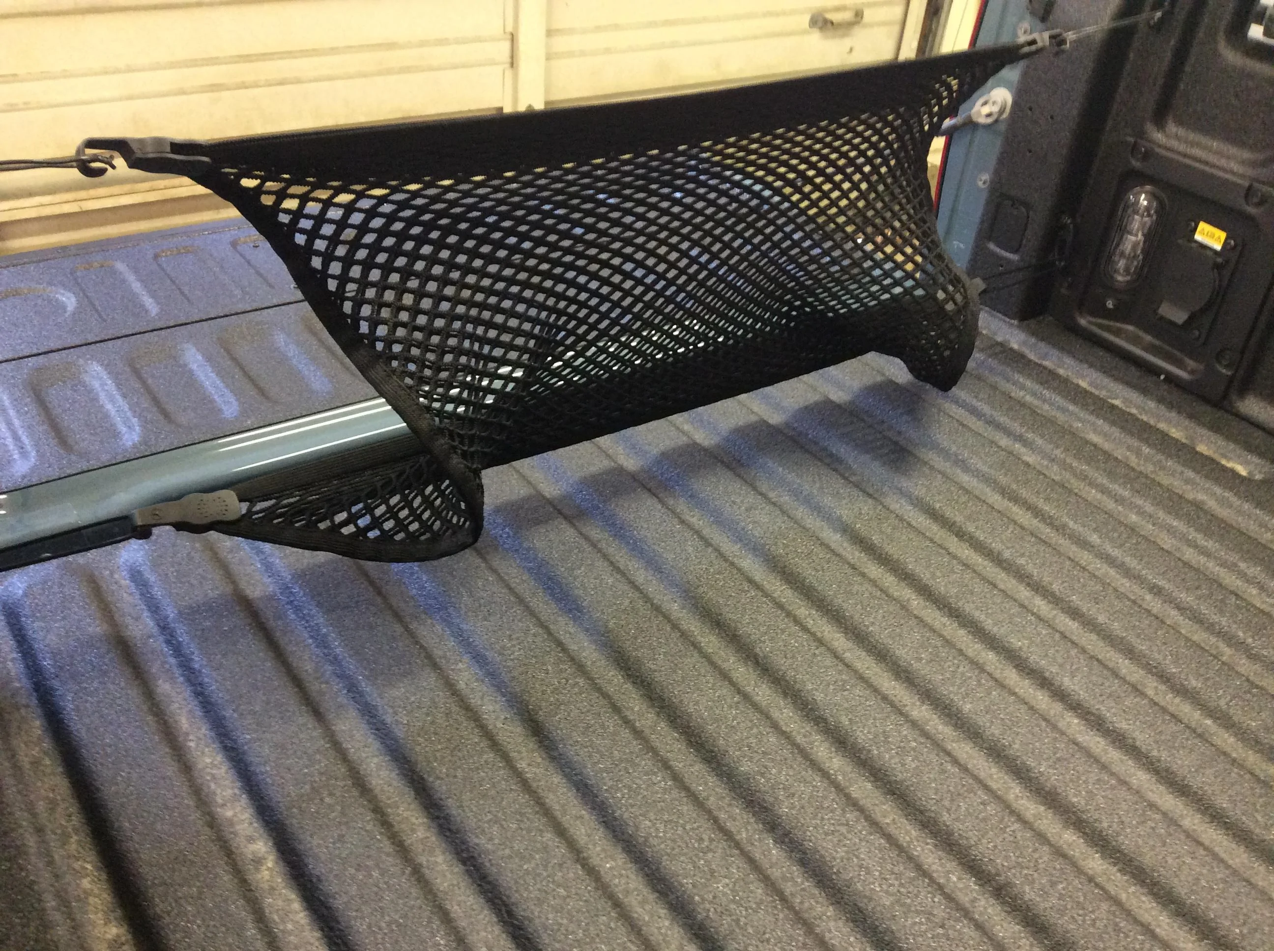

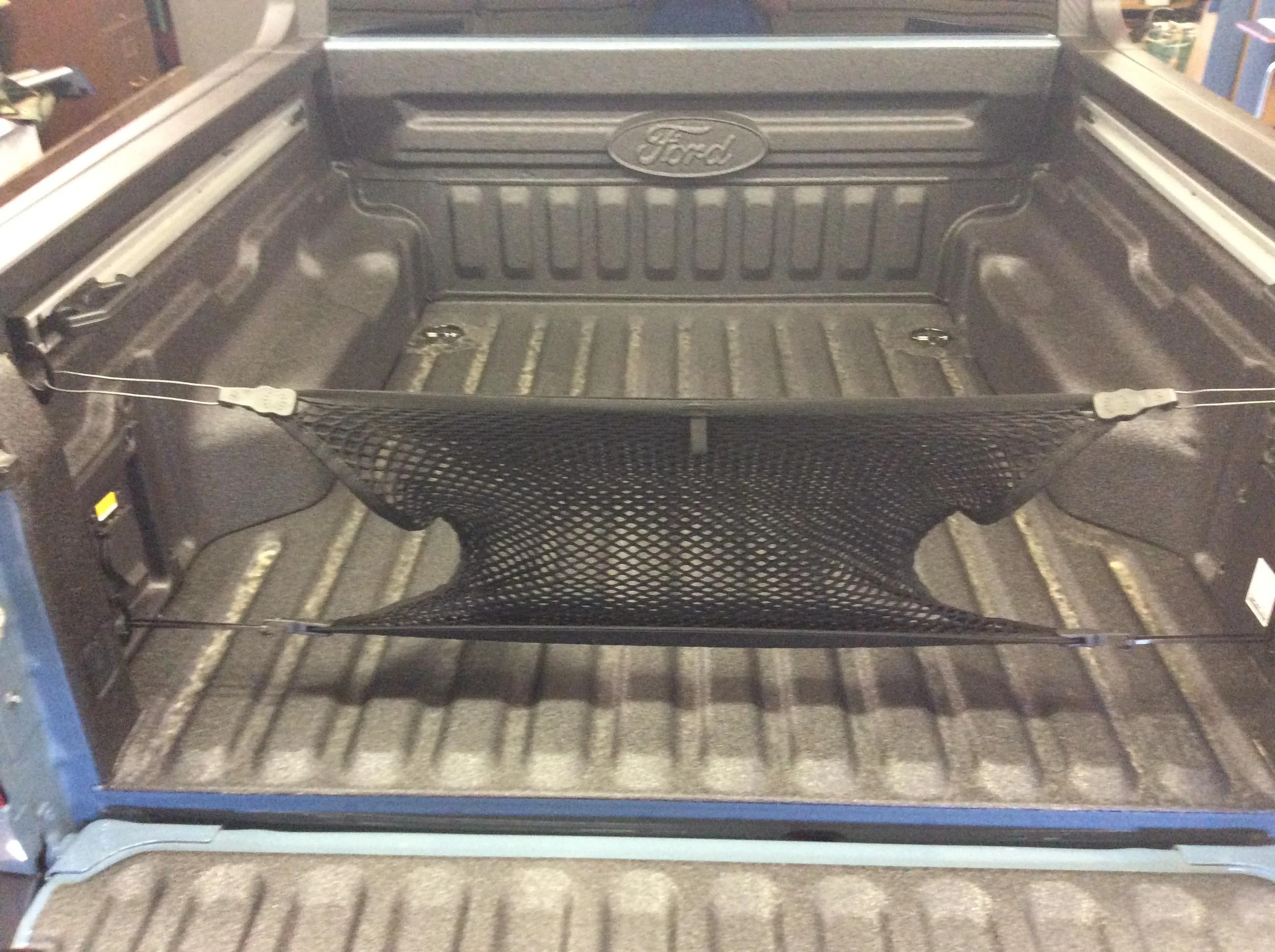

I will utilize the bed with a divider or cargo net for somethings but....

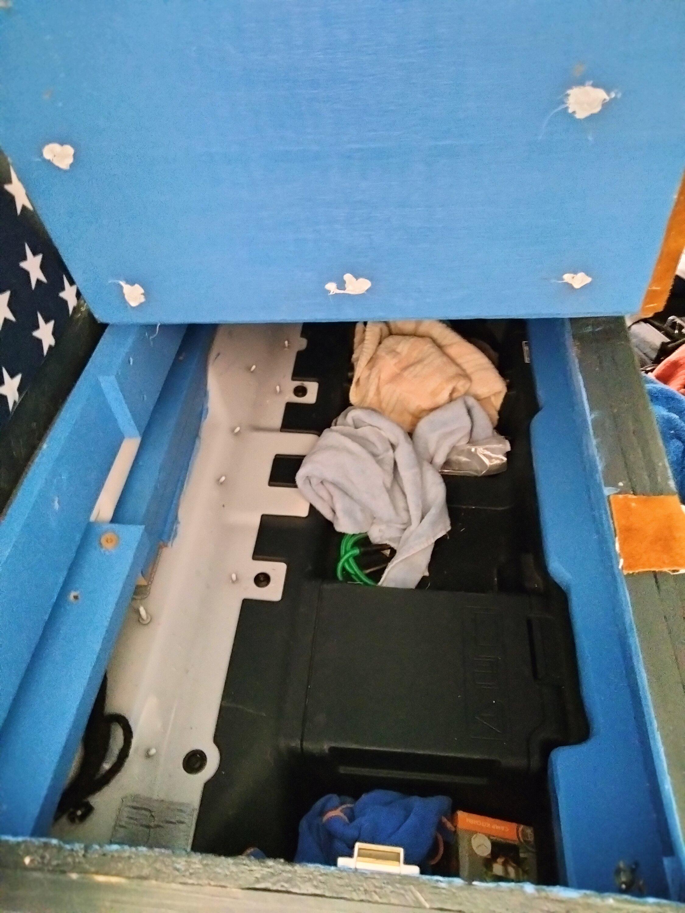

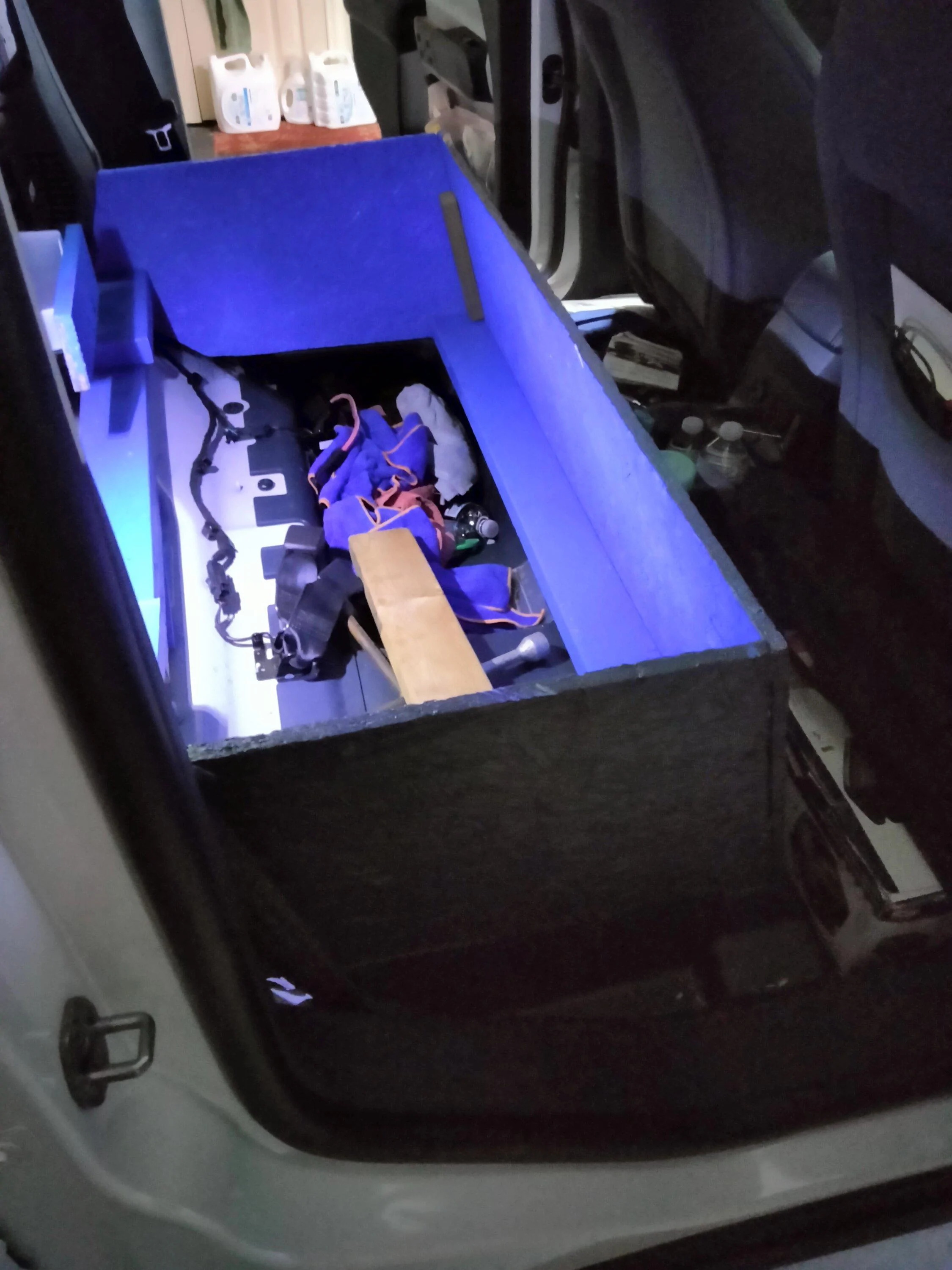

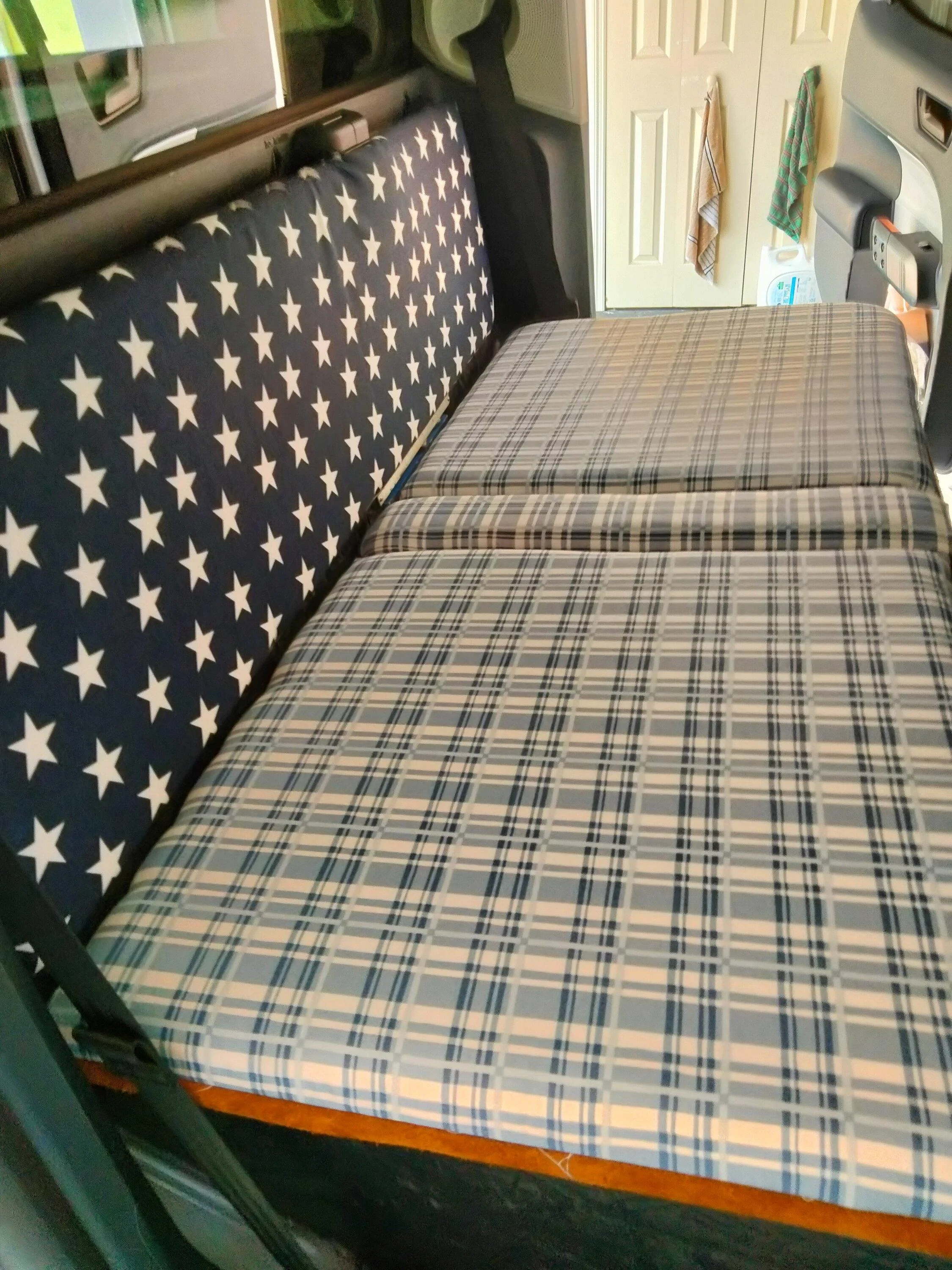

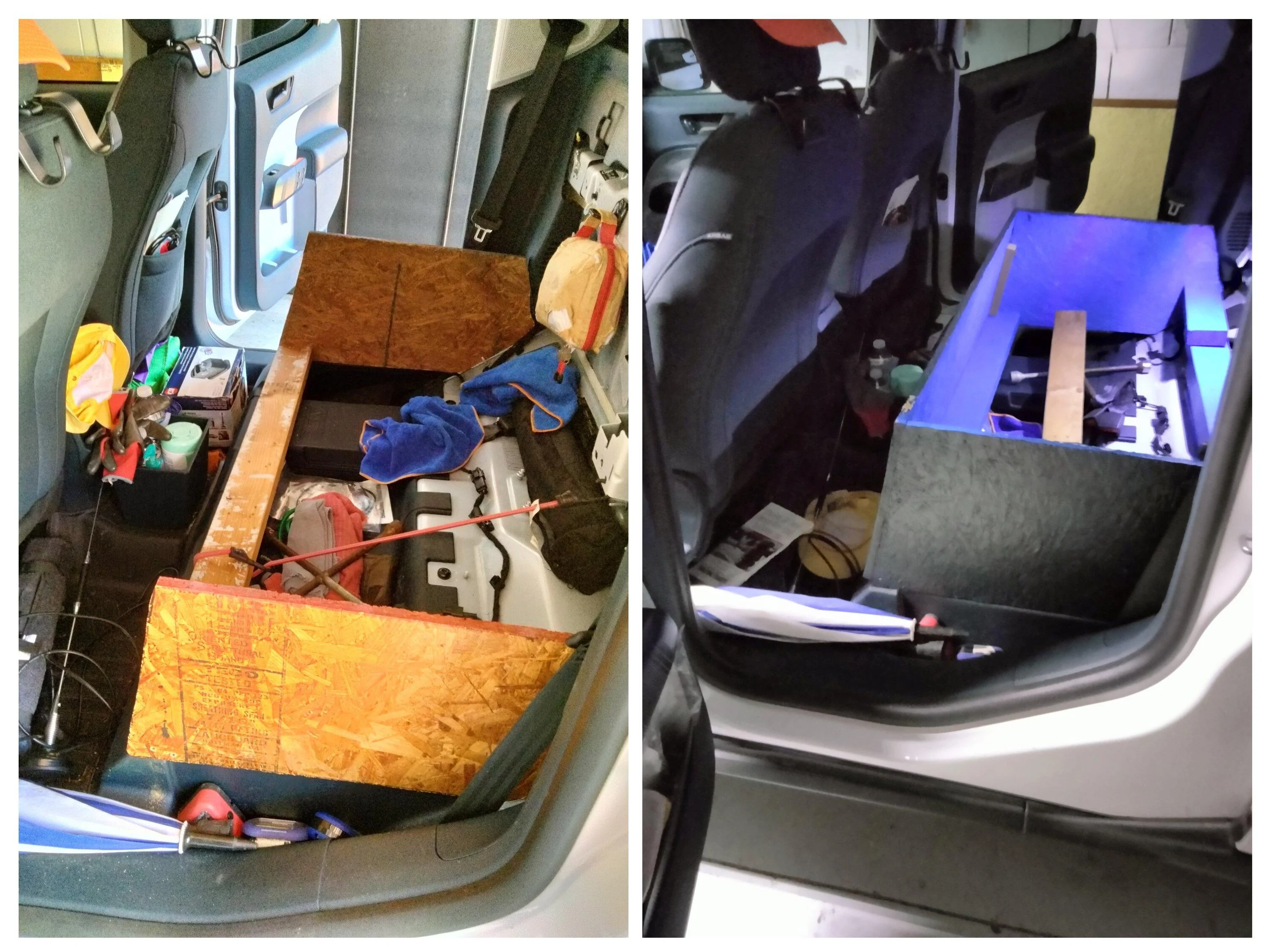

I took the stupid seat out completely and stored it in the attic, then built an awesome storage area where the seat was. I used the jack attachment studs to anchor the back and the pockets that anchor the seat bottom and used a threaded cross bolt to secure the front, built it out if 7/16 osb, I bought 18# gas struts for the lids. The seat is poorly designed and gobbles up too much room.
Oh wow, you did it proper on that seat removal! I don't know about the color palette or the cushions, but you made it all fit very well. I'd like to see some more pictures of this from a wider angle. I like the idea of what you did there!

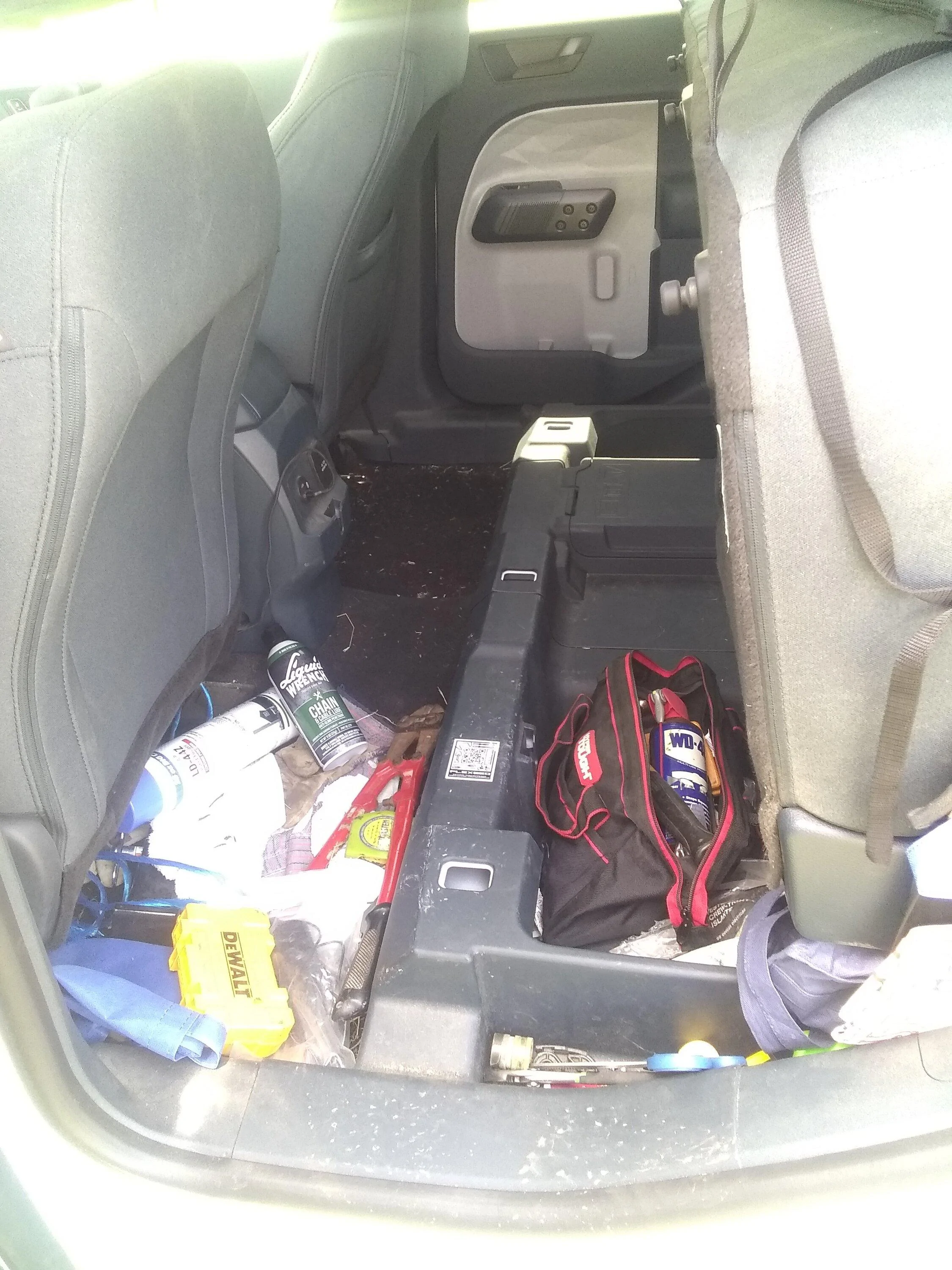

Pull the back seat out, no worries about it folding flat. You can haul a lot of groceries this way.
I used what I had on hand for the fabric, the upholstery shop wanted $125/ yard plus $100 shipping to get something close to the seat colors, it would have taken 3 yards to do the work, the plaid wifey had the stars on navy Walmart had for $14. The OSB I had, and the 3/4 ply was leftover from the same thing I did in the PriusV and carpeted. Lowe's color matched the fit panel to the paint on the outside the is ide was a mistint I had.

Thanks for the pics Mark! I was just messing with ya on the upholstery, function is form after all, so I get it. I bet you have so much more useable space in the back of that Maverick now!
