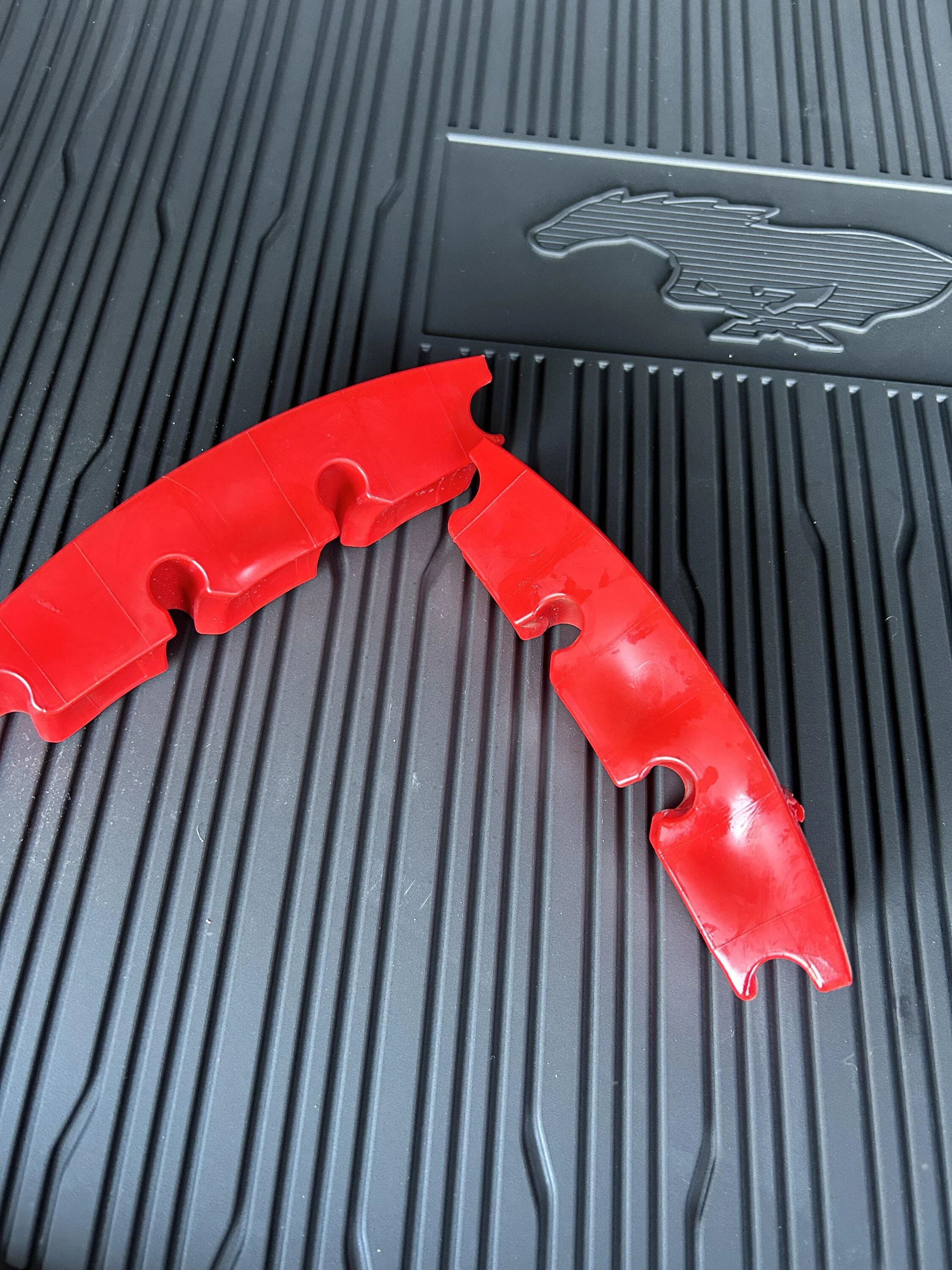

I have a '22 XLT with the tow package and it rides really nice compared to other vehicles I have owned. What were you driving before the Maverick?
Also I know it's a long shot but check your springs. The factory installs shipping spacers and sometimes they are not removed during PDI.
These are for a Mach-E but the Maverick ones look similar.

I had a '22 Ranger XLT but swapped out the rear shocks for Bilsteins. Made a big improvement. The Mav rides WAY firmer. And we have relatively smooth roads in NC.
