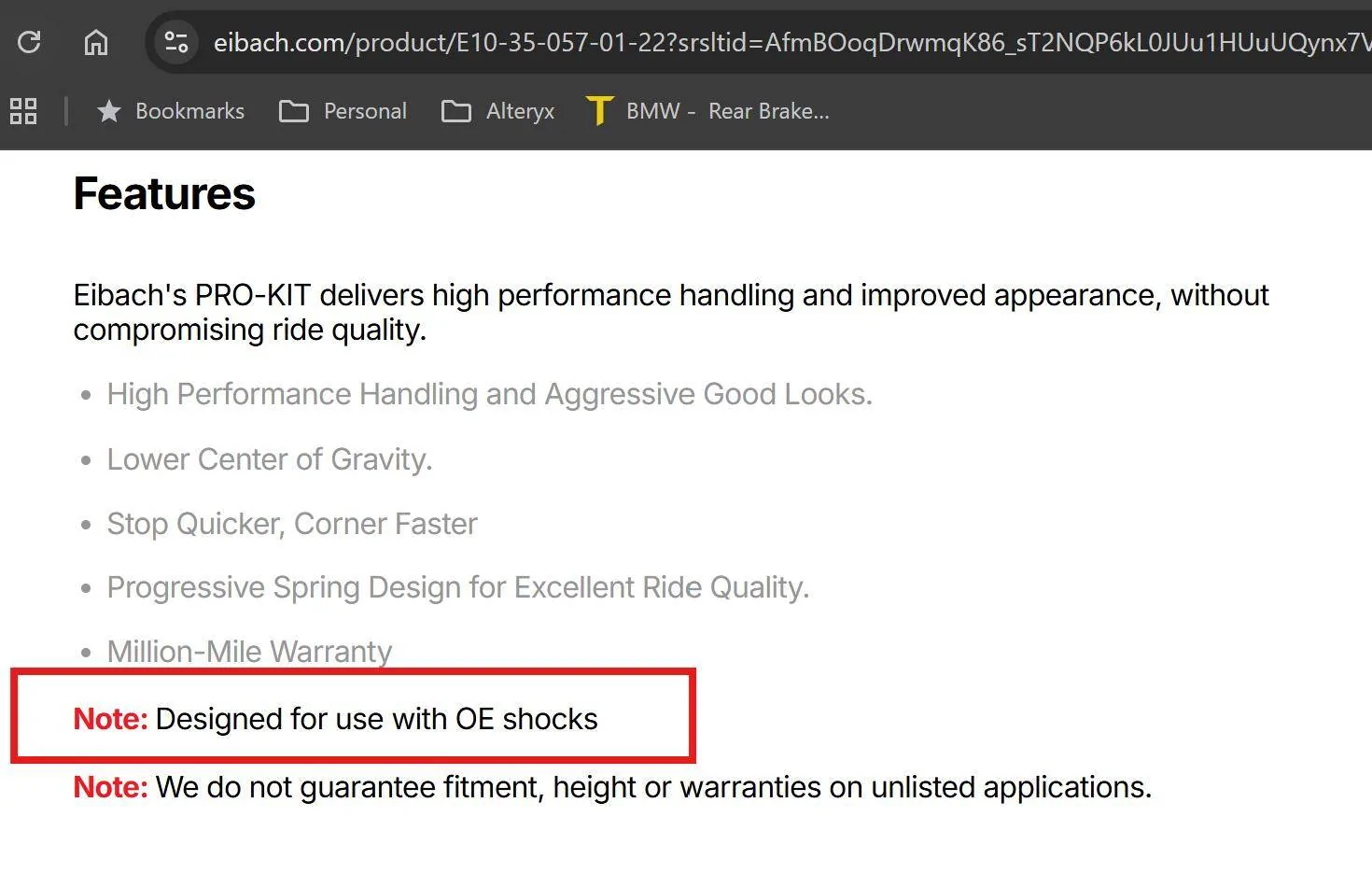

All you lowered folks, do you replace shocks too?
Nemo
Feb 15, 2024
79
81
24 Maverick XL
Lowered on Eibach springs. Hit some potholes recently and heard/felt a hard hit on the front. Put one wheel up on a ramp to see where it bottomed out, thinking maybe it was the sway bar end link. Didn’t see anything and the end link (using longer ones, so that the sway bar is closer to original position) has a bunch of room. Thinking that it is the shock bottoming out. Instruction say to slightly cut the front bump stop, which I did, but maybe I should have left it as is. Cutting a very small portion of it anyway, so probably doesn’t make much difference in this case. Maybe the Lobo shocks will be a potential expensive option.
