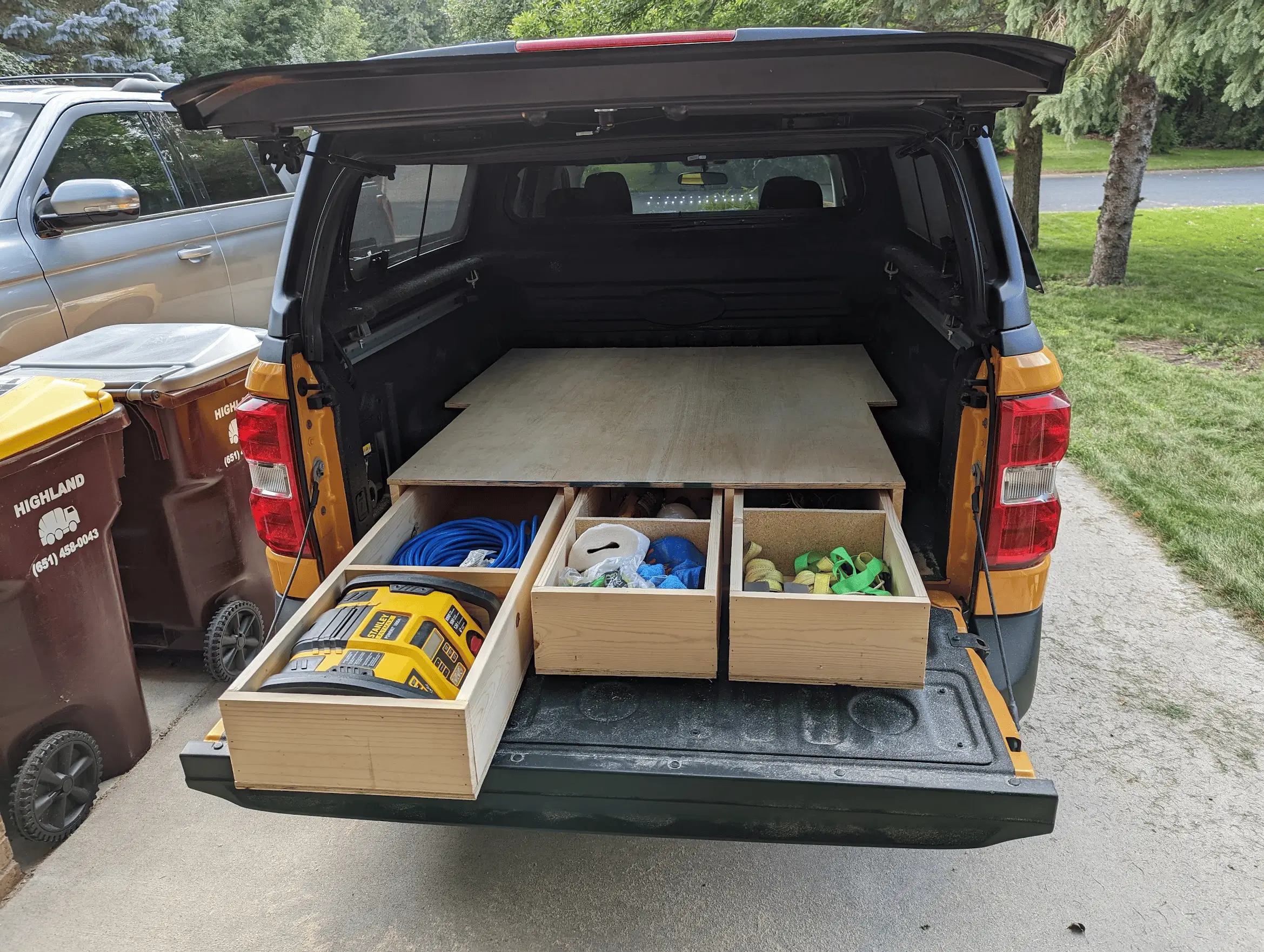

What did you use for drawer guides? Rollers on the bottom?
No rollers or guides, just wood on wood. The plywood is smooth enough as is, but I could wax it if it gets sticky.

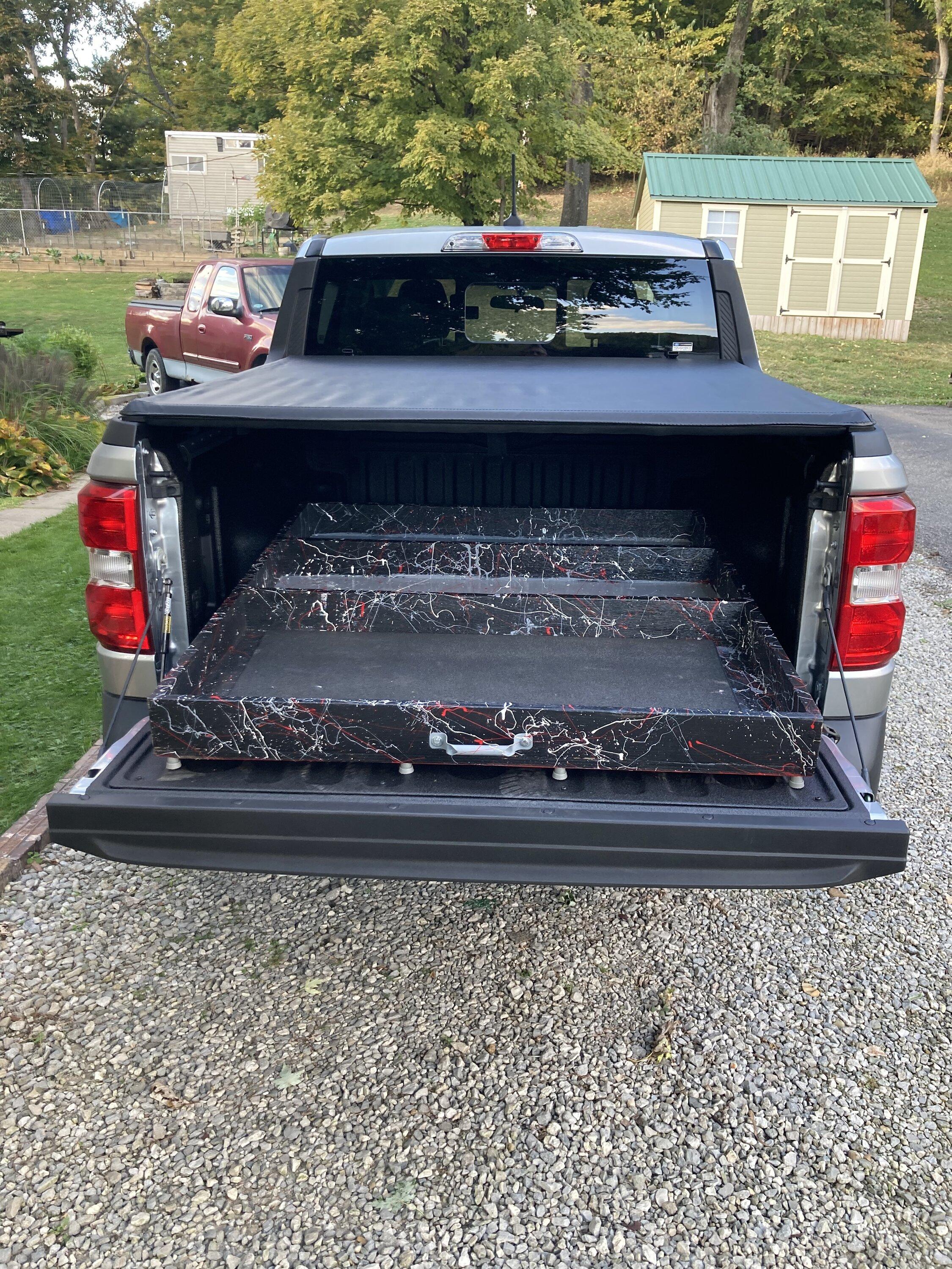

I’m working on a pull out single drawer. Trimming down the one I had in the F150. Since this isn’t the beater truck, sanding down the wood and painting it. Will post pics when I’m done. Lumber is outrageous, but I do some salvaging and have quite a stockpile of reclaimed stuff that does the trick

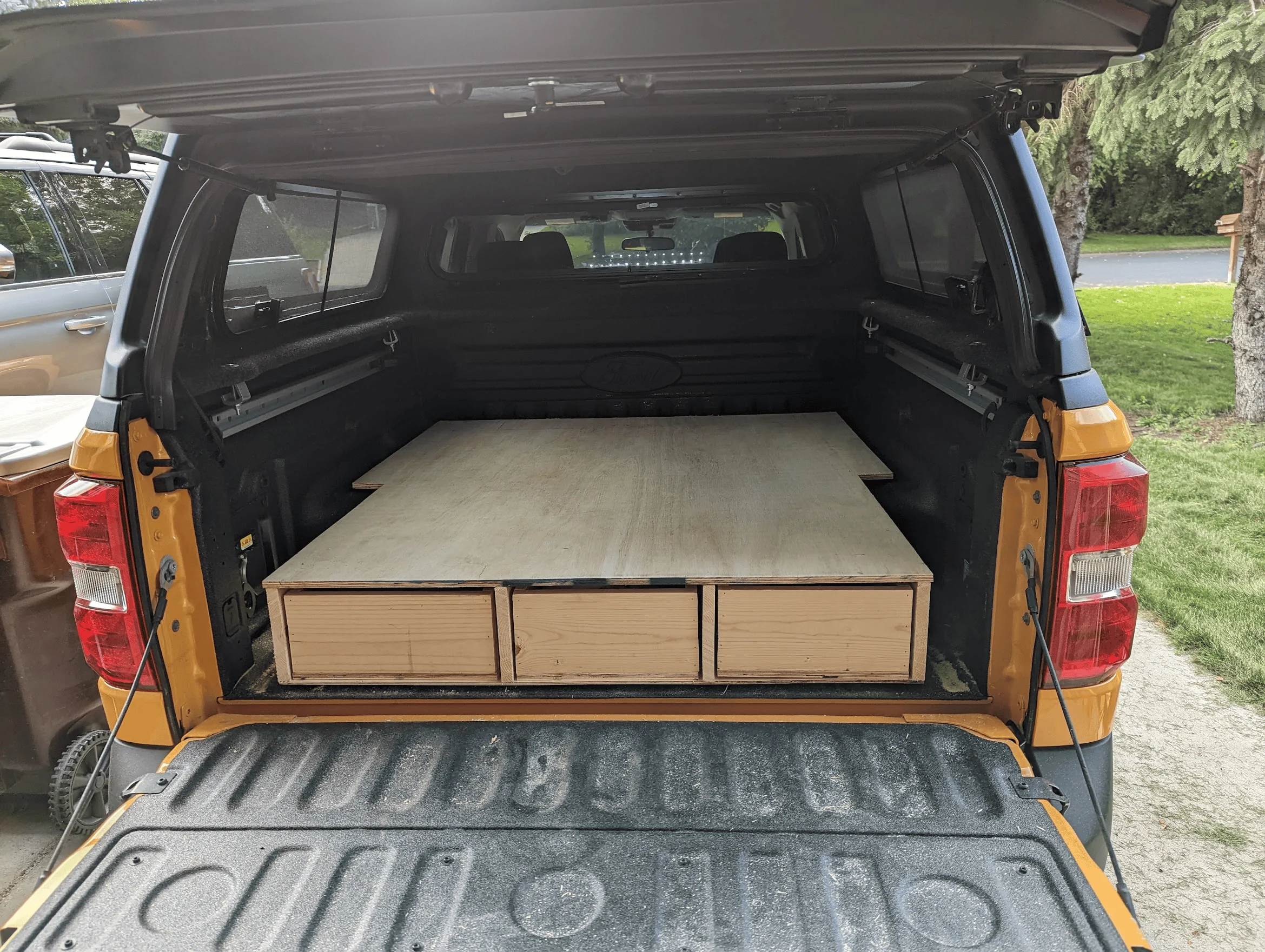

With no one offering a truck bed drawer system yet (that I could find) I decided to build my own. About $100 worth of lumber, and now I have plenty of room to store tools, tow straps, etc without having to empty the back seats/remove car seats. Overall height is 8", so the front half of the deck sits on top of the wheel well bumps. Also leaves enough access so I can still get into the storage cubby and access the power panel.
Did you use , roller ball transfer bearings , for the drawer bottoms to reduce friction ?
of the several DIY versions of bed drawers I have seen on the forum I like yours the best. Roll on some paint and bedliner and it will be perfect! you did a great job, I'm going to copy yours.
Thanks - I ended putting some rubber flooring material on top and it works great

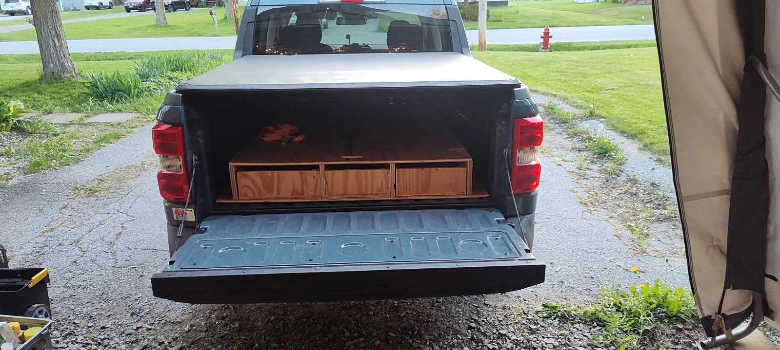

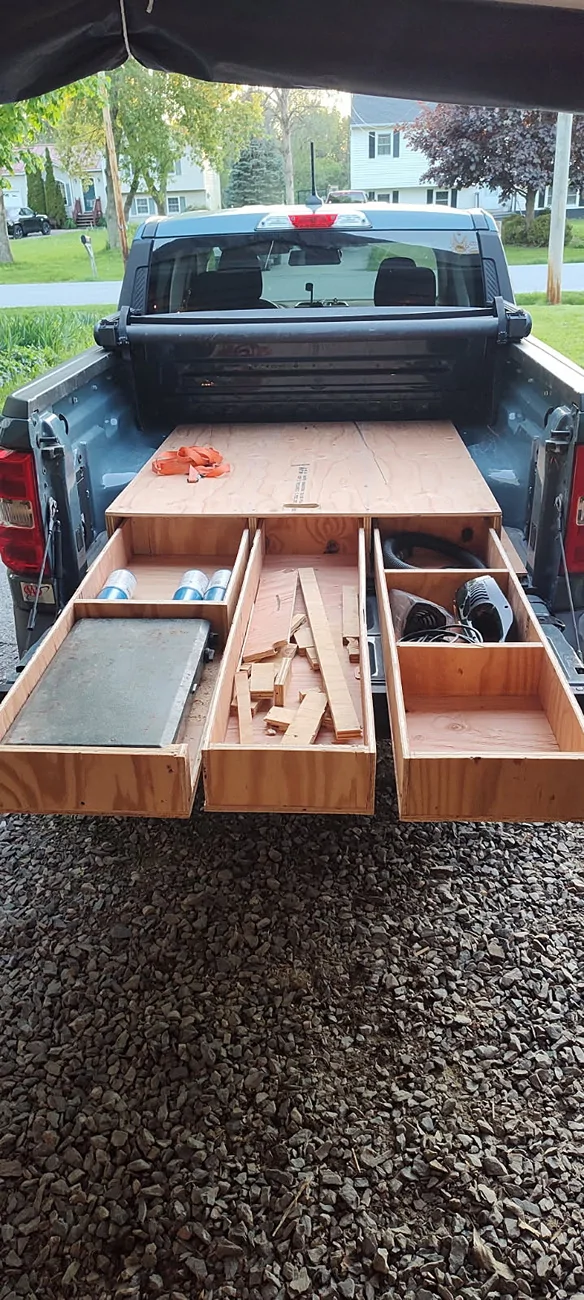

I did it too. 3 drawers but mine are different widths. I think yours look a little nicer and well built but I'm pretty sure mine are going to be fine for my use. I put a cutout in the top so I have a place to grab and pull the whole thing out to the edge of the tailgate. This is the base of a camping set up I am working on for my 2023 XL.
