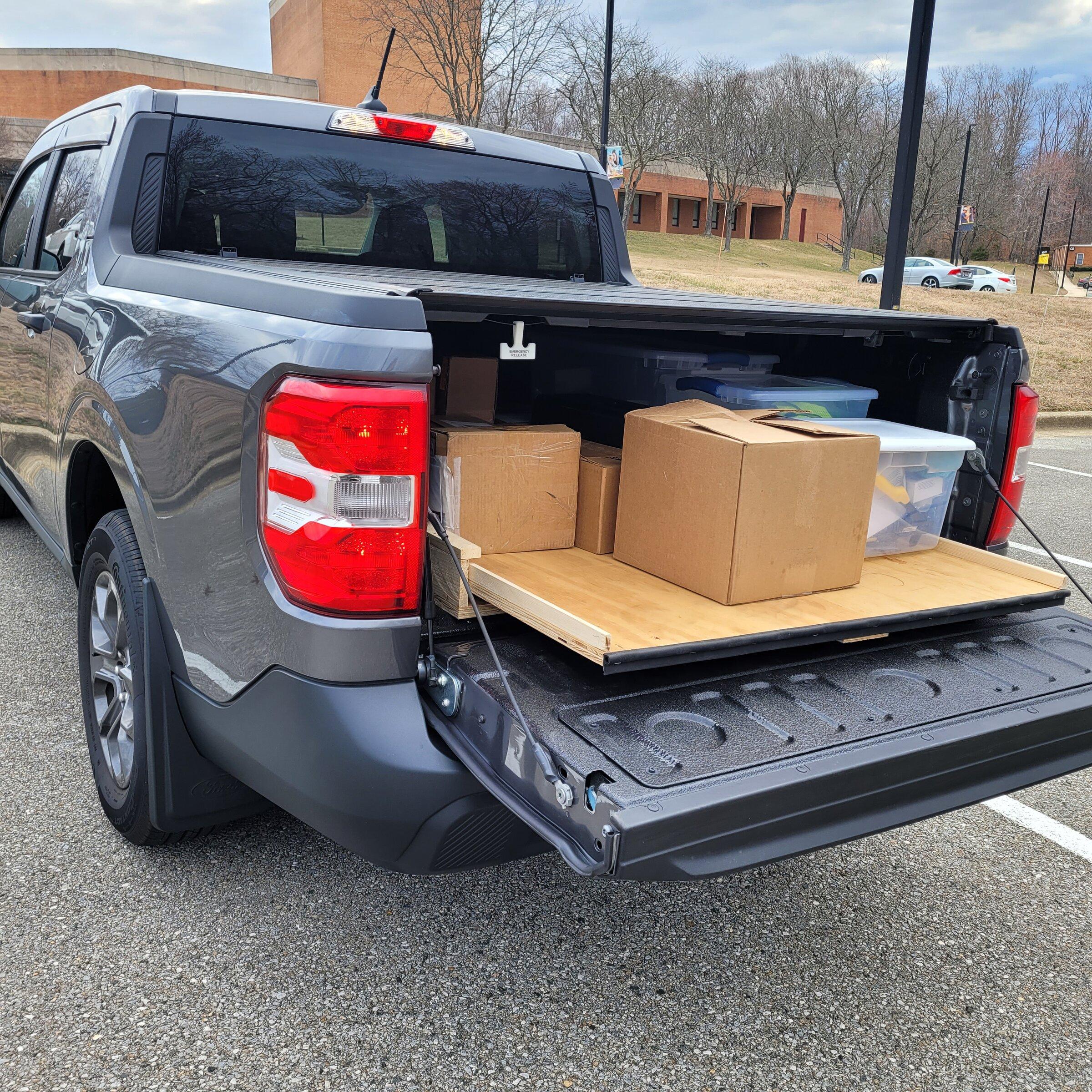

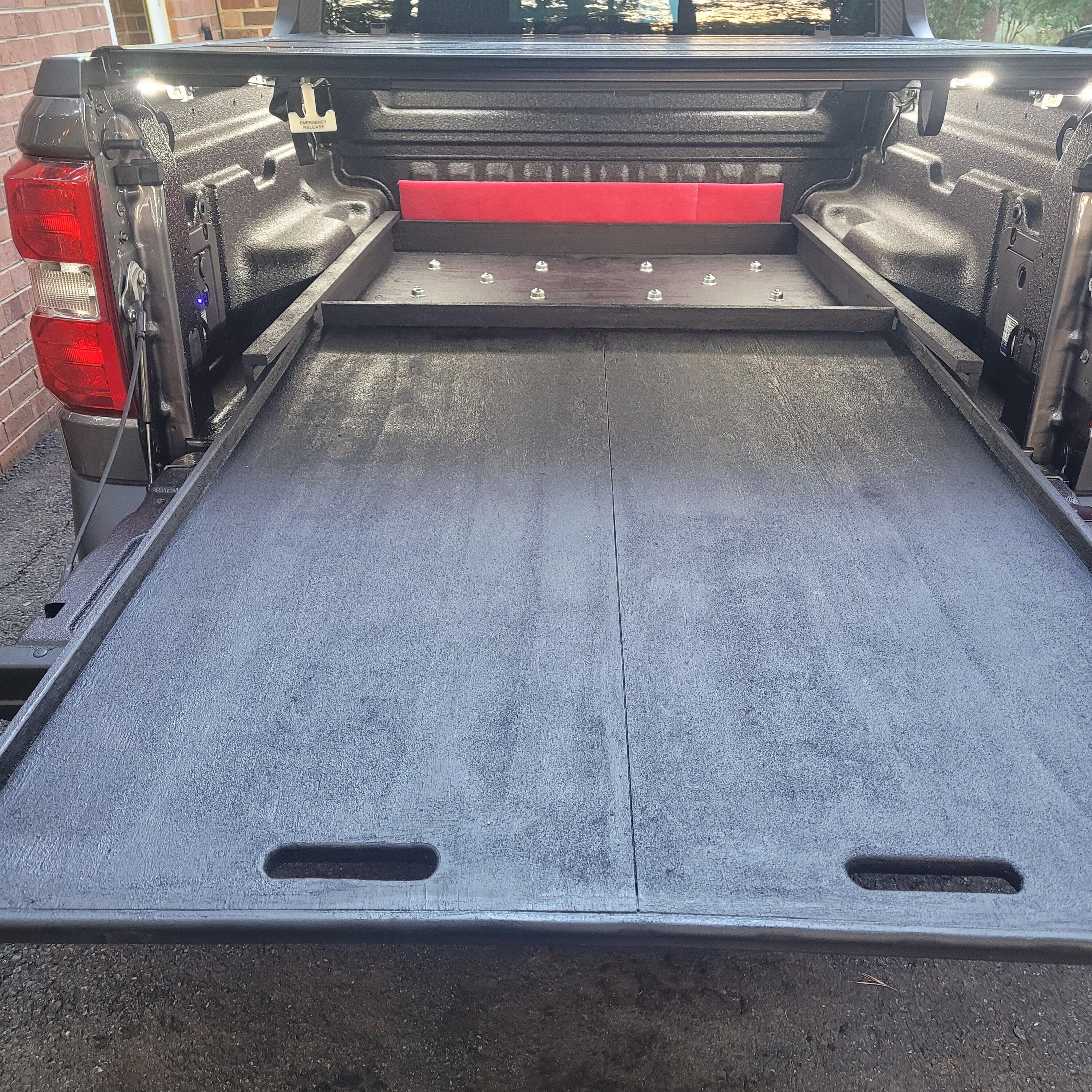

Thank you. I based my build on one of the many YouTube videos that are already out there. Just search DIY pickup slide out tray.

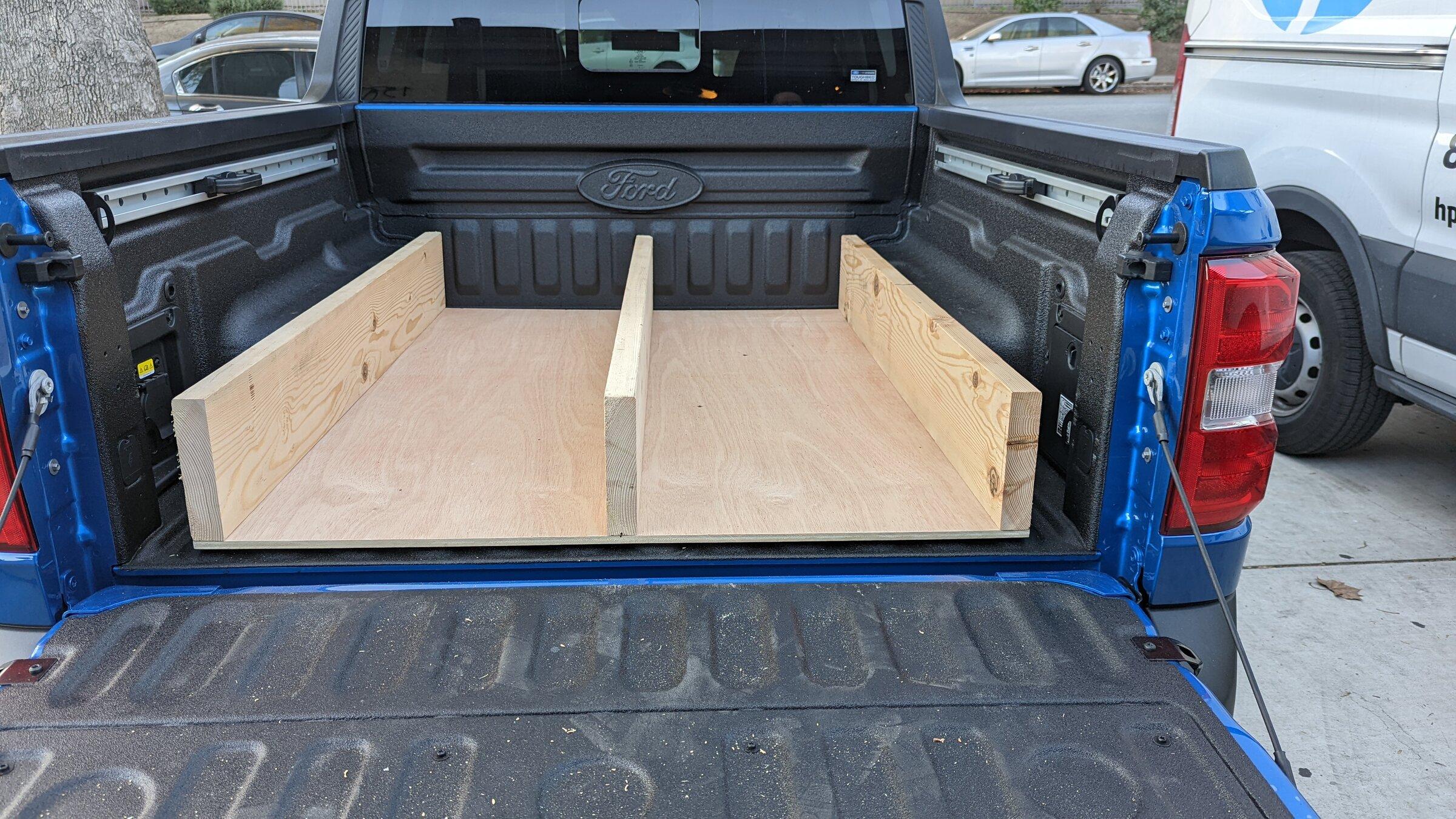

I measured between the wheel wells for the base. It just sits on the bed but it's pretty snug. I then assembled the side rails/guides and back stops from 2X4s I cut to size. Measured between the side rails for the slide out. Let me know if you have any questions.

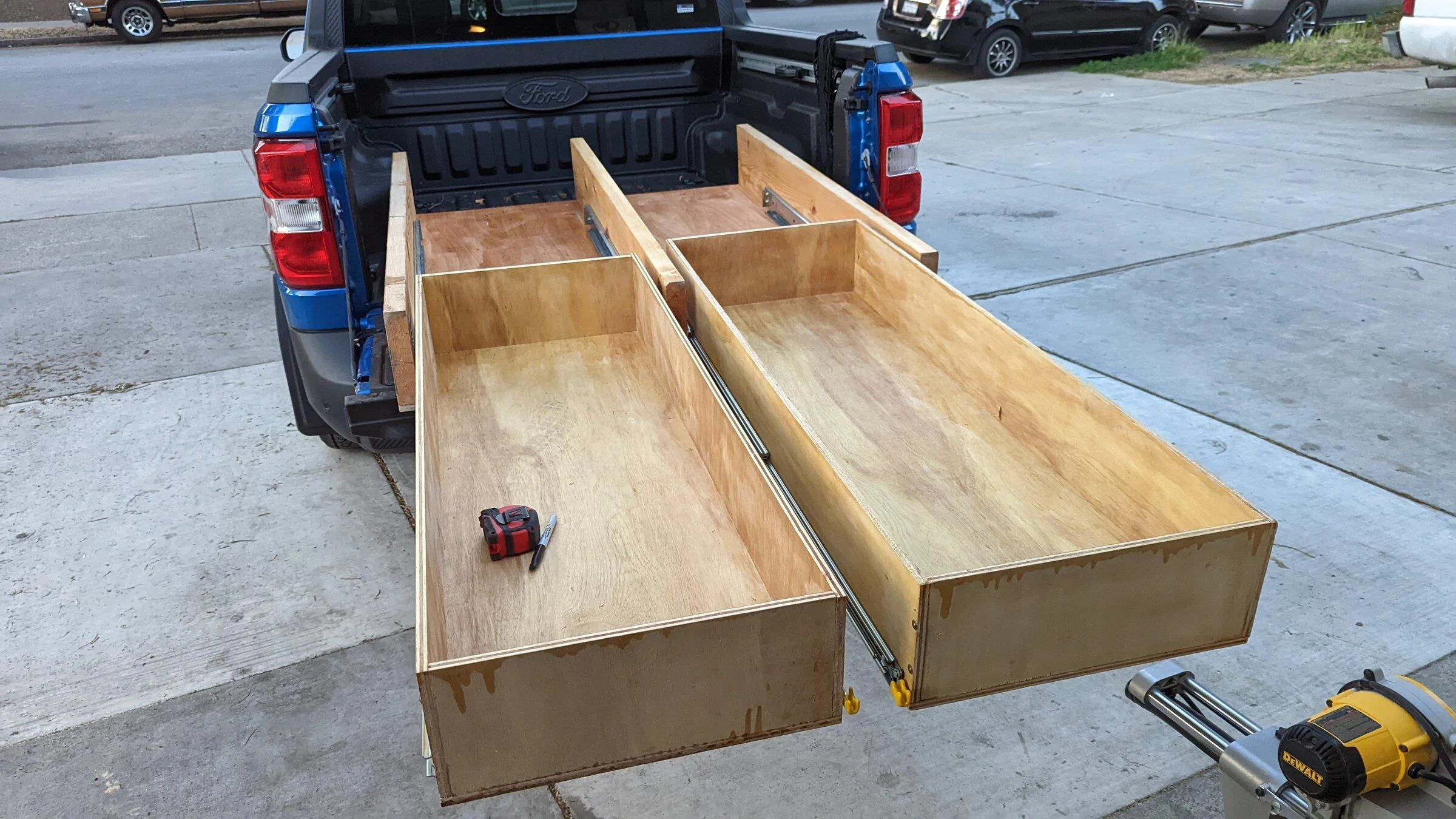

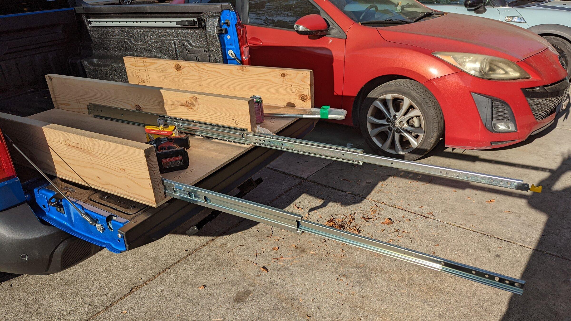

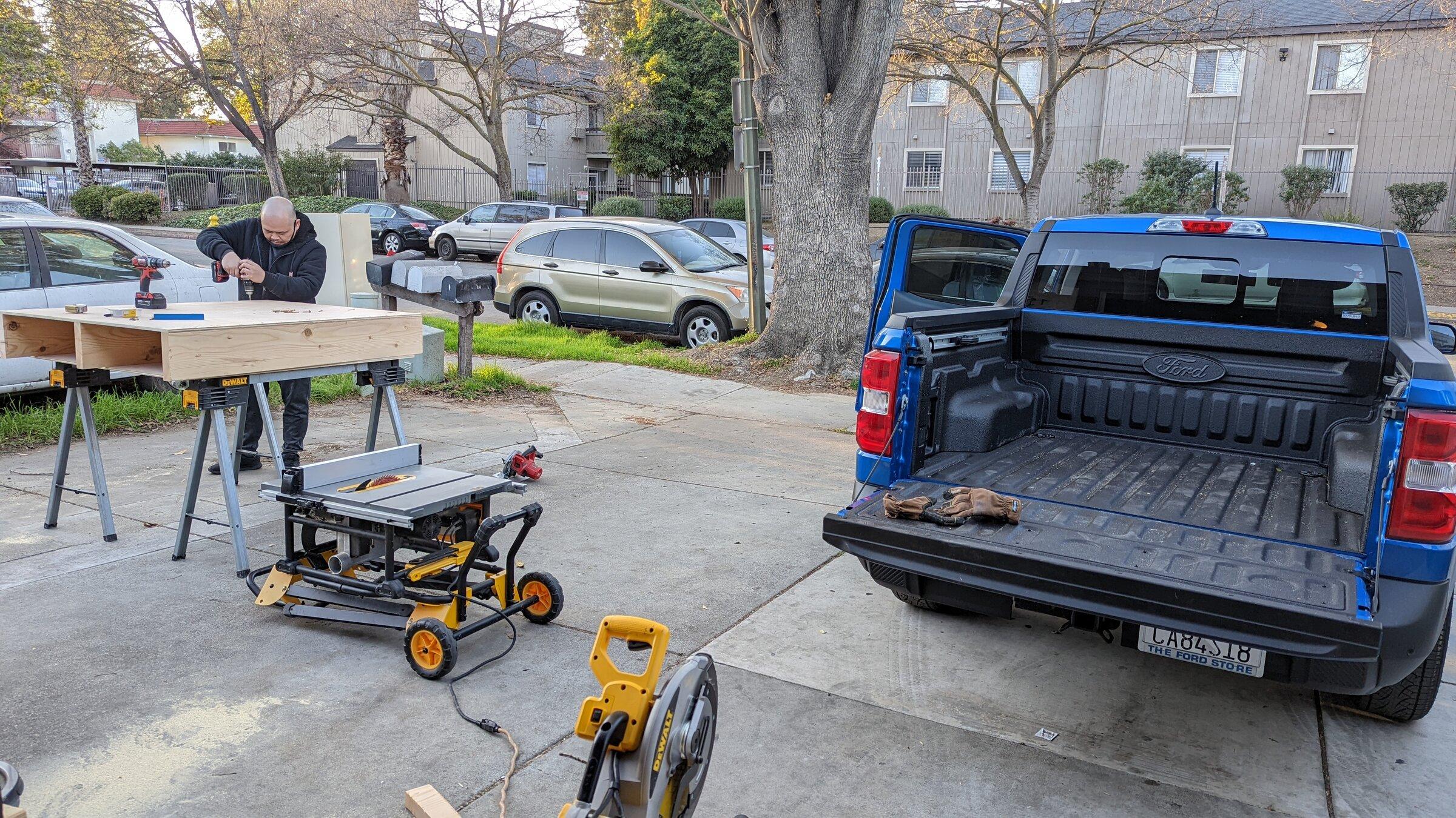

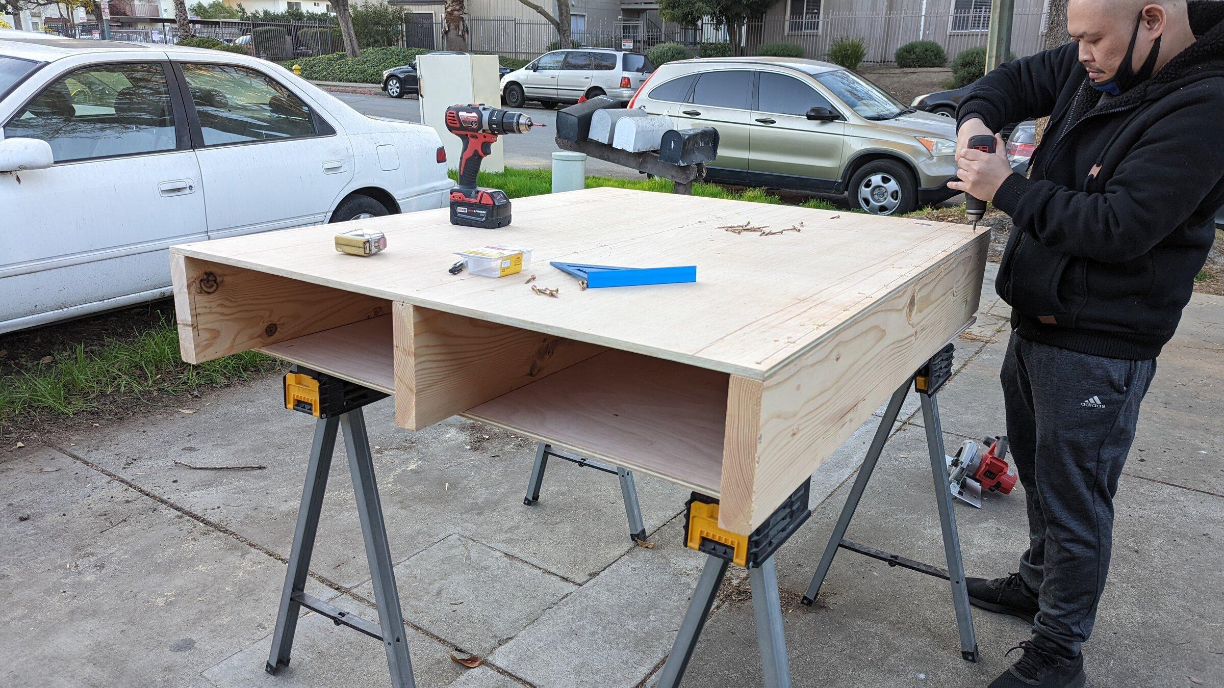

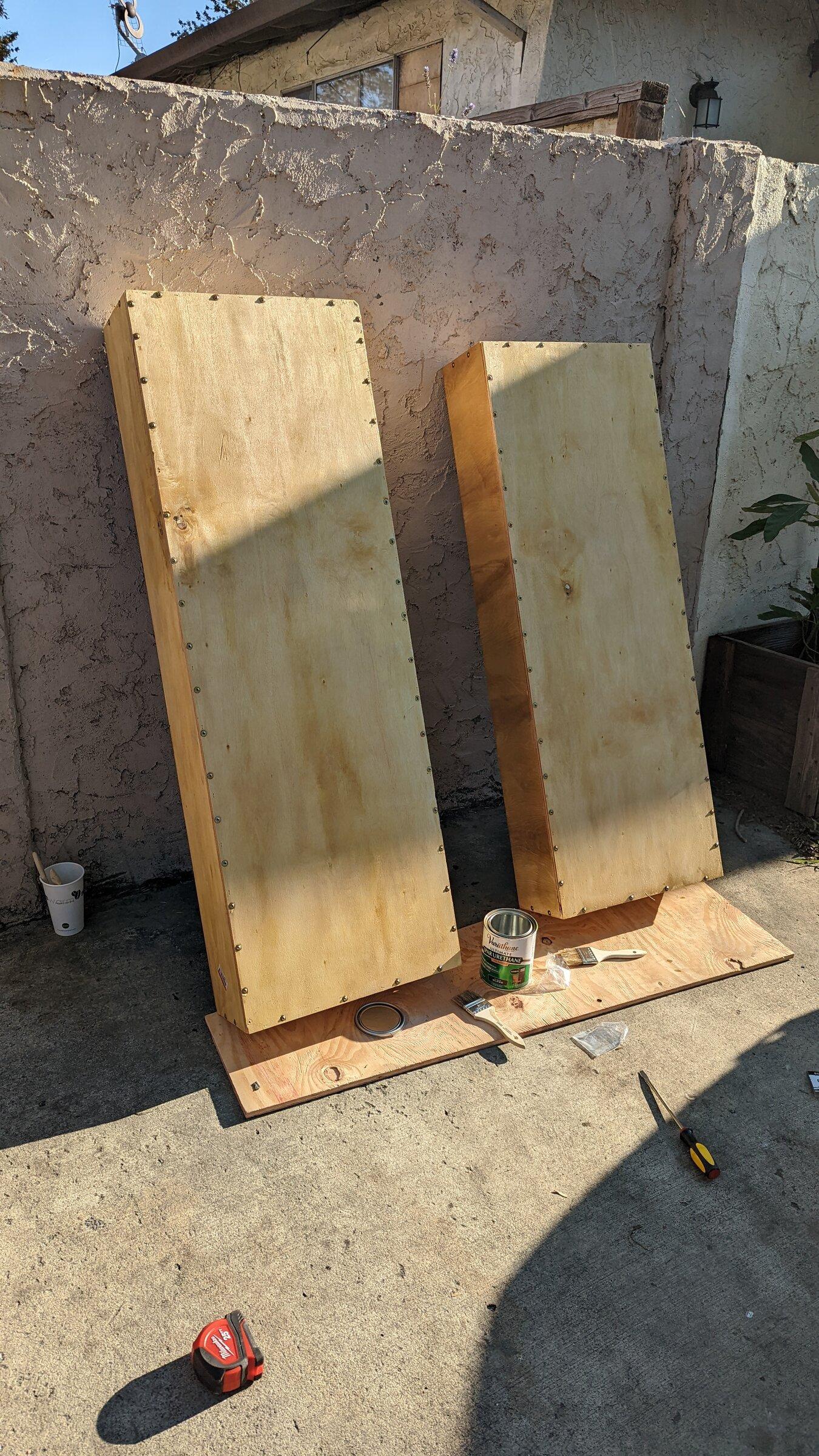

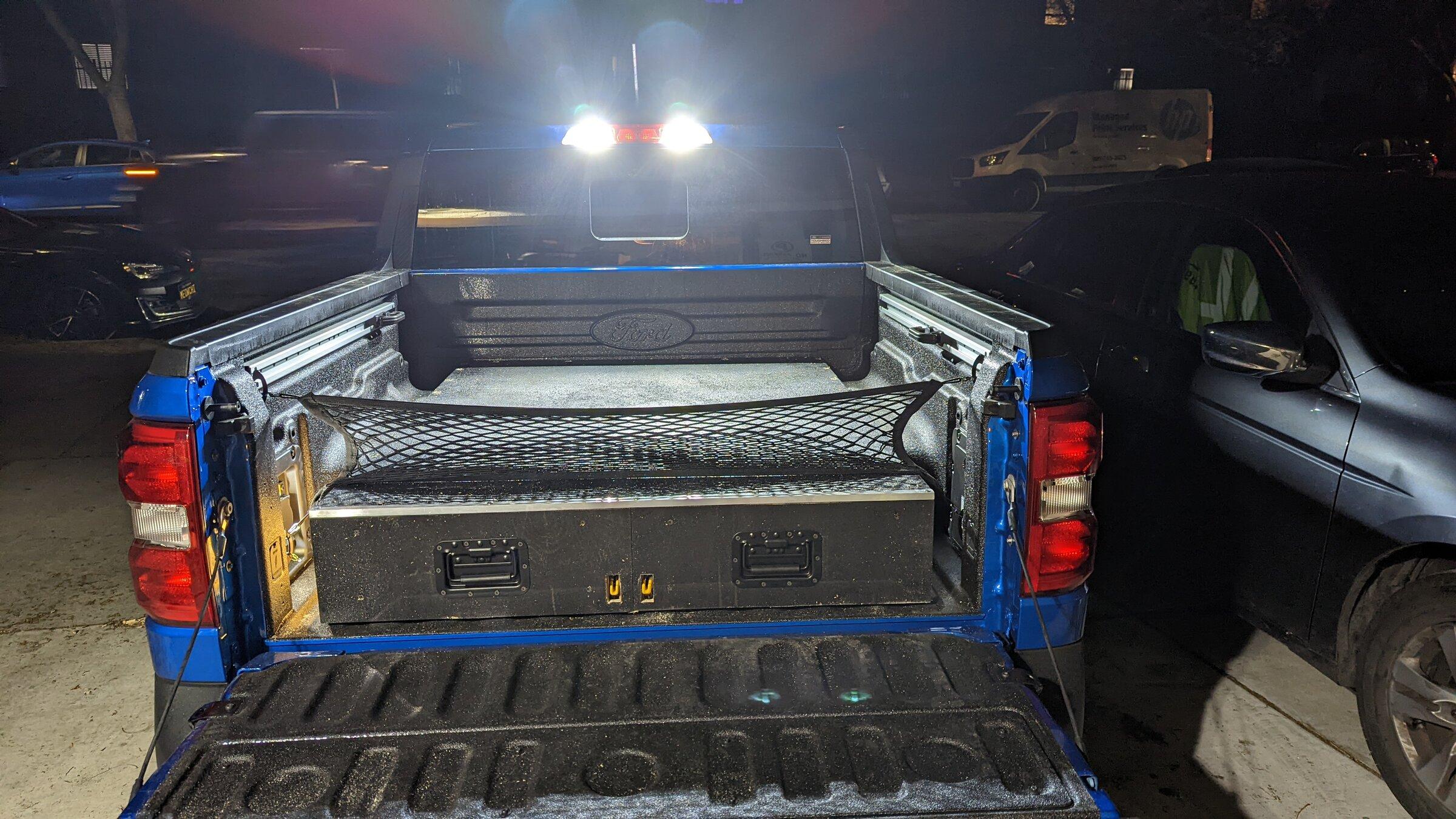

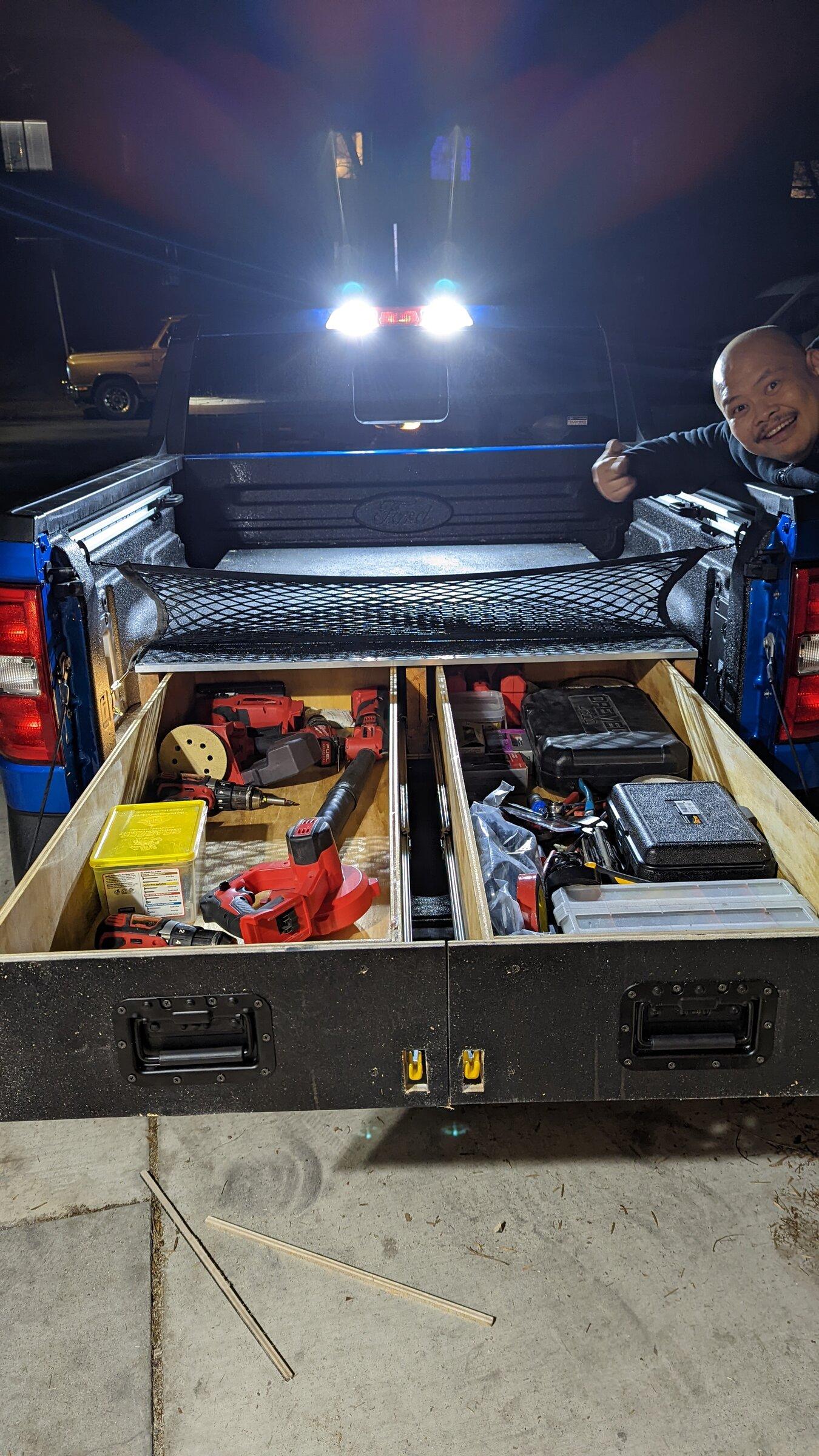

I contacted decked and they told me they weren't going to make anything for our trucks. So I decided to make my own.

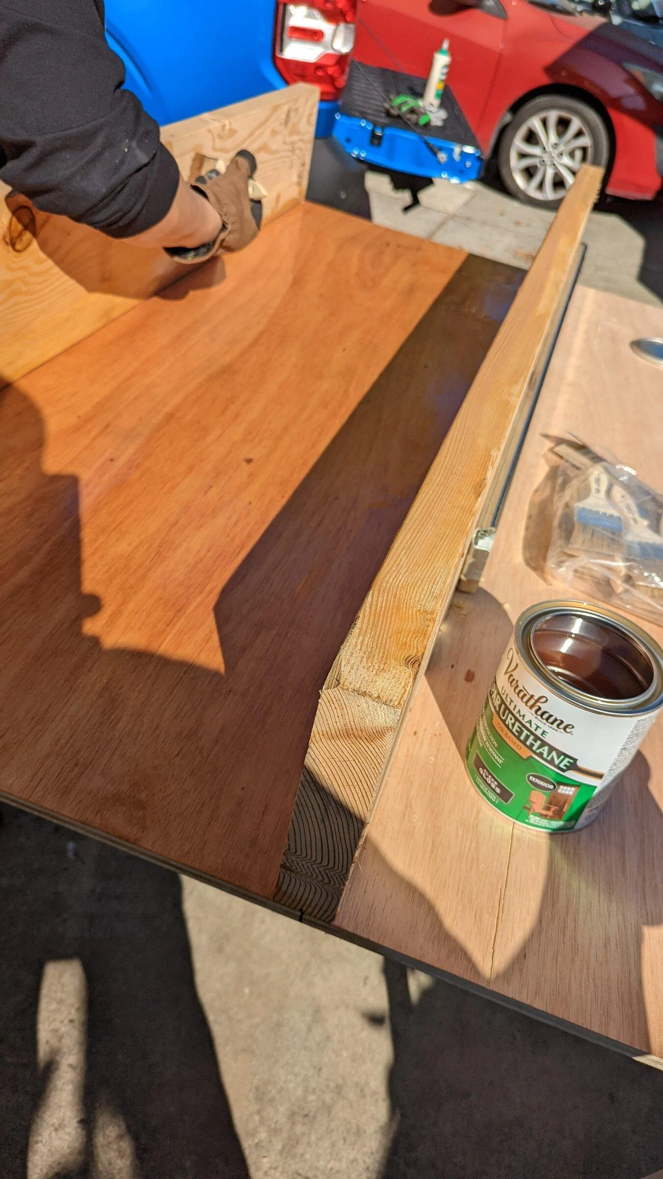

Coated the top with roll on bed liner and everything else with urethane.
Used 2x8 for the side and 1/2 ply for everything else. Aluminum trim for the top outer edge. Handle from Amazon and 350lbs locking rails also from Amazon.
Let me know what you guys think.

AOLISHENG 1 Pair Heavy Duty Drawer Slides with Lock 12 14 16 18 20 22 24 26 28 30 32 34 36 38 40 44 48 52 56 60 Inch 380 lb Load Capacity Side Mount Full Extension Ball Bearing Industrial Locking Rail https://a.co/d/diFbKch
I purchased a set of locking and a set of non locking, then put the locking rails on the right side of each drawer(this way you have to pull up on the locking latch to open the drawer).

They lock in the fully open and fully closed, so if you're parked on a incline/decline or hill they won't chop you fingers off
