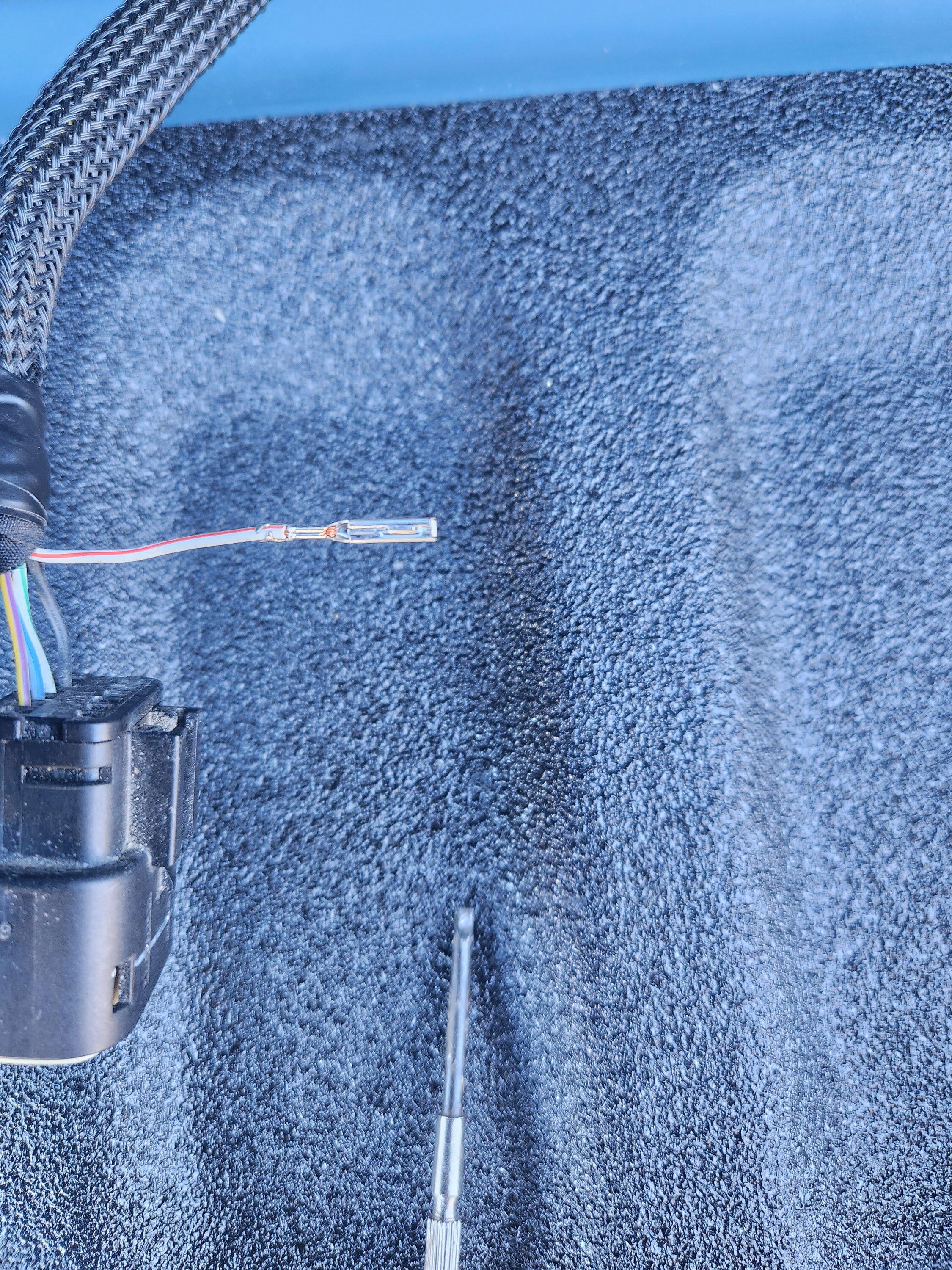

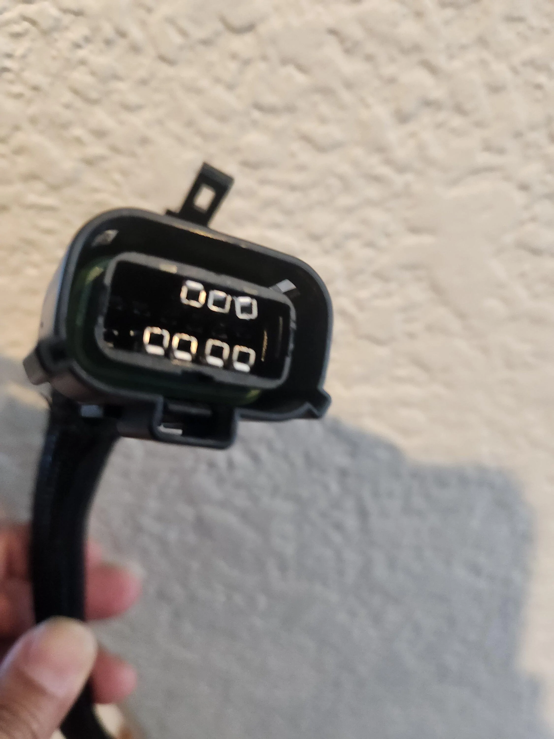

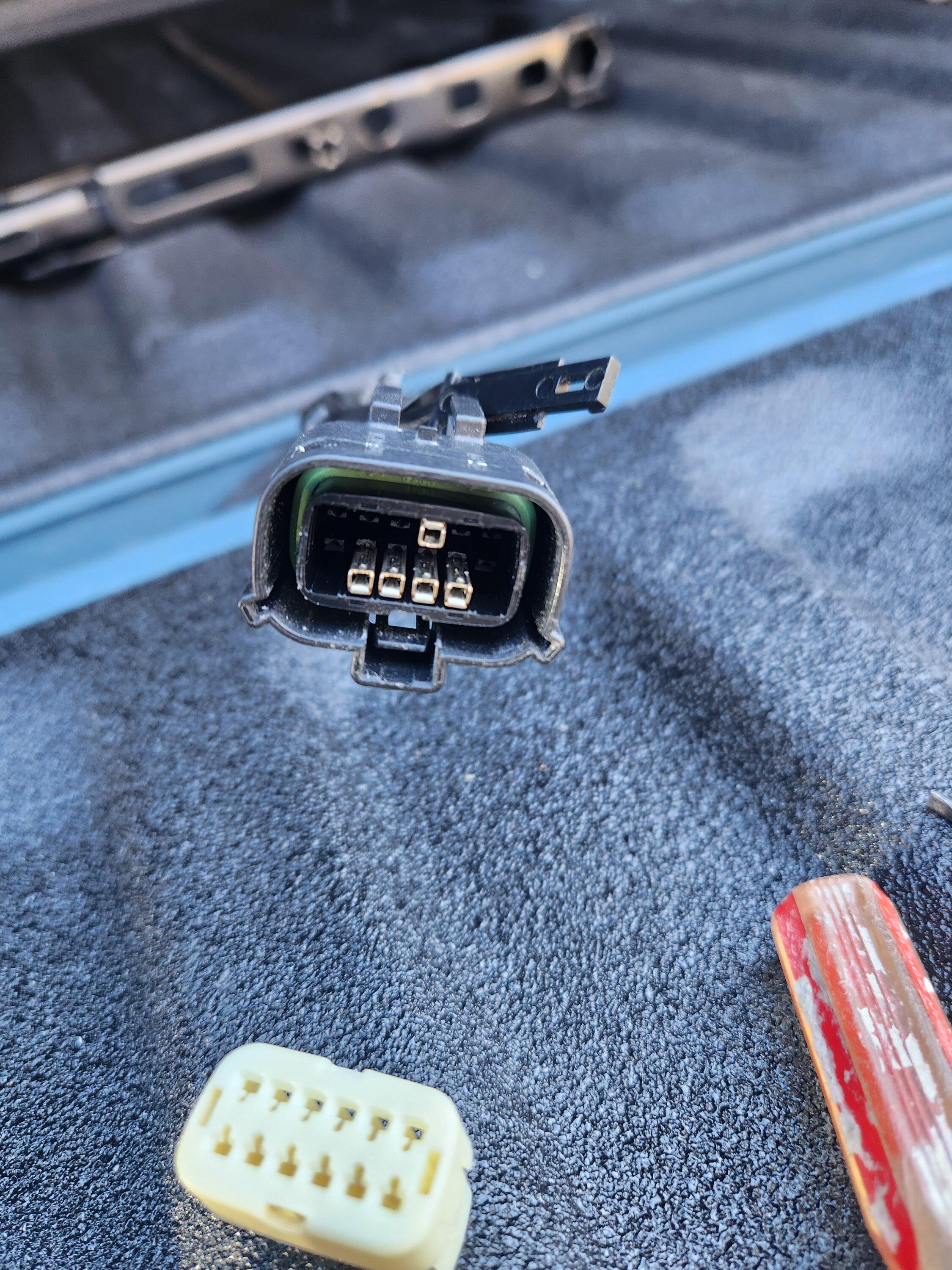

I pulled out my connector to take a look at it. It appears to be a standard 12-pin molex connector.
This video shows clearly how to add and remove pins from this connector.
I verified that the pins on our connector are standard molex pins. I removed the red pin and easily reinserted it using a small paper clip.
I plan to add the two pins needed for the actuator and run the wires through the existing cable sheath.
Should cost a fraction of buying the cable which is now unobtainium.
There are little black plastic blockers on the rear of the connector that have to be pushed through and removed before the new molex connectors can be pushed through the waterproof gasket. You have to fully remove the white facade from the front to get these plastic pieces out. Inserting a paperclip on either side allows you to remove the white facade.

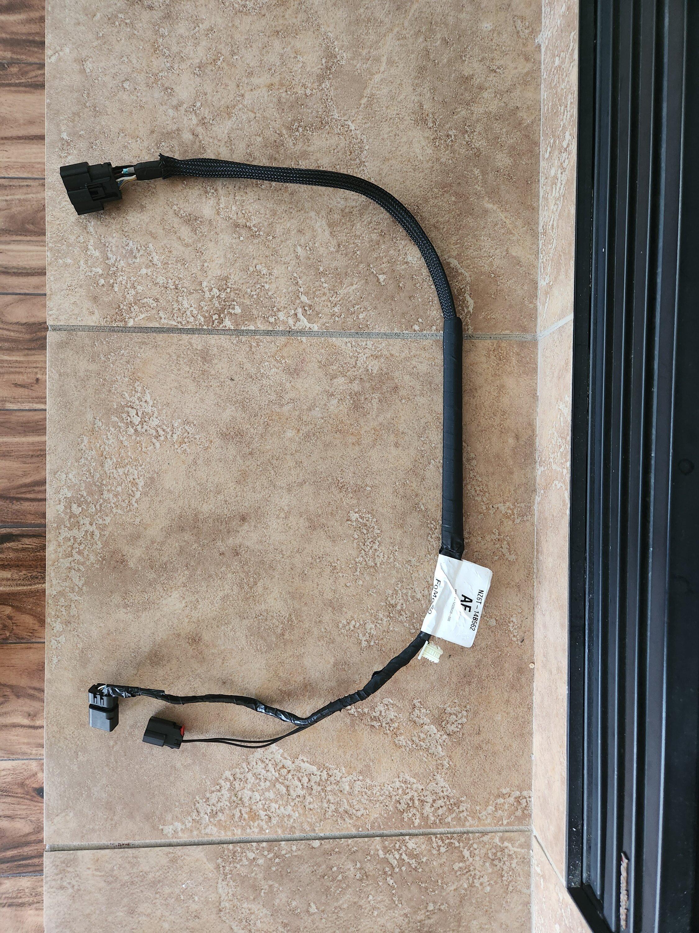

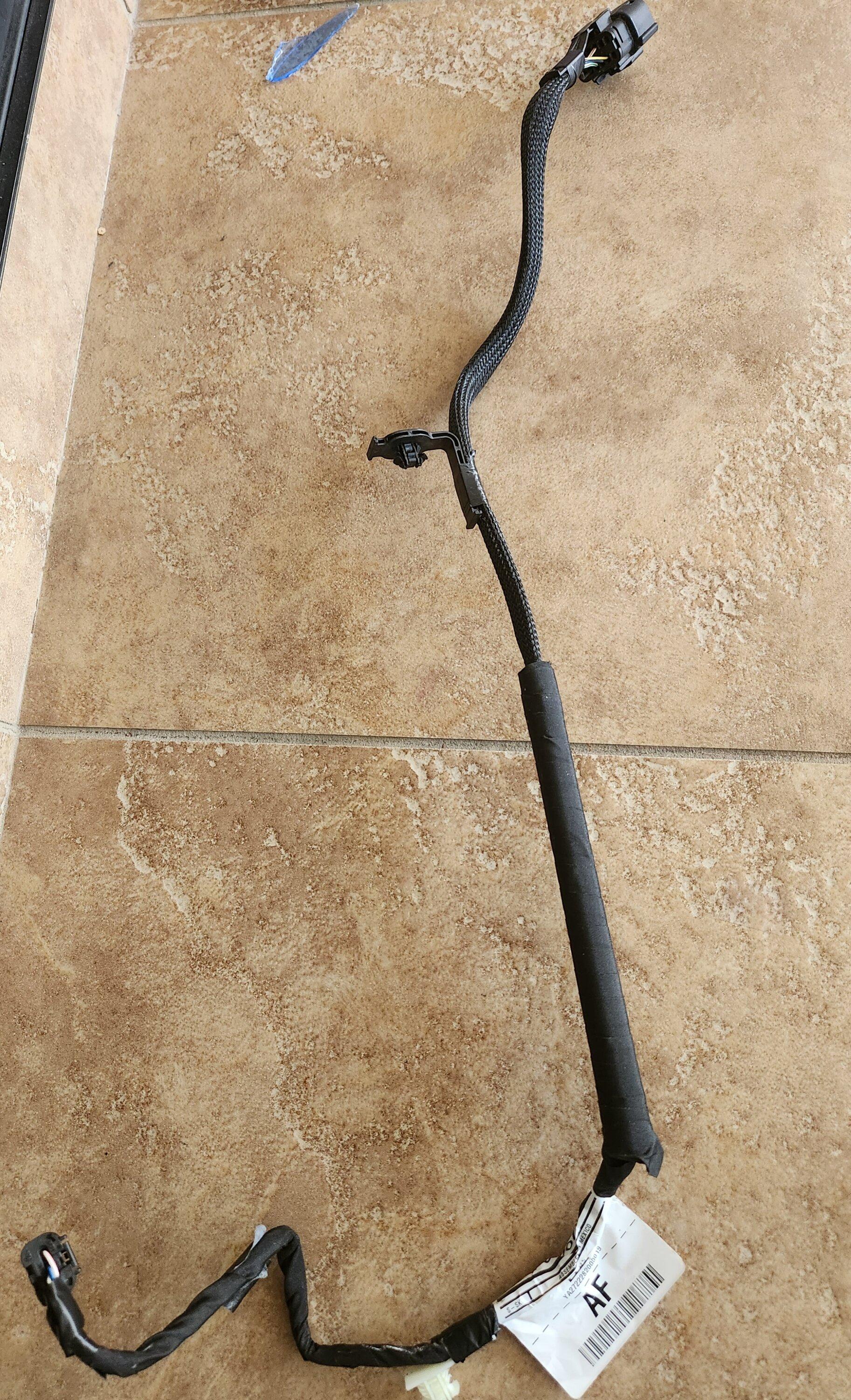

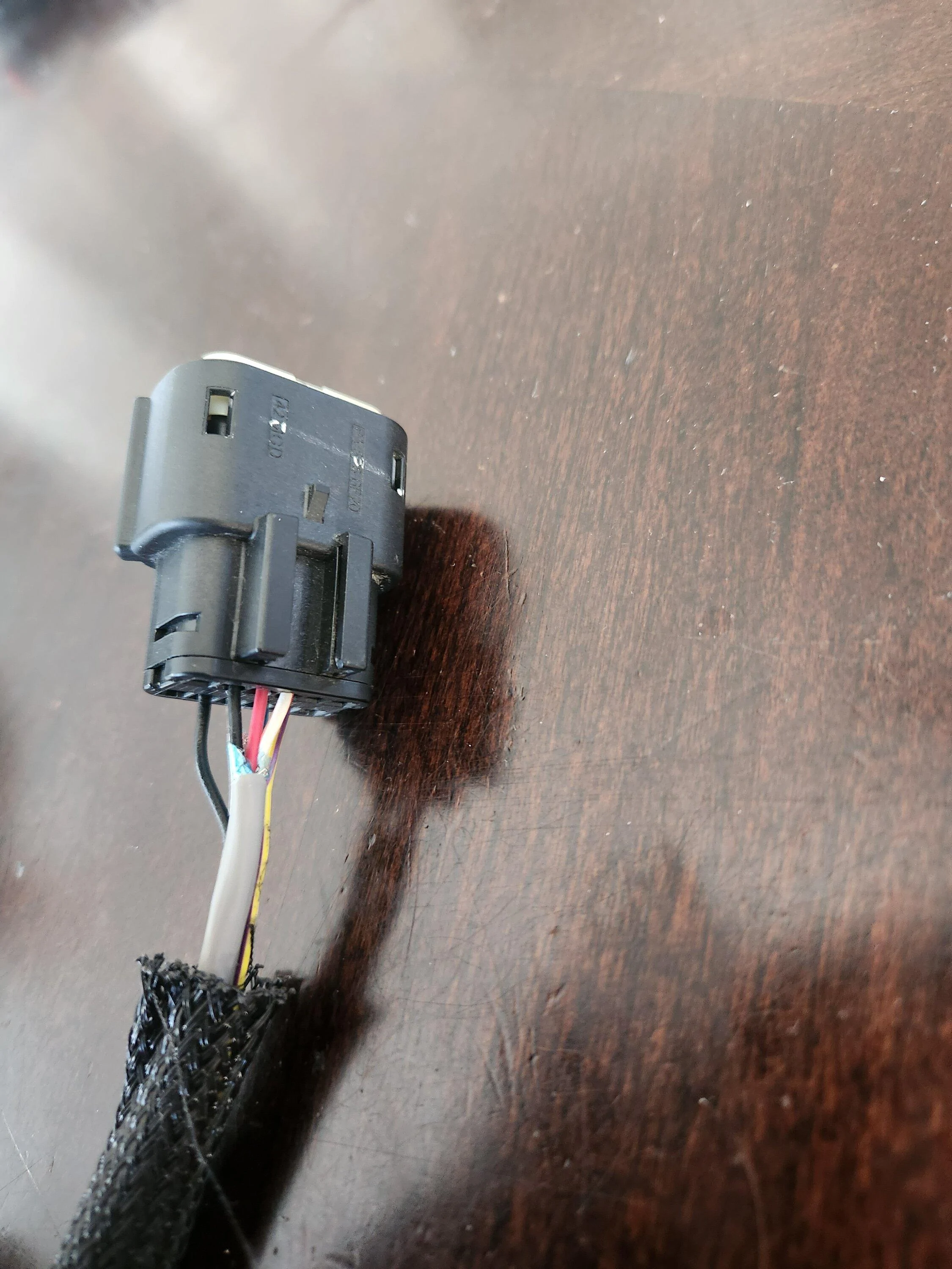

And here is my completed DIY stock cable before:
And after:
And after:
Thank you Telemachus! I followed your instructions exactly and it worked perfectly. I was going to just order the harness from Ford but as others have mentioned, I was unable to locate one in stock. Your solution made sense, was less expensive and worked great.

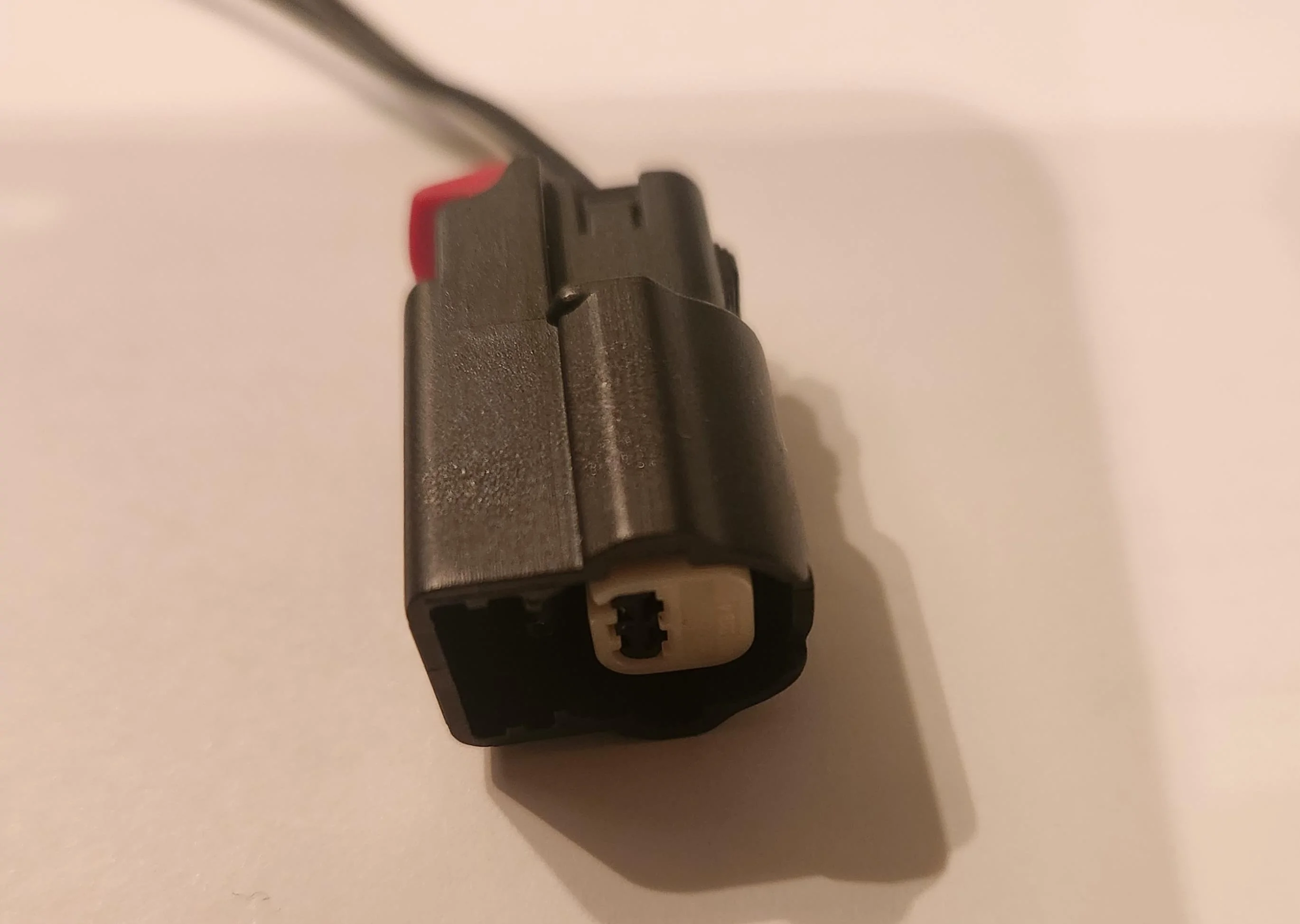

the wpt 1314 connector is a regular run of the mill connector for ford- airbags, washer fluid level, among other things. Your local u-pull will most likely have something that will work as it’s not a maverick specific connector.
heck you might be able to find one with wires running to a molex connector and snatch the pre terminated molex pins out. Then just add your bounty to the maverick connector and fish the wires through the stock harness and your golden.

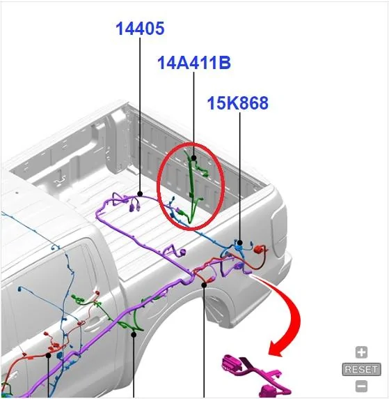

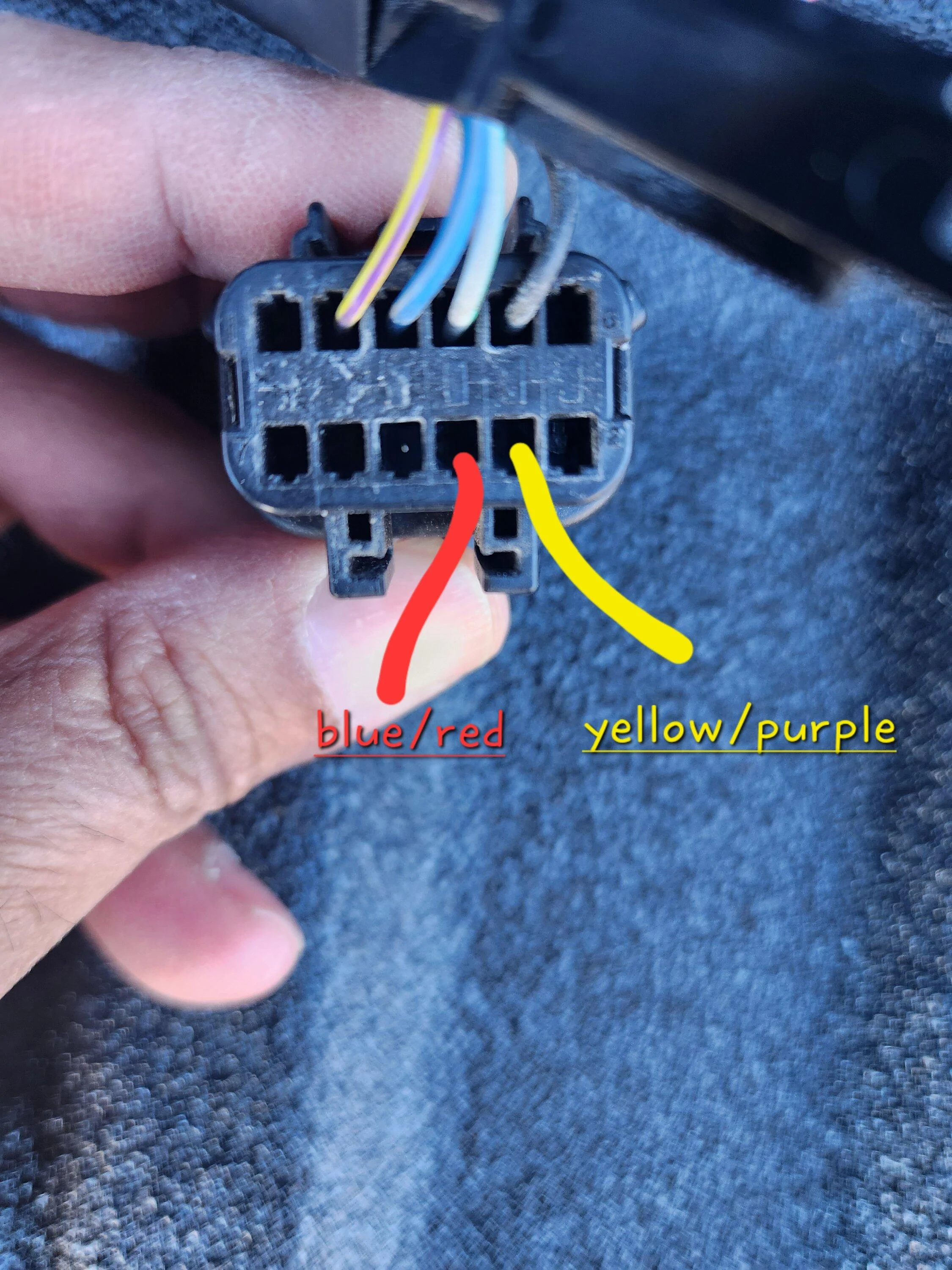

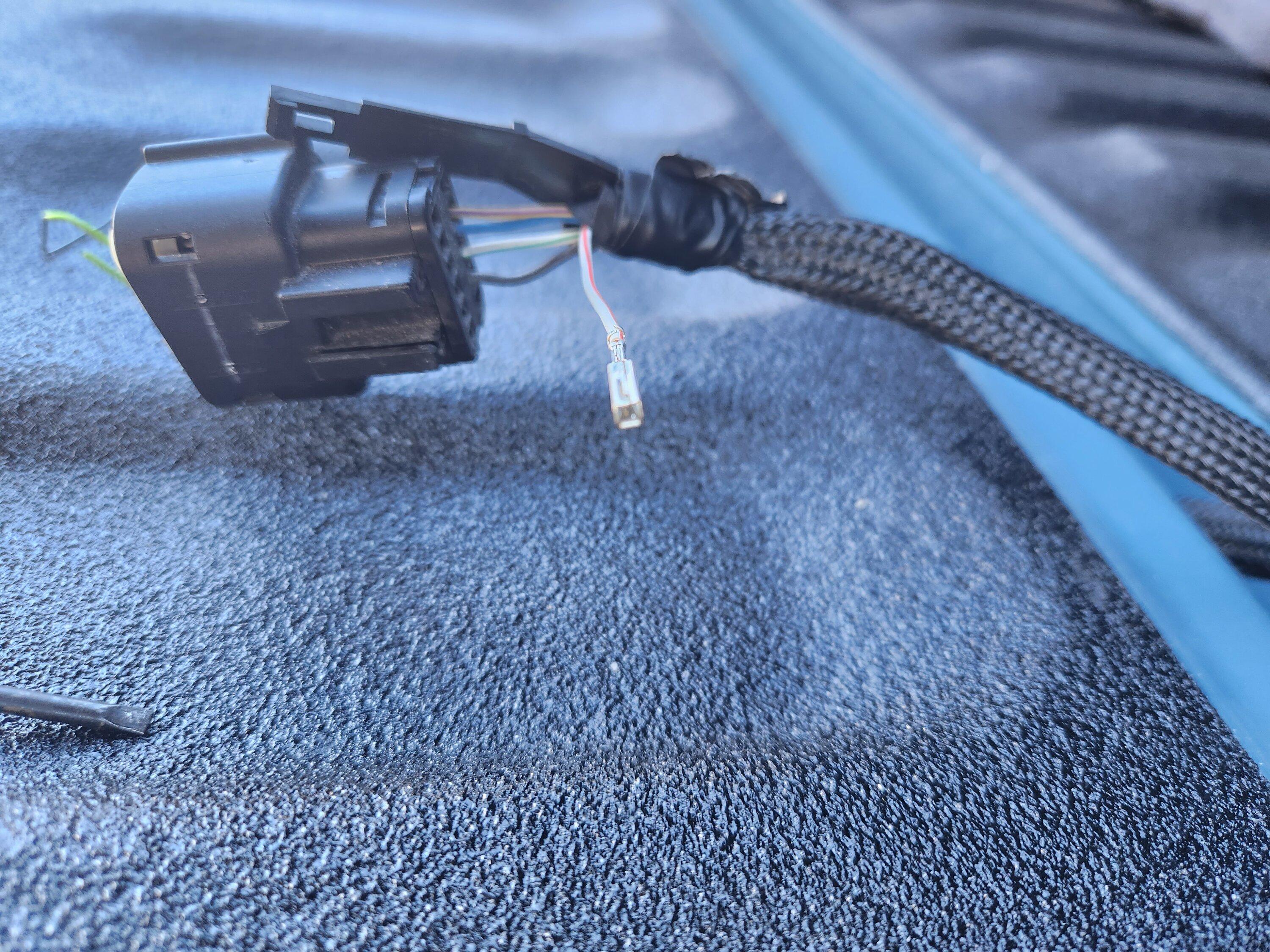

I still have a theory that there's power to the rear of the truck in the main wiring harness for a tailgate lock actuator. According to parts diagrams for the ranger it looks like there's a shorter harness that includes plugs for the rear camera and the power lock actuator and connects into the main harness under the end of the truck bed. I'm willing to bet that if you trace back the wiring for the camera on the XL and unplug it you'll have multiple pins in the plug on the main part of the harness, two of which will be 12v and ground which are meant for a harness on an XLT or Lariat
Green harness is the shorter harness that connects to backup cam and tailgate lock actuator
Purple harness is main harness

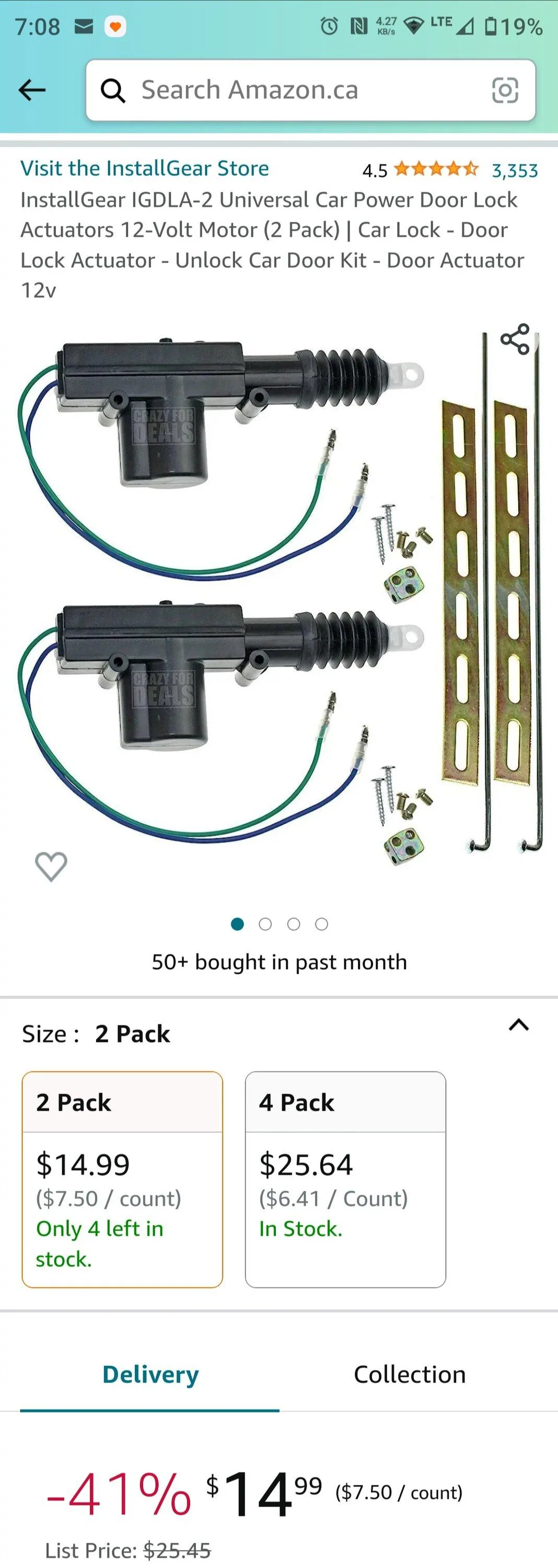

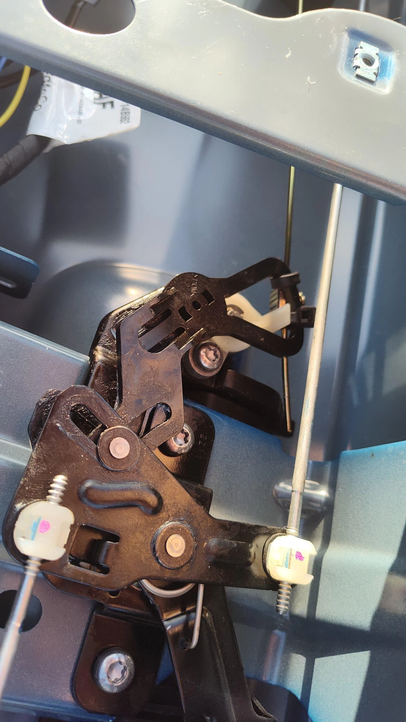

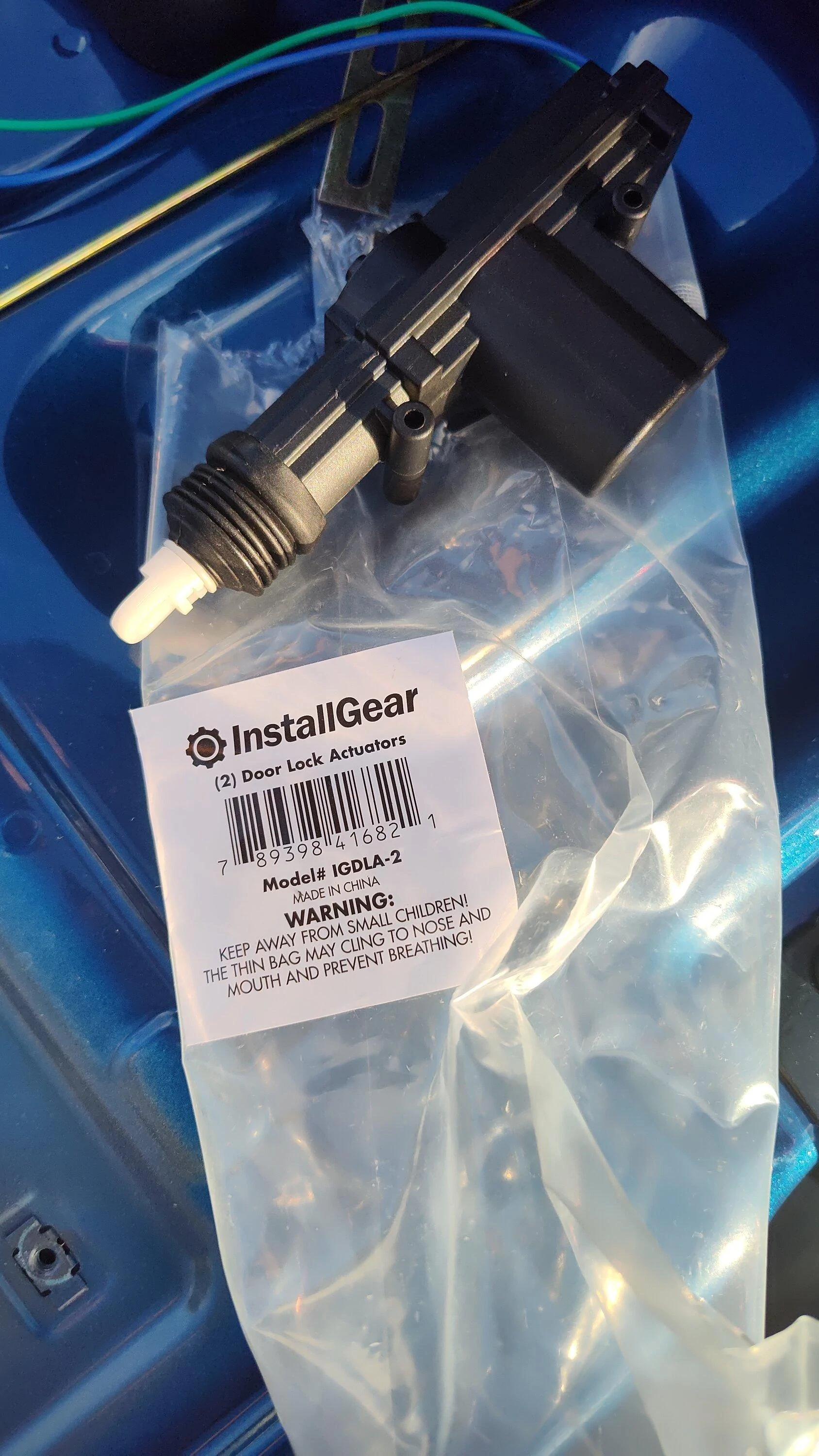

Hi everyone interested to update XL trim to power lock tailgate.
I used parts from Amazon (see pictures) not expensive at all.
Connected to these blue and yellow wires from the main connector (as shown in the discussion).
Attached the actuator to the door frame and voila.
Have my tailgate door open and close with my remote.
Ford Maverick DIY Tailgate Power Lock using Control/Actuator from Ranger IMG_20230816_183929162
Ford Maverick DIY Tailgate Power Lock using Control/Actuator from Ranger IMG_20230816_183838325
Ford Maverick DIY Tailgate Power Lock using Control/Actuator from Ranger IMG_20230816_183901034
Ford Maverick DIY Tailgate Power Lock using Control/Actuator from Ranger Screenshot_20230816-190811_EDIT_1

Brilliant! Especially with complaints of the OEM unit not holding up under heat.
