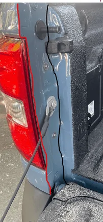

For the rear part of the bed that isn't lined, I just emulated what I saw on factory and linex bedliners. I suppose you could spray that part, but I cant imagine much scuffing that section of the paint, at least for what im using my truck for. Here are some other pics of that view in case you were curious.
So what are your thoughts (or any one else that wants to chime in) on continuing the spray to the black line and/or all the way to the red line?
