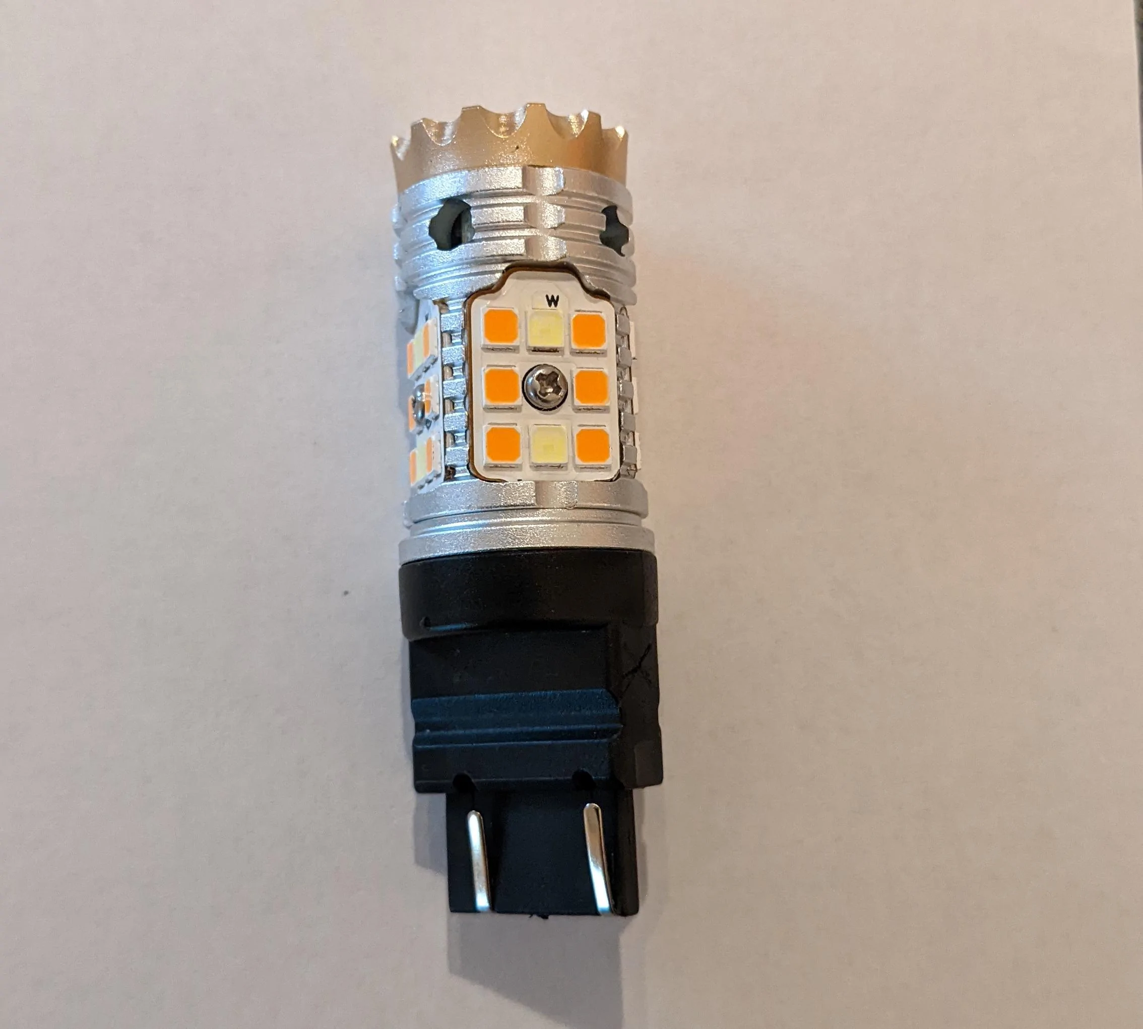

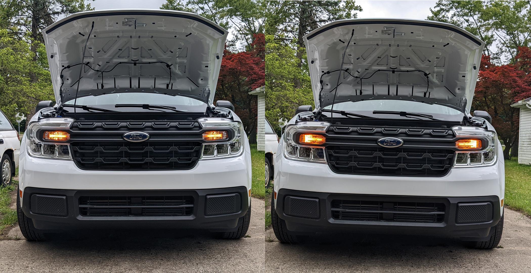

Installed Lasfit switchbacks and damn they are so bright that I got worried...
These are the old T-series:
Ford Maverick DIY - Dim those bright Lasfit switchbacks u_lasfit

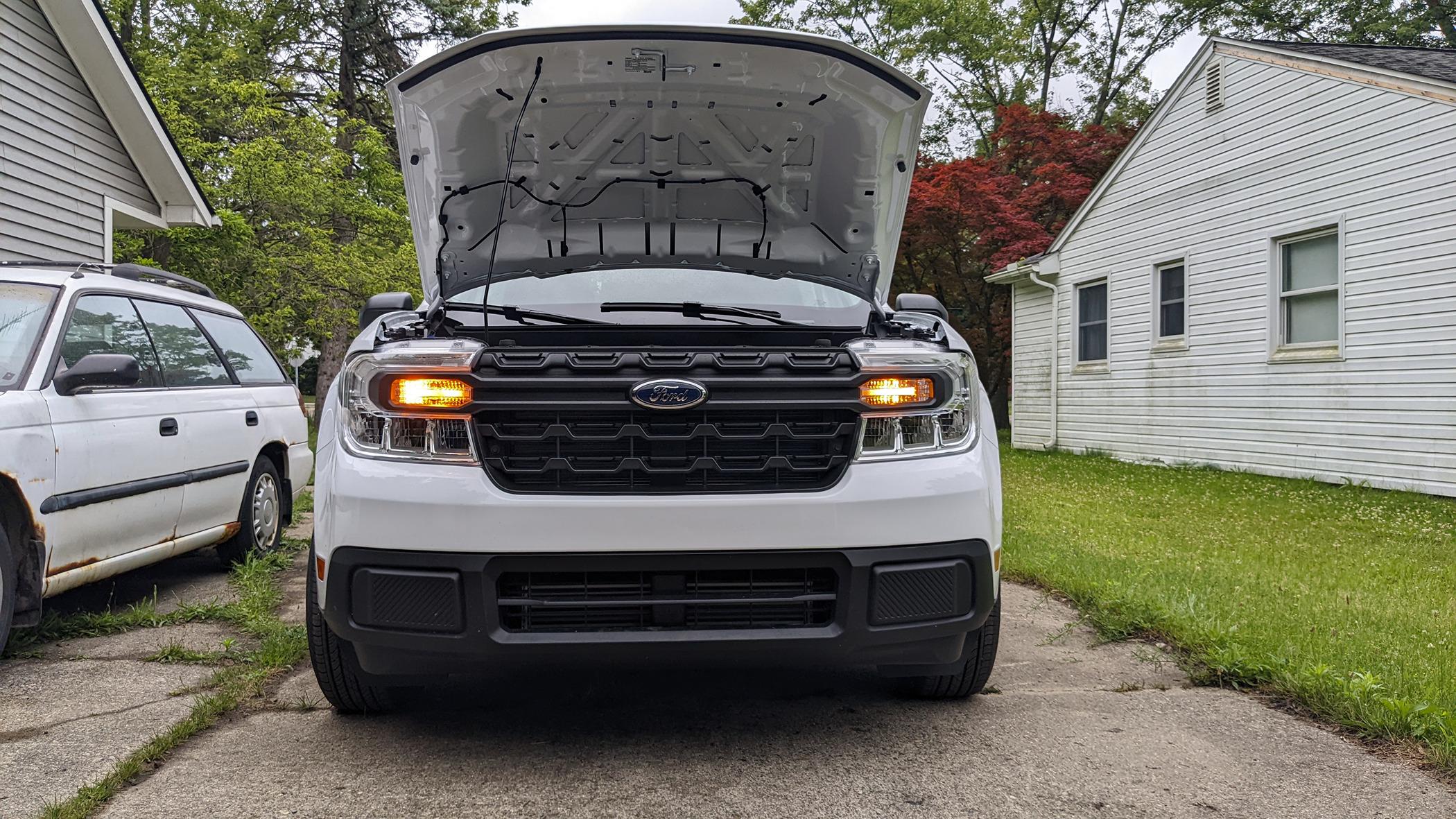

Left - unmodified Lasfit, right - stock bulb:
Ford Maverick DIY - Dim those bright Lasfit switchbacks u_lasfit-stock

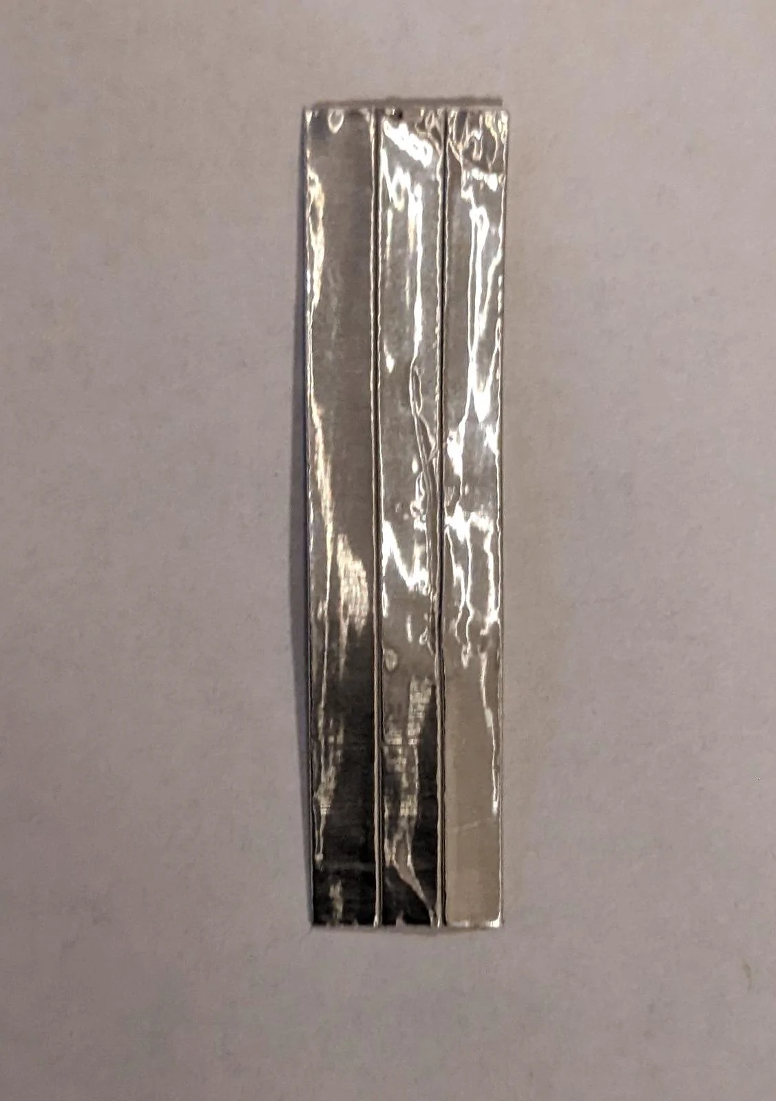

Cut some aluminum tape strips with exacto knife:
Ford Maverick DIY - Dim those bright Lasfit switchbacks al_strips

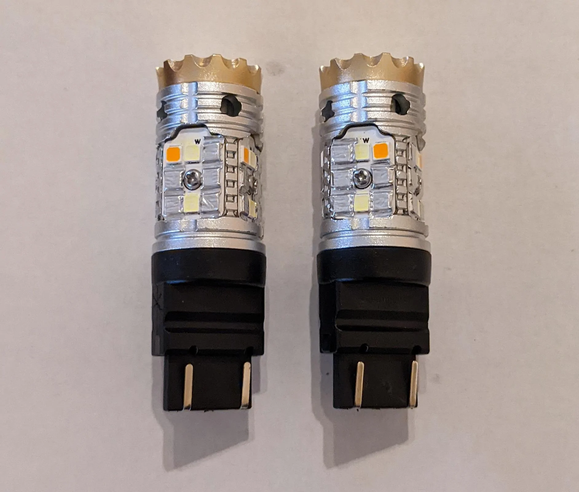

...and after experimenting with covering different led counts and positions I came up with this:
NOTE: Notice the exposed mirrored led positions on both bulbs, needed to get mirrored led pattern when installed on truck. Did all 4 bulb sides like this.
Ford Maverick DIY - Dim those bright Lasfit switchbacks m_lasfit
...which looks closest to the stock bulb brightness. Only one amber LED on each side left exposed, total 4 amber leds per bulb, the rest 20 leds are covered with aluminum tape. With small flat screw driver made sure tape is well wrapped all around the leds sides.
Left - modified Lasfit, right - stock bulb:
Ford Maverick DIY - Dim those bright Lasfit switchbacks m_lasfit-stock

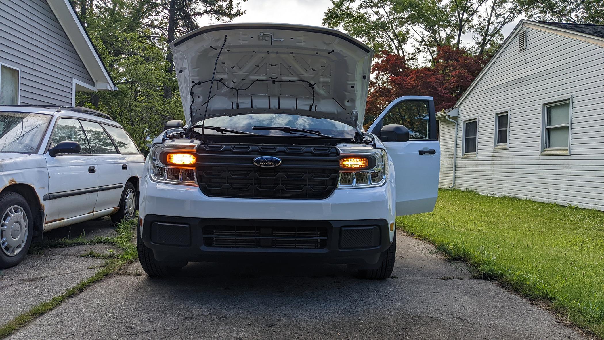

Side by side stock(left) vs. modified Lasfit(right) installed:
Ford Maverick DIY - Dim those bright Lasfit switchbacks stock-m_lasfit
And some final installed video:
Will see how it looks in a bright sunny day and expose some more leds if needed. Flexibility is the best thing about this mod. :)
Hope it helps...

LED are integrated circuits (Light Emitting Diode) and are susceptible to heat. Covering them in aluminum foil will probably cause them to fail prematurely, kind of like baking a potato.
I hope you still have the originals.

Looks like it still has the switchback ability just the ambers aren't as bright.
This to why...
And for running them as DRL.
