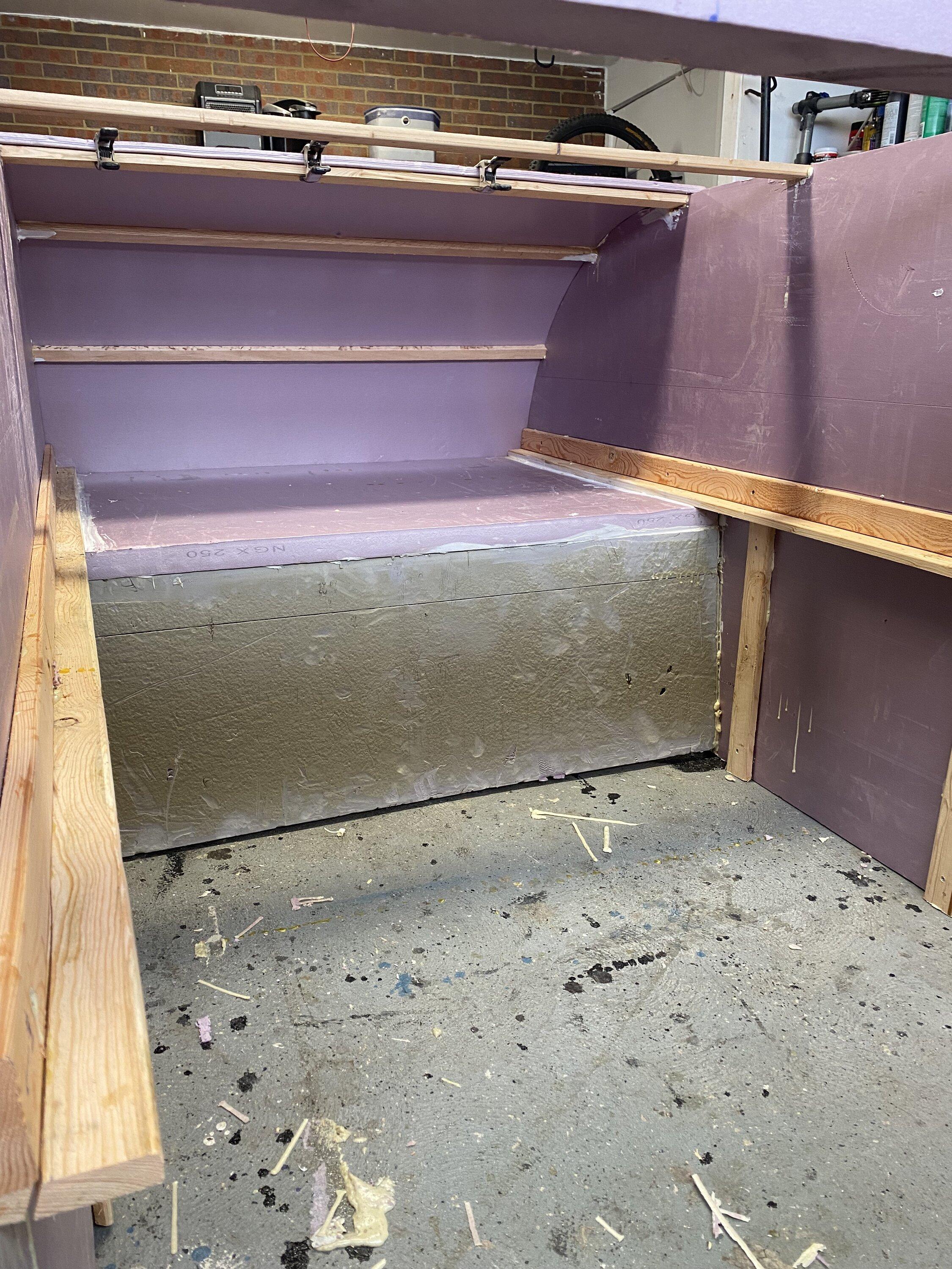

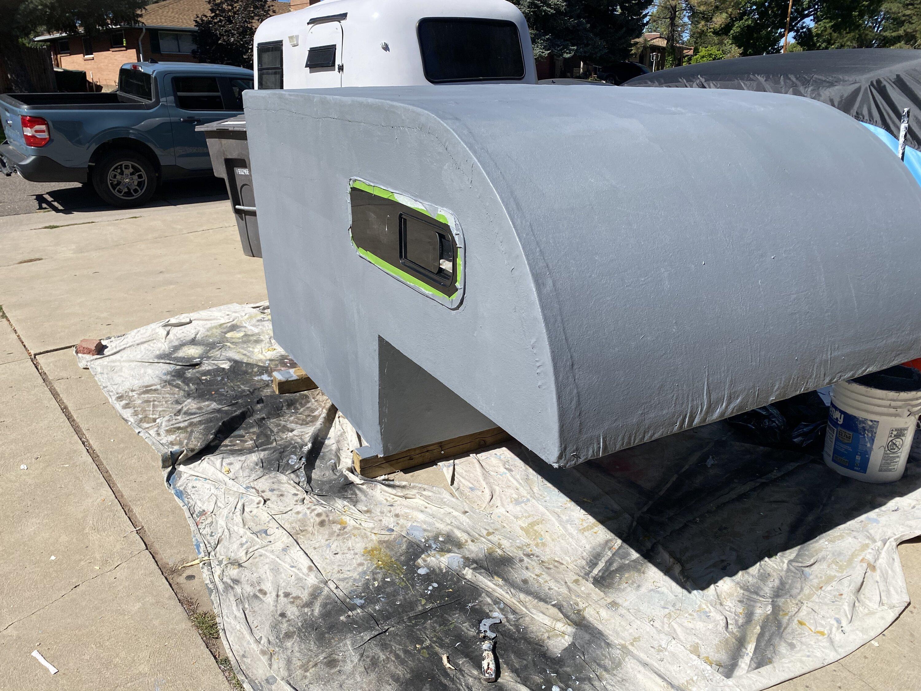

Team Maverick! Wanted to share my recent DIY camper build. Its 2” rigid foam insulation, wrapped in canvas and coated with Tightbond II (sometimes called Poor Man’s Fiberglass or PMF), then painted with rubberized roofing paint.
First time building with these materials. Learned a lot and a few things will do differently next time. I consider this a prototype and will likely build something different in the future, but for now, I’m satisfied. Took about 3 weeks, weighs around 150 pounds, cost around $300, gas mileage went down to 33 mpg (Hybrid) with mixed driving.
Full size bed, room for me, my bike and a few supplies. Not really meant for long camping trips, just quick overnights, and occasional solo bike trips.
2400 mile trip coming up in two weeks.
NOTE: Interior is unfinished for now. If I love it, and it works for me, I'll finish the interior with an automotive carpet.

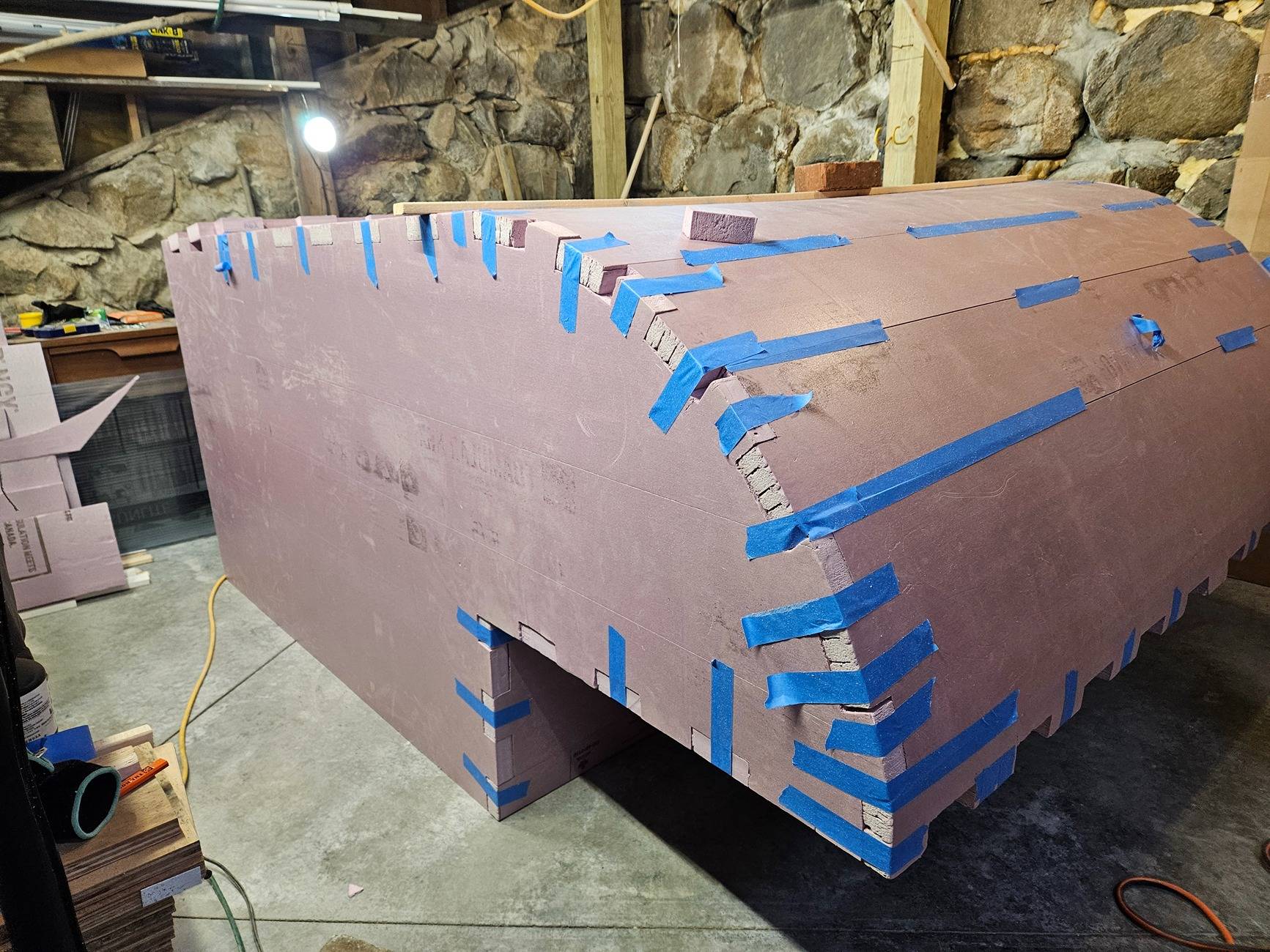

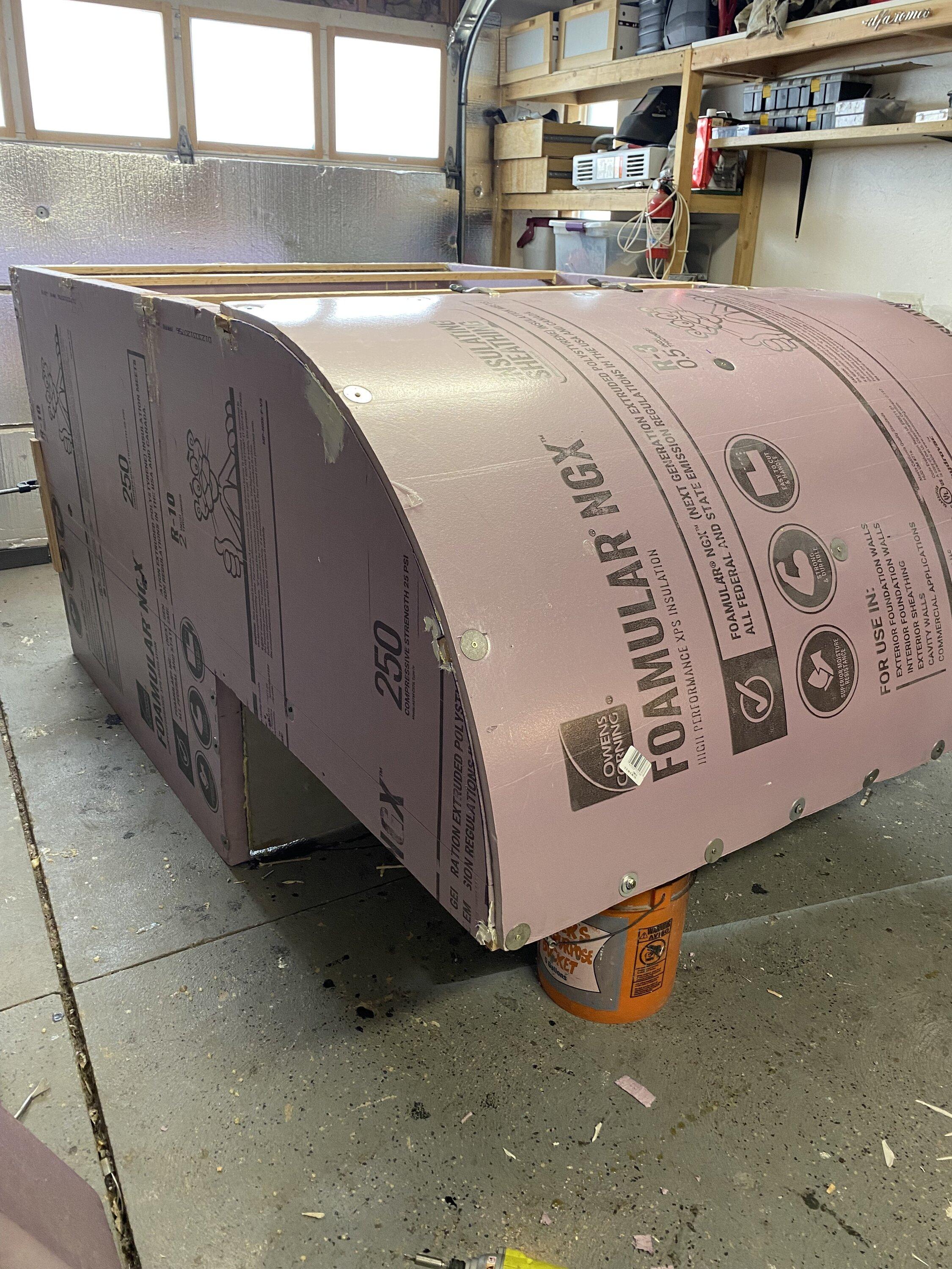

I just started building one for myself but with an overhang on both sides. I know it will cut way down on the mileage, but it's not really a concern for me (for now). I'm still at a point where I can change the design a bit without wasting too much money in materials. I have thought about making it lower and extending lengthwise but ugh!! I don't know! 🤷‍♀️🤦‍♀️
I'm using 1.5" Foamular. The outside is 75" wide. I havent figured out how I am going to attach it. I have the sides and the top all cut out but not glued together, (I will be putting in some corner bracing, but I'm not sure how to reinforce the cabover area. Will wood rails like yours be enough?) I need an extra body for help and warmer temps. It has been really cold here in NH. I still need to figure out the bottom shelf that will sit on the rails, and if i will need to use some plywood for extra support. I did the 4" notches to hold it together like puzzle pieces. (so I'm going to need some filler for all the goofs) What kind of glue did you use? What size wood are you using for the supports? I need to make some ribs to help support the span of the roof.
So if anyone has a suggestion, please let me know.
Thanks

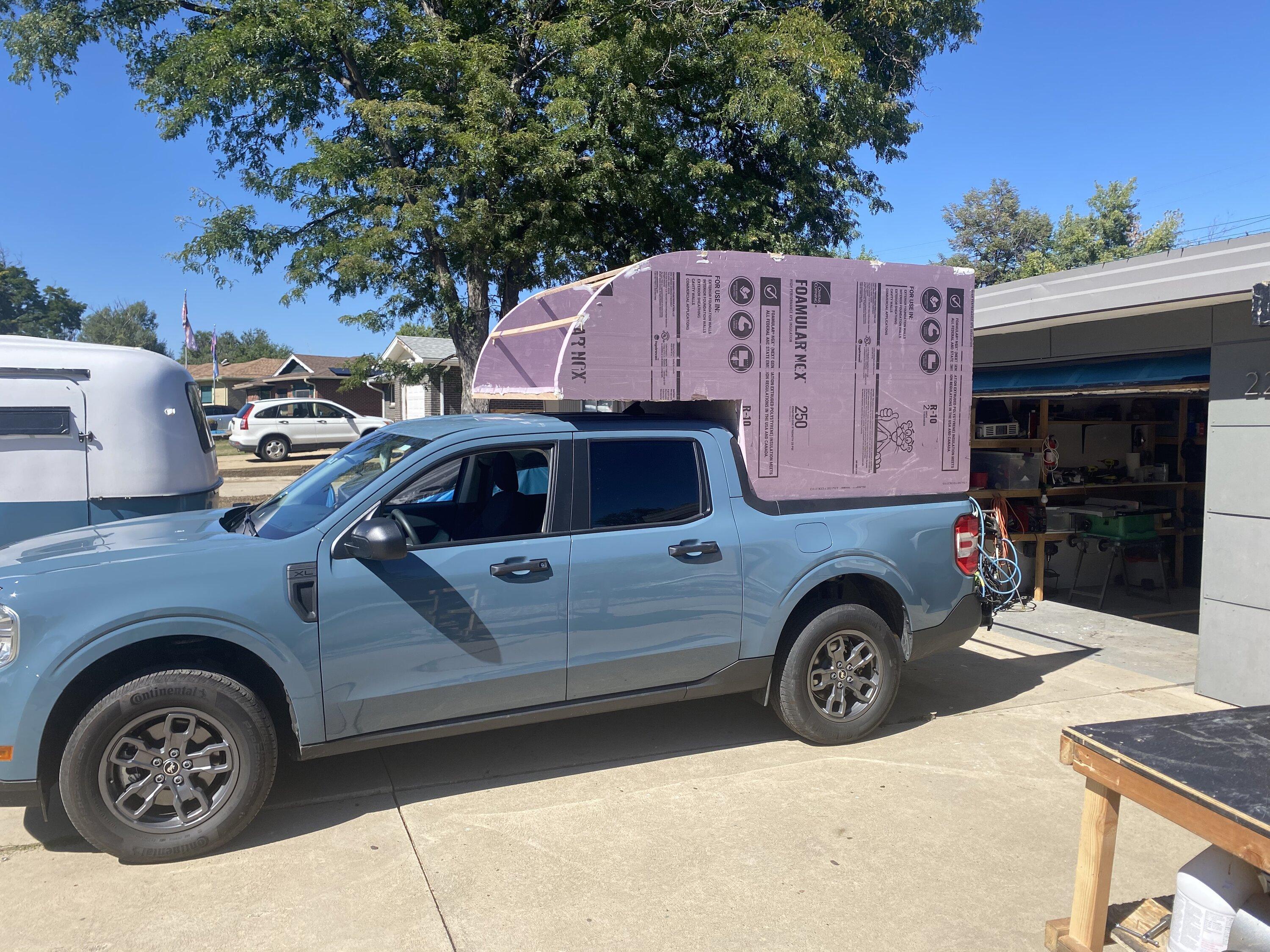

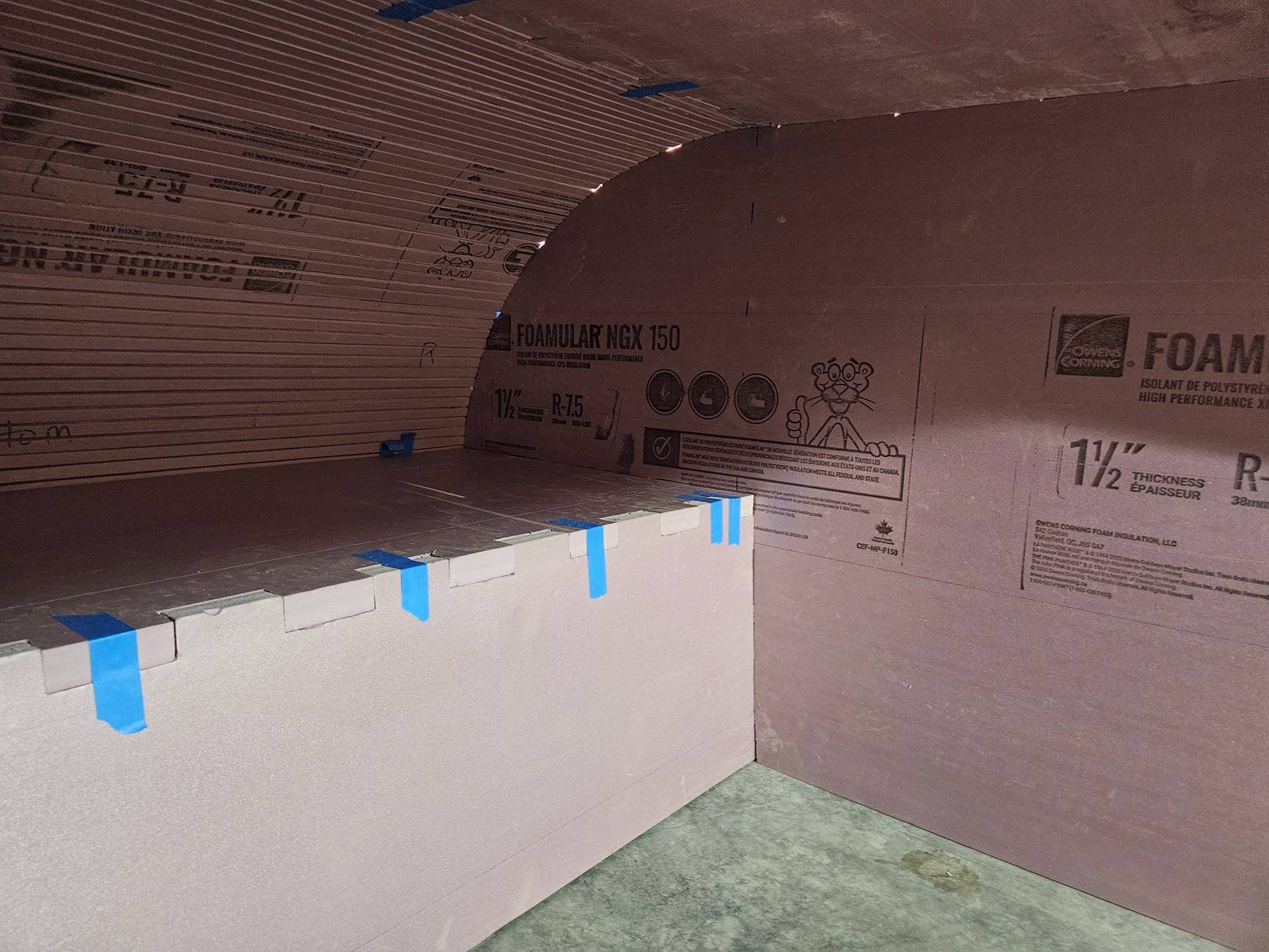

Thanks
Hey there! Looks like you're off to a great start! Keep us posted with your progress. Sadly, I don't remember much about my camper build because I kind of winged it, figuring things out as I went.
If I were to do it again, I'd probably make some sort of sandwich board with a thin layer of plywood. It would add a bit of weight, but it would be way easier to mount stuff, like shelving, outdoor shower, traction boards, etc.
I'd also make it longer so it fits over the open tailgate. Maybe not as tall though.
I actually sold my 2022 Maverick because it had a bunch of recalls, but I recently bought a 2024.
I'm thinking of building a smaller 1-person camp pod for my new Mav. I'll post here once I get started.

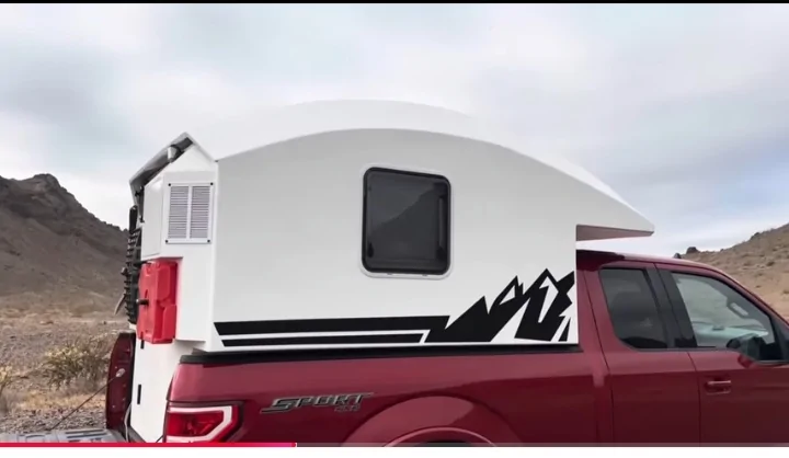

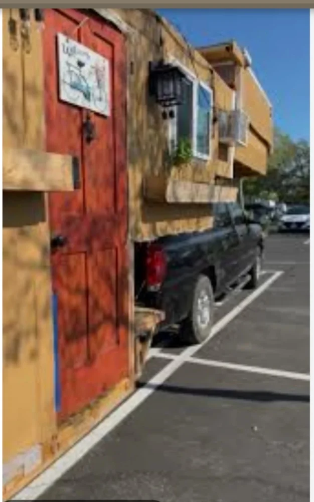

Here's another nice looking DIY camper version on a Tacoma, with an interesting design element.🤔

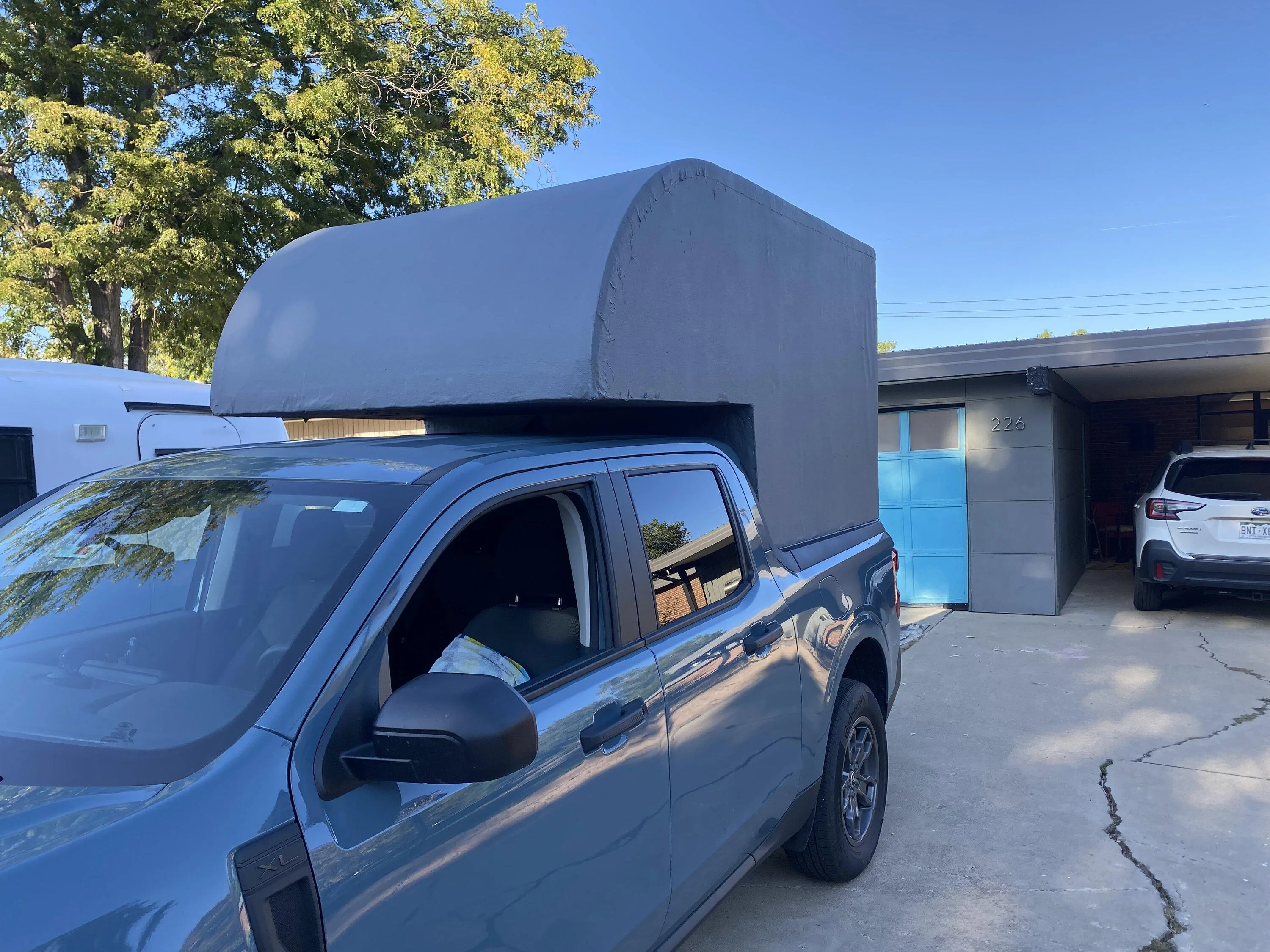

Sorry for the extra long delayed response... I abandoned it for the time being. Too many other more important projects like home repairs. It's still sitting there waiting. I still can't make up my mind if I want to change the design. 🤦‍♀️ I kind of want to make it narrower for better aerodynamics and somehow extend back over the tailgate but still be able to drive with the tailgate up. Also trying to figure out how to mount the windows I salvaged from a truck topper. 🤷‍♀️🤦‍♀️. I tend to OVERTHINK ...

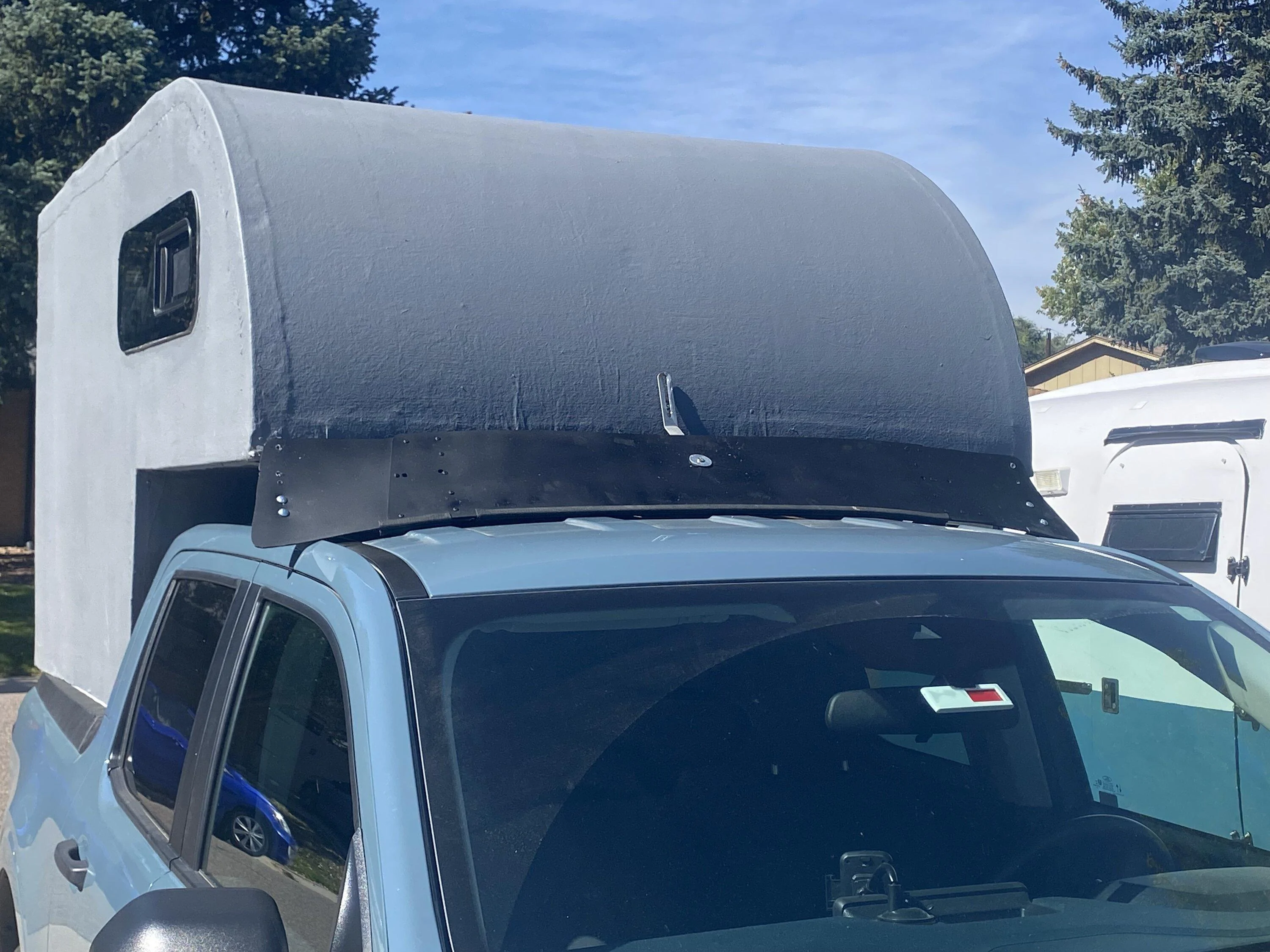

To be clear, this was an experiment and I wasn't sure how it would turn out... or even be usable :ROFLMAO:But, it drives great. Can't really tell it's there. There is some wind noise but not as much as I expected. I added a wind deflector, which somehow made the wind noise worse.
Try moving your deflctor as far forward as possible
to send more air overte top.
