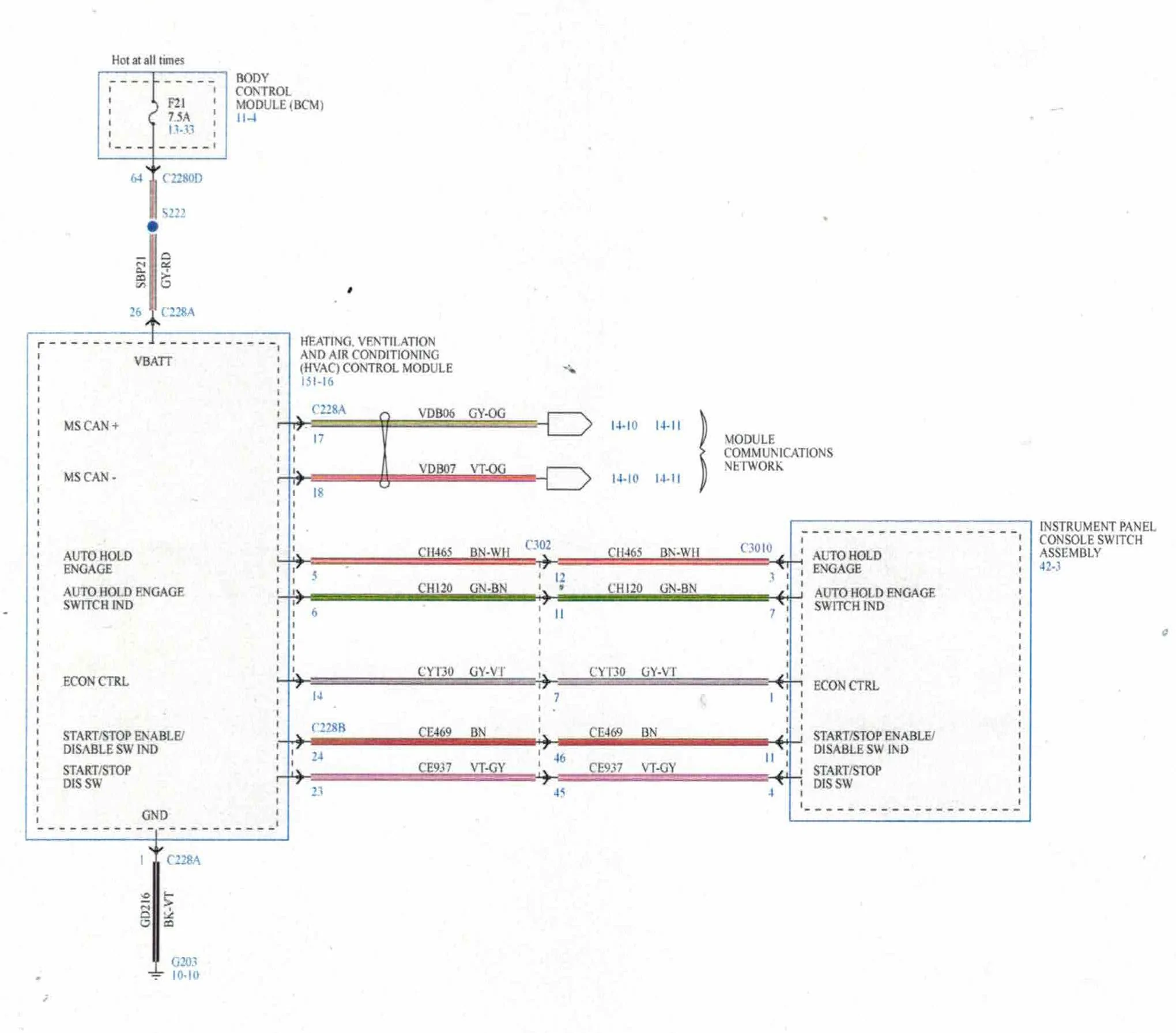

auto start stop goes through the HVAC control module. I tried checking settings to see if it stores on / off information in the module but no luck so far.

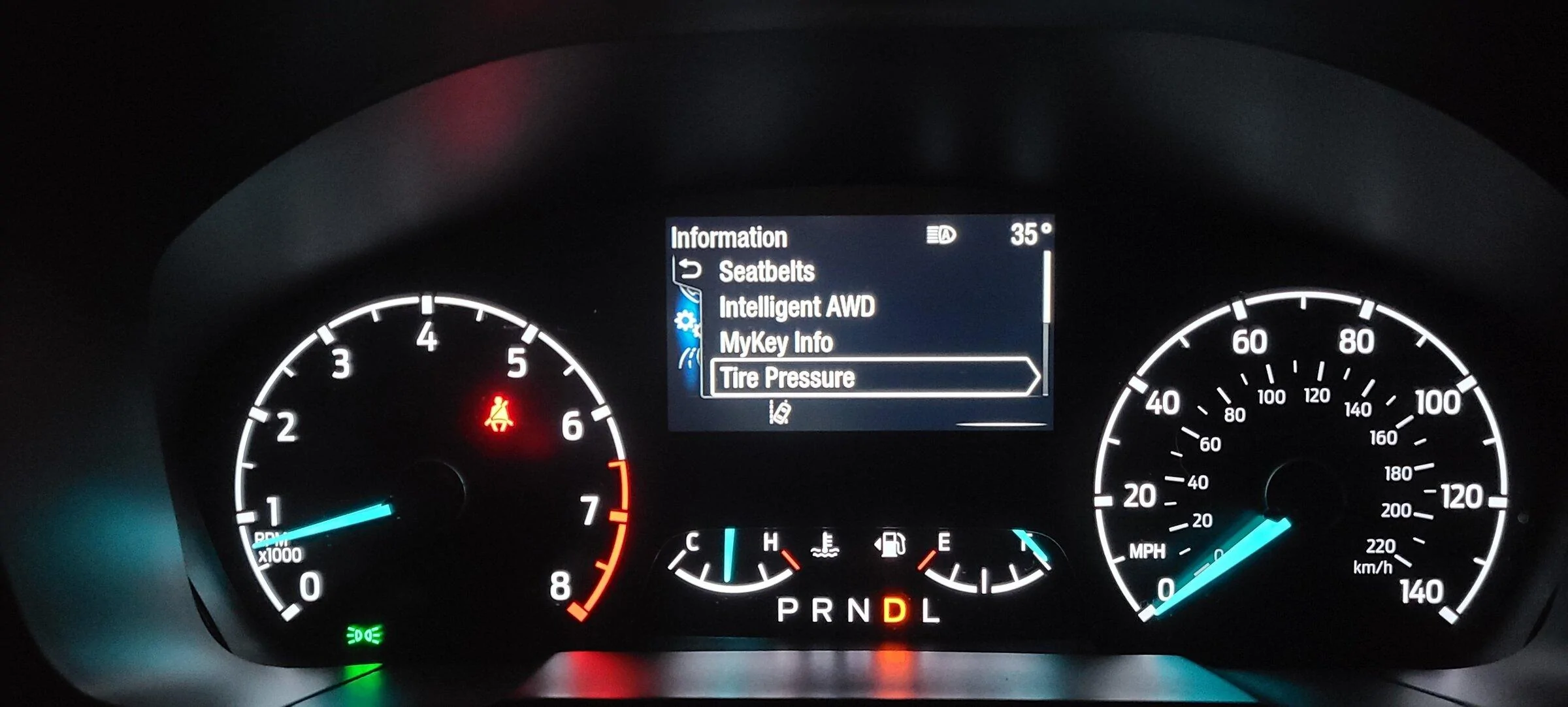

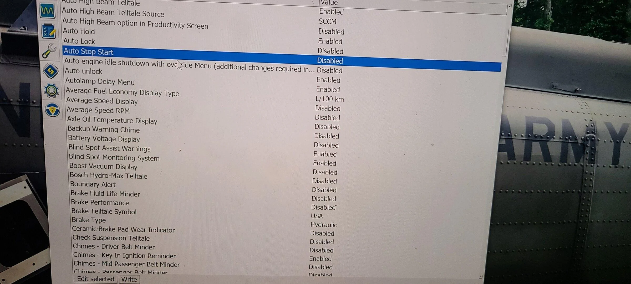

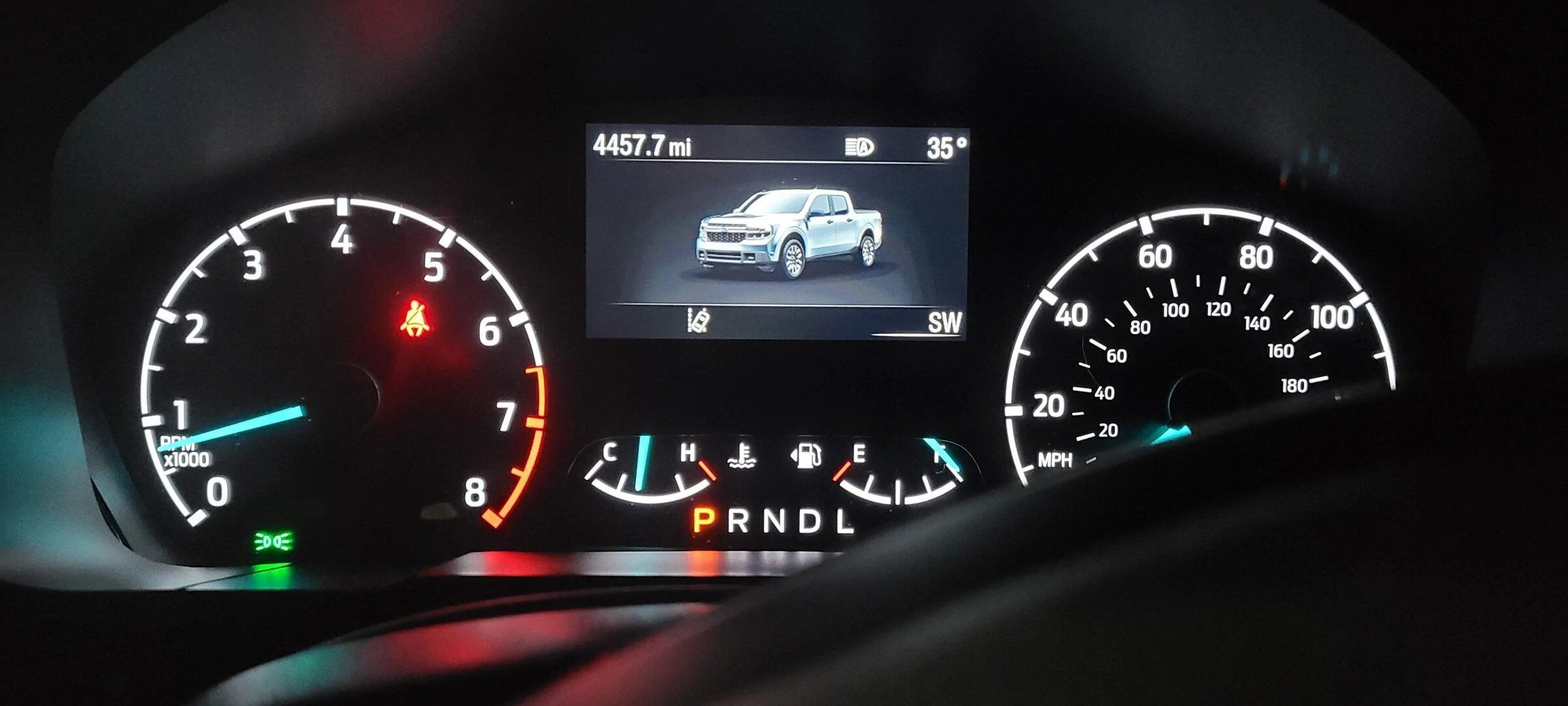

I was playing around with Forscan tonight and discovered that "Auto Stop Start" Under IPC Module
Configuration was set to "Enabled" and that there was an option to "disable" it so I figured I'd try it. I haven't been able to drive it yet but the autostart screen under settings, information is not there anymore and the grey A with a line through it is not there when I'm in park.
I will know for sure once I drive it in the morning but there is a huge possibility that you can disable it using Forscan! Assuming I'm not wrong of course, as I've only used it for an hour or so.
This works
There si a way to disable, I did it on my 2022 xl, google how to do it on the Ford Bronco Sport, you have to change one of the codes.
