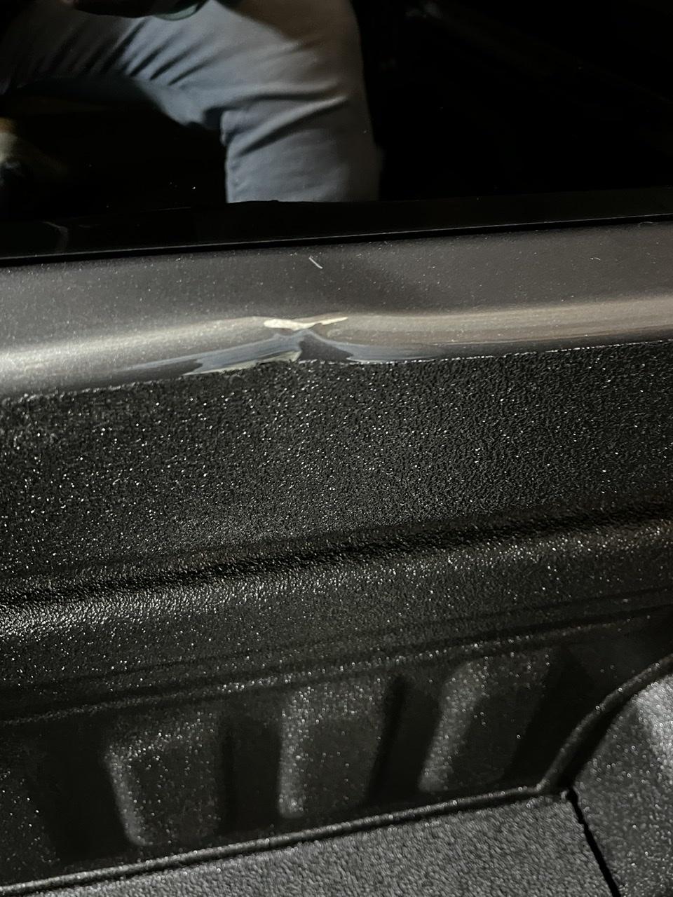

Part of me wants to say get a 2x4 and a rubber mallet and hit it from the top to see if you can flatten out the dent. Then as others have said, take it to a spray in liner place and have them hit that area. It will probably build up enough material where you wouldn't see it anymore.

I had a wooden box in the bed today. Some slack from the tiedown got loose, and while I was backing into my driveway the tire ran over the tiedown and pinned the wooden box up against the cab leaving this huge dent. Trying to figure out what to do next. Any ideas?
A shop can use a weld style dent puller to pull that out as best as possible. Then work the top side back to flat. Have some bed liner applied to that top surface as it will be as hidden as much is possible.

After seeing this, if I ever get my truck I'm NEVER putting anything in the bed EVER!
id echo this, but id have a paintless dent guy come out and see what he could do WITHOUT welding, as much as you don't wanna believe it, any weld will promote rust when the paint on the back side is burned off from the spot welder. paintless as far as it'll go, and then bed liner up to the bottom of the window glass should make that all but disappear.

A little touch-up paint to prevent rust and you will be the only one that will really know it’s there.
Or cover it with the drop-in liner when that becomes available. 😄
I did see your comment about bed covers not sitting flush anymore. If you use a bed cover, I could see how the bulge on top of dent would be an issue. Body Shop quote for that if you have to cover your bed at times.

Find your self a bed liner place they can re spray the lip and build it up no problem
It's a truck - having bed rails covered with spray in bedliner is a great solution!

Sorry, boomer that this happens to a new truck. I’d first get some free advice from a dealer or local body shop…I’d see if there is access to the dent from behind the back seat of Maverick to push the dent outward, (probably not). But at least temporarily get some rust retardant paint (right color) and with an artists brush to cover the damaged bodywork that is exposed so it will not rust. I too would guess $700-$1,200 (since you live in NY). But too would look at having the dent covered with bed liner.

You just need a 2x4 and a hammer.

Cheap fix - take a piece of wood and hammer. Place the wood over the dent (top and sides) and pound it as flat as you can. Then a little touch up paint and touch up the bed with a spray can of liner. Probably less than $25 total.

I too would guess $700-$1,200 (since you live in NY), but a good body guy could make most of it disappear with "filler" for a couple of hundred. But would look at having the dent covered with bed liner.
A good body guy wouldn't do anything for a couple of hundred other than pull the truck into the shop. LOL

You'd be amazed at what a competent paintless dent repair person can do. I'd at least have them look at it first. Usually their only requirement for a perfect fix is access to behind the dent.
