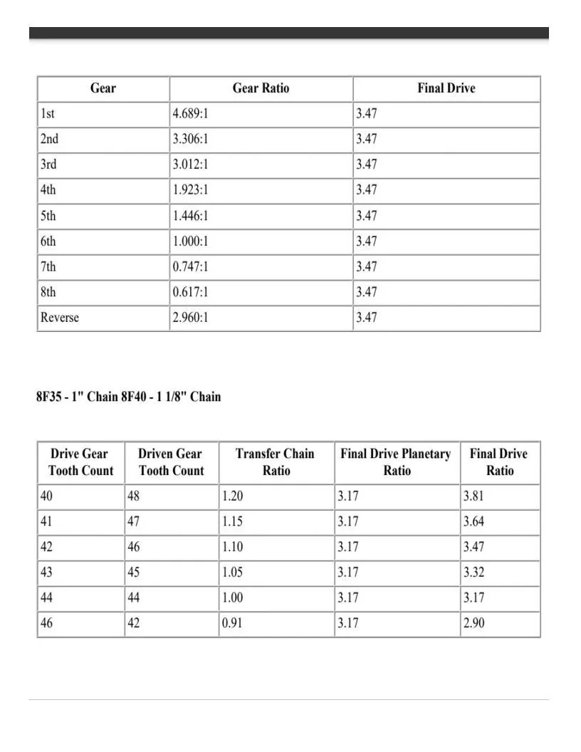

I work with computers. So, I read "different gear ratio" and assumed "different transmission."
Also that should gear chain not drive train. It is spelled out in detail in the shop manual as seen here.
Ford Maverick Dealer screwed me over gears
You missed the "computers" part of my post...

I didn't, I am just thorough to sideline conjecture from others in this case.

The tow package includes essentially a different transmission, an upgraded cooler, and a transmission cooler. Not something you can tack on after the fact.
You would have better luck flipping for something closer to what you need.
Where did you see it was a different transmission? AFAIK it's still the same 8 speed as the other ecoboosts. You do get a trans cooler and upgraded radiator/fan along with the higher ratio differential.
OP buy it, order another one and trade it in. To a different dealer.
See follow-up post from me. I saw "different gear ratio" and read "different transmission" because it would be easier for Ford to keep both in stock than to modify it on the line.

This makes me wonder what is the towing cap of an AWD Mav without the factory towing package?
if you just added a receiver and 7 pin plug
It's the same engine, same transmission, same brakes. So from that perspective it can pull 4,000. Shoot the vehicle is at least comparable to a Santa Cruz which is rated for 5k.
But the door sticker says 2k. So I'd be very careful going over that. Warranty and liability issues could result. But if you need to move something a couple miles on a one off it's not like the vehicle couldn't safely do it.
