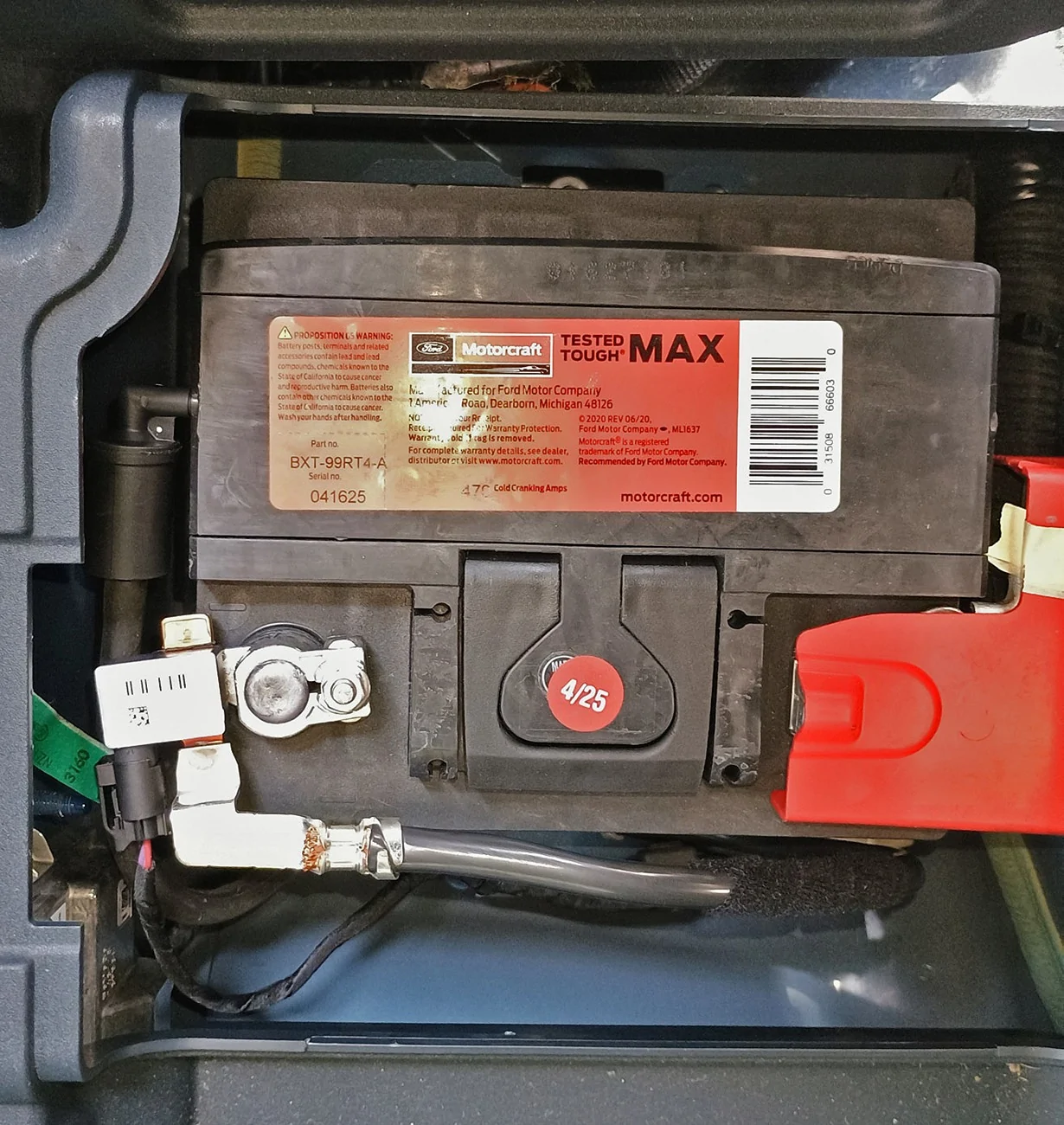

Update, dealer installed Ford battery BXT 99RT4 I checked listings and it appears to be standard type.
This is what was put in mine a few days ago > lead acid

Yep, that is the standard stock lead acid garbage.
