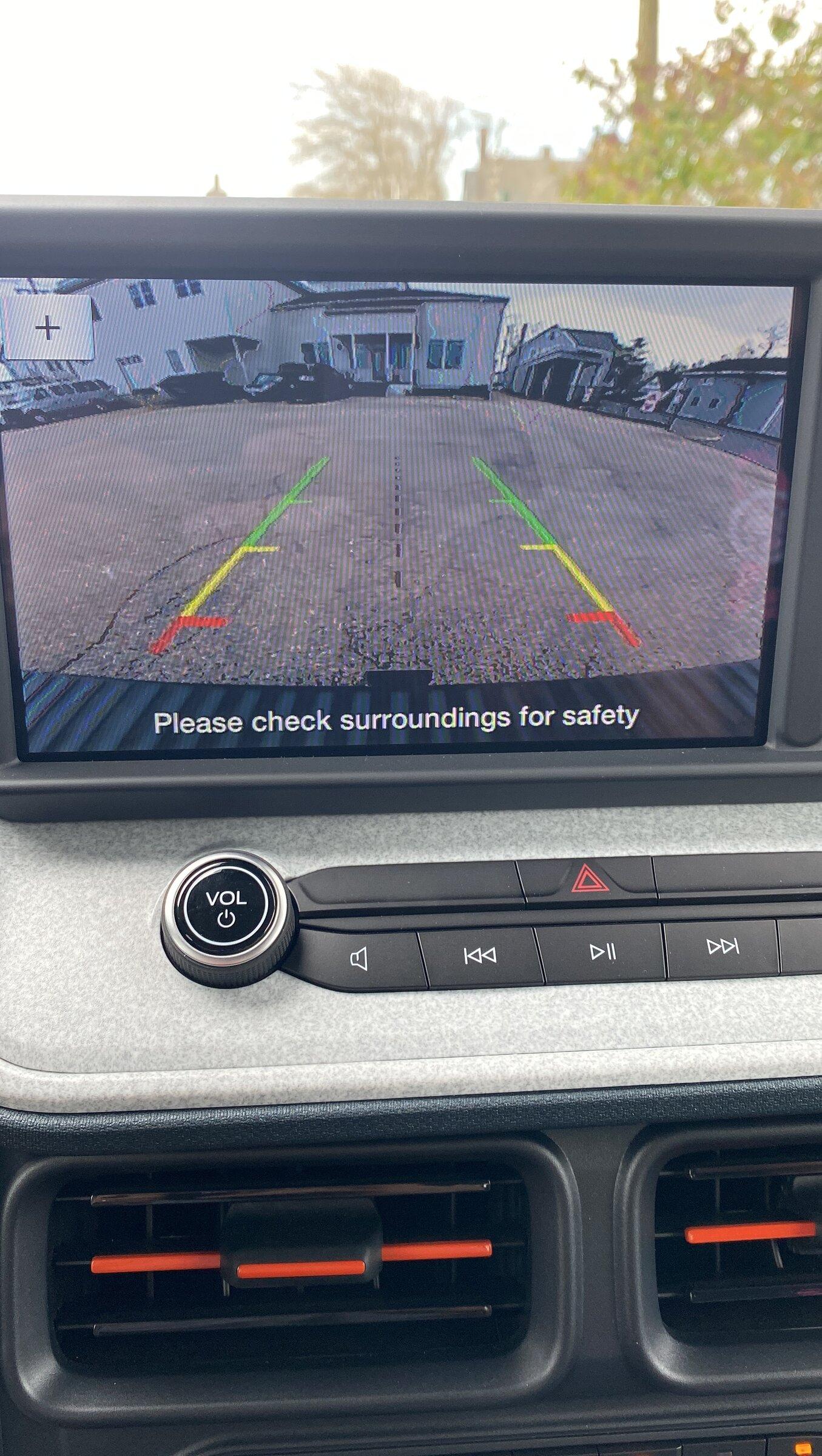

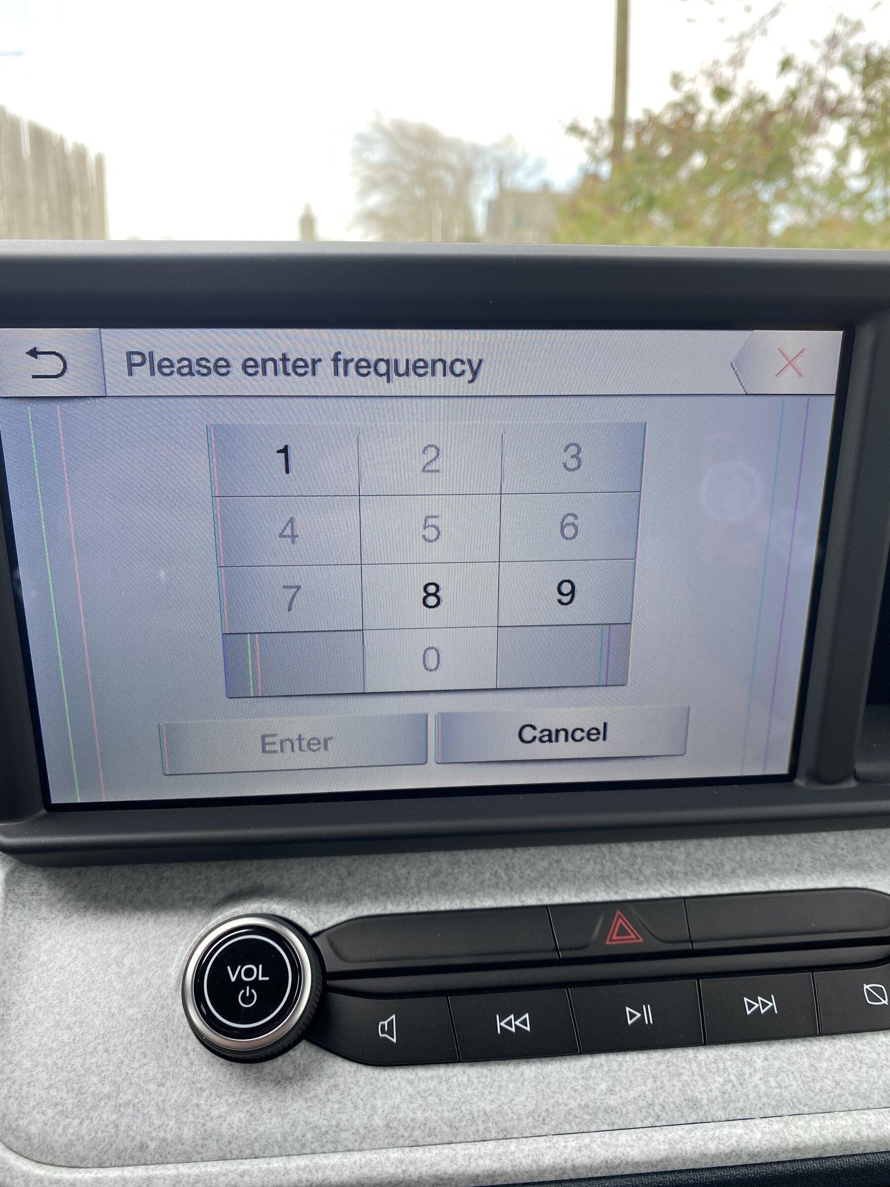

Display has vertical lines at all times and in reverse it’s all scrambled (hard to tell in photo). Only 1,800 miles, not happy.
Ford Maverick Dead display 417F7B6B-CAE9-46C3-9DBA-9A09FBDE5244
Ford Maverick Dead display 9038921B-0A62-4132-BAC9-CB85E29C1435

Having seen many bad monitors in my time, the coloured lines on the screen, like in the picture from the OPs one, are a classic sign of a failing LCD panel. No amount of resets will fix a hardware failure like that long term. Just adding this as a heads up to anyone who might run into this issue in the future.

Couple things here indicate it's not a defective LCD panel, other than the fact that a force reboot/"soft reset" cleared up both issues. One is that a defective LCD panel's lines generally will run the entire height of the LCD vertically and will always be present. In OP's case, the lines are limited to a specific UI element - everything under the header for the outer bars, and there are some that are limited to the height of the buttons. Further, the image from the camera feed was distorted, not clear and in focus, which is a separate issue. For another, the lines did not persist when the backup camera was active.
If you look closely there are some coloured line distortions in the backup camera image as well, just not in the same place. It could be the graphics co-processor for the screen, rather than the screen itself.
Edit: Other posiliblity, the screen is in some kind of test/service mode. I recall seeing similar coloured lines in videos of the instrument cluster when it was in service mode.
