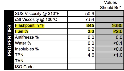

Hmmm. I just got my report back. Second oil change, 7800mi on synthetic. My commute is about 30 miles one way, plenty of time to get to operating temp. My fuel in oil percentage was 2.5% on my ecoboost. I did just idle it a bit before the oil change
To get the most accurate results for an analysis, you should preferably change the oil (collect the sample) after an extended run where the engine maintains NOT (normal operating temp) for at least 20 minutes. Backup method would be cold, AFTER a 20+ minute trip. Cold Idling for a few minutes prior is never recommended.
